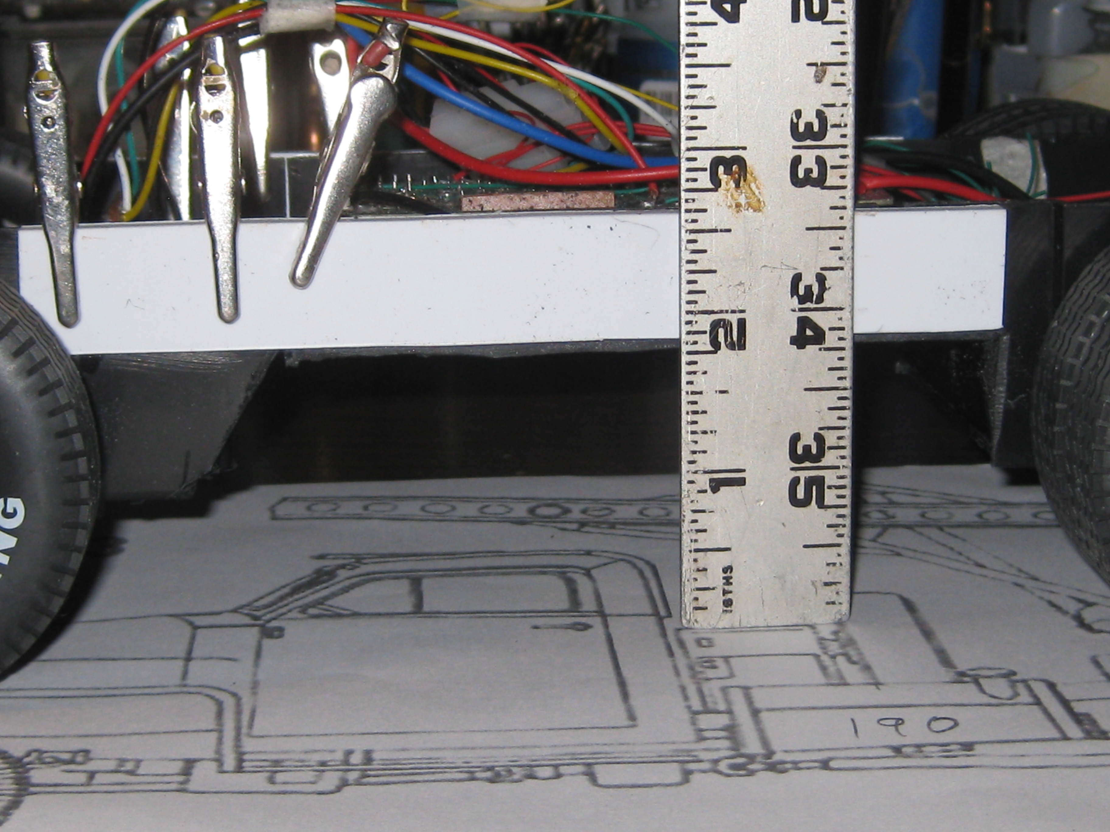

Recently, I realized I joined this forum 5 years ago (on February 24). Gosh, how time flies......I have posted photos of a number of my finished projects before, but I never did a photo WIP thread that showed my progress as it got done from the start. I want to try to do that. Last week I remembered that I had a large scale R/C truck model that was begging me to use it for some kind of a project. It is one of those toy like 1/16 (1/14?) RTR trucks that I got on the internet for $60 a couple of years ago. It's a model of a King Hauler, and it is going to donate itself to be cannibalized and converted into a Studebaker deuce and a half. It won't be Tamiya or even Heng Long quality, but it will work out well enough to suit me (I'm easy to please). It's going to be fun (for me), and maybe provide you guys with a few laughs about "Why it might be easier to scratch build something than convert anything into something else". I hope this works.

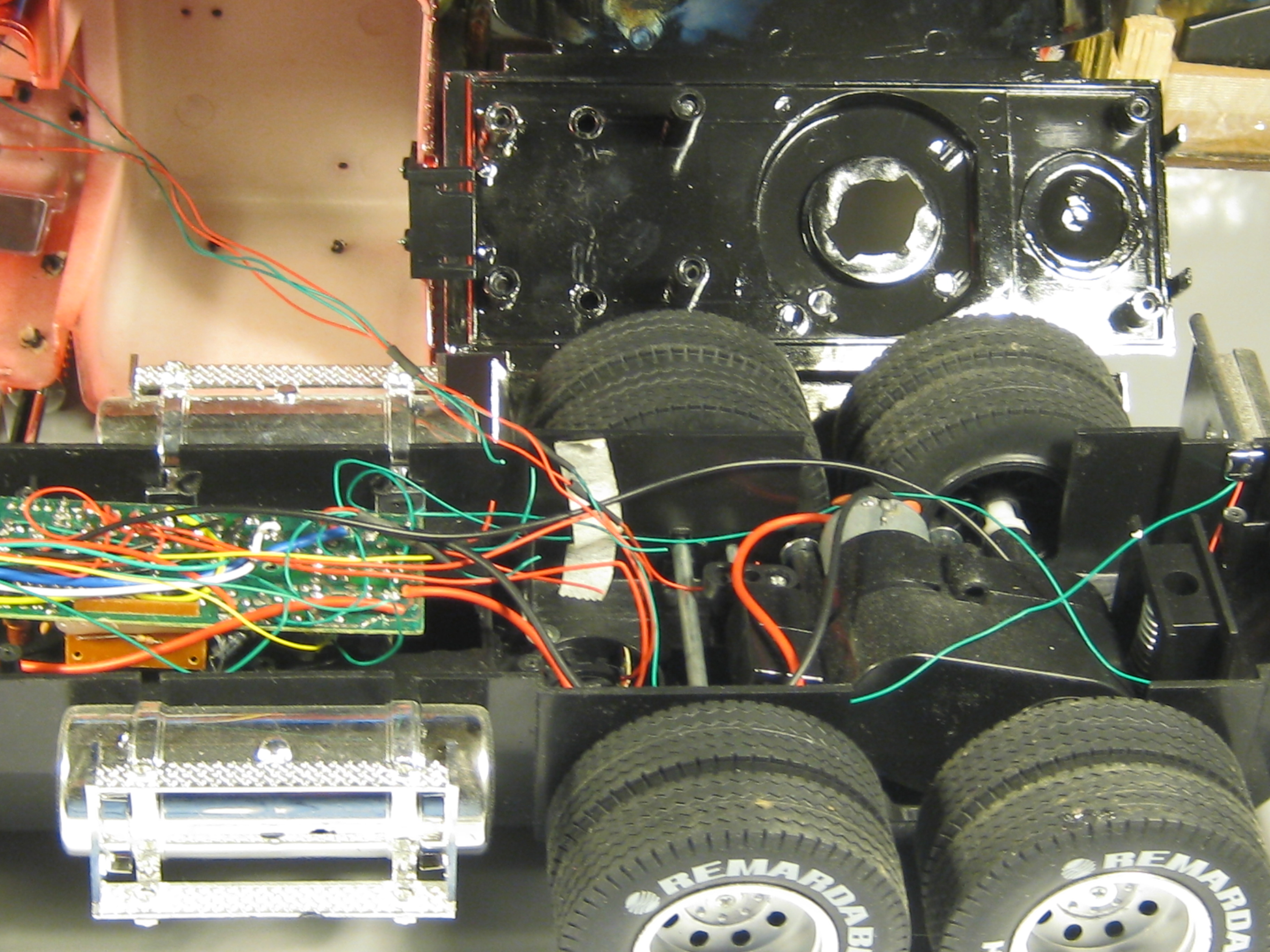

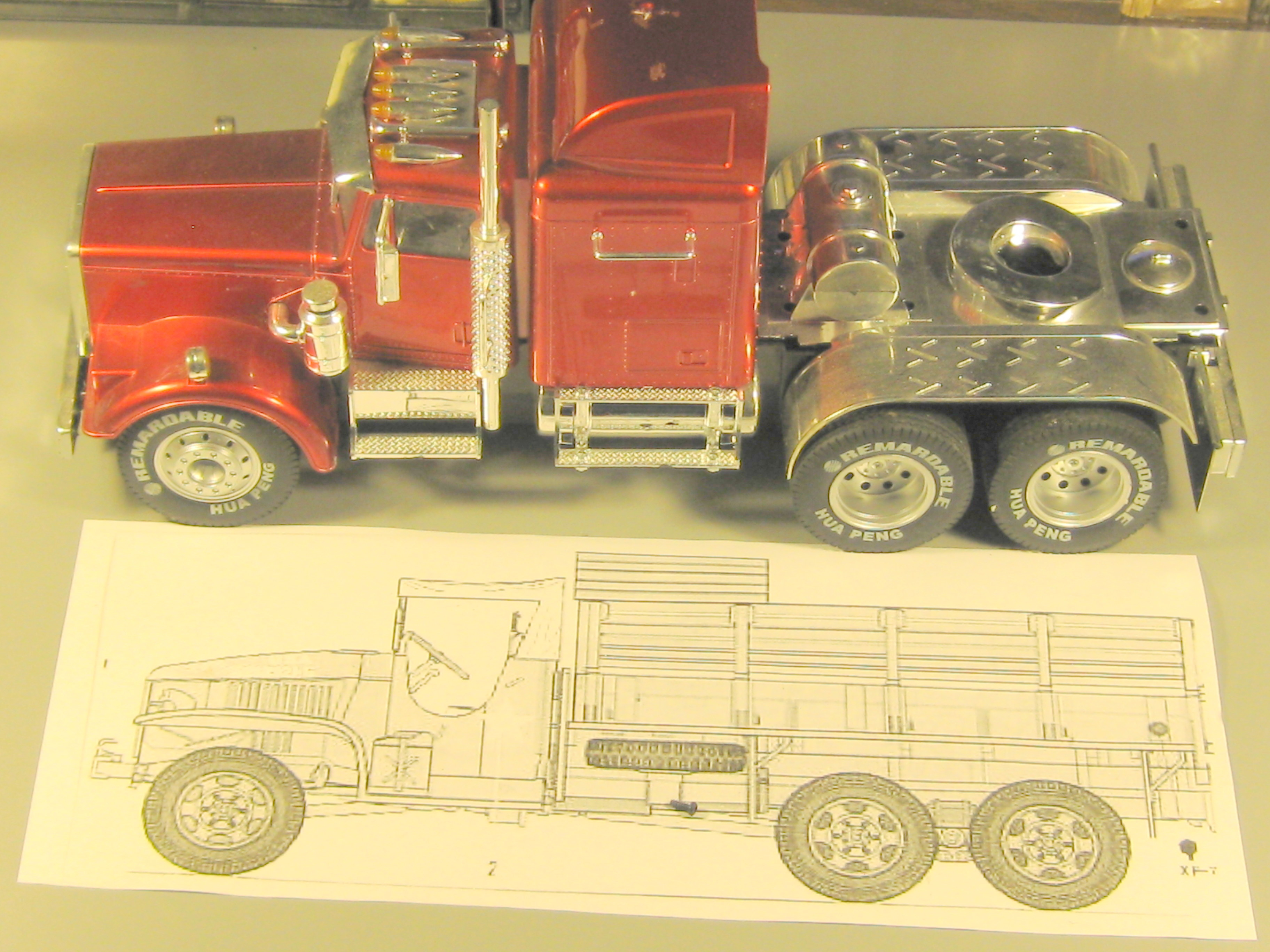

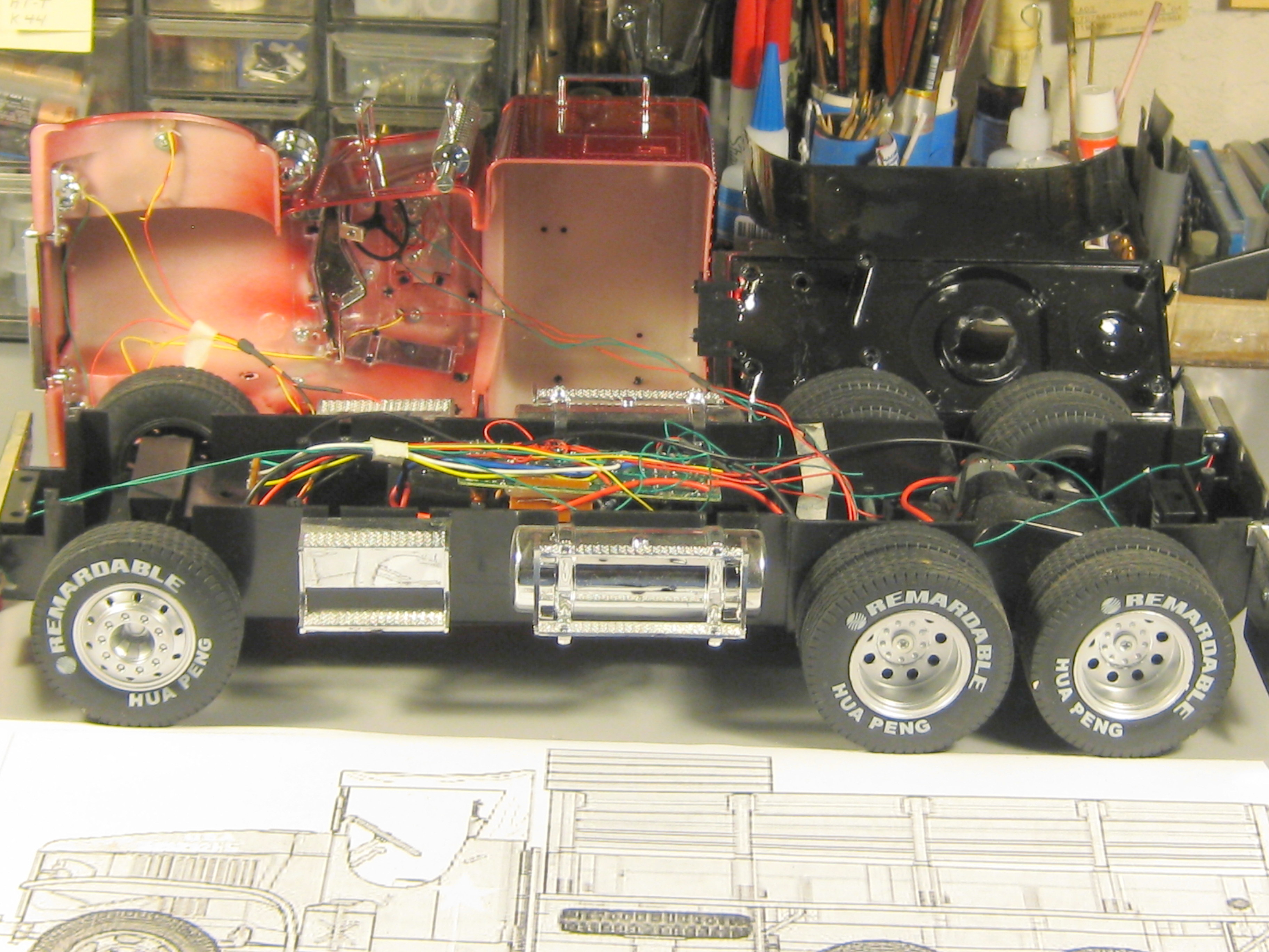

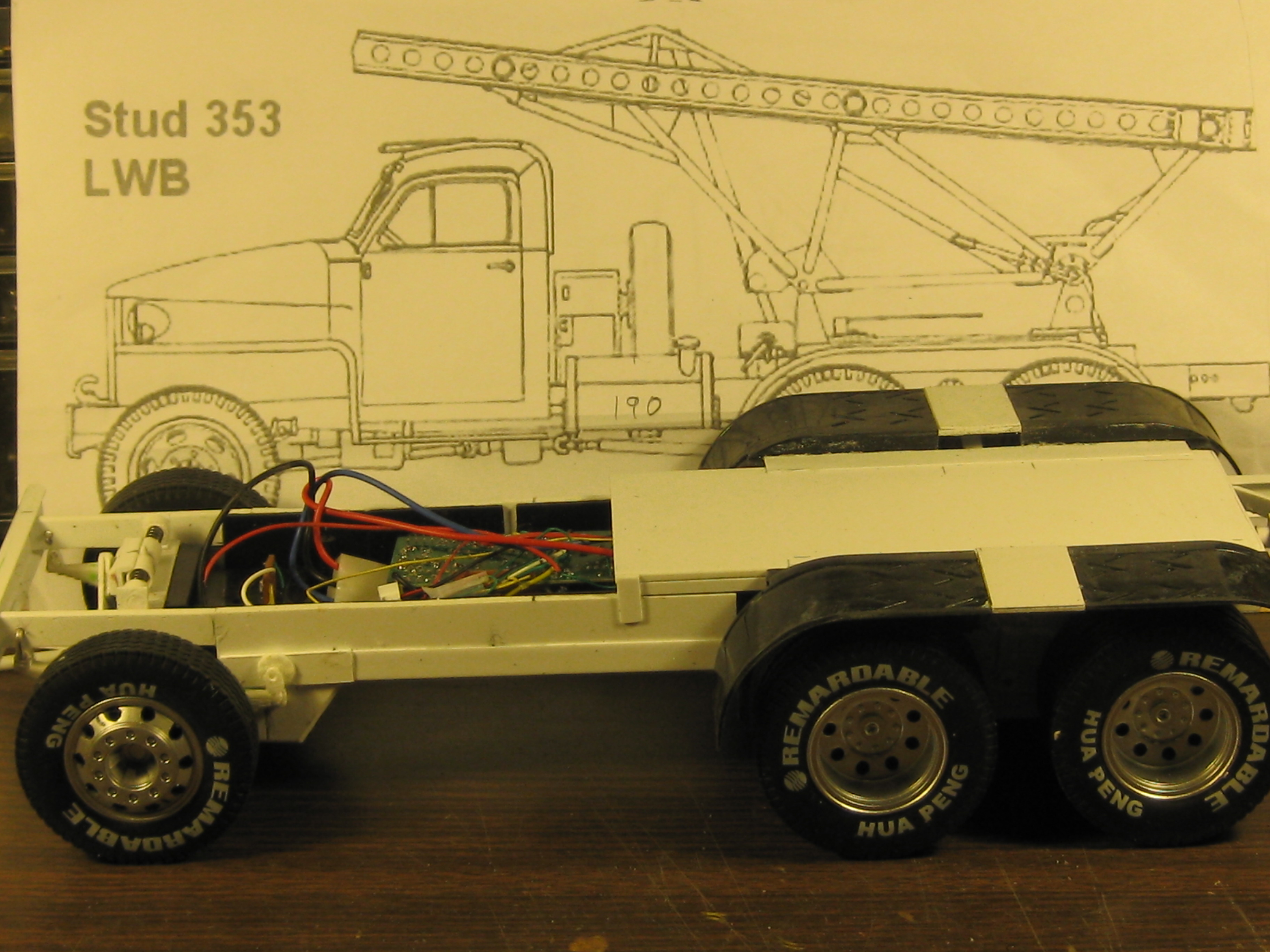

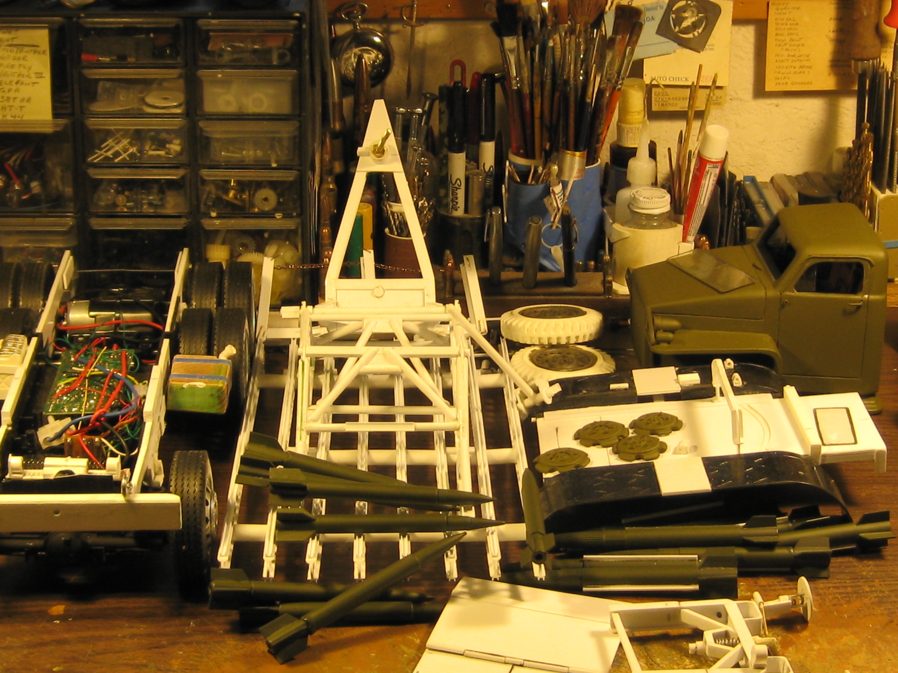

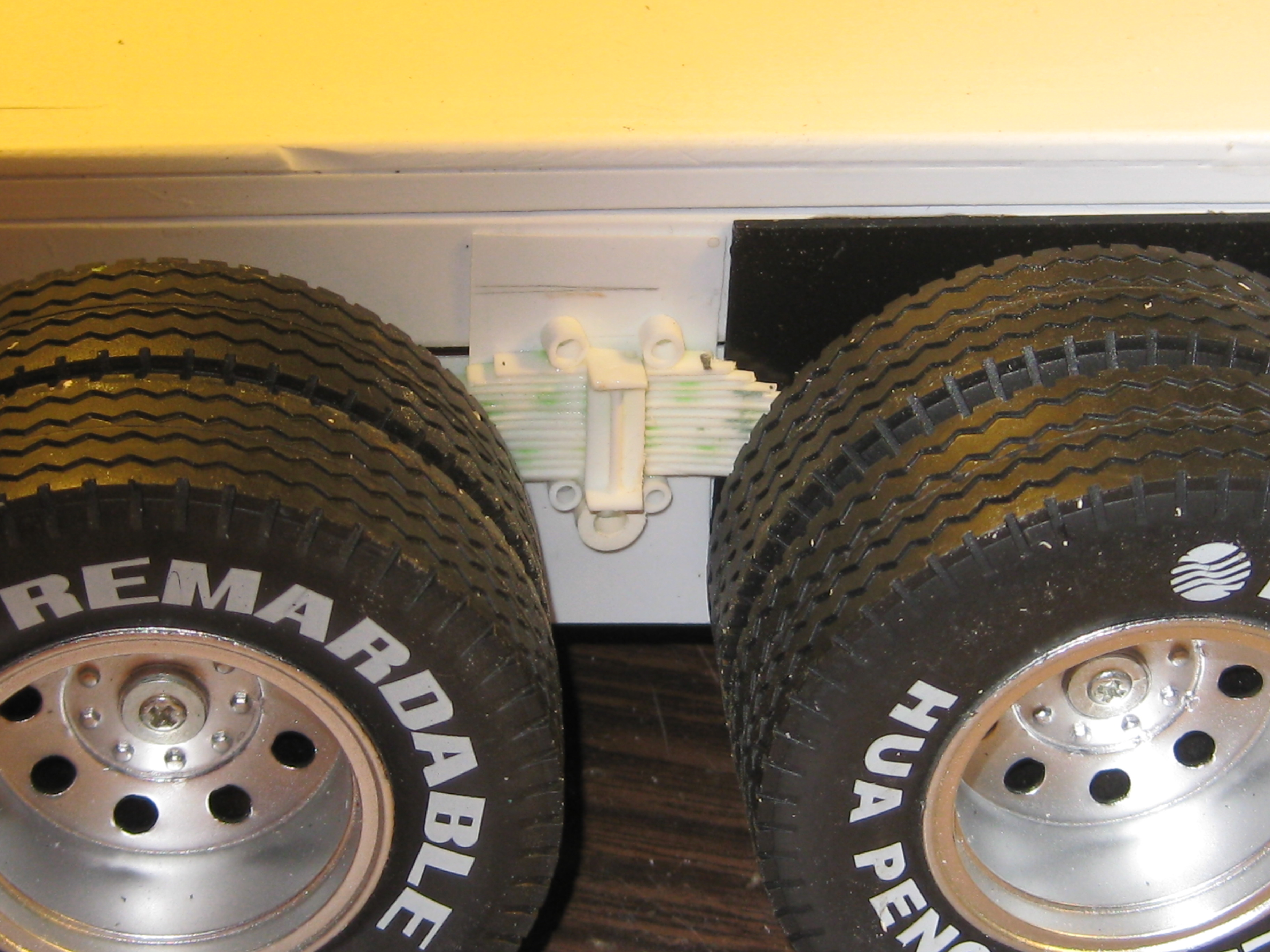

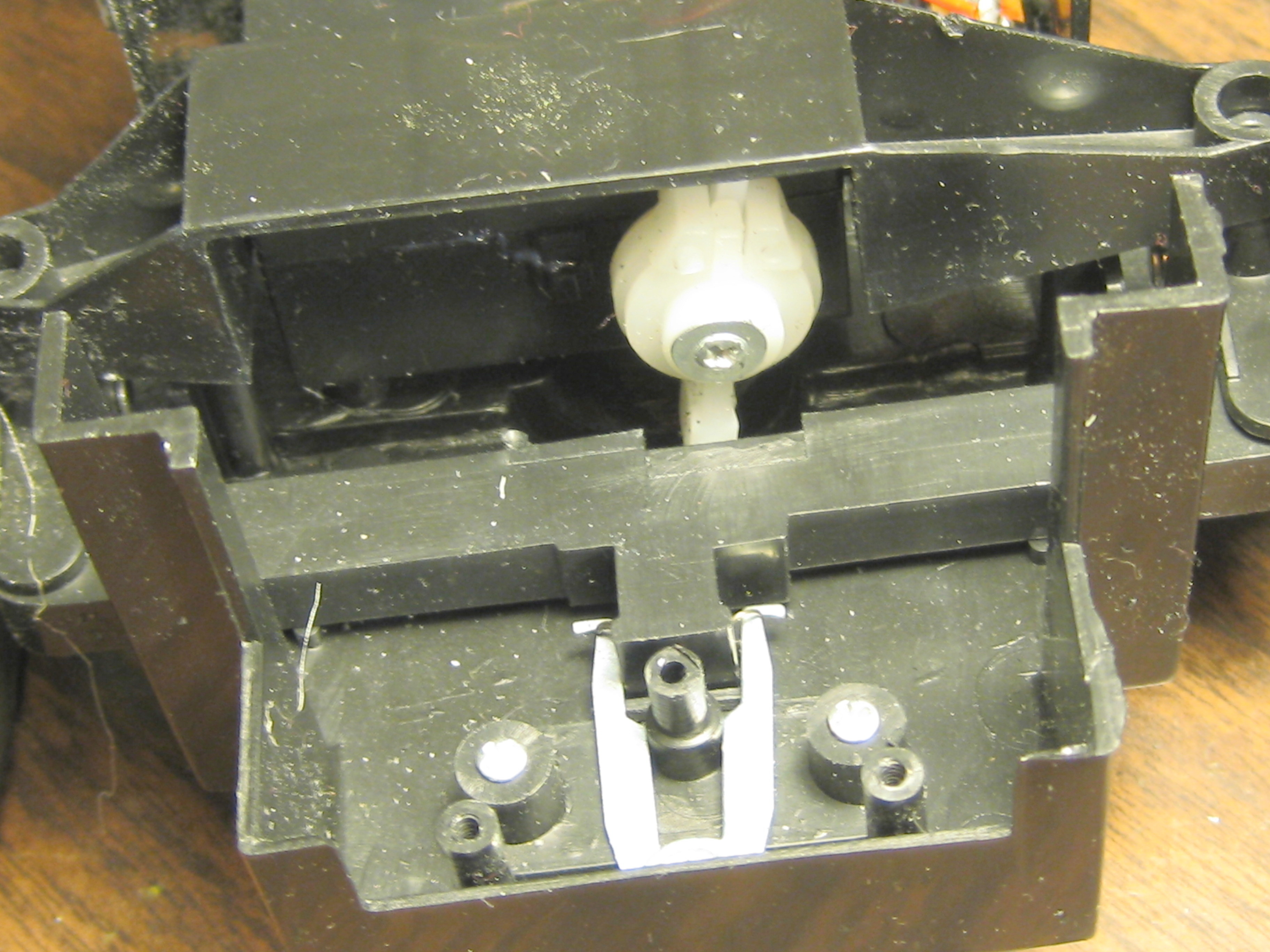

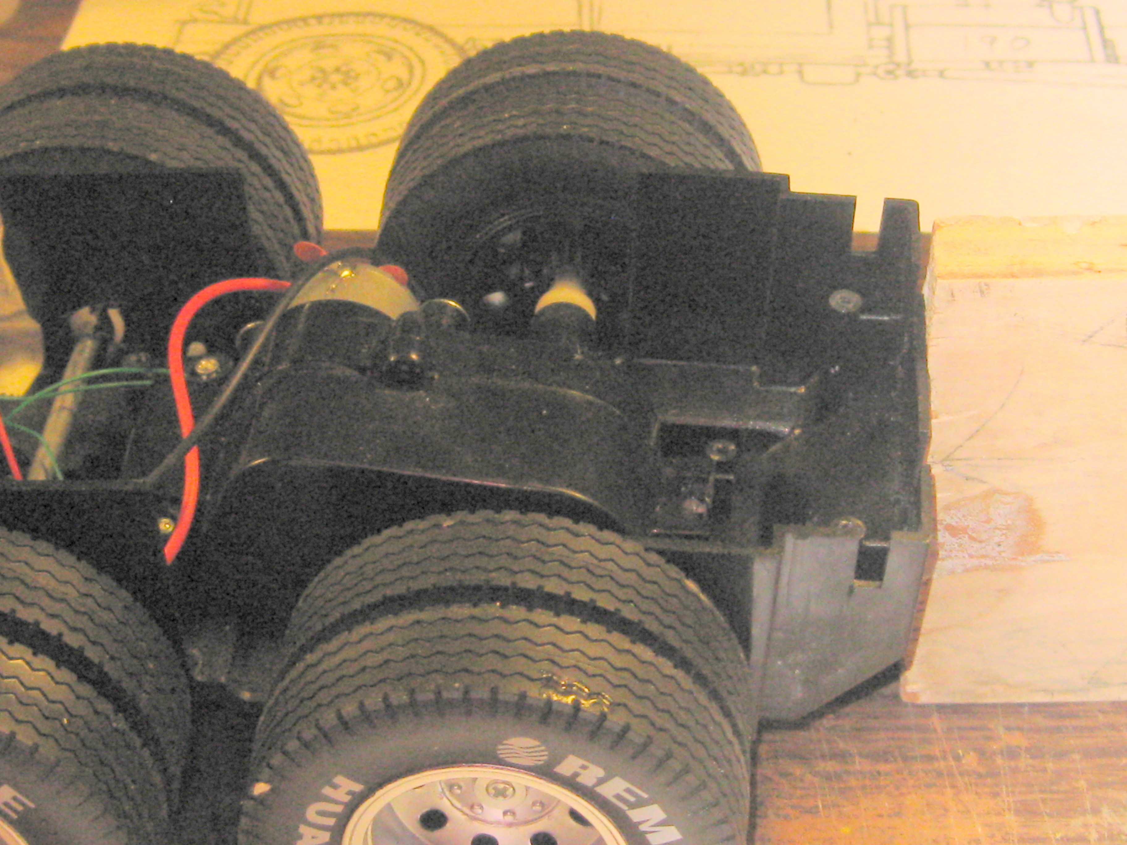

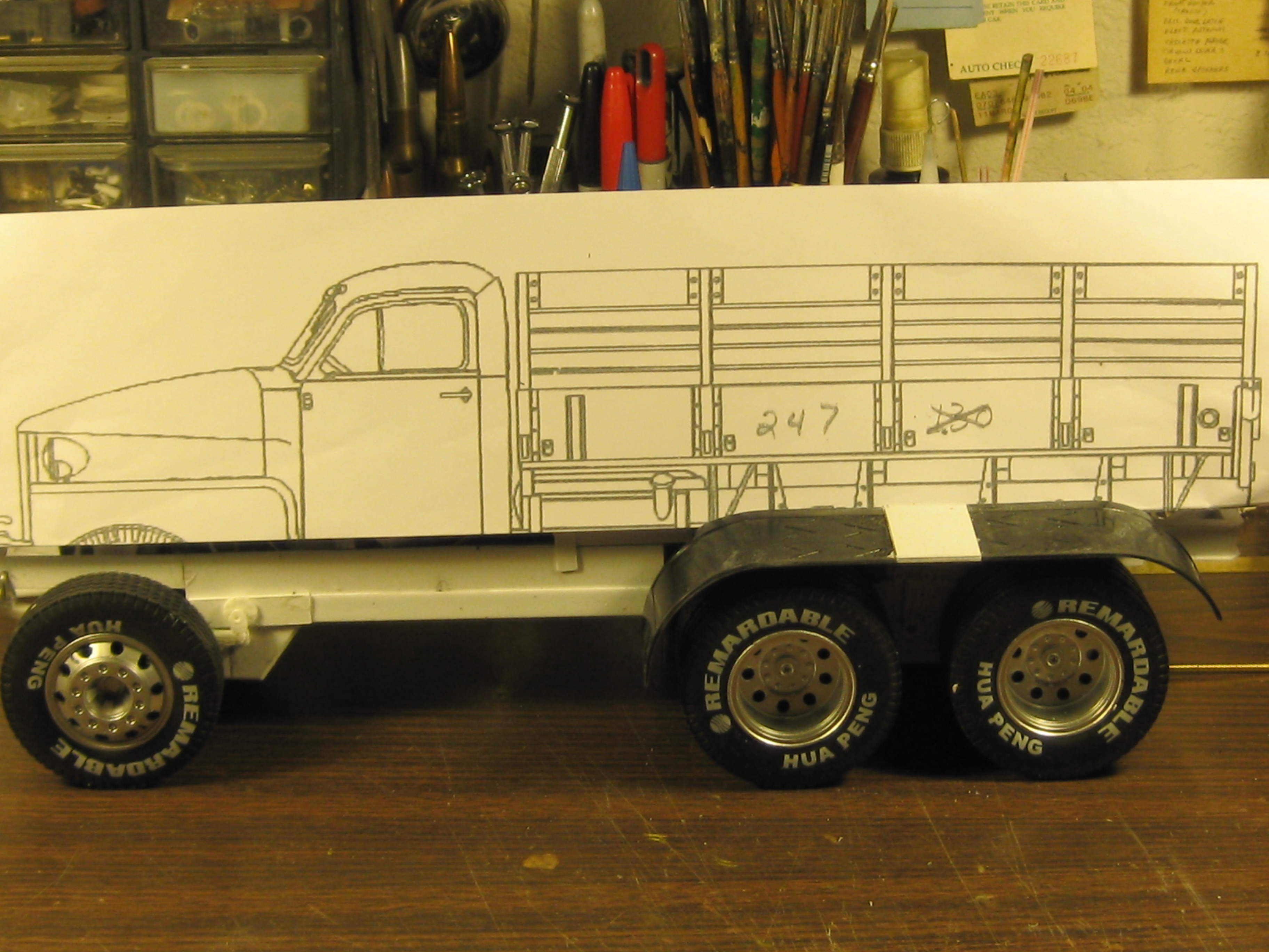

Here's what I started with ....
http://www.rcuniverse.com/forum/atta...mentid=1968236http://www.rcuniverse.com/forum/atta...mentid=1968237http://www.rcuniverse.com/forum/atta...mentid=1968238
The dimensions of this truck were close to the dimensions of the Studebaker, but could be improved. I shortened the frame by cutting out 25mm. I also cut out the battery box on the bottom to get the ground clearance more accurate.
http://www.rcuniverse.com/forum/atta...mentid=1968243http://www.rcuniverse.com/forum/atta...mentid=1968244http://www.rcuniverse.com/forum/atta...mentid=1968245

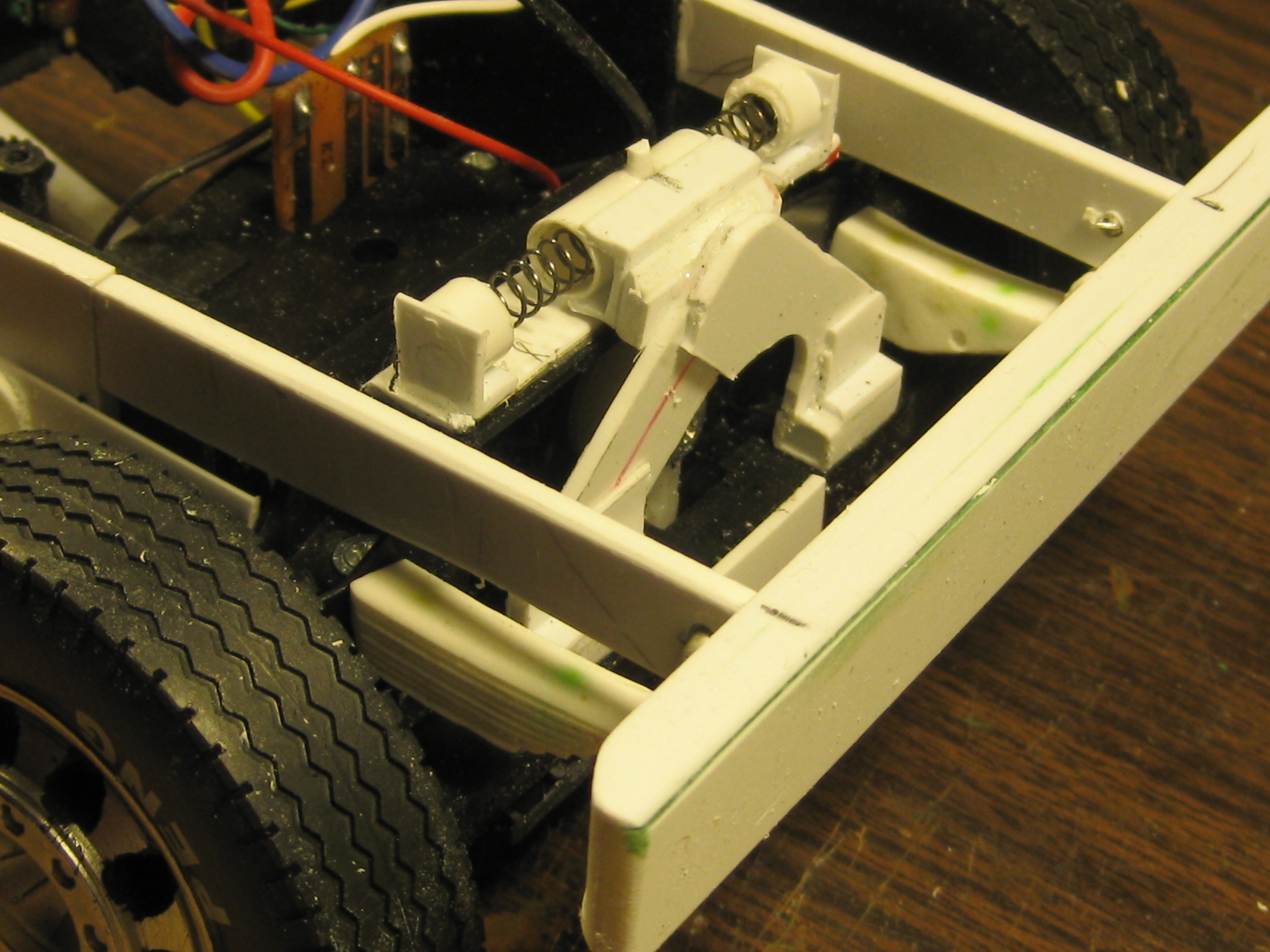

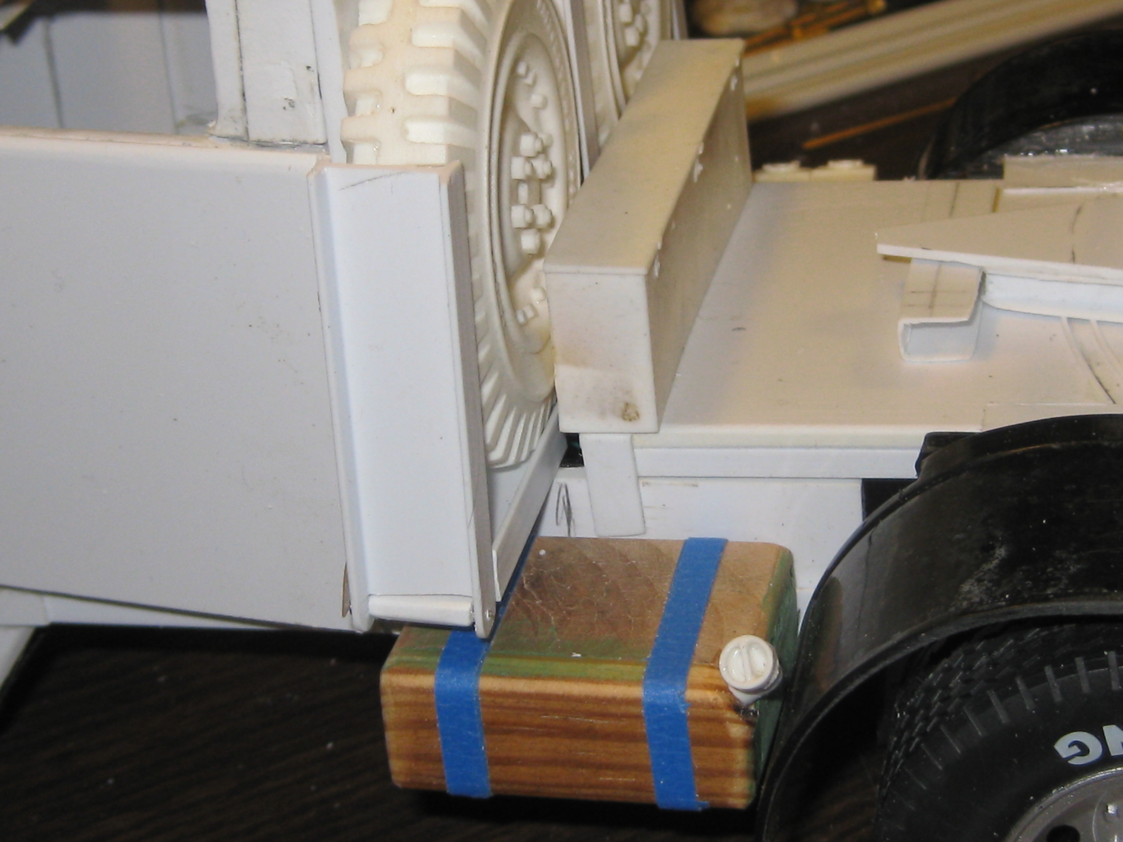

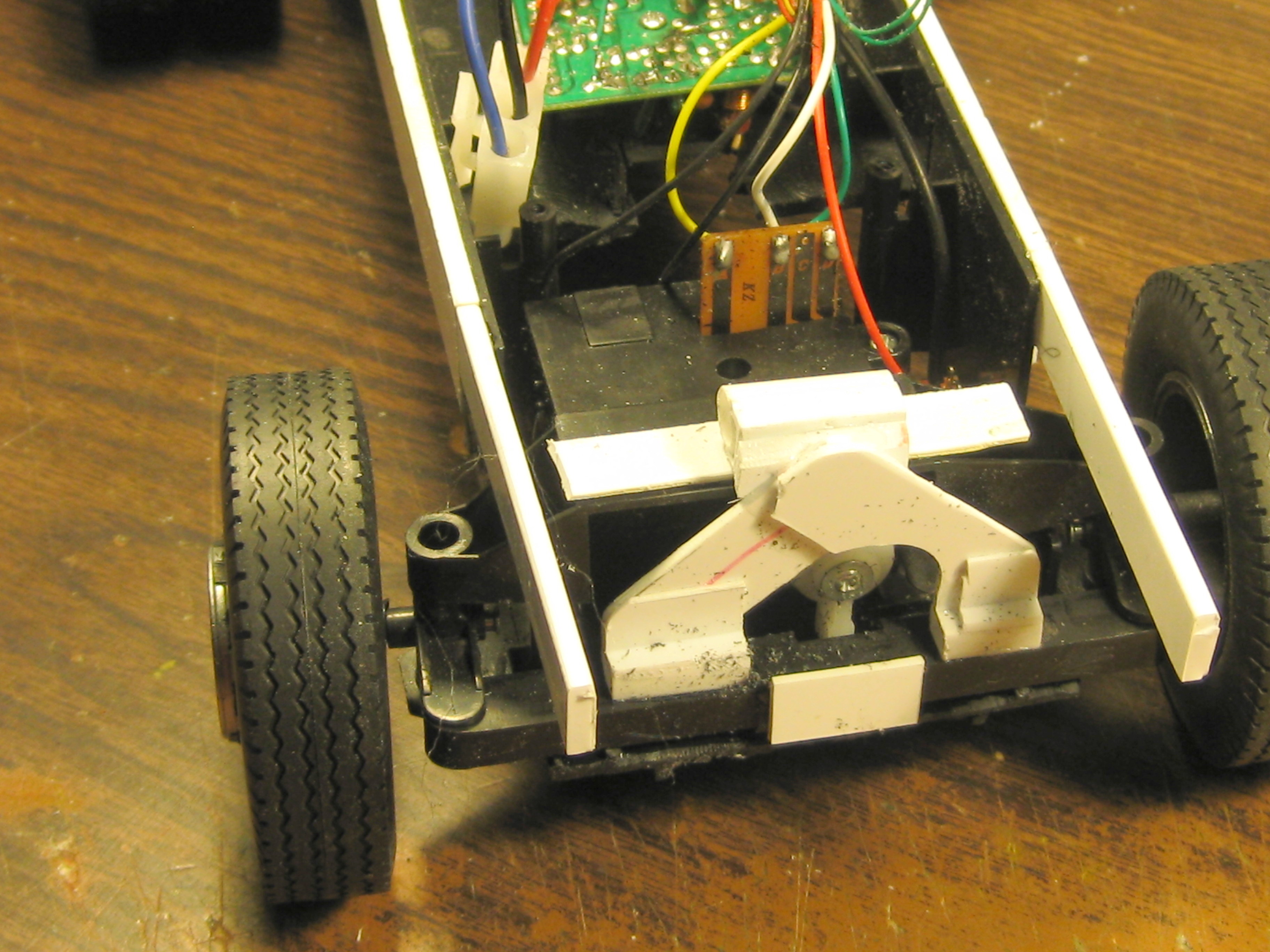

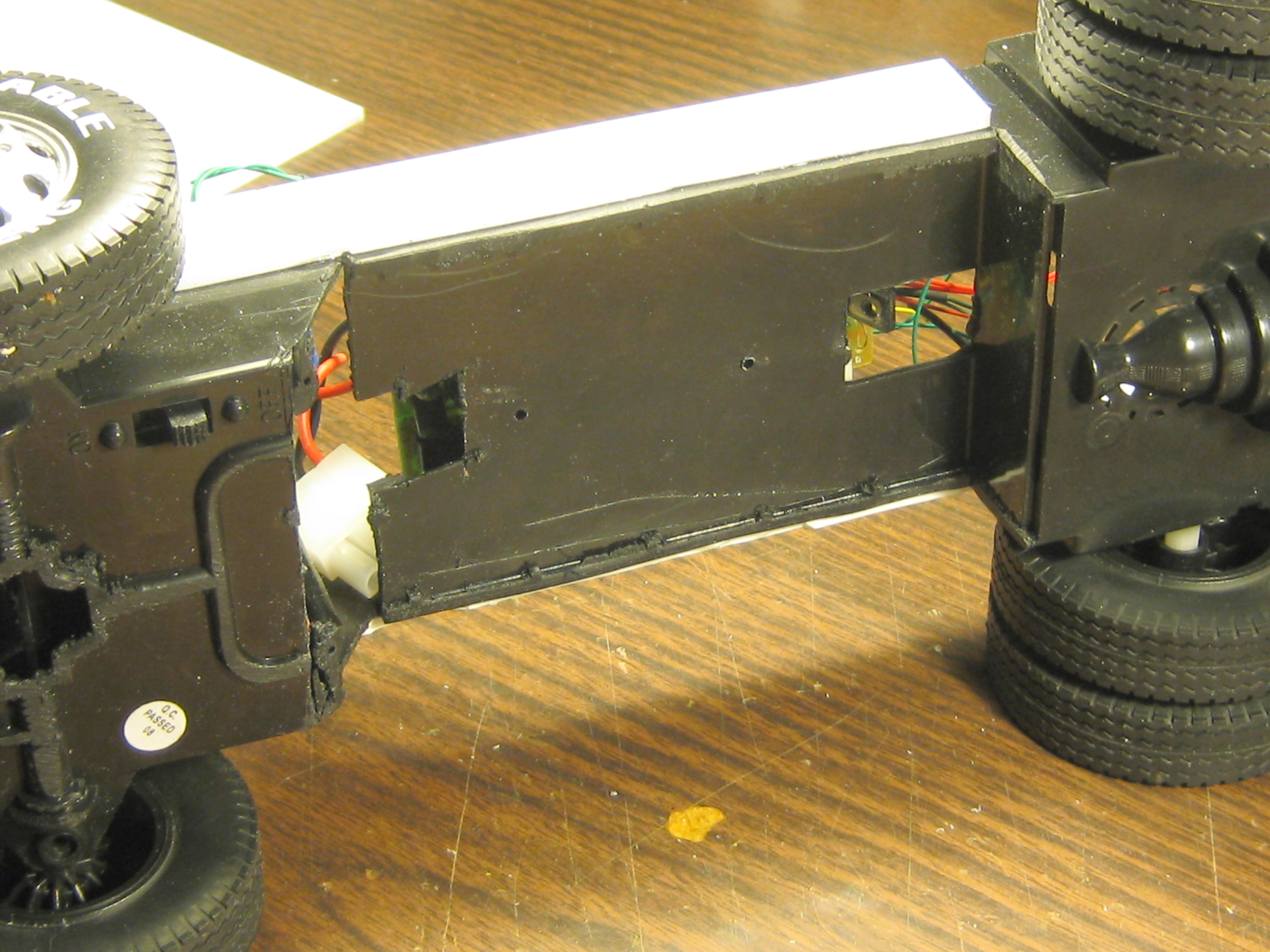

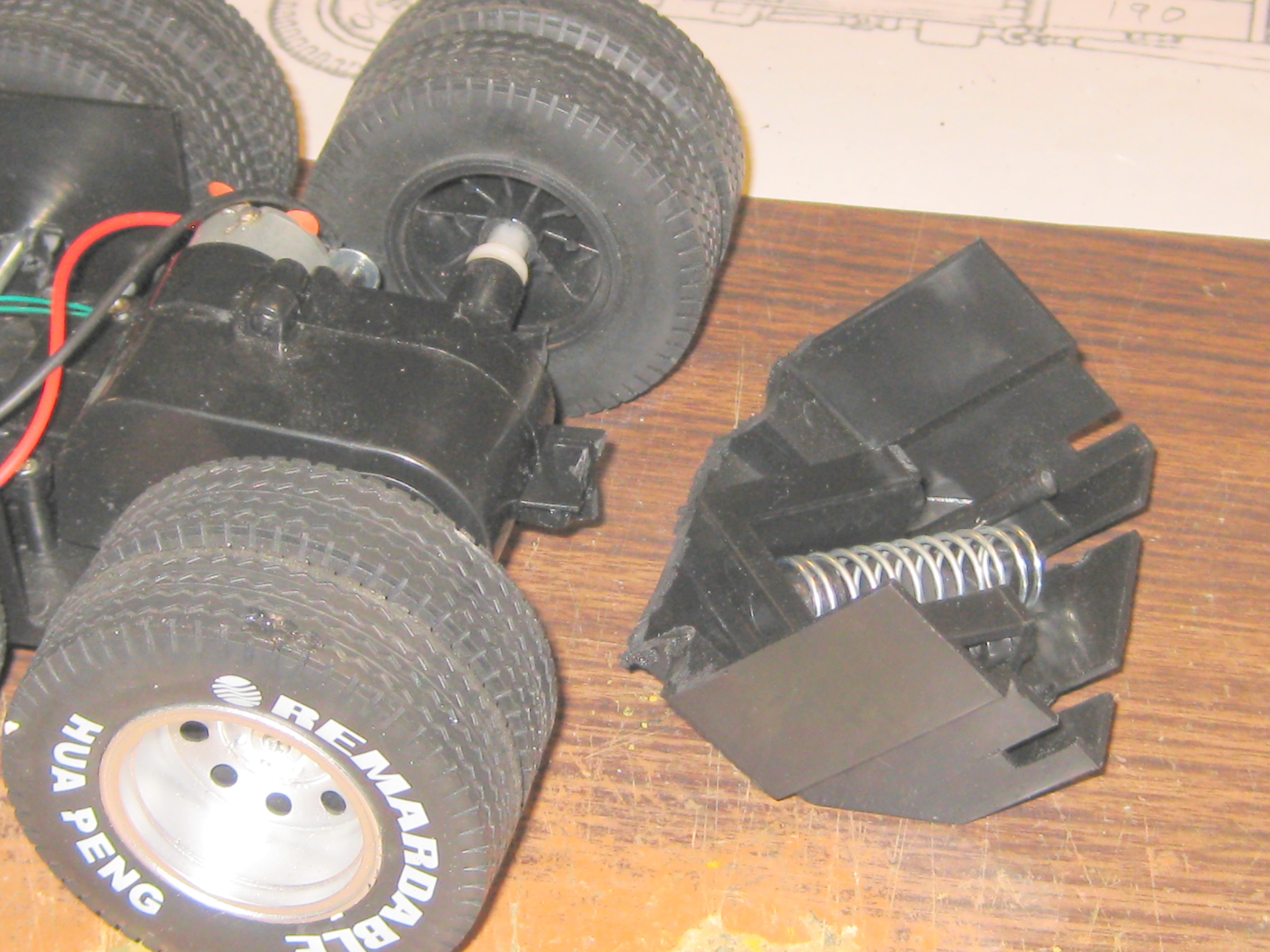

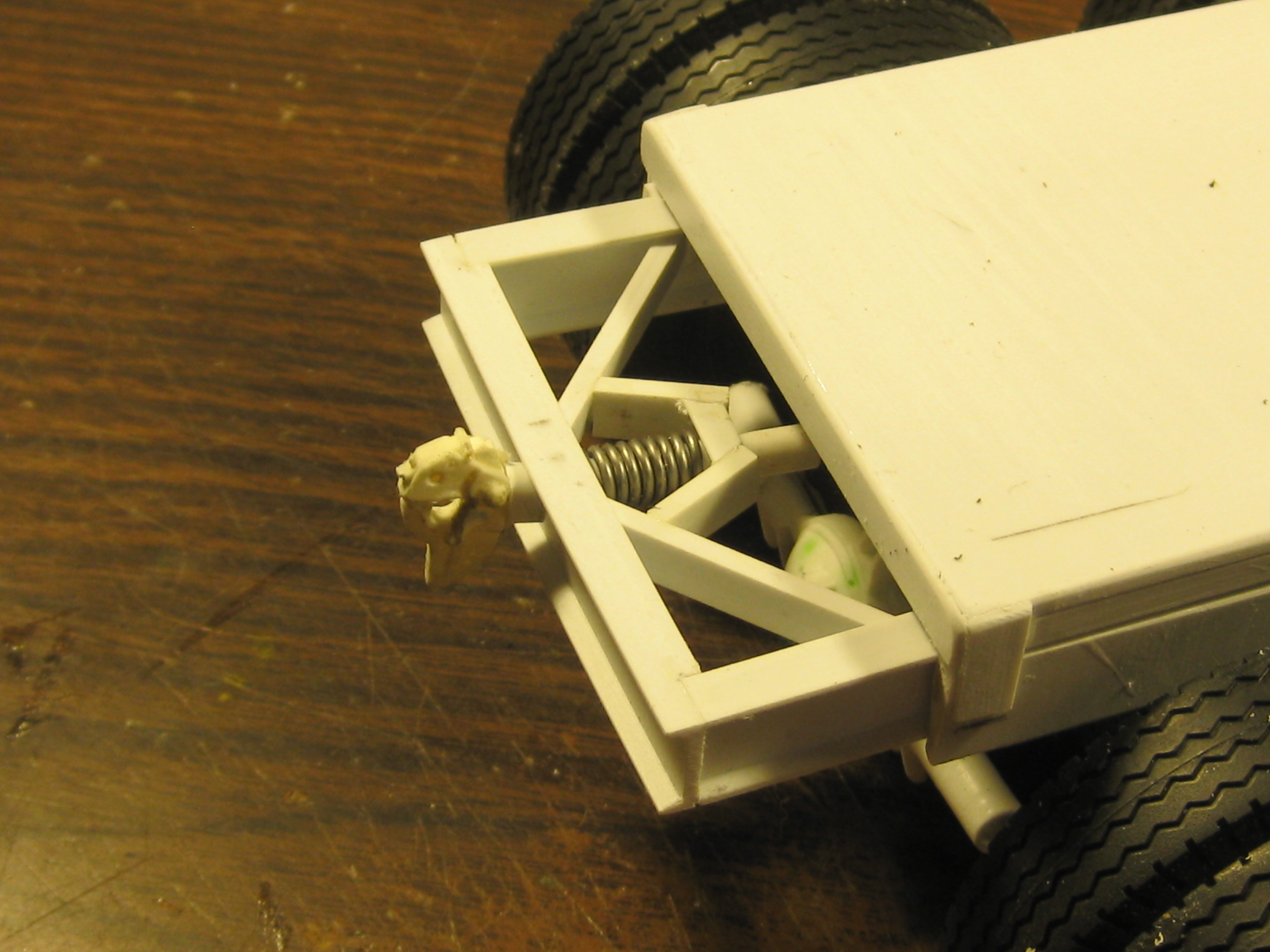

The Way this toy was built required amputation of the front end, which had the centering adjuster for the front wheels, and the rear end which had a spring thing for the suspension. I built a mickey mouse rig to replace the wheel centering thing.
http://www.rcuniverse.com/forum/atta...mentid=1968246 http://www.rcuniverse.com/forum/atta...mentid=1968247http://www.rcuniverse.com/forum/atta...mentid=1968249http://www.rcuniverse.com/forum/atta...mentid=1968250
http://www.rcuniverse.com/forum/atta...mentid=1968260http://www.rcuniverse.com/forum/atta...mentid=1968261
If you have any suggestions about building this thing ..... please speak up ..... I'm open for good ideas.

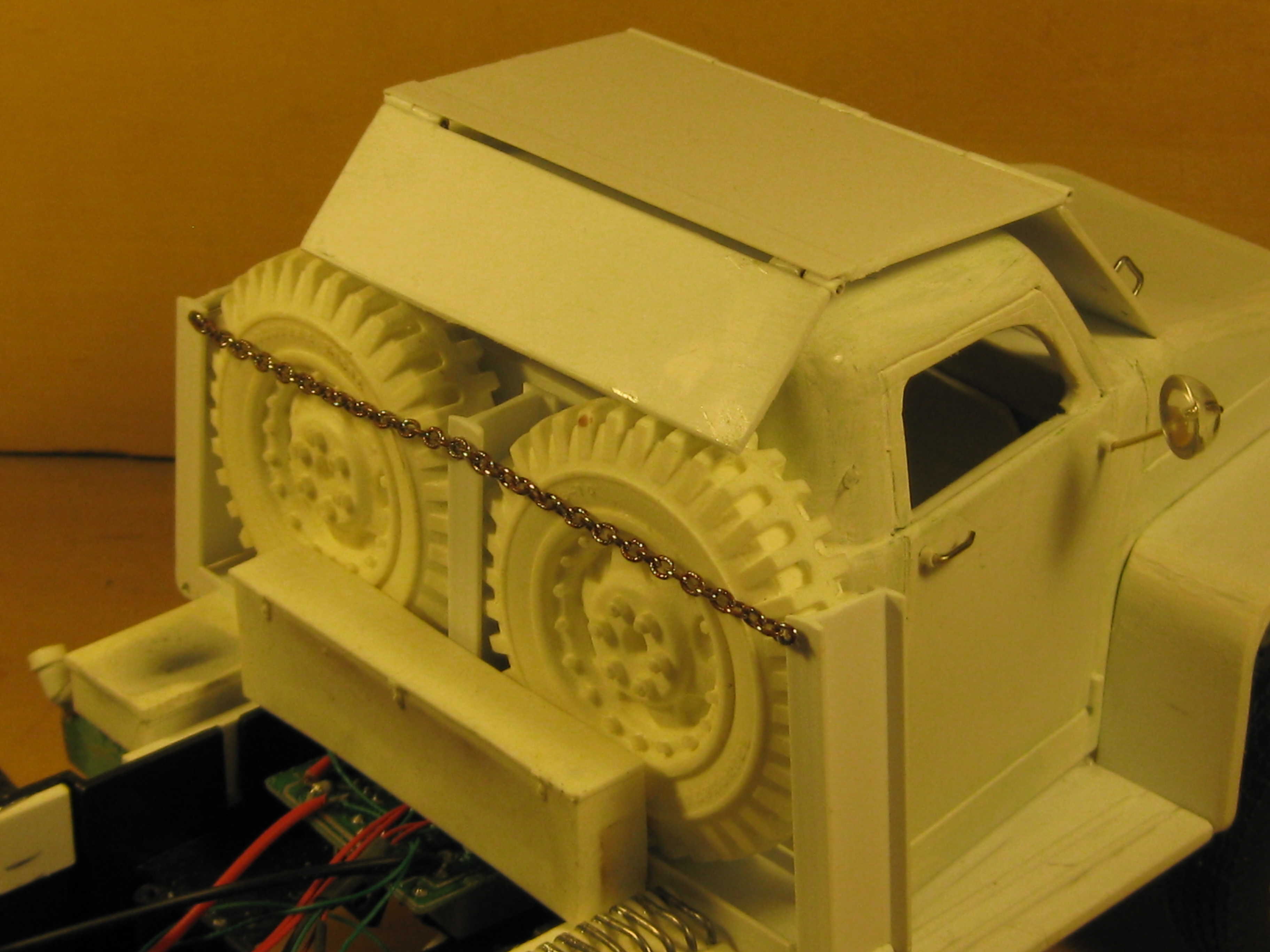

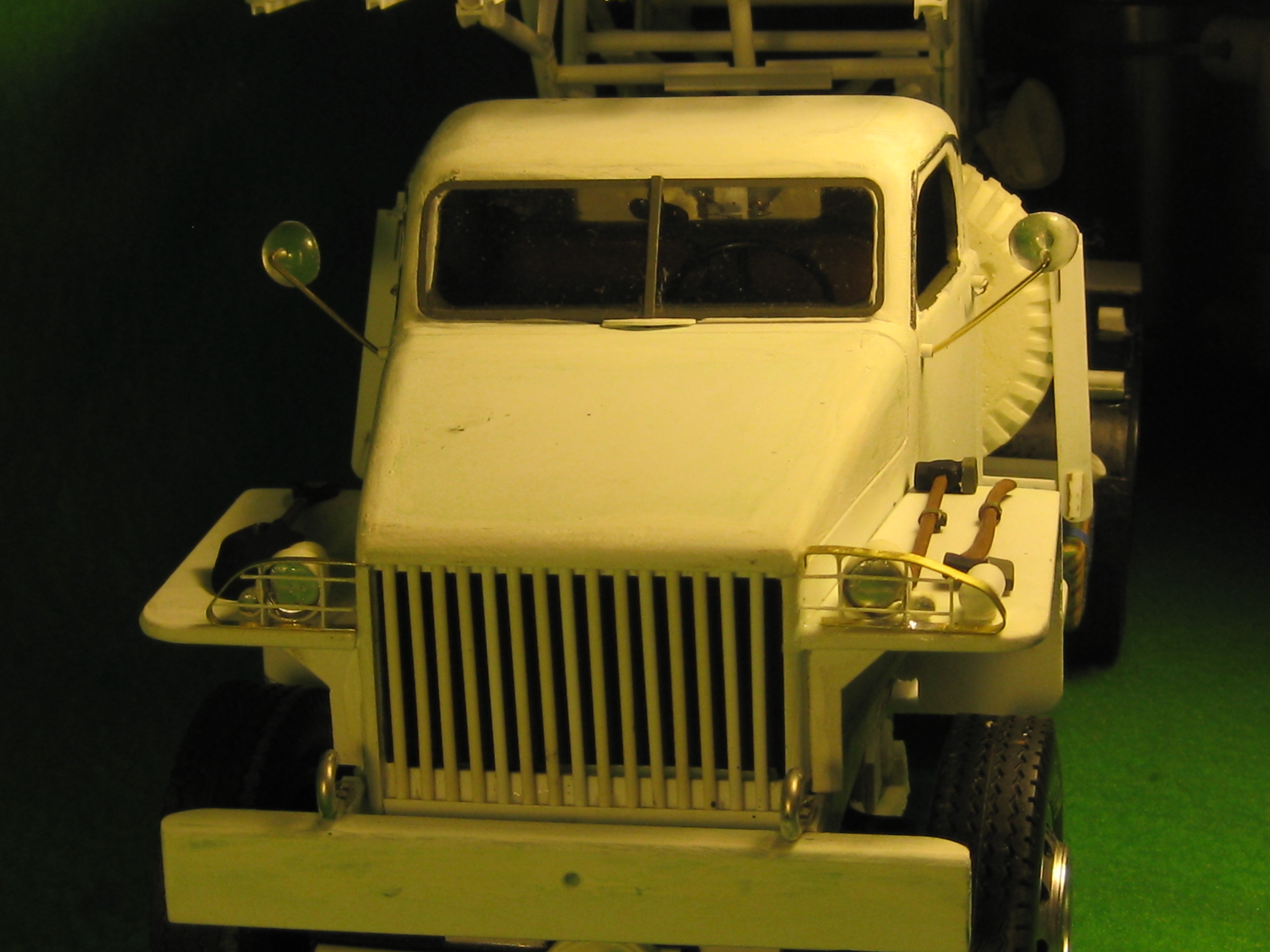

7 Attachment(s)

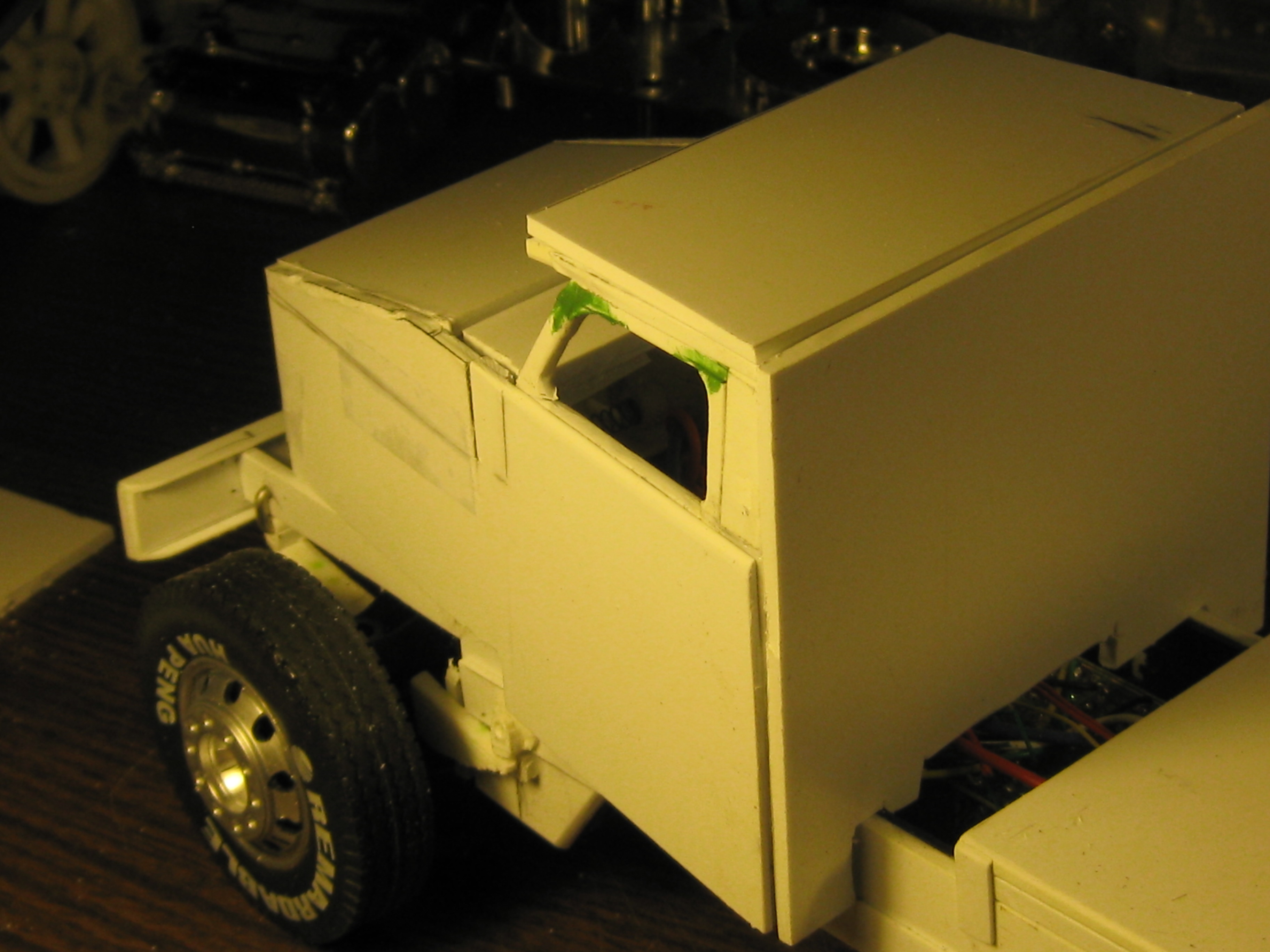

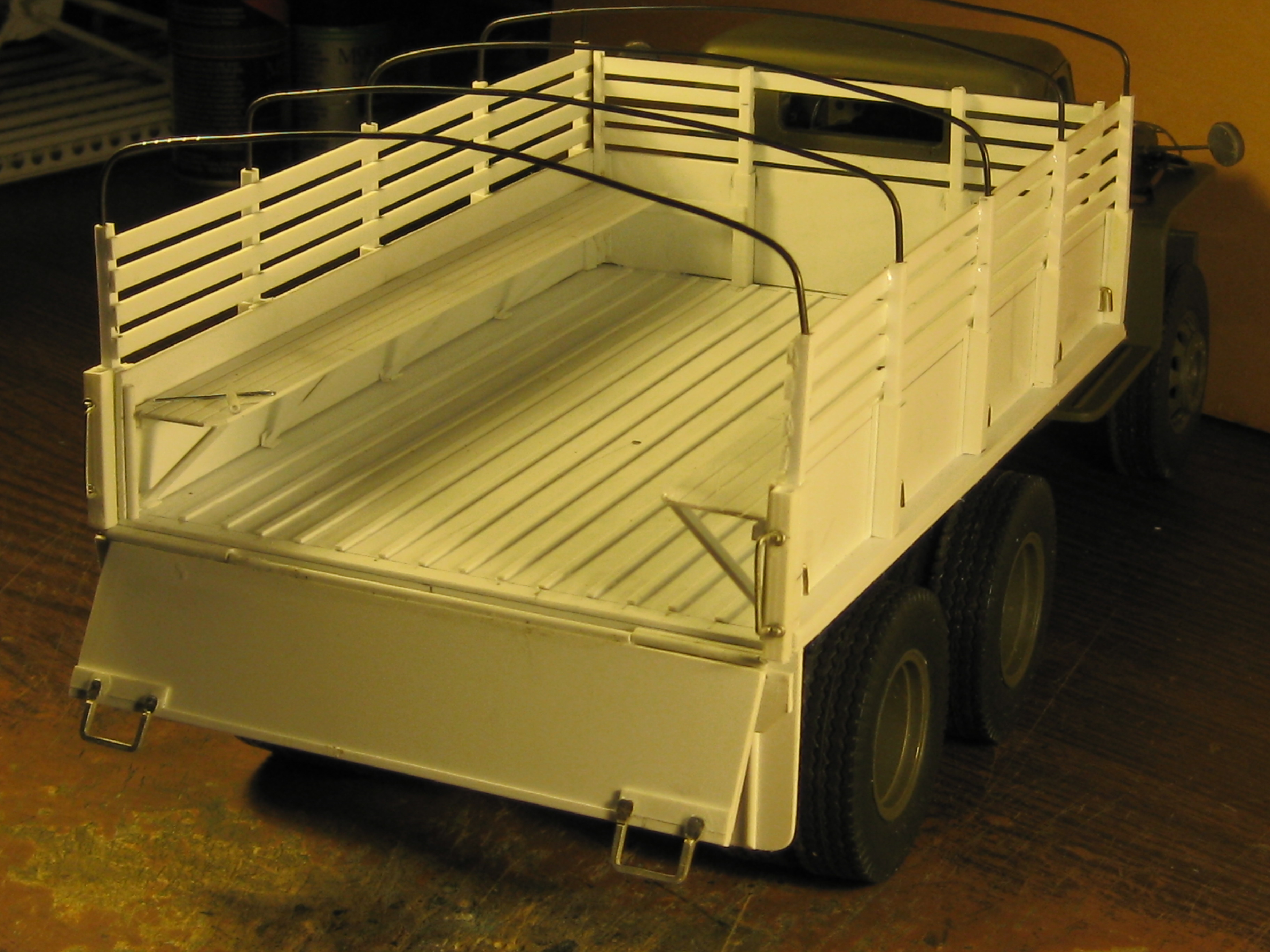

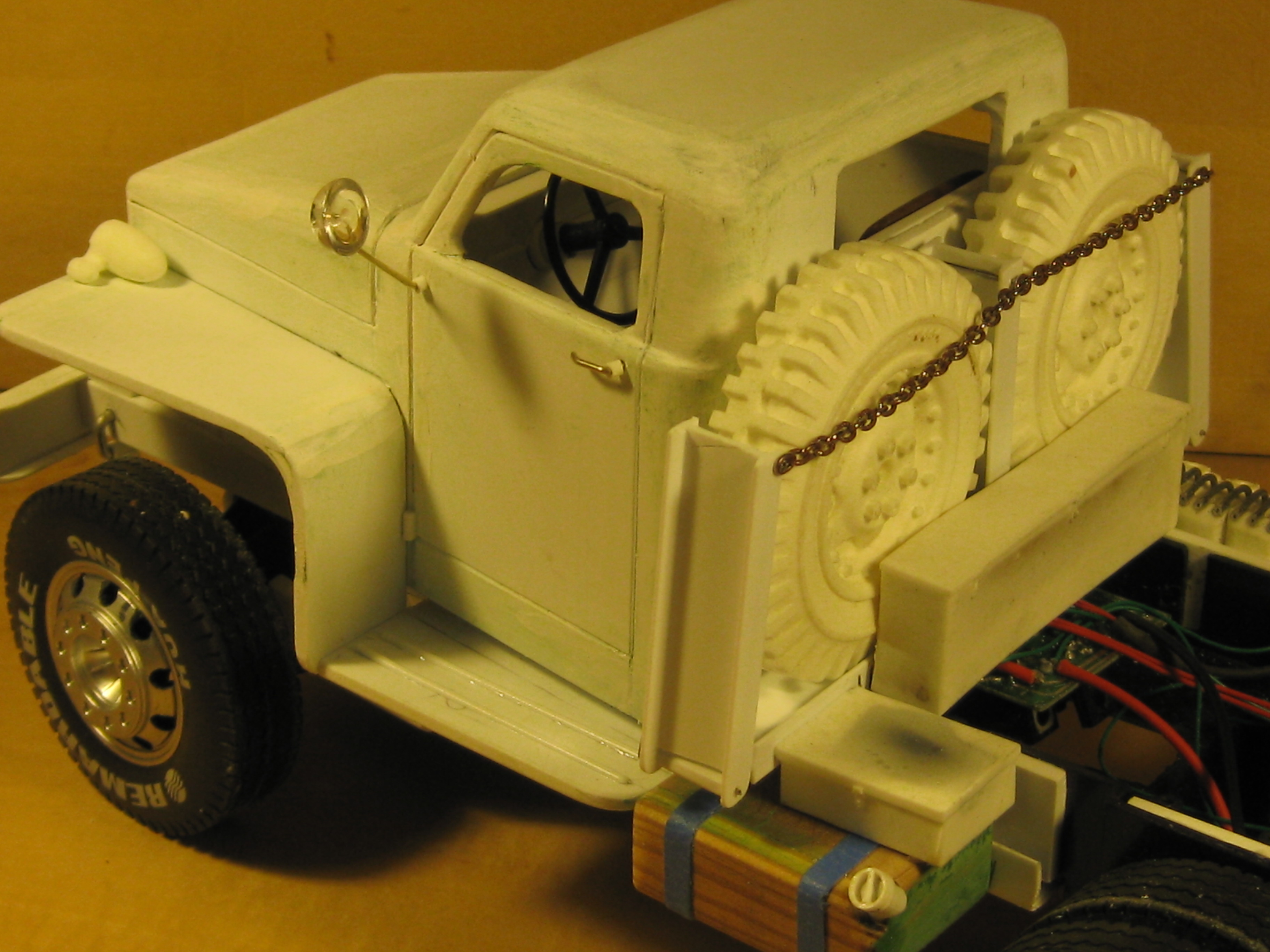

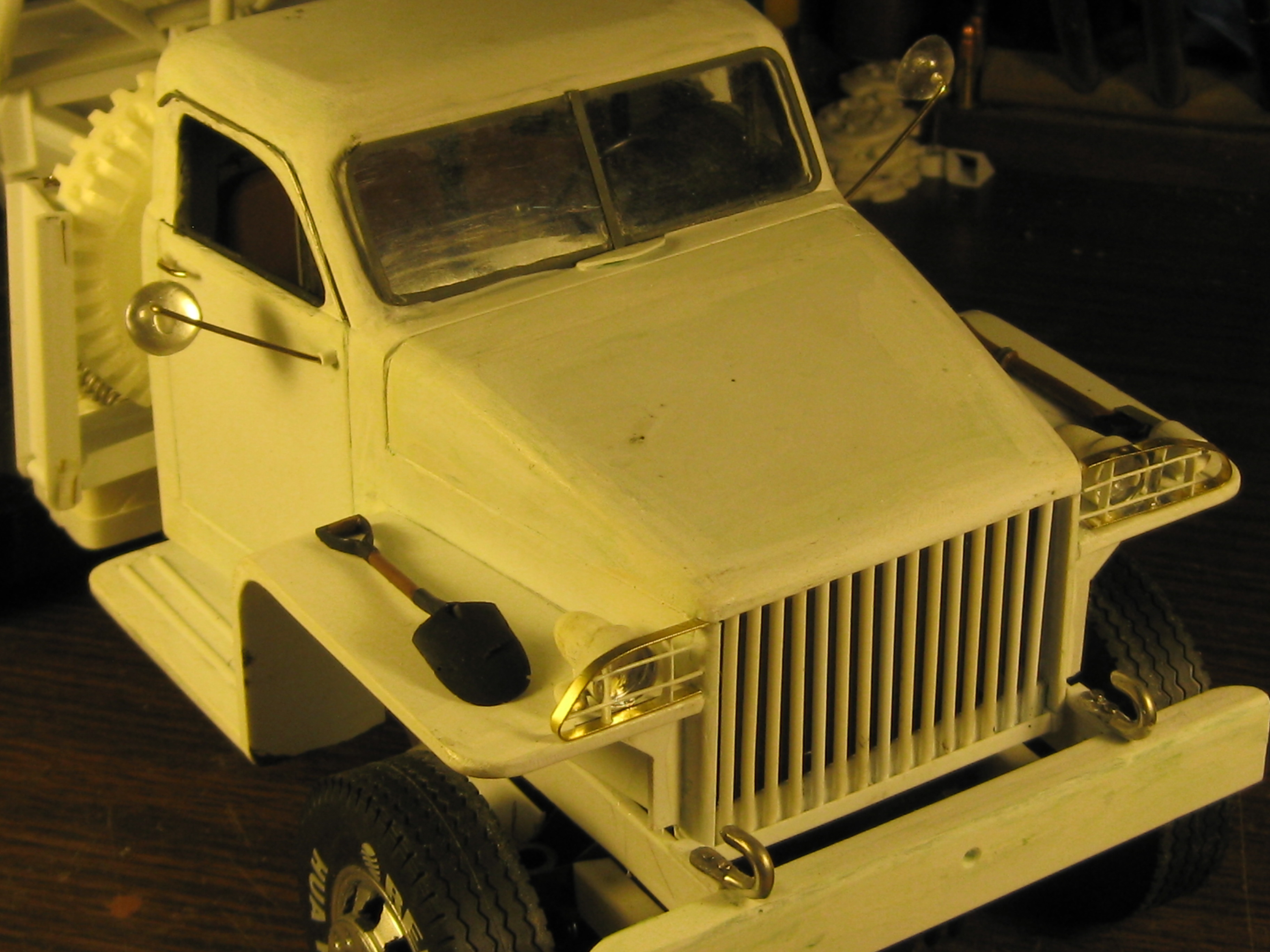

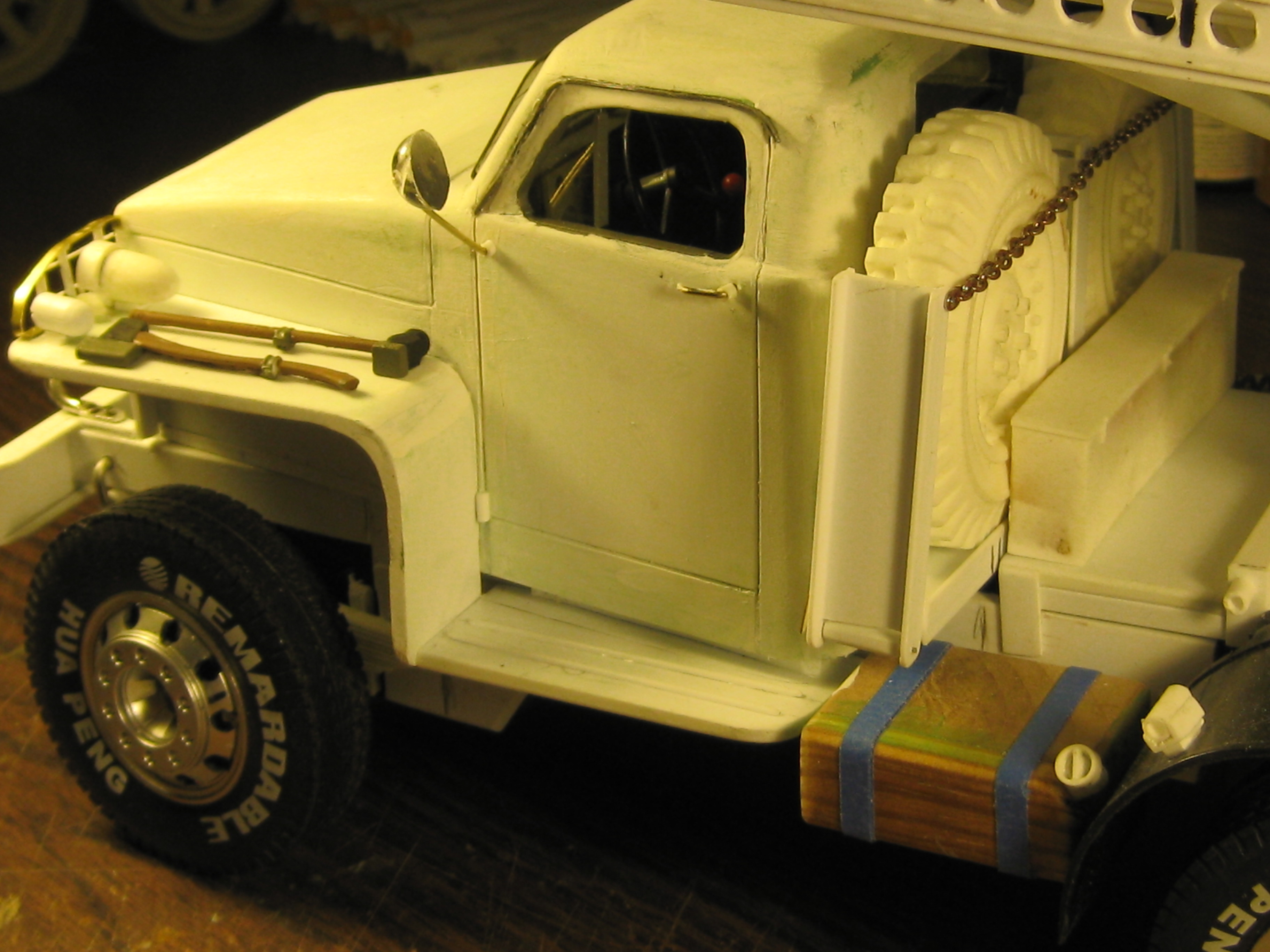

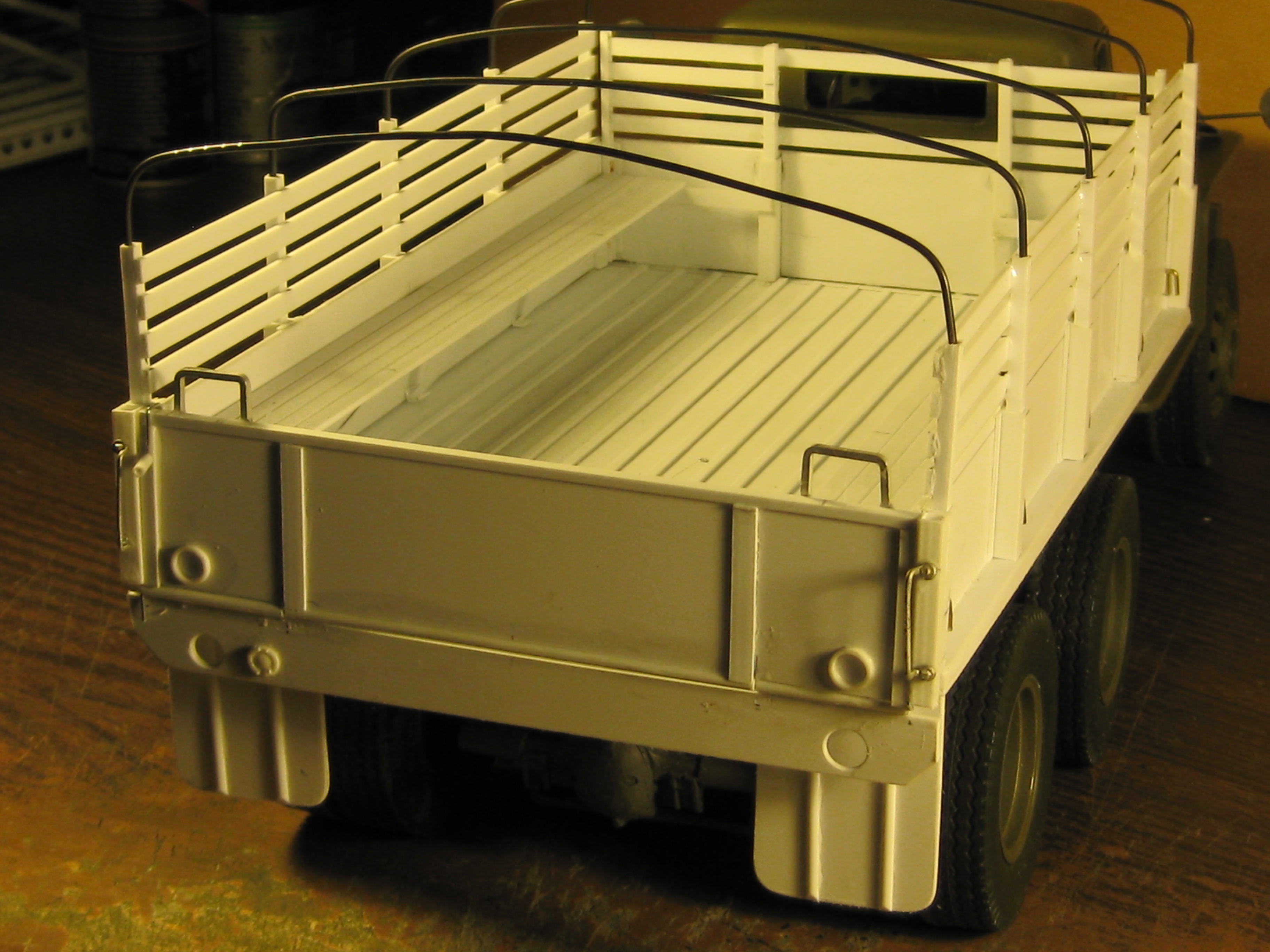

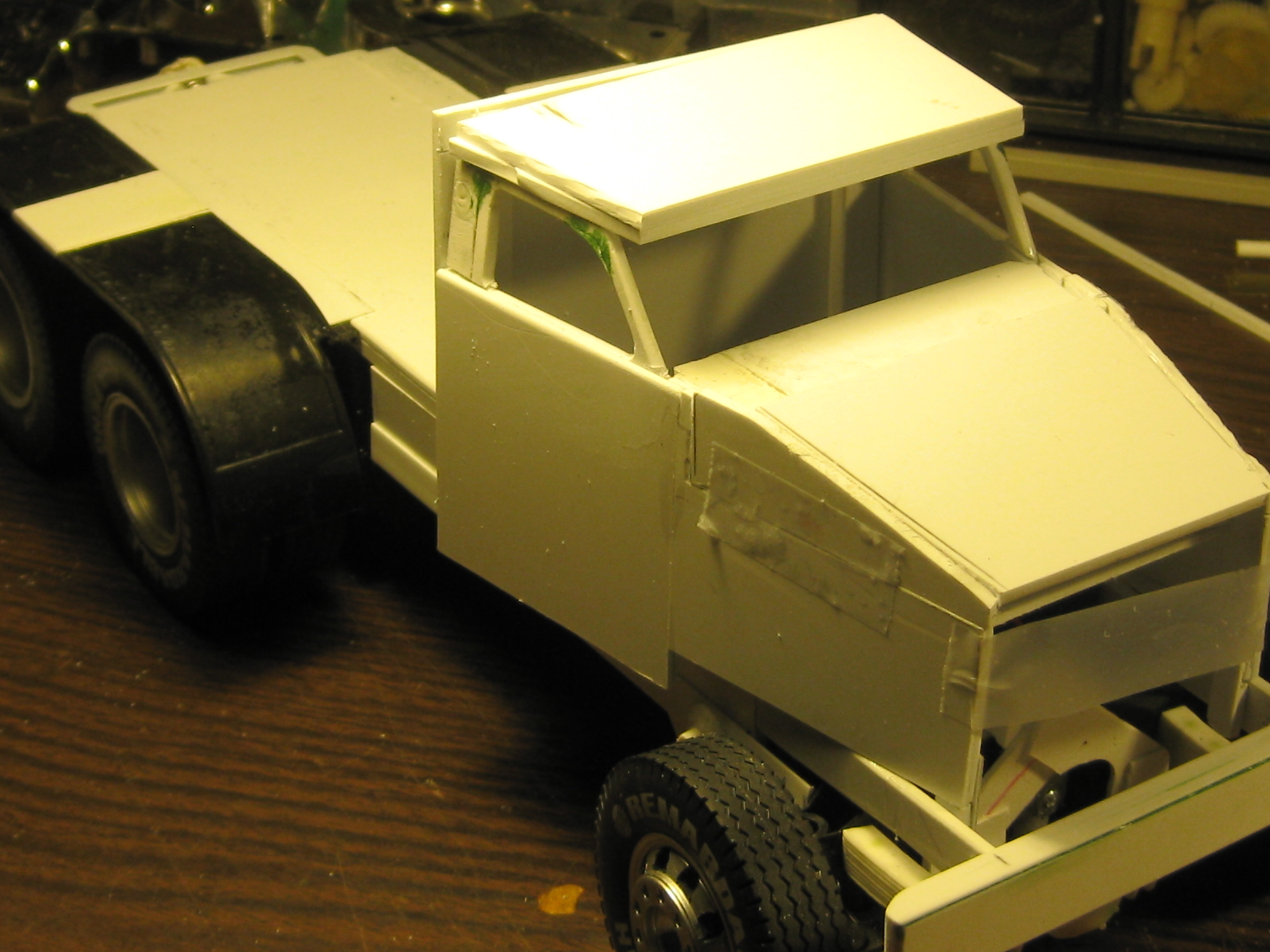

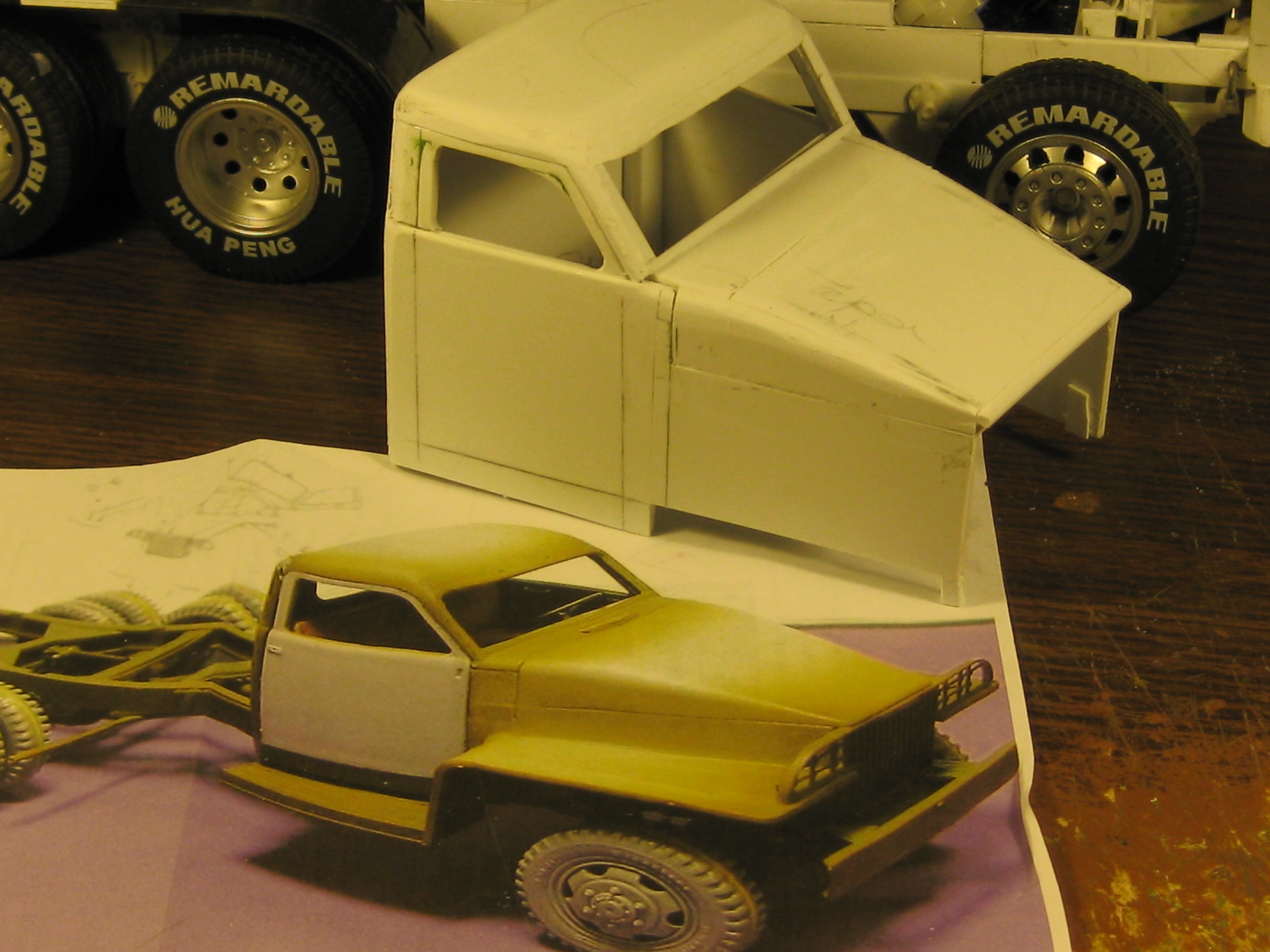

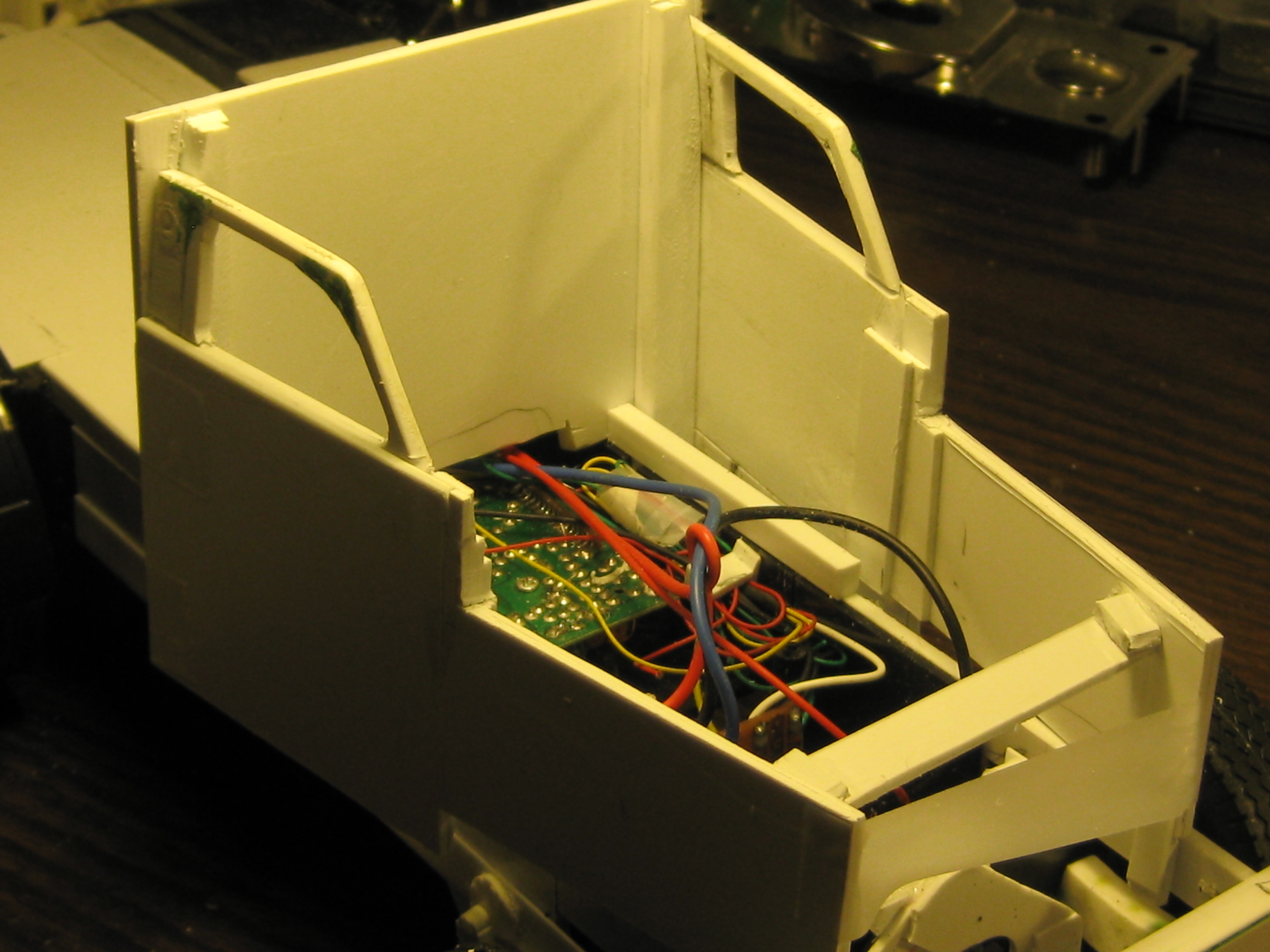

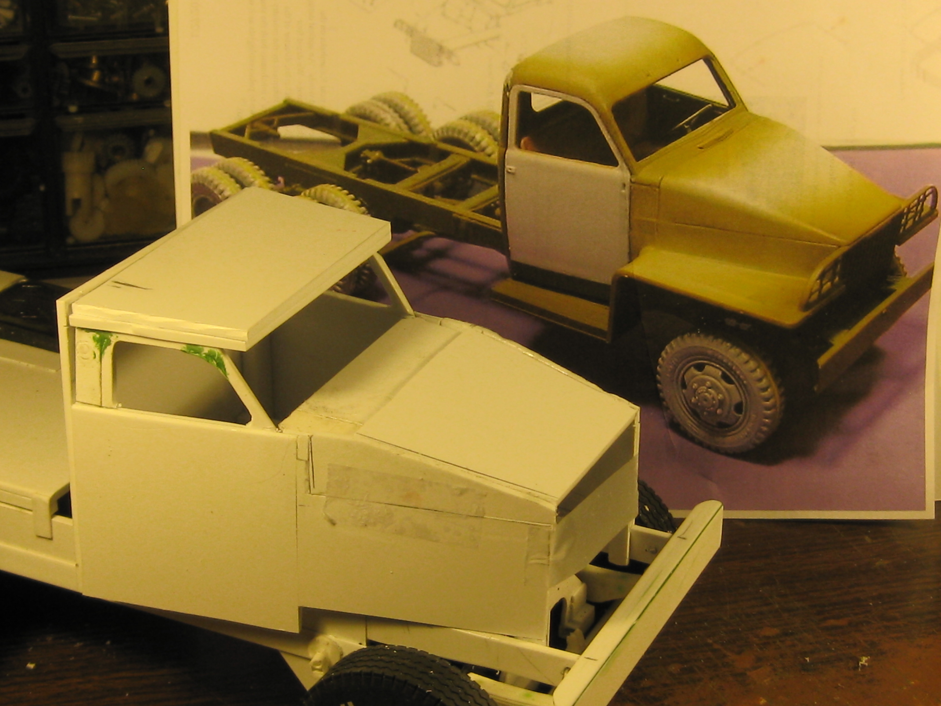

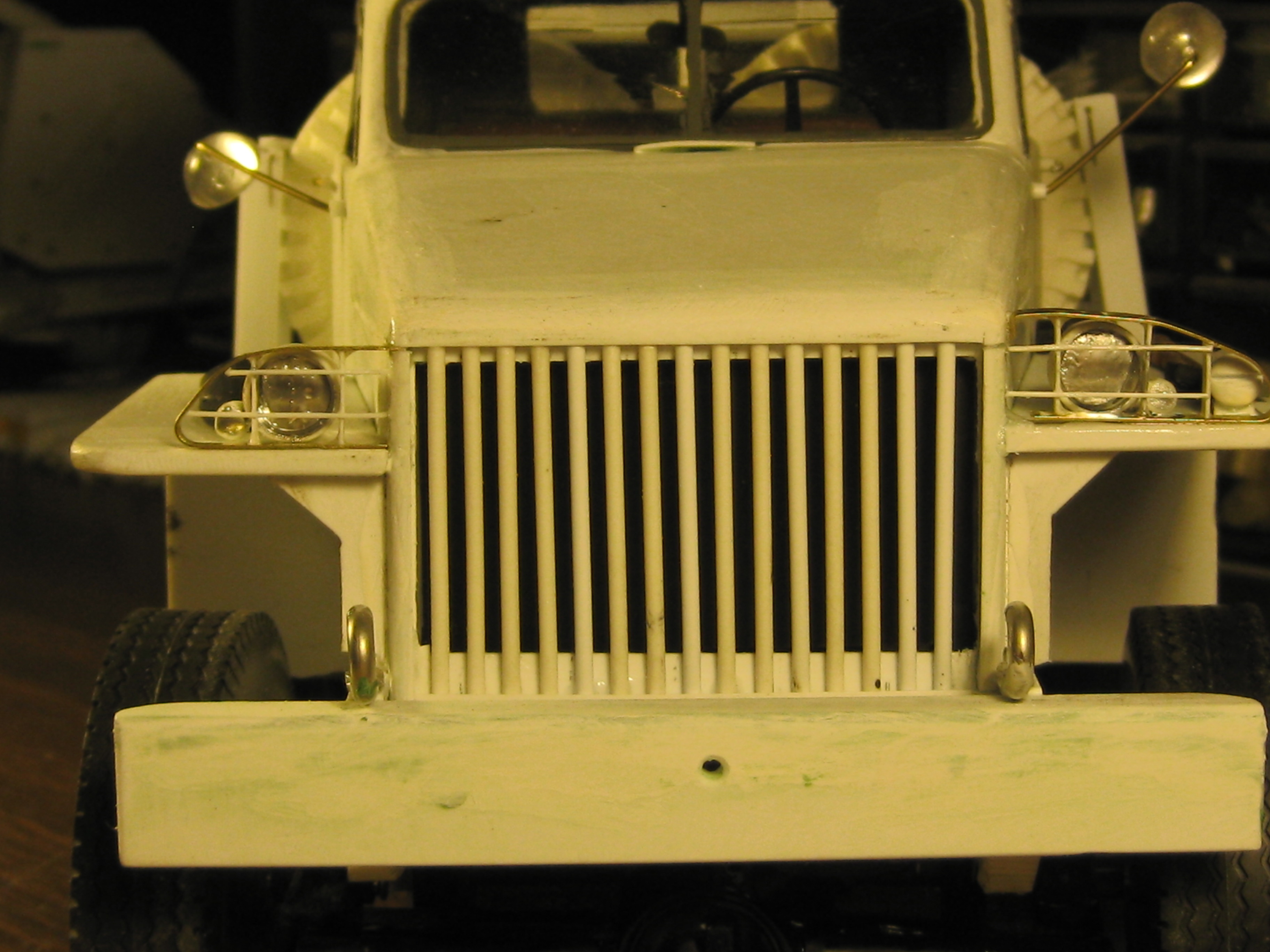

I got a bit more progress done and thought photos of my crude start of a Studebaker US6 cab, and a few other things, was in order. The cab is kinda rough right now but after some hammer and hacksaw adjustments, it should get better eventually. It will take a bunch of cutting, bondo, file work, more bondo and sanding, and then a thick coat of paint should make it look decent (from a distance). Things are working out well so far, and I am beginning to think about all of the different kinds of load beds that were put on this truck in WWII. I am building the bed to be interchangeable with other types of load beds besides the Russian rocket launcher "Stalin's organ"
.http://www.rcuniverse.com/forum/atta...mentid=1968797http://www.rcuniverse.com/forum/atta...mentid=1968798http://www.rcuniverse.com/forum/atta...mentid=1968799http://www.rcuniverse.com/forum/atta...mentid=1968802http://www.rcuniverse.com/forum/atta...mentid=1968805http://www.rcuniverse.com/forum/atta...mentid=1968806http://www.rcuniverse.com/forum/atta...mentid=1968807

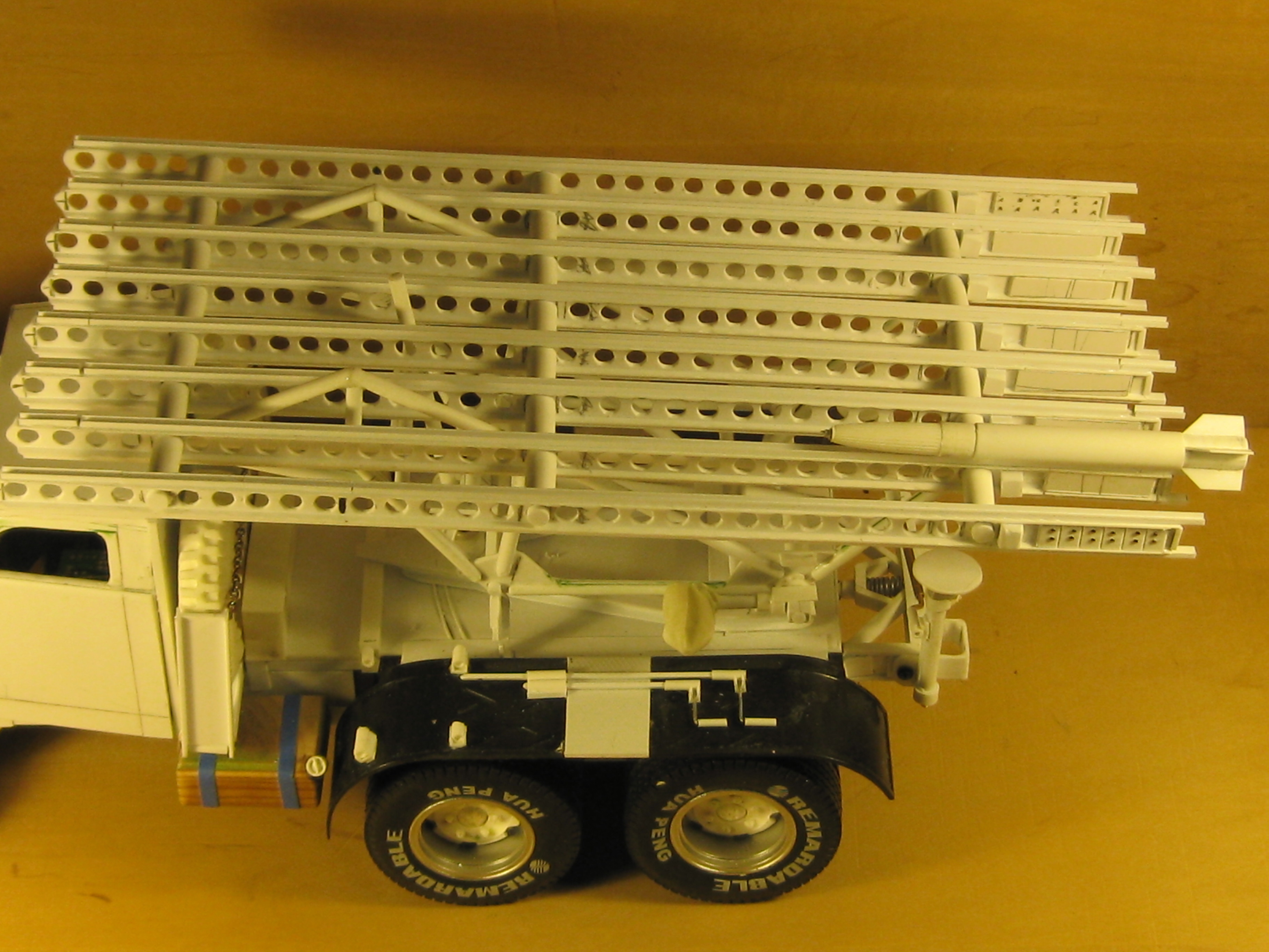

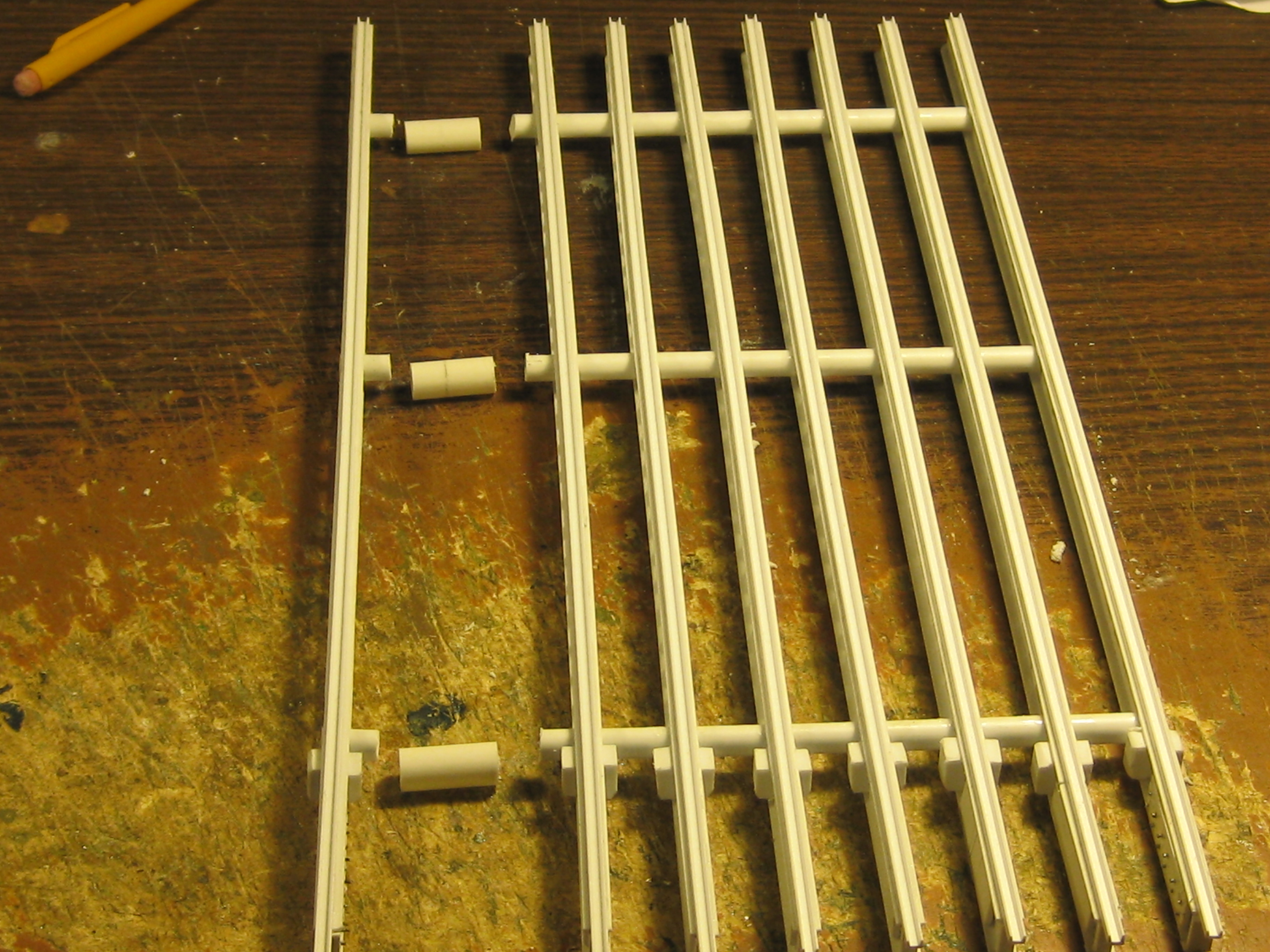

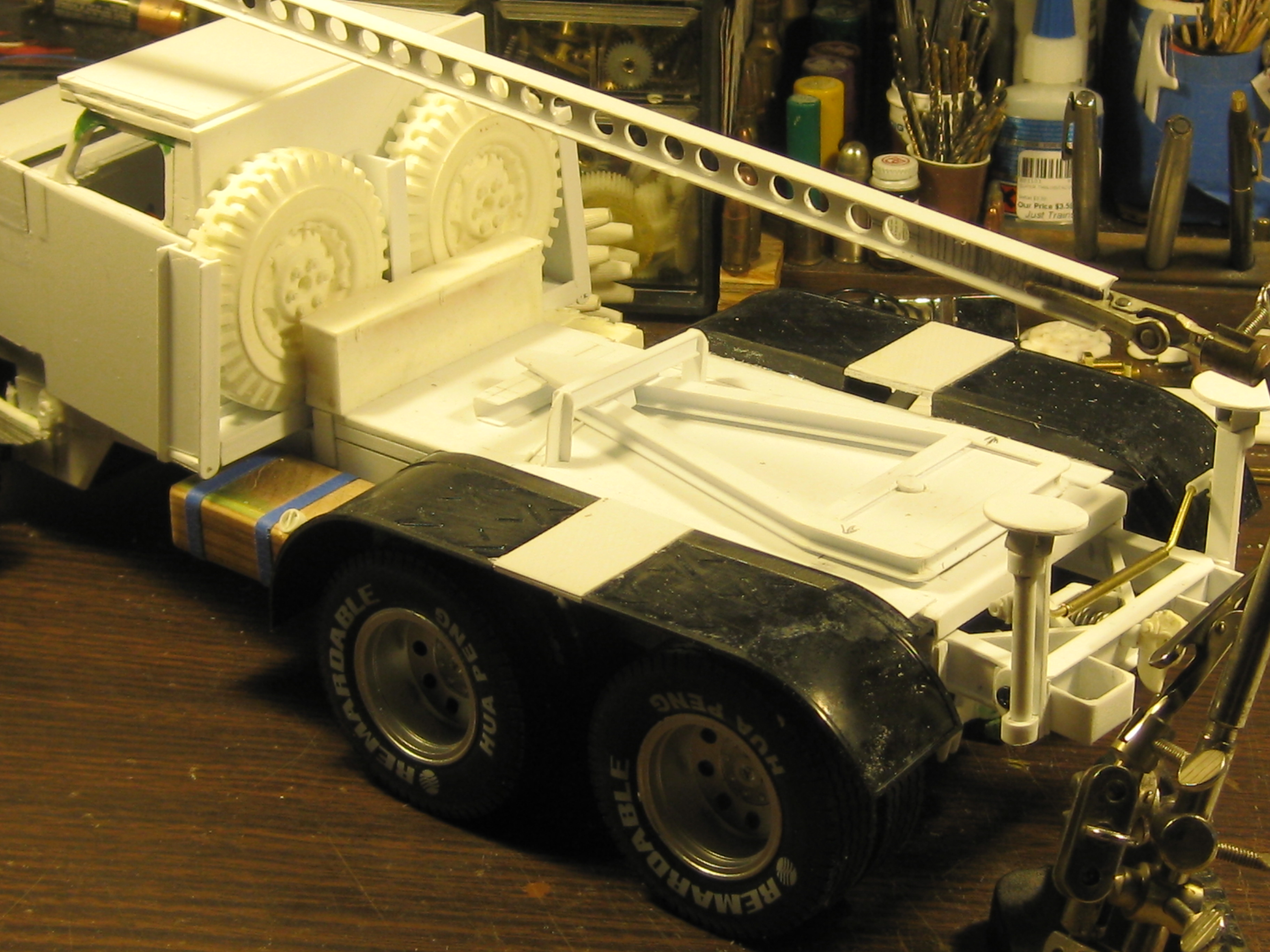

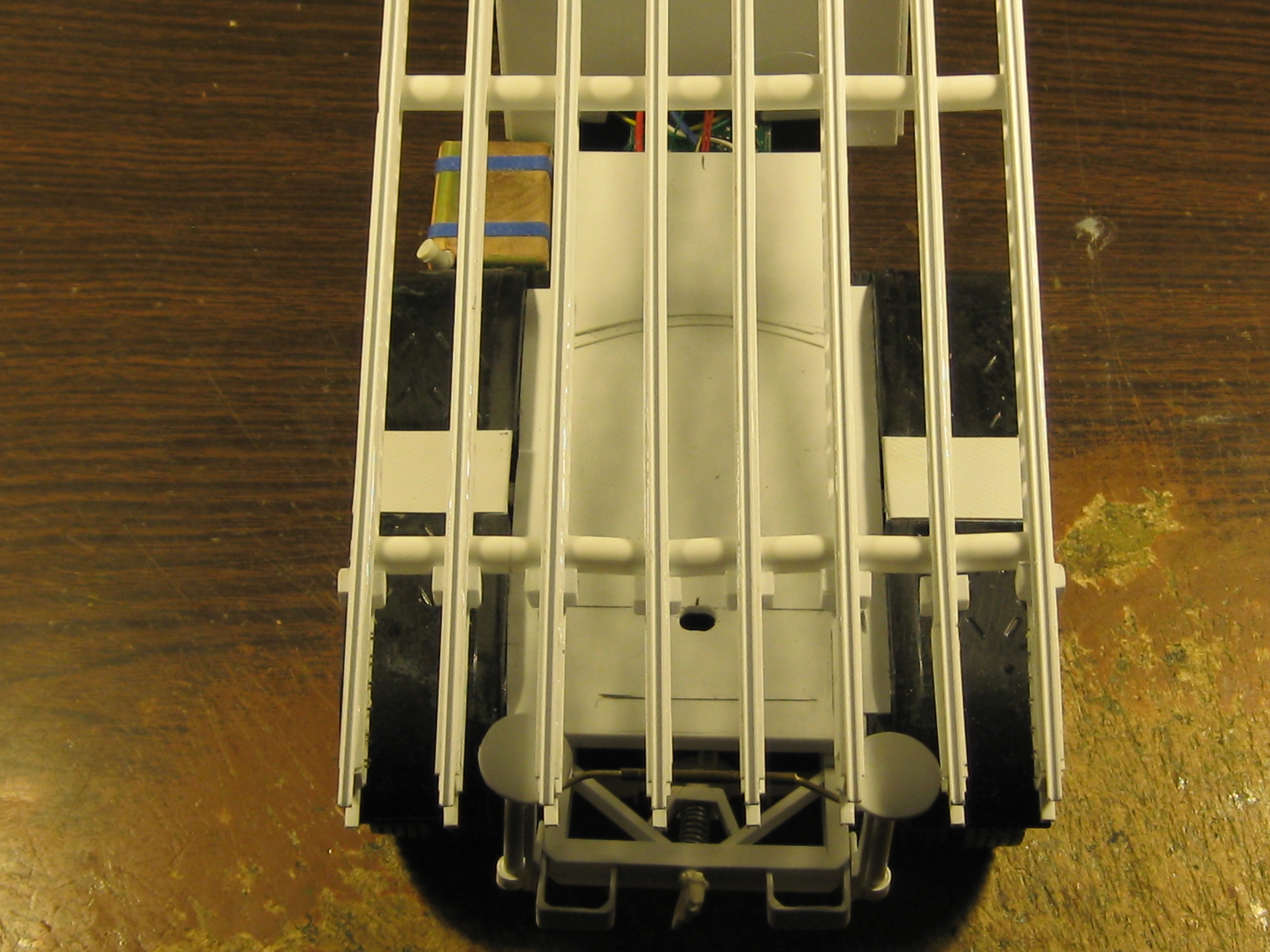

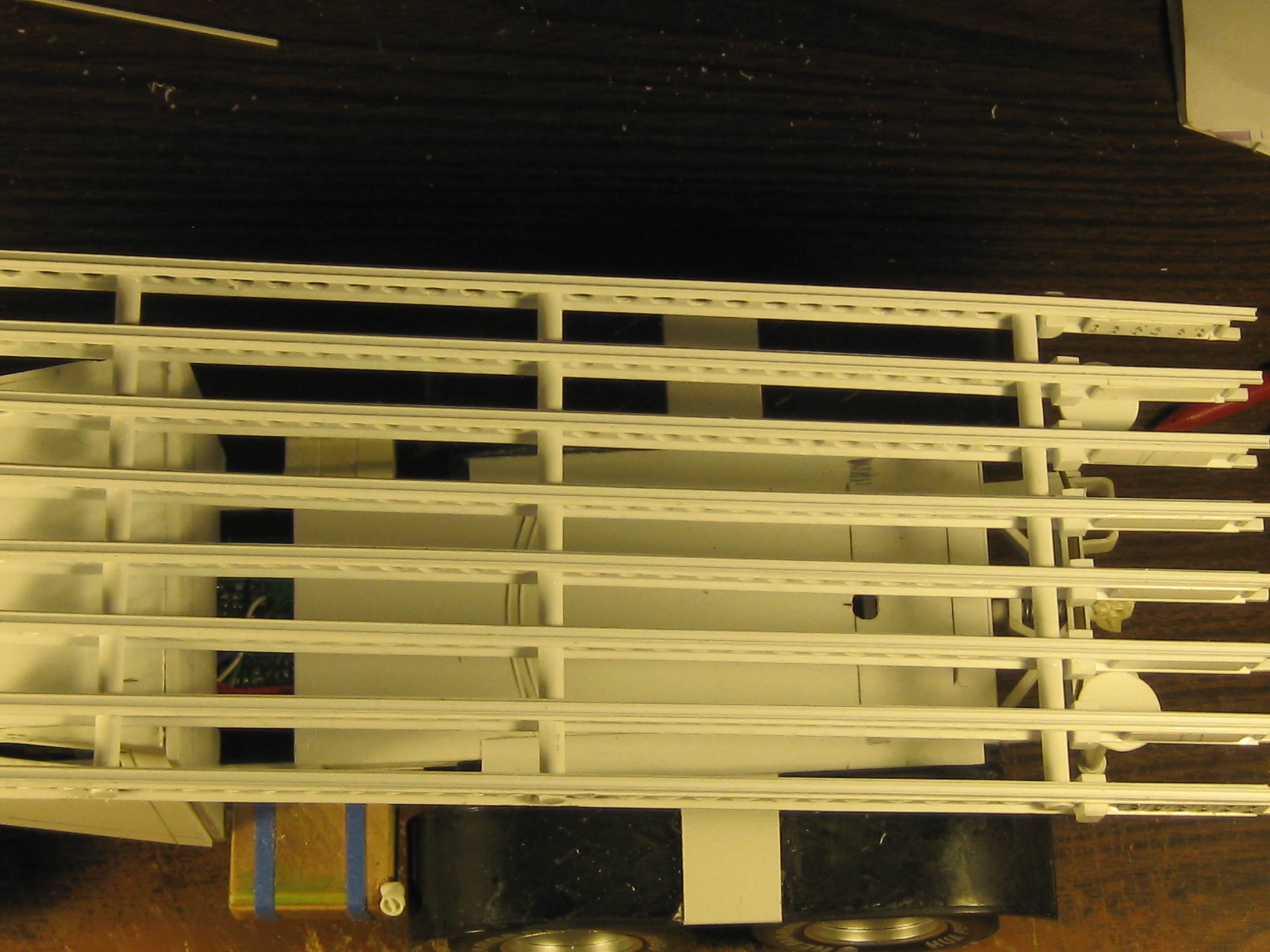

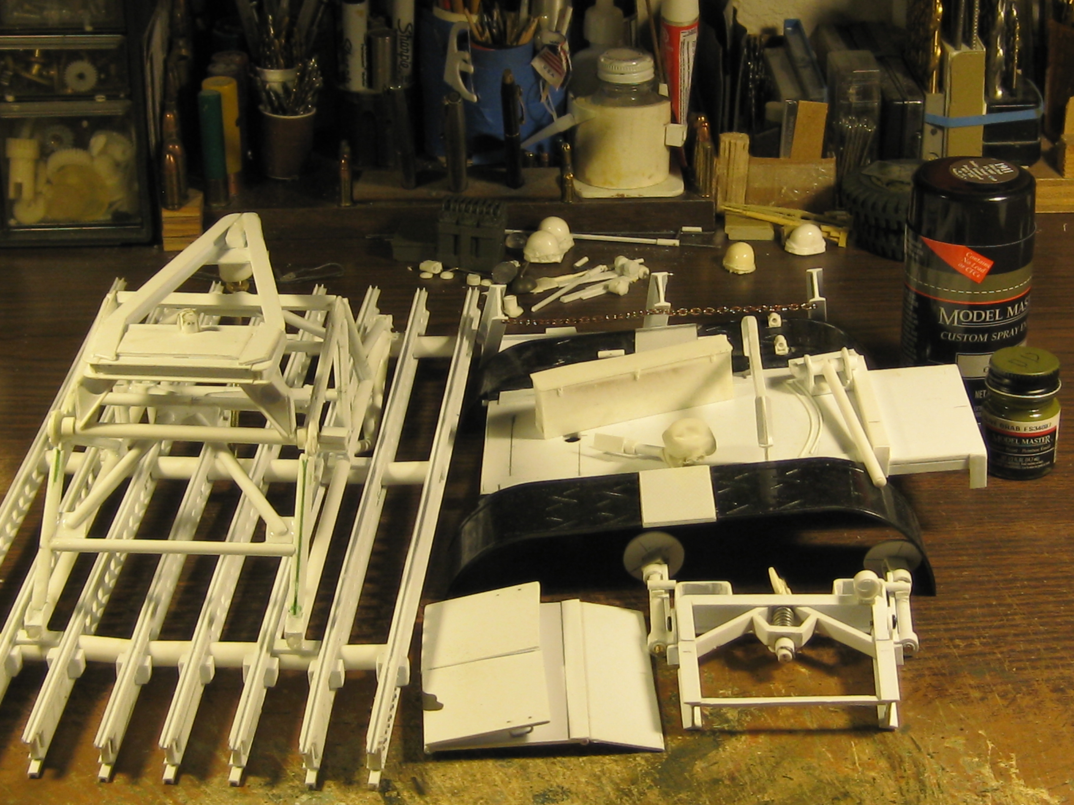

I decided to take a break from doing the cab and do some work on the bed for the rocket rack. Not bad so far but the rocket rails and support rack for the rails are gonna be a pain. I think I have a plan for rigging up a fixture that will allow me to stack and clamp 2 or 3 beams on top of one another and drill all of those holes in my drill press. Drilling them one at a time on each styrene beam is out of the question.
http://www.rcuniverse.com/forum/atta...mentid=1970142http://www.rcuniverse.com/forum/atta...mentid=1970144http://www.rcuniverse.com/forum/atta...mentid=1970145http://www.rcuniverse.com/forum/atta...mentid=1970146
Only 7 more rails and the tubular support frame to go .............. I'm getting a headache .............
http://www.rcuniverse.com/forum/atta...mentid=1970148http://www.rcuniverse.com/forum/atta...mentid=1970149

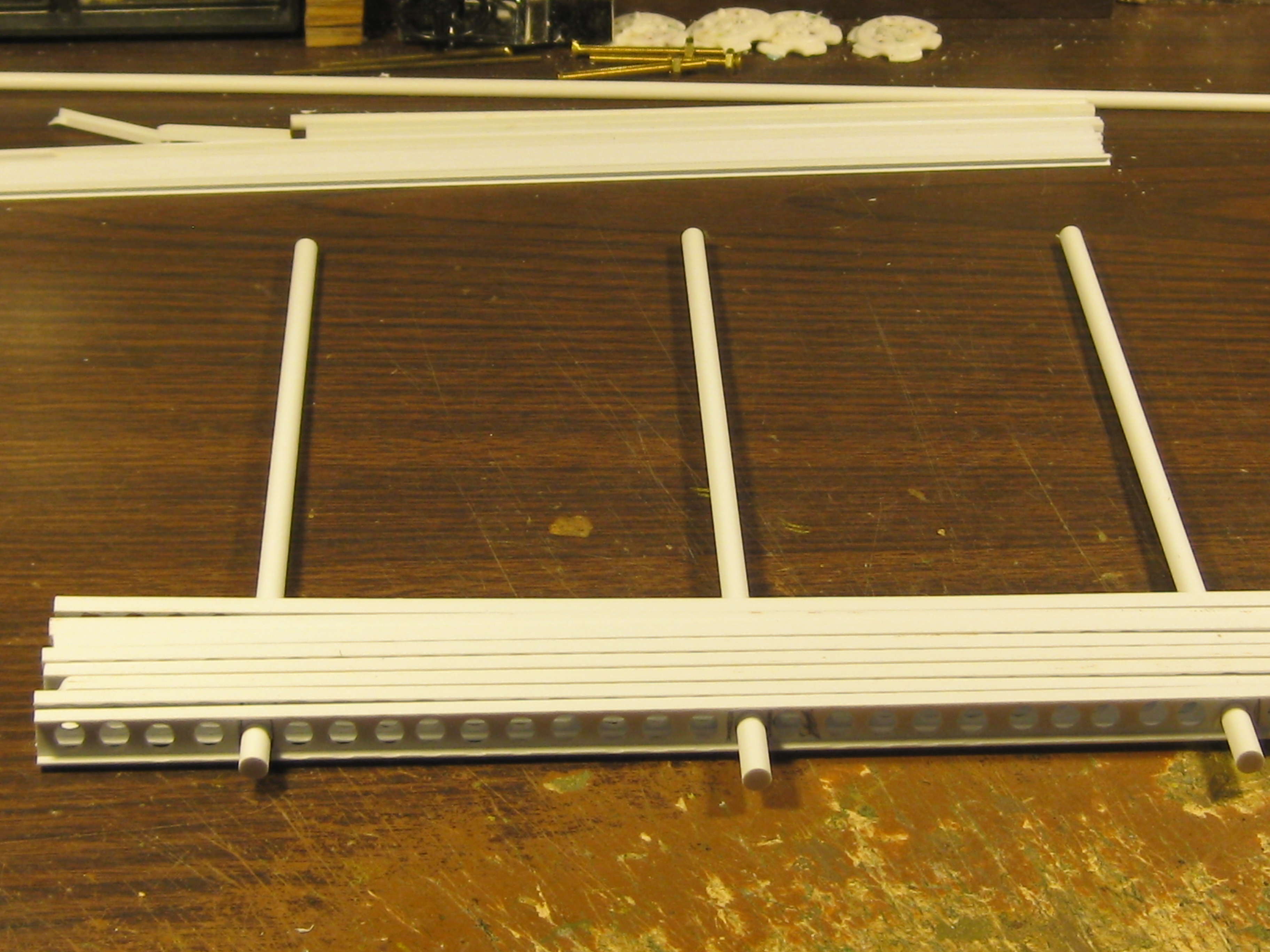

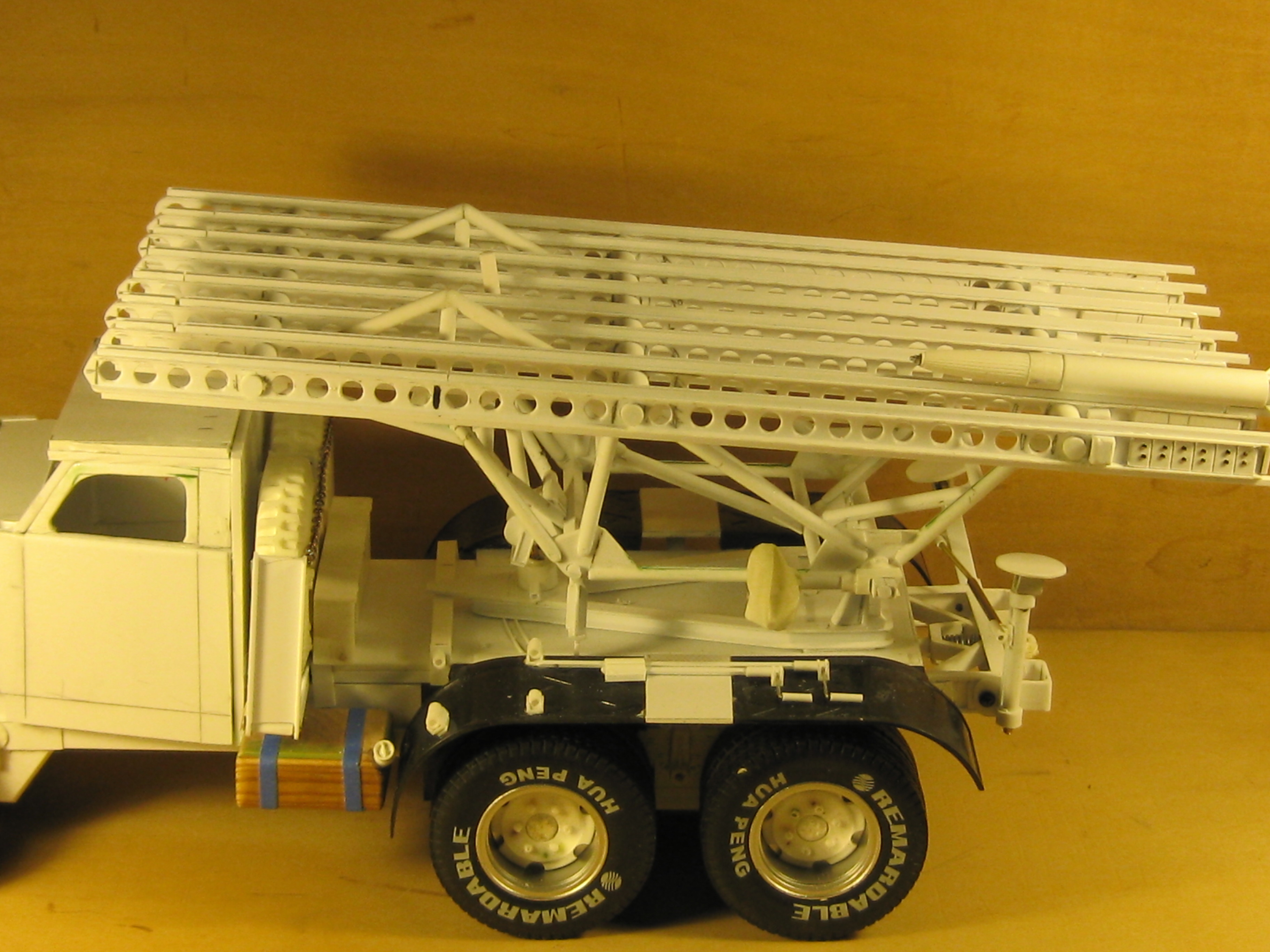

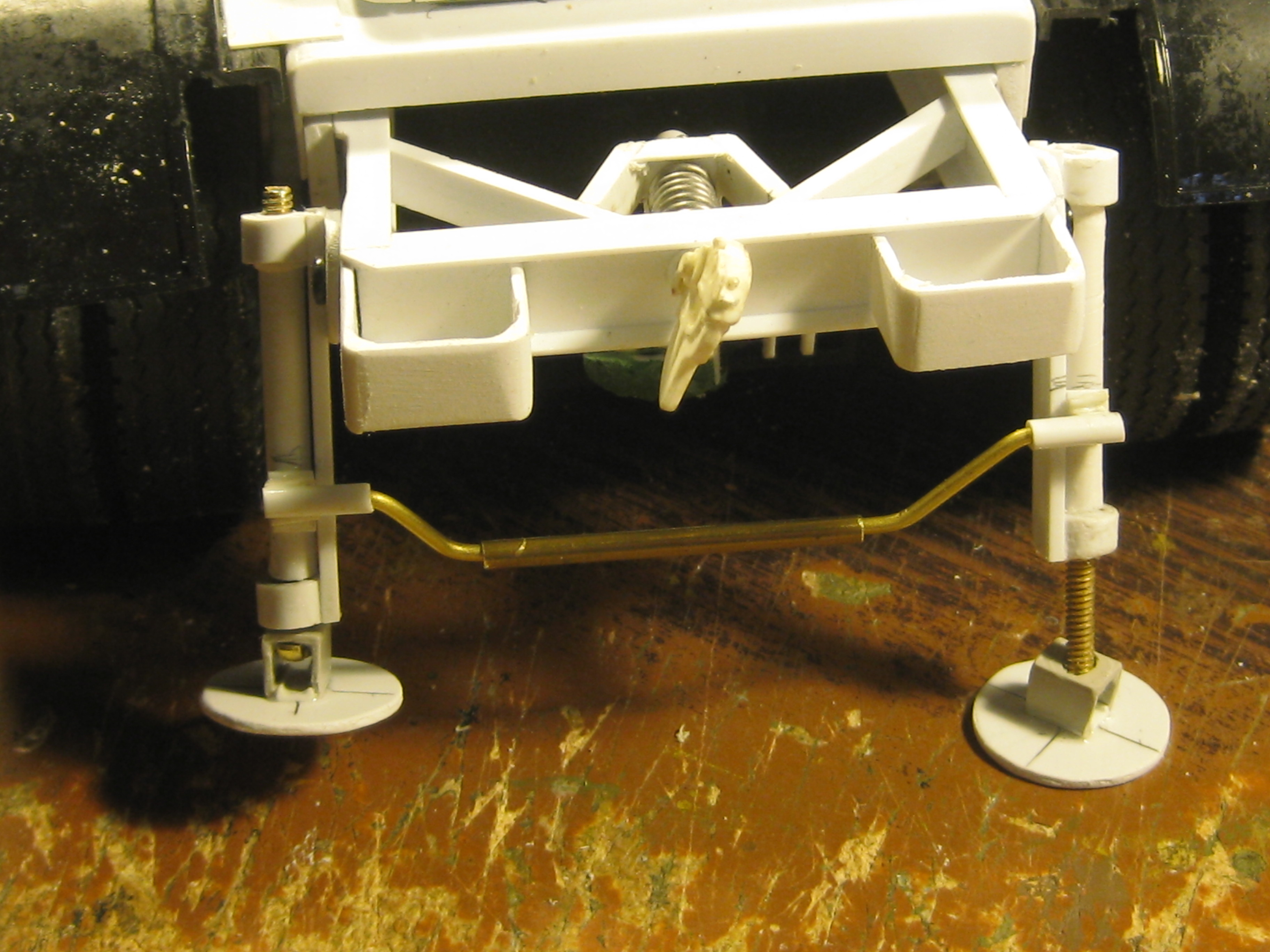

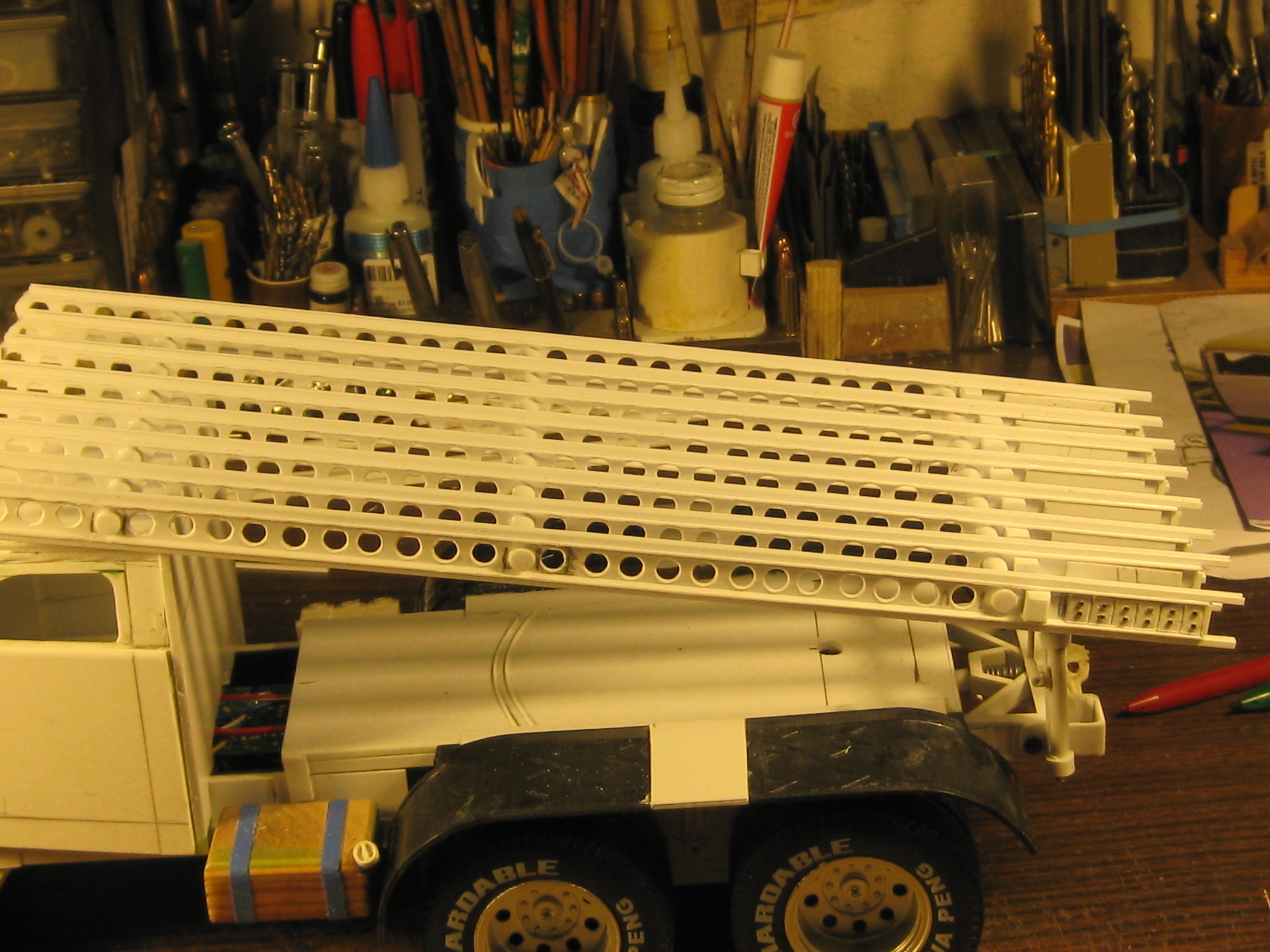

Todays posting is a WIP upgrade on my effort to build a Studebaker US6 with a Katyusha rocket rack. I've never done a build thread exactly like this before, and today I am going to show additional progress, including an embarrassing learning experience (dumb mistake) that I made that I was able to correct (Mickey Mouse Modification). I seem to recall an old saying ..........
"Measure twice, cut once". That is advice I will try to remember in the future.

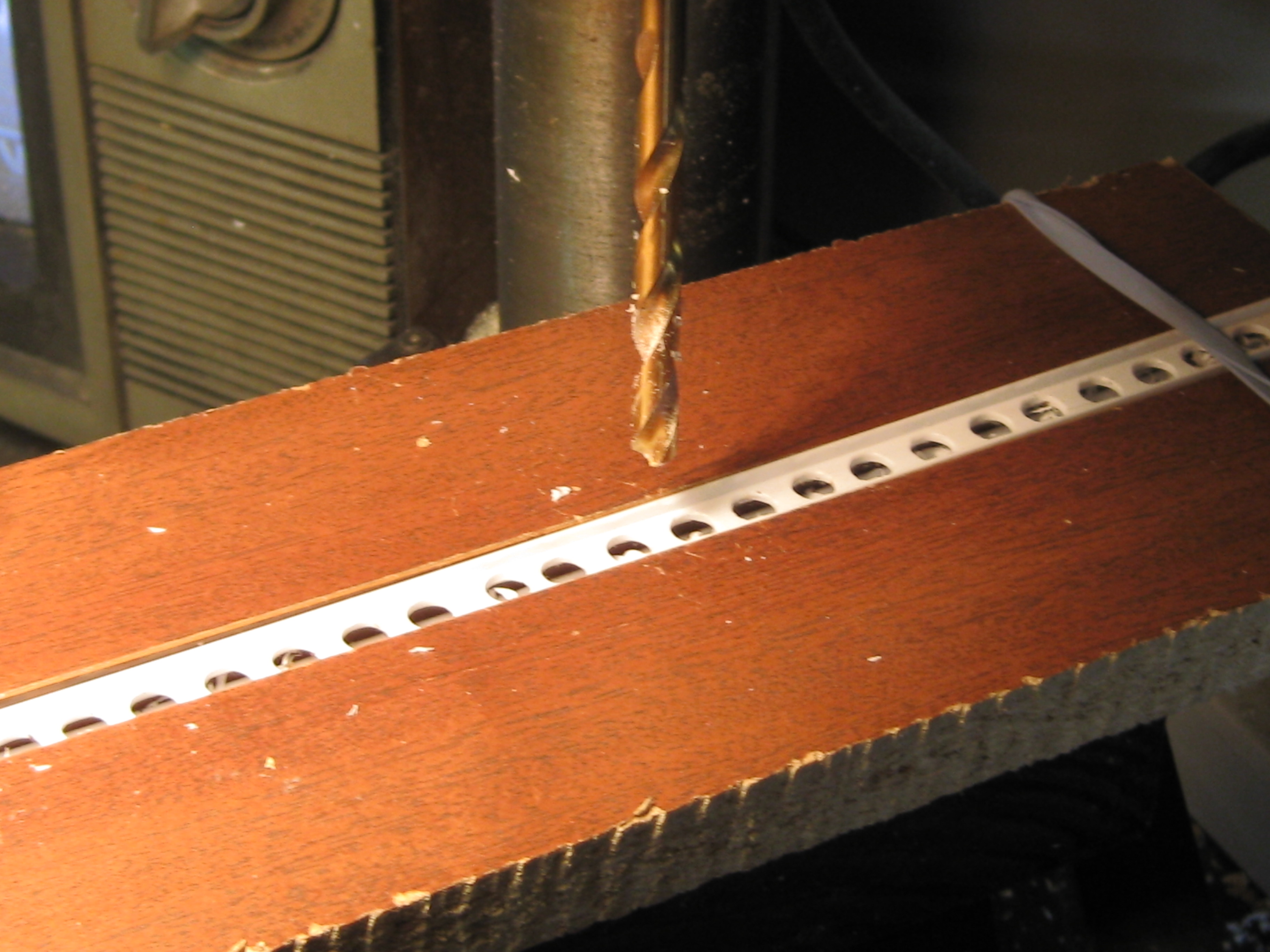

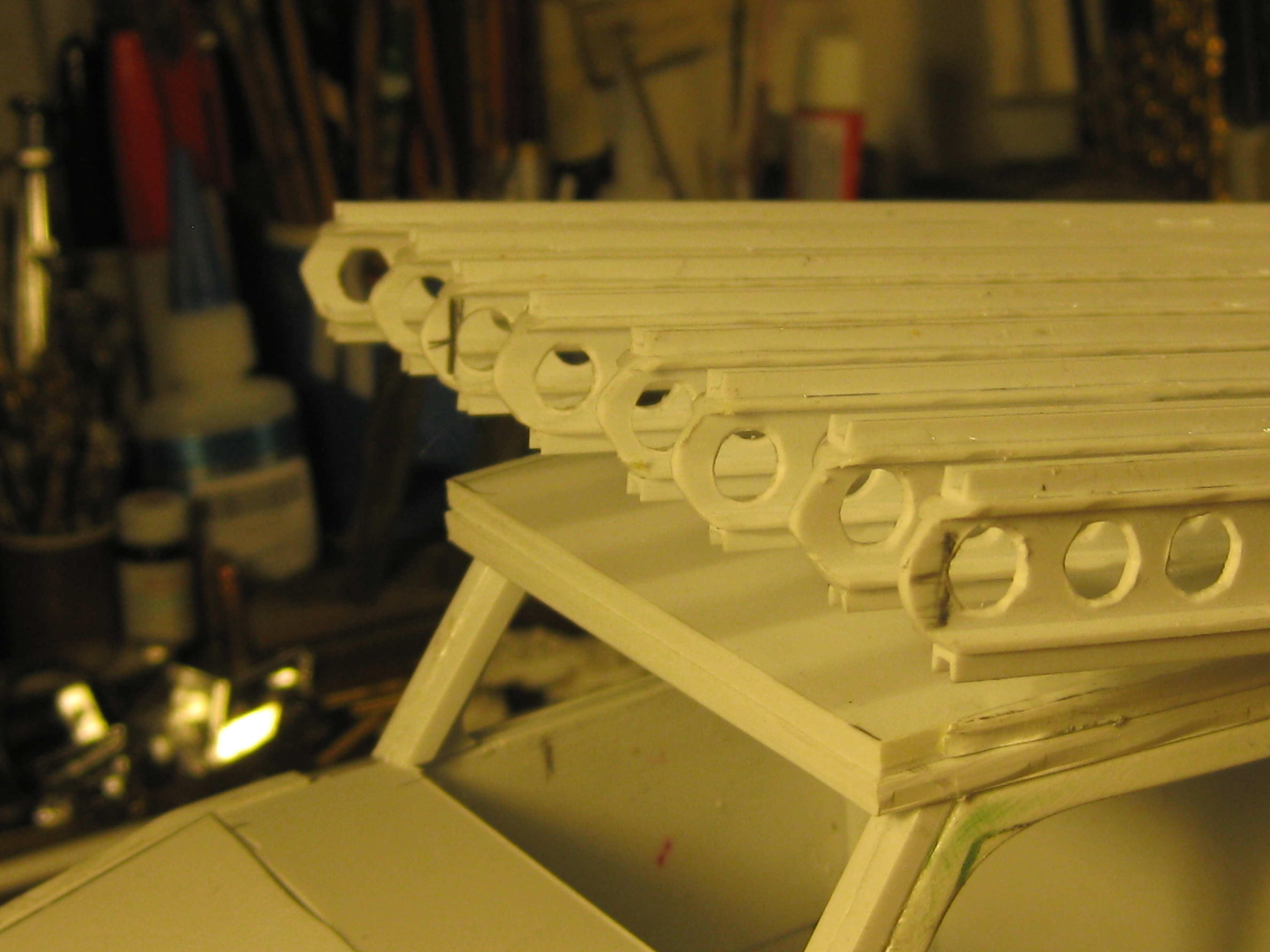

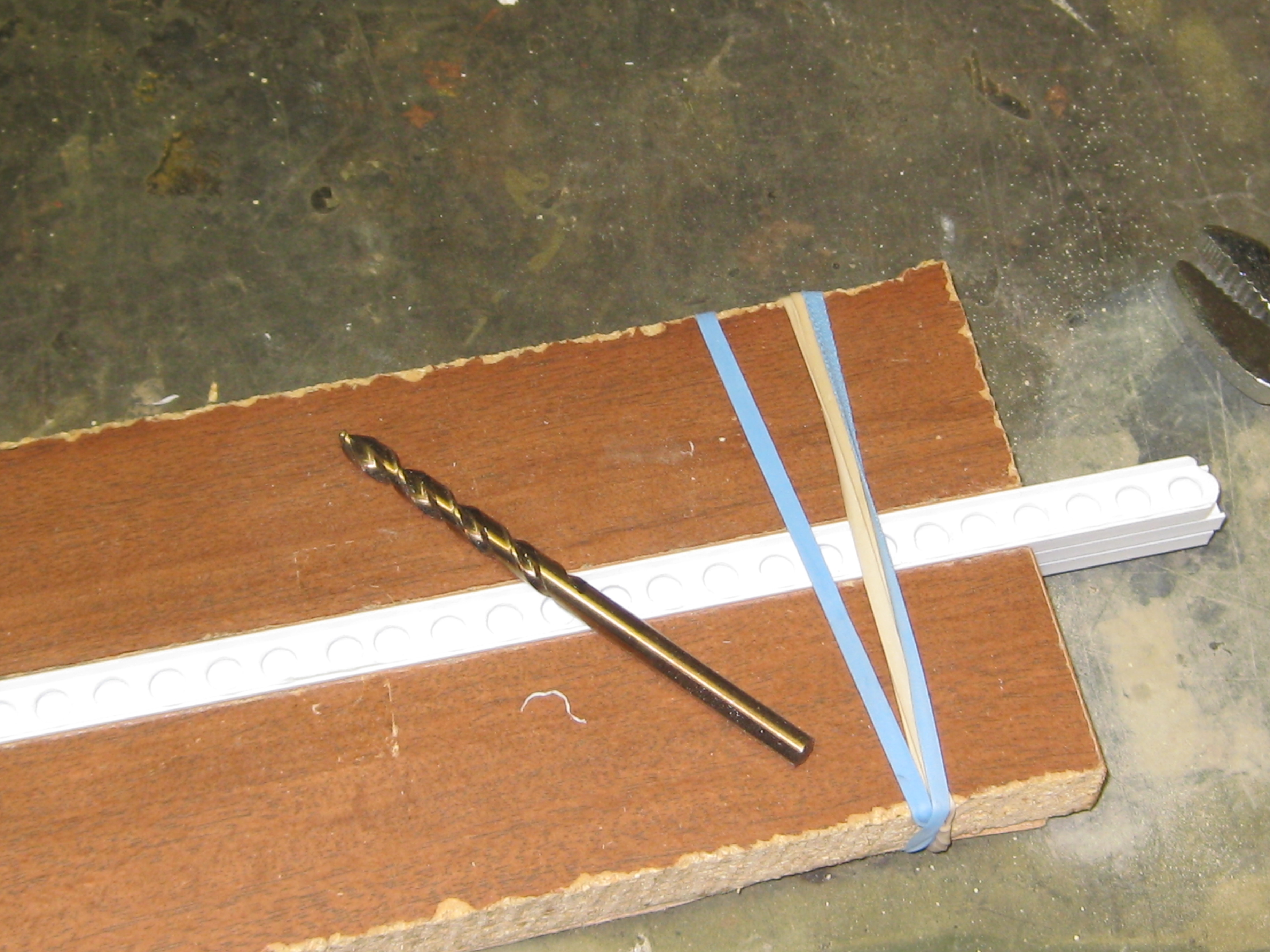

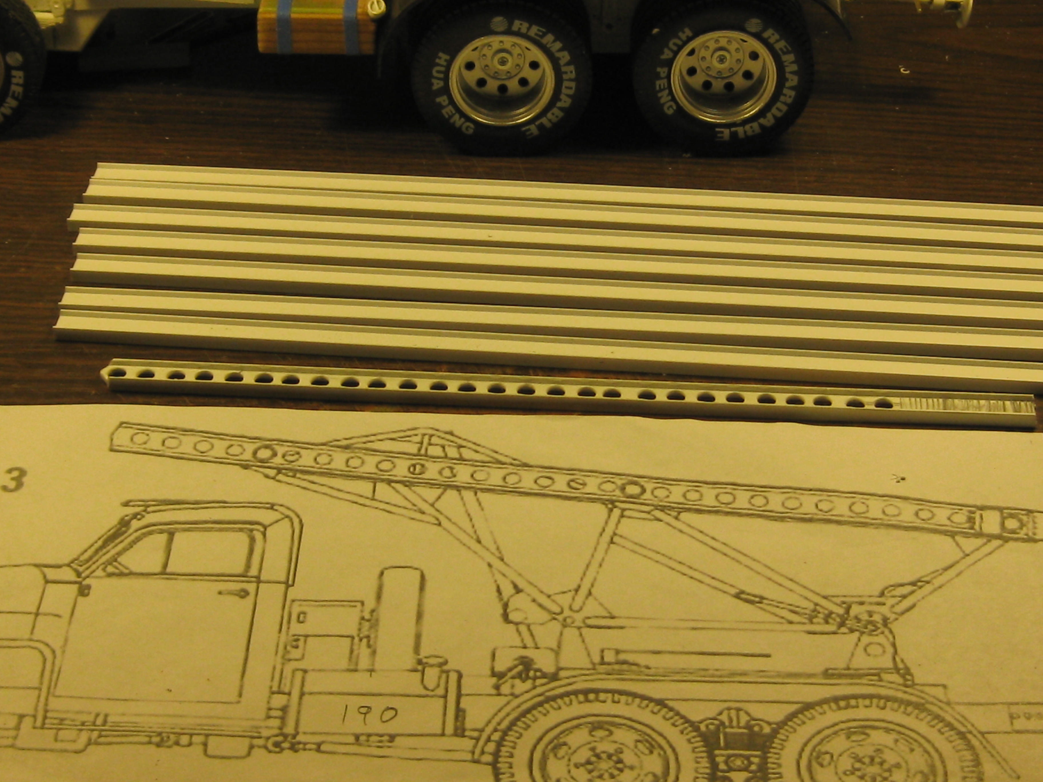

The eight rocket rails needed a bunch of holes drilled into them. That didn't turn out to be too bad once I was able to put together an alignment frame so that I could drill a couple of them at the same time, I used the first one I made as a template so that all of the holes would be uniformly spaced in the others.
Things went ok until I discovered my bad judgement at proper.rail spacing. The rails were too close together. At least 3mm more of space between each one was needed. Since I already glued the heck out of that rack, the only choice I had was to cut the three connection rods and insert a hollow tubing sleeve (21 pieces) in between the rails and reglue everything. That "redo" worked for a plastic toy, but I think it's a good thing I didn't try to become a brain surgeon, rocket scientist, or bomb squad technician.
Some additional progress photos ...........
http://www.rcuniverse.com/forum/atta...mentid=1971813http://www.rcuniverse.com/forum/atta...mentid=1971814http://www.rcuniverse.com/forum/atta...mentid=1971815http://www.rcuniverse.com/forum/atta...mentid=1971817http://www.rcuniverse.com/forum/atta...mentid=1971818http://www.rcuniverse.com/forum/atta...mentid=1971819http://www.rcuniverse.com/forum/atta...mentid=1971820http://www.rcuniverse.com/forum/atta...mentid=1971821http://www.rcuniverse.com/forum/atta...mentid=1971822
Rex Ross 02-24-2014 08:28 AM
Here's a photo of the rocket rack before I widened it by 23mm

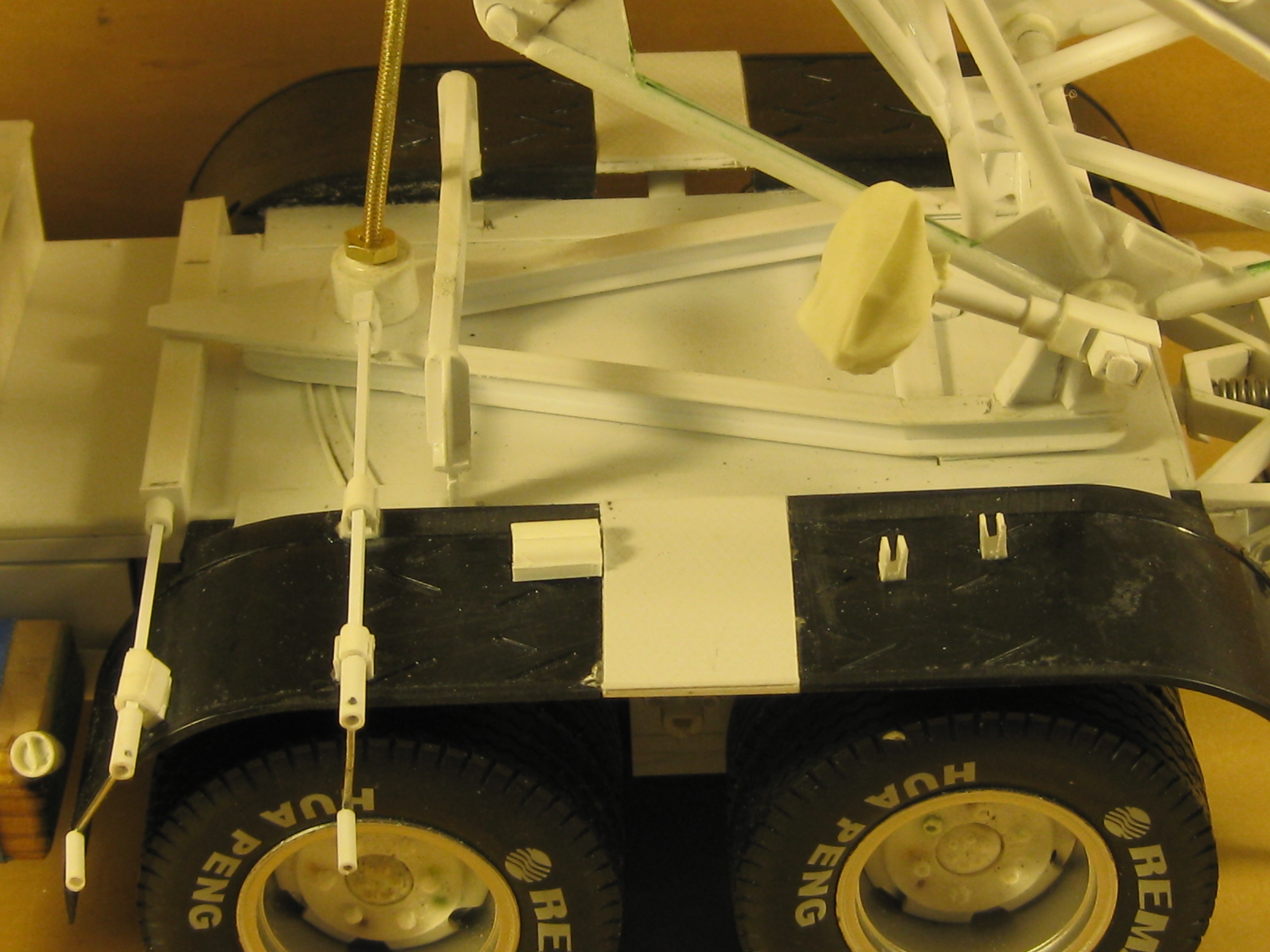

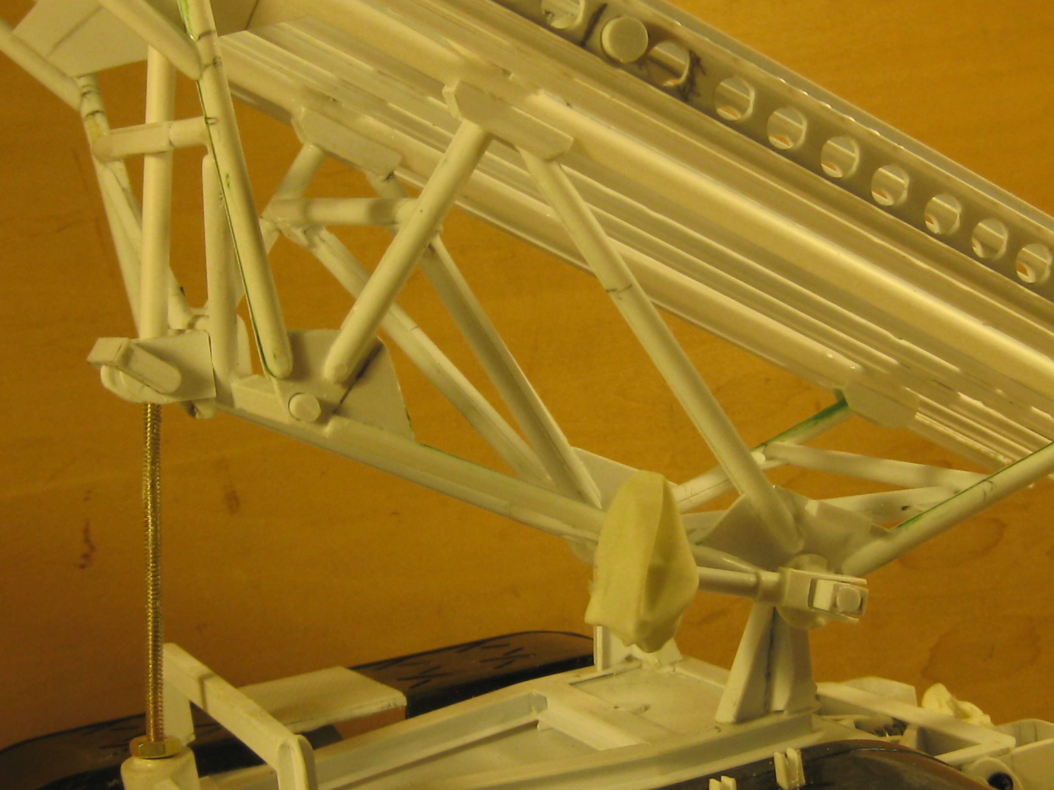

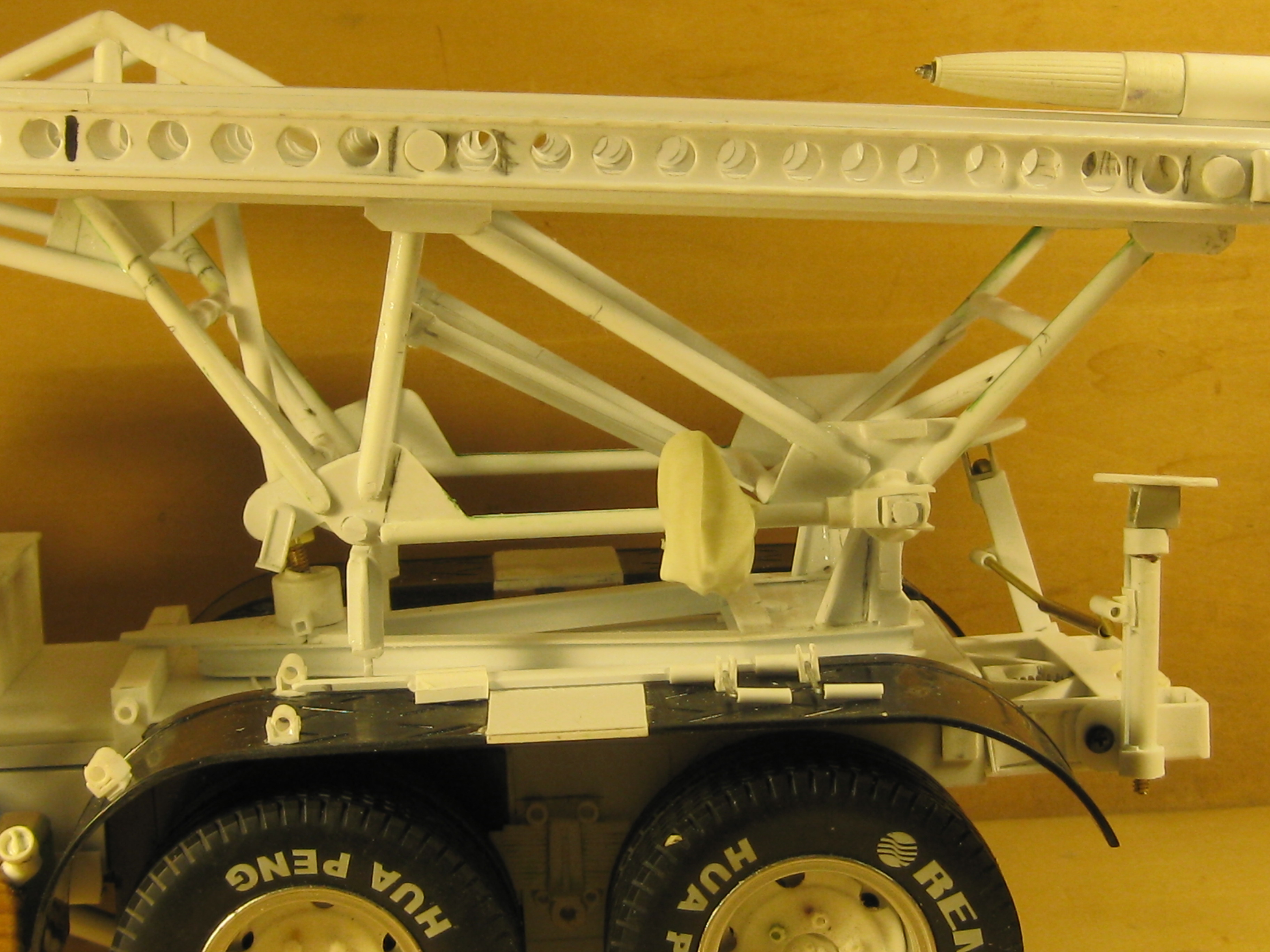

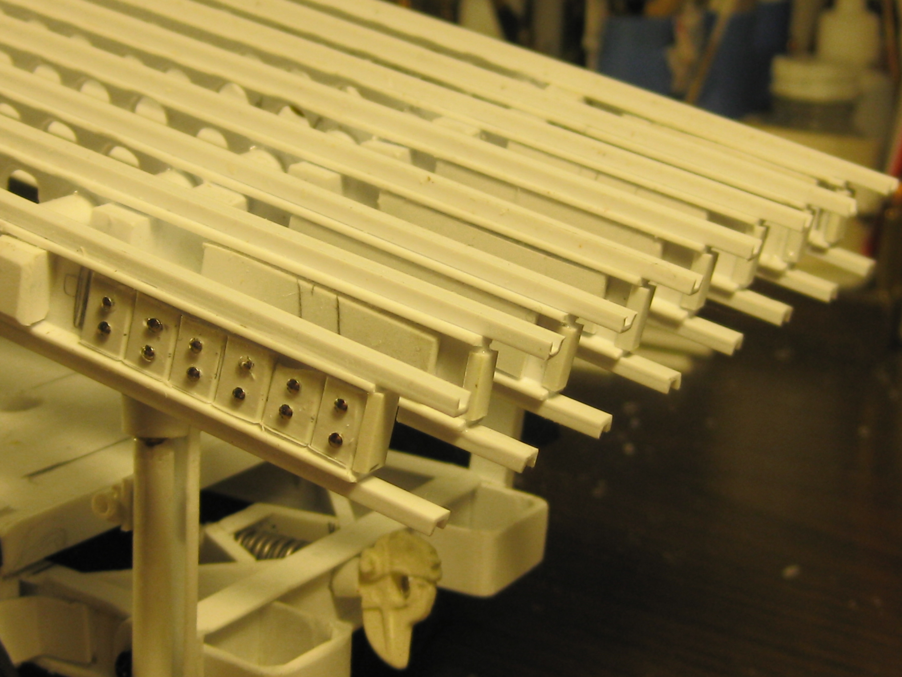

I'm beginning to ask myself ......"What the heck was I thinking when I thought a Katyusha rocket launcher on a Studebaker truck chassis is a model I need to build"? Then I answered myself, "I guess I was thinking ..... because I just don't have one".
So far, so good ....the cab and chassis mods were easy.... but the launcher rails and tubing frame were nothing but pure details to build. I kinda felt like a spider building a web. I still have to build 16 rockets, but that's OK, finishing the cab will be easy by comparison...... when I get around to it.
Google searches came up with a heck of a lot of detail reference photos that enabled me to put together a fairly accurate scale model of this rig. I found out a lot more about Russian rocket launchers than I ever thought I would want to know.
http://www.rcuniverse.com/forum/atta...mentid=1974210http://www.rcuniverse.com/forum/atta...mentid=1974211http://www.rcuniverse.com/forum/atta...mentid=1974212http://www.rcuniverse.com/forum/atta...mentid=1974213http://www.rcuniverse.com/forum/atta...mentid=1974214http://www.rcuniverse.com/forum/atta...mentid=1974215

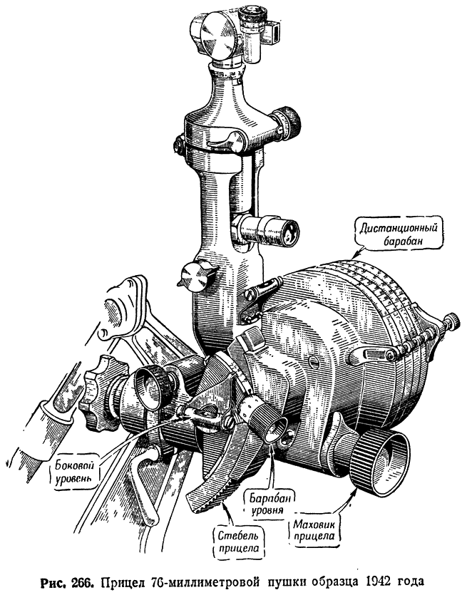

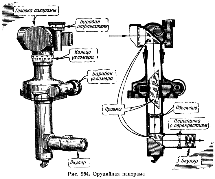

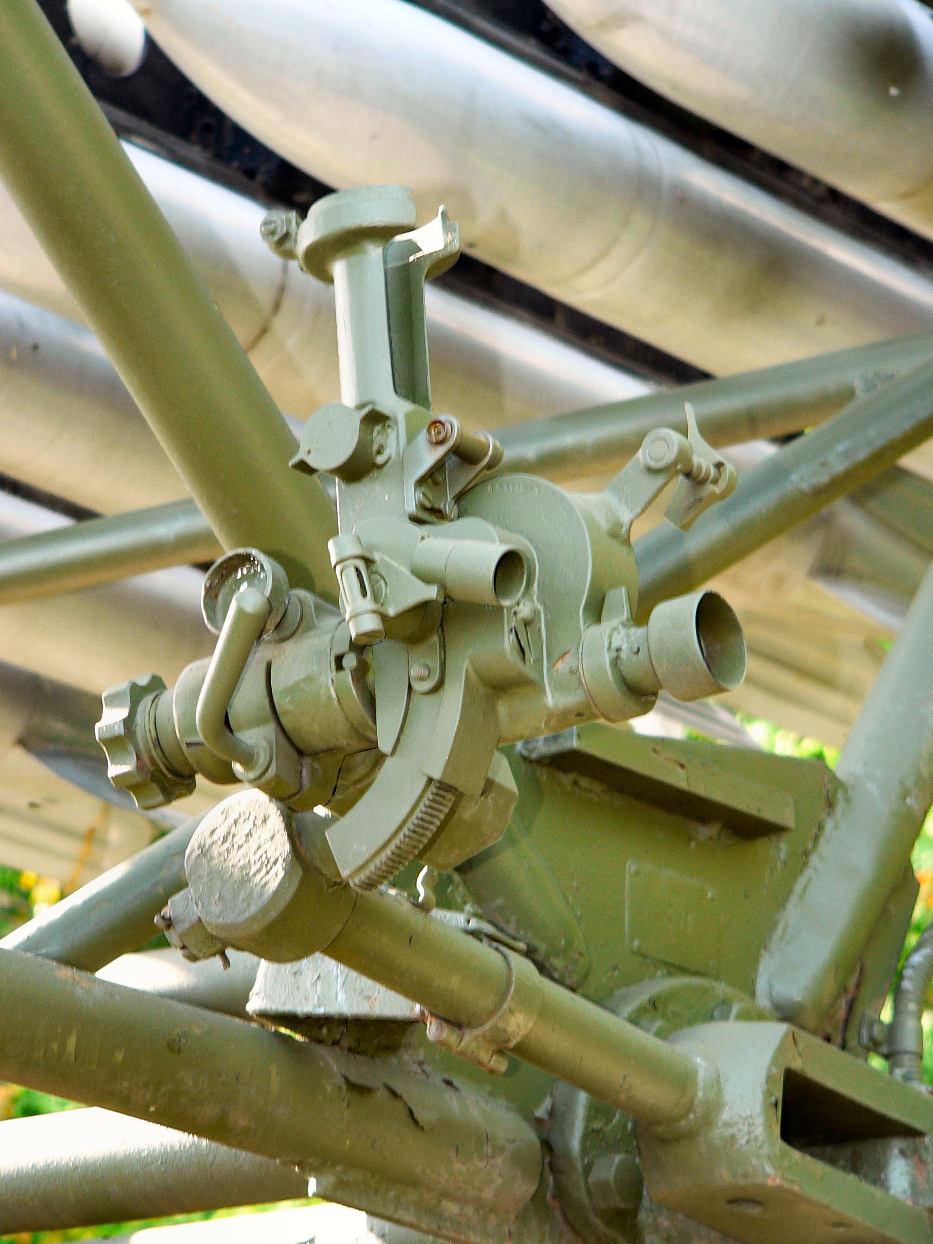

Somewhere on the launch rail superstructure there was a mount for a dial sight, possibly with range and angle of sight scales and leveling bubble, this was the normal Soviet sighting arrangement. The sights may have been removed before firing.
http://www.rcuniverse.com/forum/atta...mentid=1974218
The dial sight would have been oriented using a director type instrument oriented in a centre of arc or zero line. Calculations, or more likely measurement of bearing and range from the map was probably at battalion level.
http://www.rcuniverse.com/forum/atta...mentid=1974219http://www.rcuniverse.com/forum/atta...mentid=1974220
A ranging gun would have acted as a rangefinder. The difference between rocket and shell ballistics was such that the effects of atmospheric conditions on projectiles would have been somewhat different so the correction derived would have been approximate. With a BM 21 a low level wind measuring system was sometimes used, I've no idea if such arrangements were used earlier.
On my scale model of a type BM 13, had this type of device on the side of the tube frame that is articulated to correspond with the launch rails and used to aim the rockets (see photo and drawings). I was able to find some info on how it was configured for operation in the field under intensive battle conditions. Using ranging tables to compute azimuth and elevation (corrected for temperature and humidity) a firing trajectory solution could be calculated. This usually also involved spherical trigonometry parameters (which every schoolboy knows) so aiming the rockets for maximum pinpoint accuracy was assured. This was PLAN A. In case these instructions could not be followed, just pointing the truck at the bad guys and hoping you hit enemy stuff was PLAN B.
I absolutely refuse to try to build that aiming device in 1/16 scale. It has been built with a dust cover to protect it from the hazards of the environment.
http://www.rcuniverse.com/forum/atta...mentid=1974221
I cut a finger off of a latex rubber glove for that accurate 1/16 scale part. The 16 rockets are next

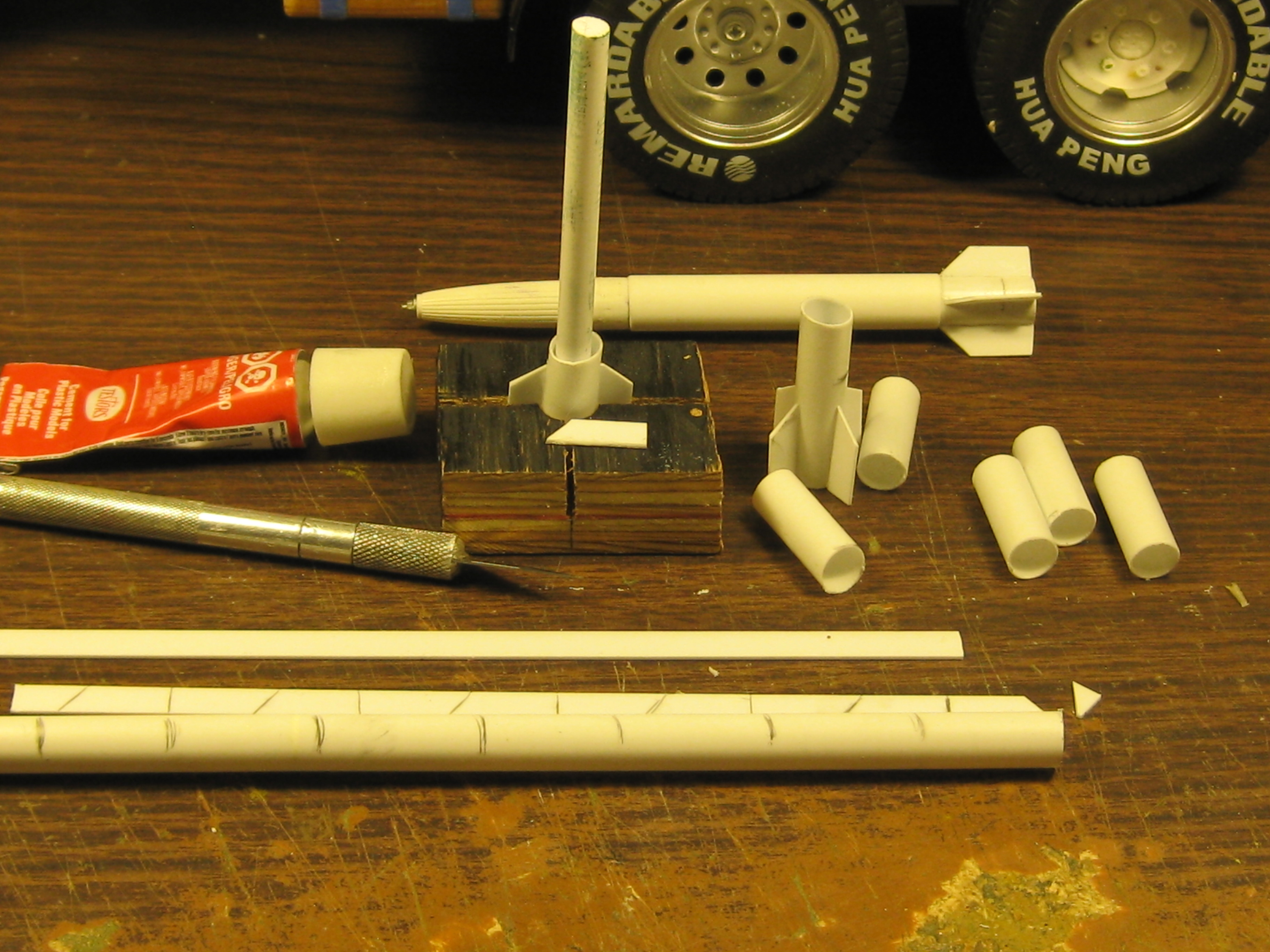

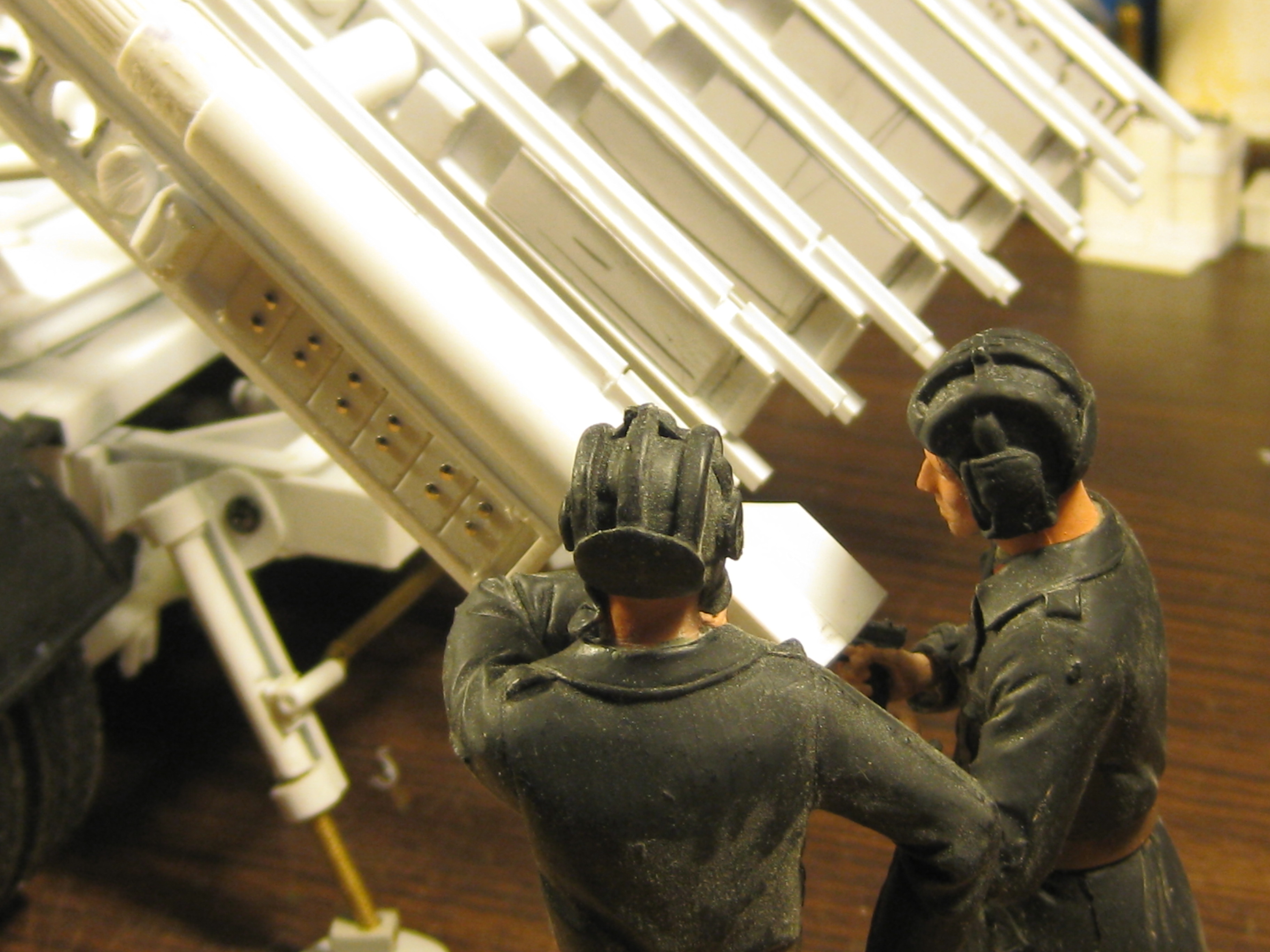

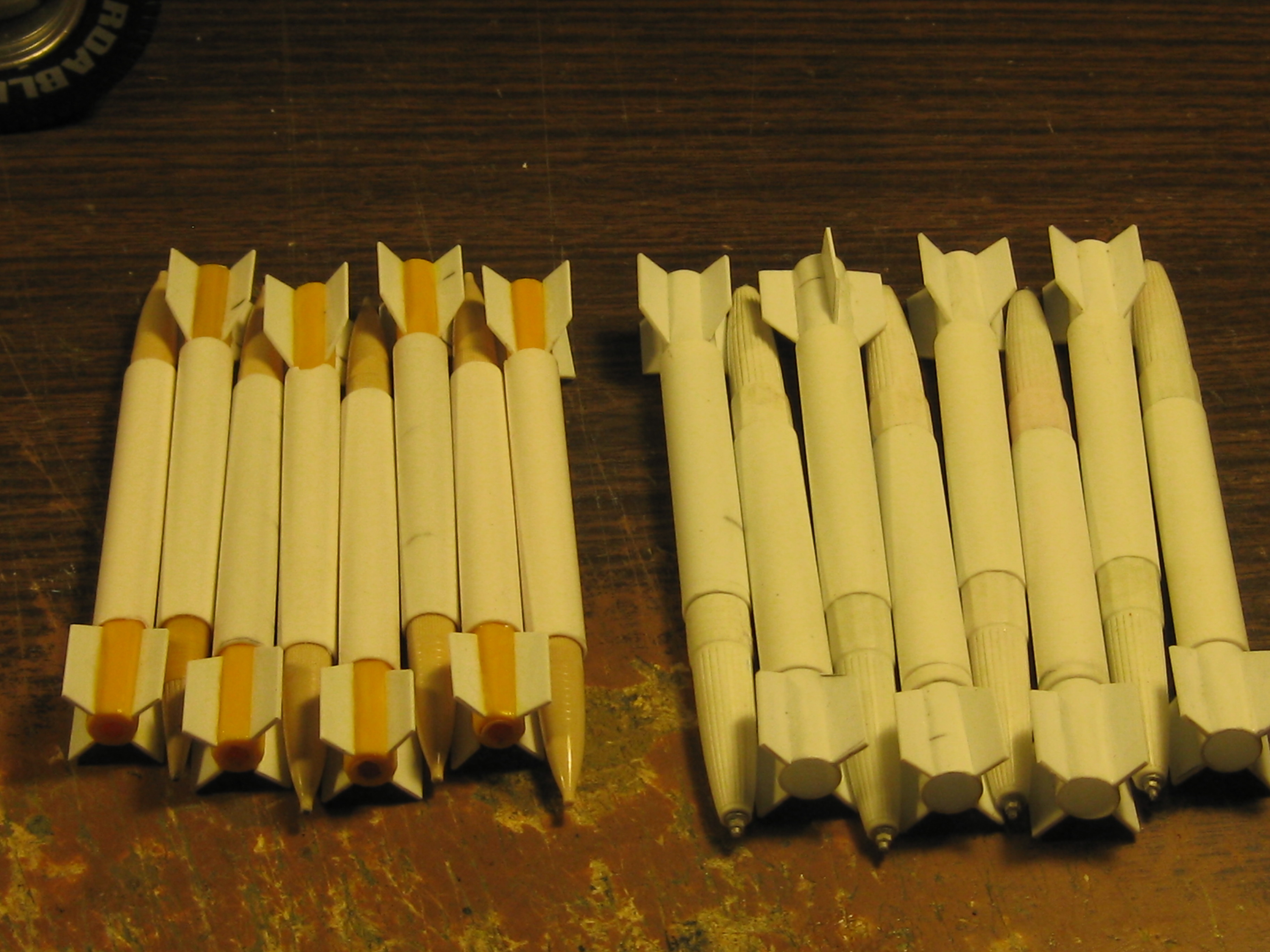

I wasn't too interested about building absolutely accurate models of the BM 13 rockets, and I almost decided not to build any at all because there were16 of them and that meant 64 stabilizing fins needed to be glued on.....evenly and straight. The wooden alignment block that I made was the solution. Then I thought that making the bodies out of some felt pens I had might be close enough to serve as a similar looking weapon. They are supposed to represent the 133mm, 42.5kg rockets, of which 6 million were built during WWII. Those will be on top of the rails. The rockets on the bottom of the rails will be the smaller ones made out of old Bic pencils. I figured since they wouldn't be very visible, it didn't matter if they were a little different looking.
Out of the 7,000 Studebaker trucks equipped with the launcher, 4,000 were lost in battle, according to my Google.search sources.
http://www.rcuniverse.com/forum/atta...mentid=1975381http://www.rcuniverse.com/forum/atta...mentid=1975382http://www.rcuniverse.com/forum/atta...mentid=1975383

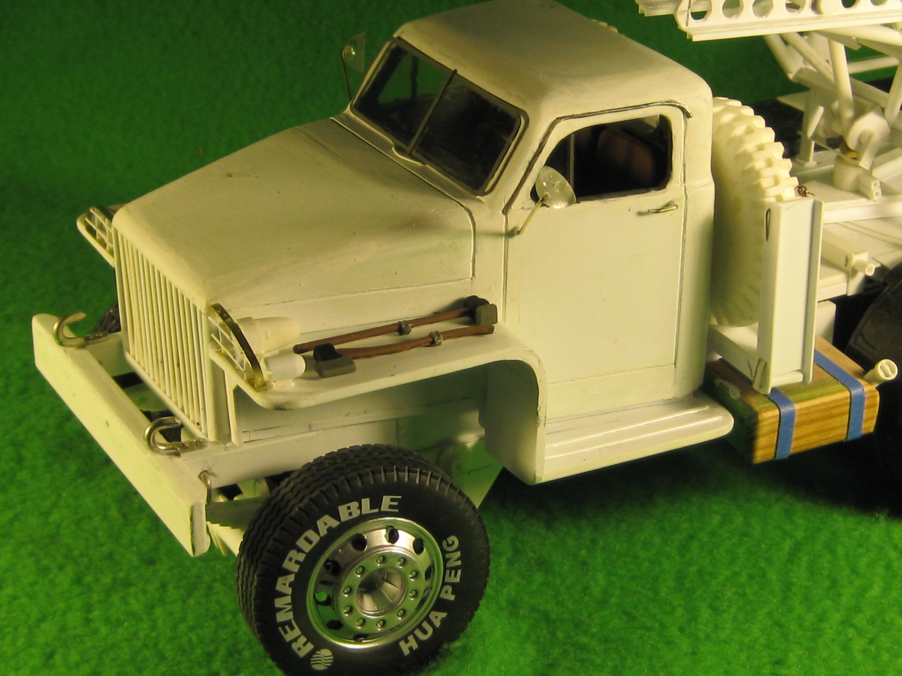

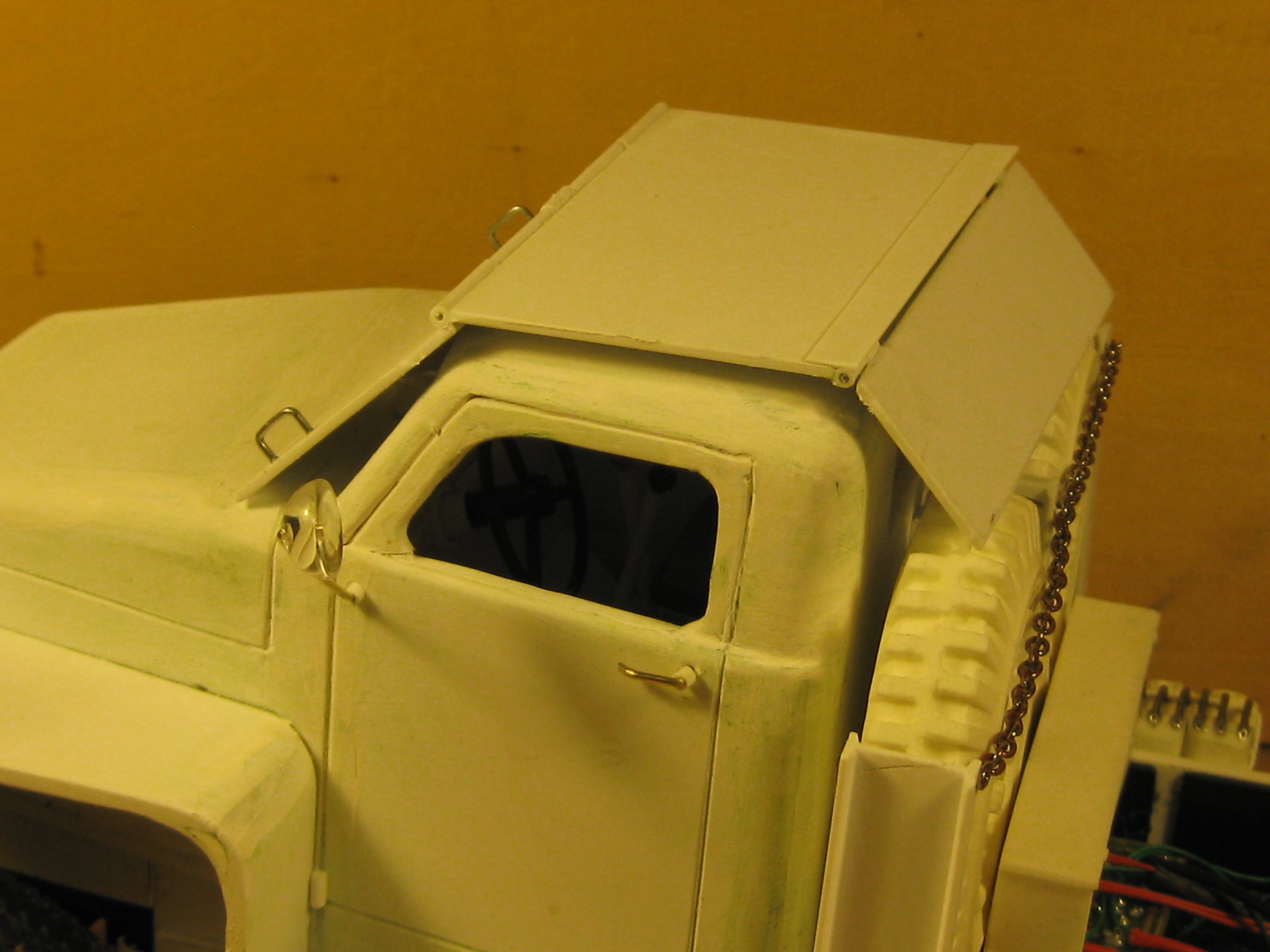

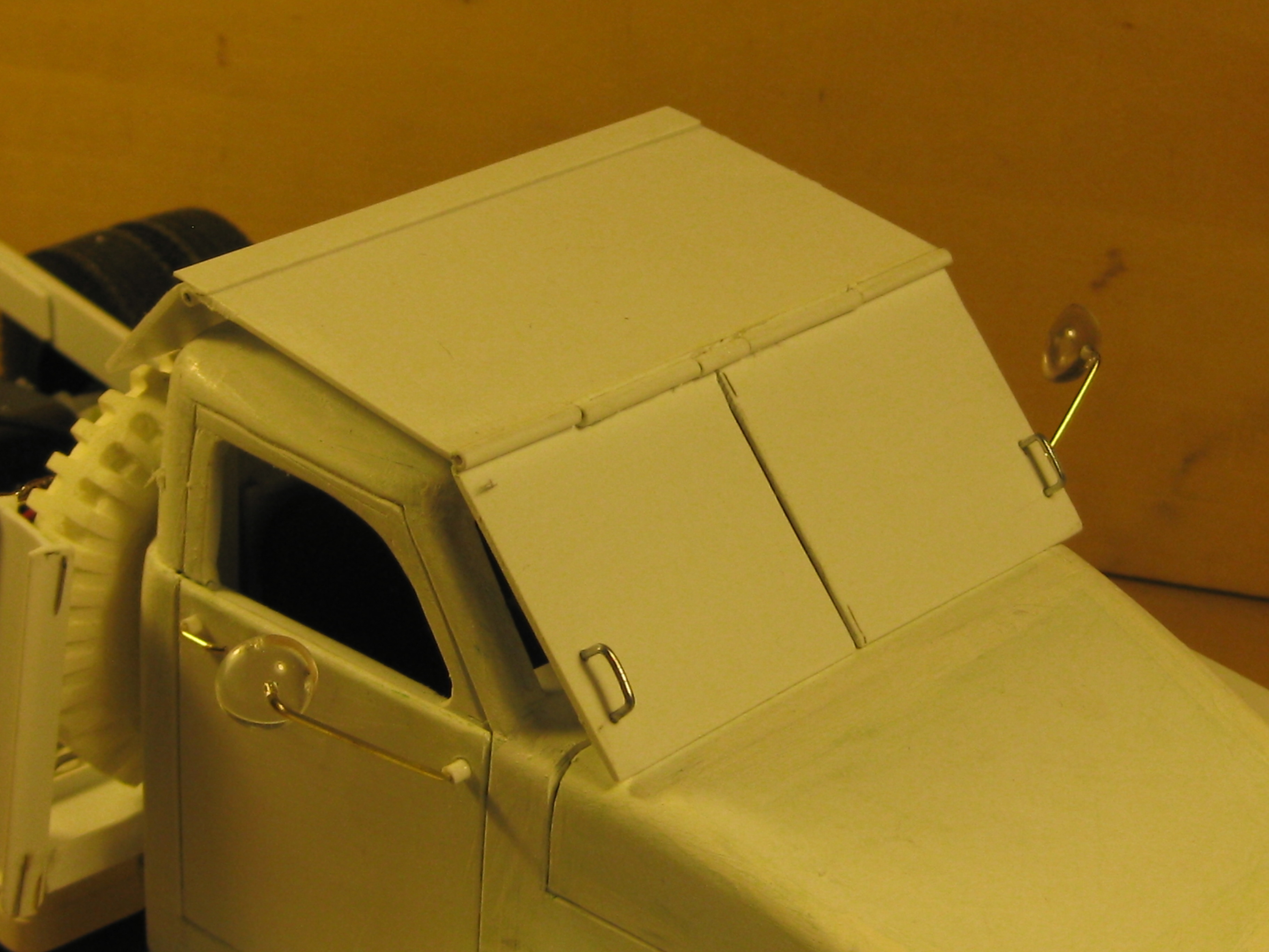

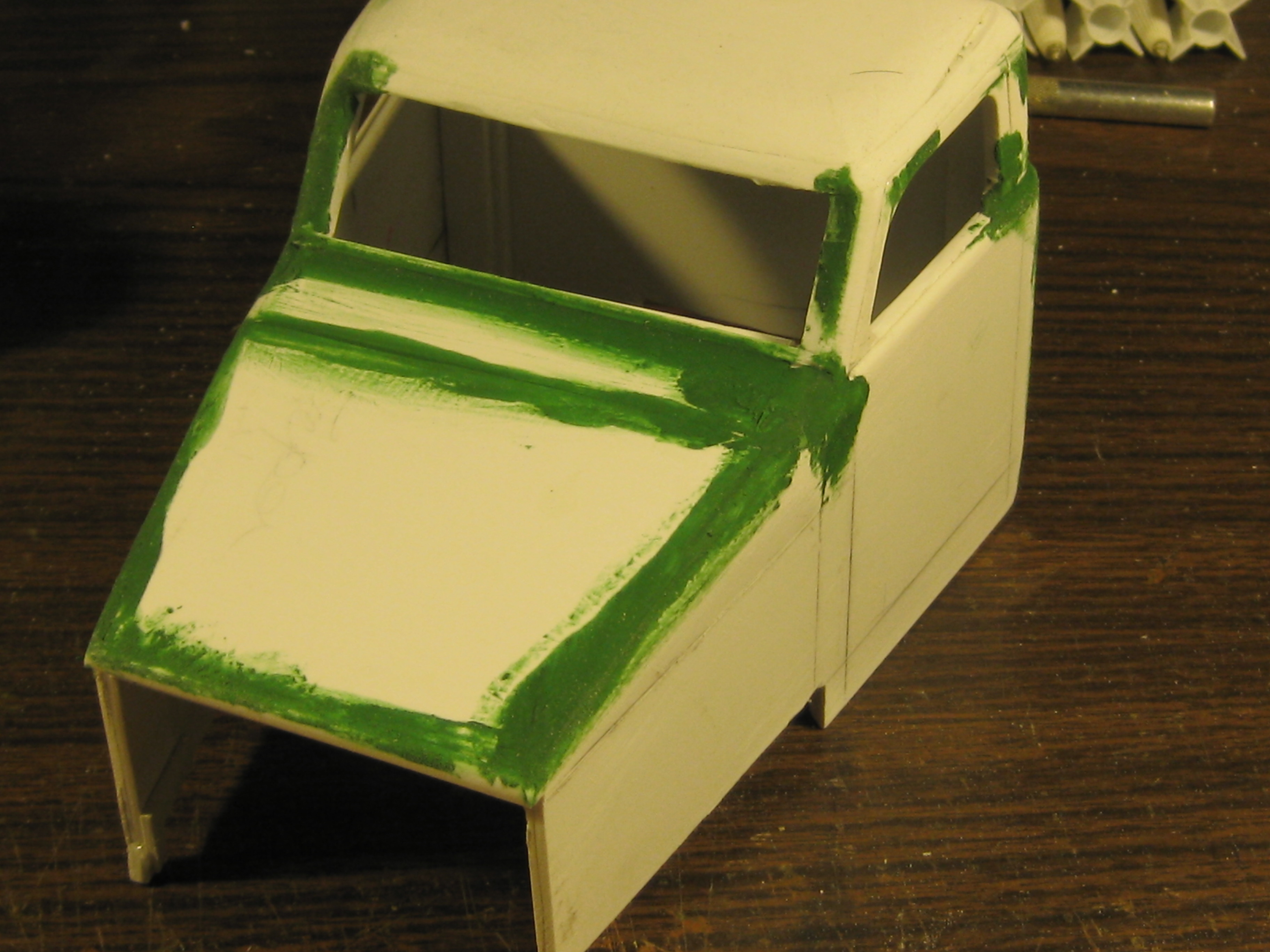

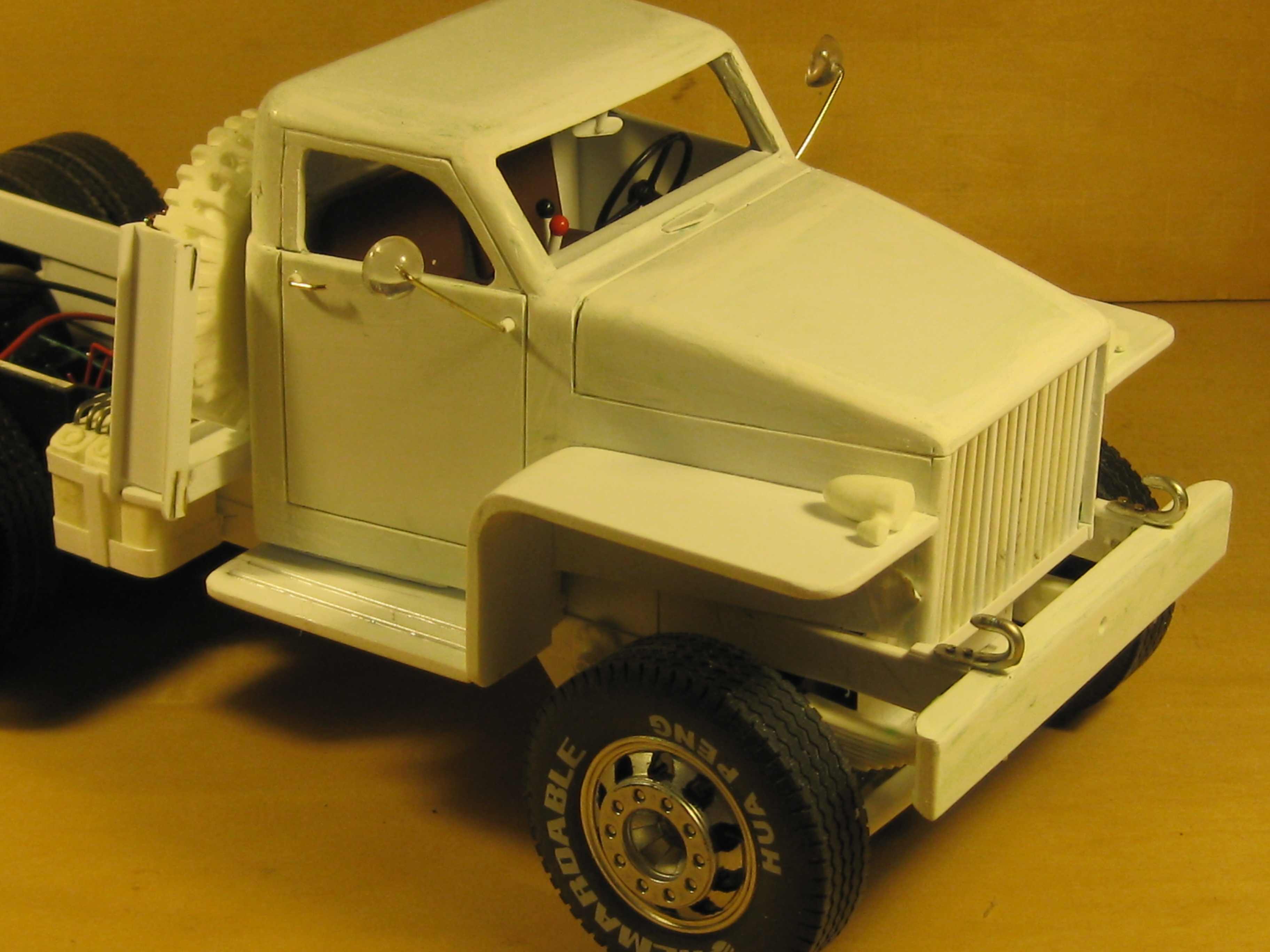

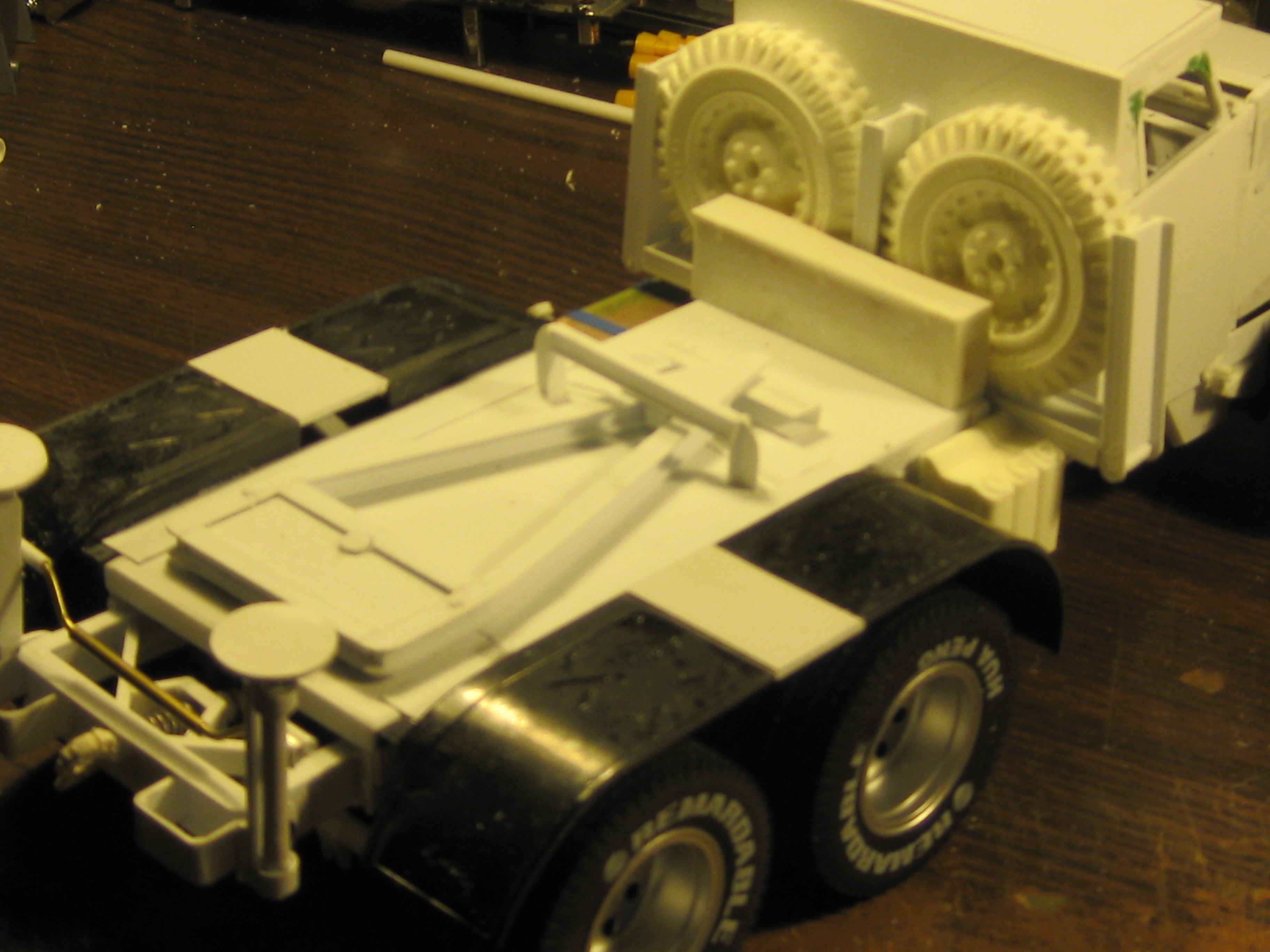

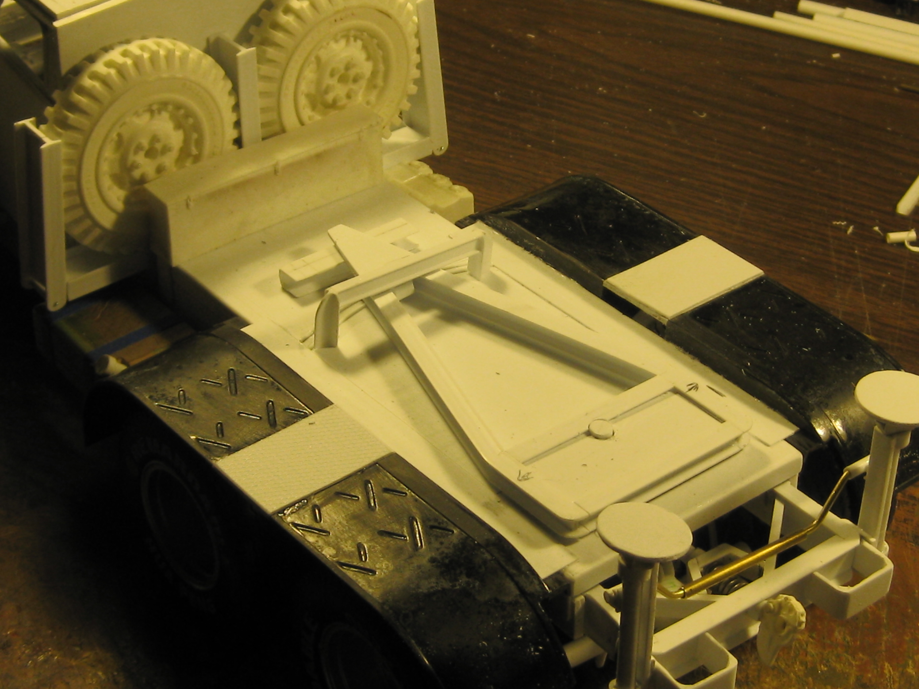

Progress on my Styudebaker cab is going well. With any luck, this thing may end up looking very similar to a correctly built (and spelled) Studebaker US 6 truck cab.
The plates on the top of the cab are blast shields to protect the cab when the rockets are fired.
http://www.rcuniverse.com/forum/atta...mentid=1977341http://www.rcuniverse.com/forum/atta...mentid=1977342http://www.rcuniverse.com/forum/atta...mentid=1977343http://www.rcuniverse.com/forum/atta...mentid=1977344http://www.rcuniverse.com/forum/atta...mentid=1977345http://www.rcuniverse.com/forum/atta...mentid=1977346

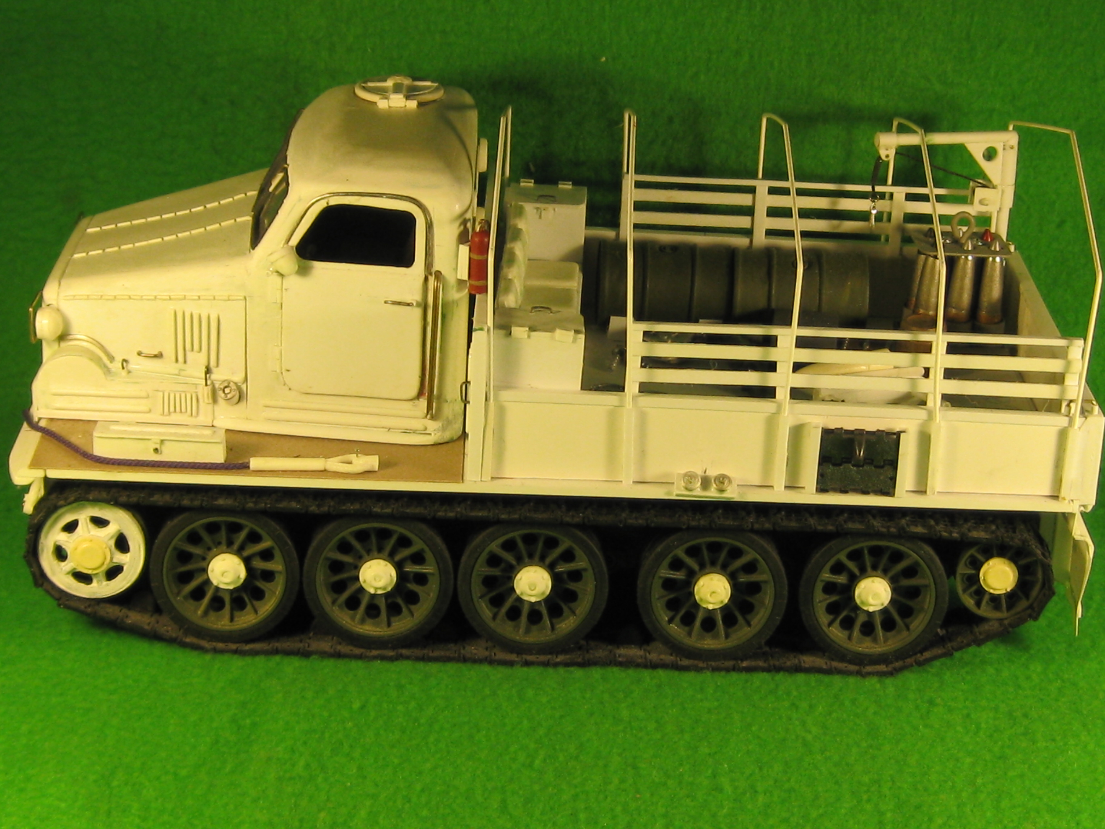

Until then I may start on some other projects that are kinda dusty from months of neglect. I gotta catch up on my backlog before I start anything else.
http://www.rcuniverse.com/forum/atta...mentid=1980206http://www.rcuniverse.com/forum/atta...mentid=1980211http://www.rcuniverse.com/forum/atta...mentid=1980212http://www.rcuniverse.com/forum/atta...mentid=1980213http://www.rcuniverse.com/forum/atta...mentid=1980207http://www.rcuniverse.com/forum/atta...mentid=1980208http://www.rcuniverse.com/forum/atta...mentid=1980209http://www.rcuniverse.com/forum/atta...mentid=1980210

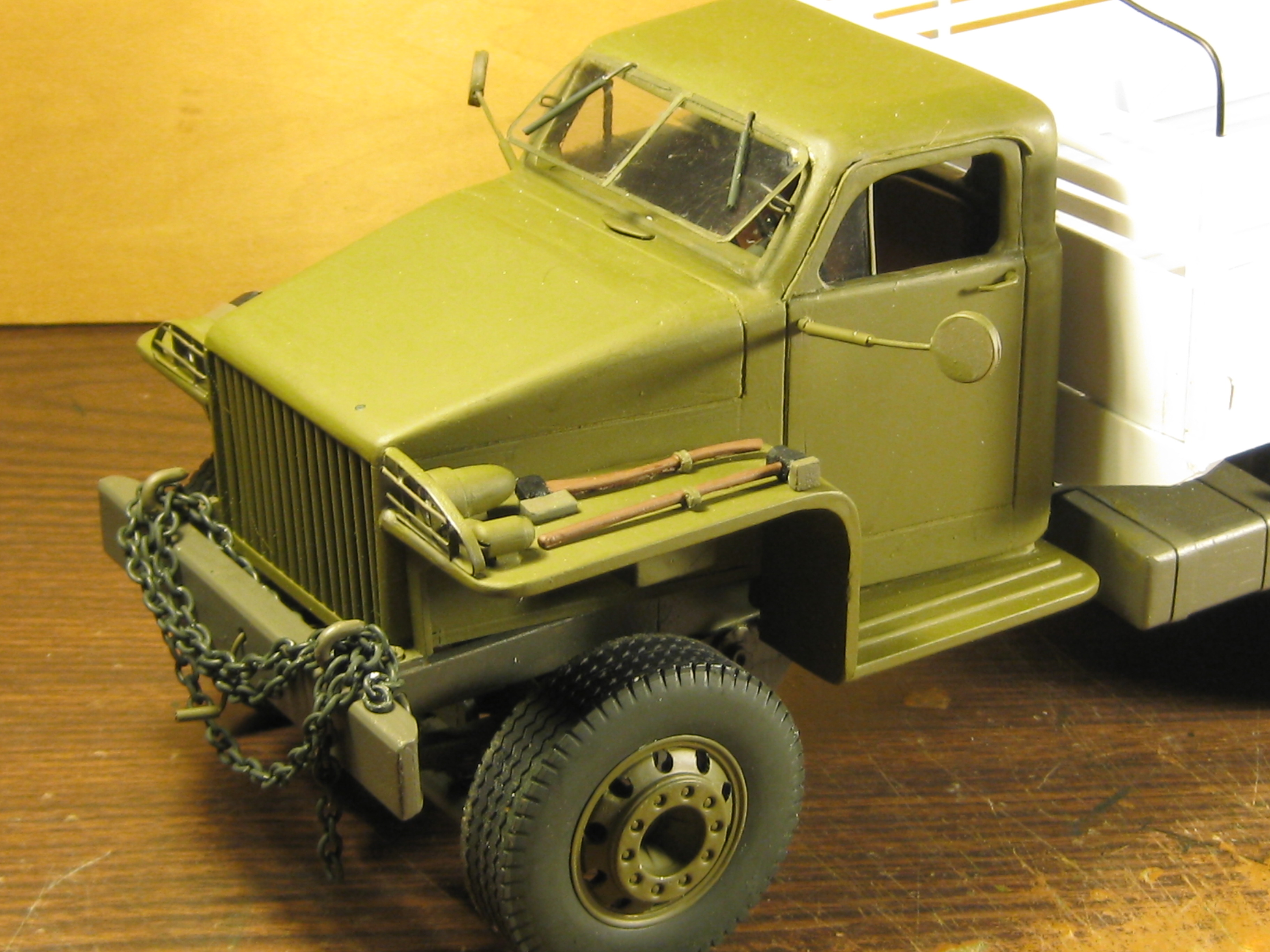

I had to order more paint in order to finish my Katyusha. This week should see a paint job on those parts.
http://www.rcuniverse.com/forum/atta...mentid=1982710
While I was waiting for delivery, I sent the Studebaker cab and chassis back to the motor pool to be fitted with a cargo/troop carrier truck bed that would be interchangeable with the rocket rack. That conversion went a heck of a lot faster than the rocket rack frame. I think there are about six or so other truck bed types that I think would be fun to build on the Studebaker bed frame. If it could be done to the real 1:1 scale truck, I think it would be fun to do that to a 1/16 scale project (that could keep me busy for a year or so).........I gotta order more paint and plastic!!!!!
http://www.rcuniverse.com/forum/atta...mentid=1982711http://www.rcuniverse.com/forum/atta...mentid=1982712http://www.rcuniverse.com/forum/atta...mentid=1982713http://www.rcuniverse.com/forum/atta...mentid=1982714http://www.rcuniverse.com/forum/atta...mentid=1982715
