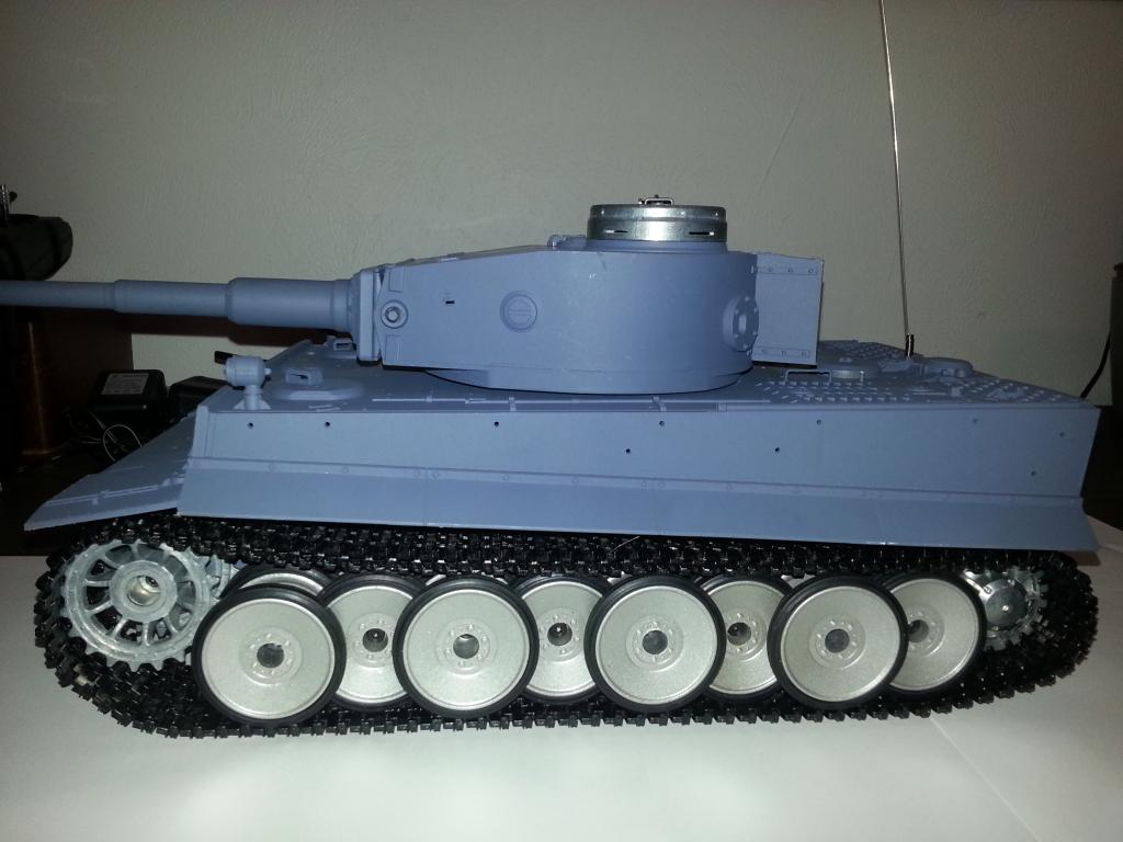

Augustus1967 07-27-2014 11:16 AM
To this point I have added Mato Suspension.
Sprockets, Idlers, Swing Arms and Roadwheels, no Ball Bearings at All, and Metal Track.
So far I'm pretty Unimpressed:
The replacement Axel Screws (Mato) that connect the Swing Arms to the Hull are Very Soft (White Metal).
So Care is needed, so as not to strip out the Phillips Head or the Threads.
Also, those Axle Screws seem a touch Long, allowing a little Wiggle (slop) in the Swing Arms.
Think this may cause problems down the road in retaining the Coil Springs, that use Friction and Allignment to keep them in place.
Next the Hexhead Axel Screws that came with the Mato Roadwheels require a different size Hex Wrench.
Apparently I'm missing this size in Inches or metric, so I reused the Original Axel Screws.
The fit is pretty Fair.
The Mato Sprockets went on easy and Fit Well.
Very Little Slop.
The Idler Wheels were a bit difficult to install.
The screw pitch is different requiring a firm hand to get the screw all the way in.
once mounted they retained quite a bit of Slop (Wiggle).
The Mato Tracks look quite nice.
Laying them out next to the Original Plastic Tracks, they seemed One Track Block too Long.
So I removed one Block from each track and installed them.
After Proper installation they Seemed Very Tight, no Sag at all from the Idler Wheels to the Sprocket.
So I added the deleted Track Blocks back, one to each side.
Now they seem Extra Saggy.
I did a test run and wound up throwing a track, port side, running on short carpet...
During a Spin... No real surprise there, but it won't do.
I'll get a Photo up this afternoon...
-gus

Good to know about the parts. Sounds like you need an idler adjuster. HennTec has one that you can get from rctank.de. Or, you would see what Taigen has already built. Those are a great functional upgrade.
Augustus1967 07-28-2014 10:02 AM
2 Attachment(s)
Yes Sir Philipat,
An adjustable Idler would be Ideal...
I've read the HennTec Idler set up is a good one, if a bit Pricey?
I am pretty much decided on not putting too much Cash/Effort into this Hull over all... As there is Much to change.
Thinking that it might be better in the end to pick up a Taigen Hull to build on, if it comes to that...
Here are photos, Port and Starboard, showing the Slack I was talking about earlier.
To my eye, and judging by my test run, I need to tighten them up.
http://www.rcuniverse.com/forum/atta...mentid=2018021
http://www.rcuniverse.com/forum/atta...mentid=2018020
-gus

Gus hallo, In an ideal world the track should come down on the third wheel from the sprocket, but when it comes to practicality's, you want it where it stays on but still carries some slack, sorry my friend like so much of this hobby it will be trial and error although the old saying " If it looks right it is right " has a lot of truth to it.Do remember you will cause damage if you remove all the slack. shaun
MAUS45 07-28-2014 10:45 AM
Gus, to make adjustments to the track tension you will need to upgrade to a Idler tension set. Right now Henn Tec makes a kit for the HL Tiger I. The only other option would be to get the upgraded lower hull from Imex.
