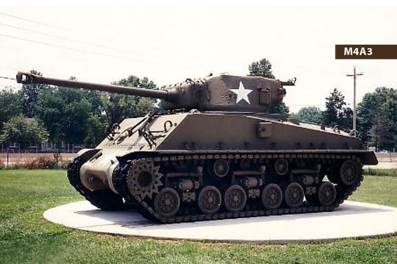

I found this photo on the Heng Long website. So where can I buy one of THESE in 1/16th scale? And what exactly is this? The site says M4A3.
paintjockey 08-11-2014 05:28 PM
I believe that's an M4A3E8 76mm. In my opinion the coolest Sherman.
Terry
mustclime 08-11-2014 08:50 PM
I liked the jumbos....pic says m4a3....tracks do not look like e8 tracks to me
Wozwasnt 08-12-2014 03:13 AM
Maybe the people who put it on display didn't know the difference and just put any old Sherman tracks on.
trackmech81 08-12-2014 05:22 AM
We had an E8 at Fort Hood with rubber pad tracks. It saved the road from damage while moving it around.
Ex_Pat_Tanker 08-12-2014 09:07 AM
They are T80 tracks, same as the ones in the Tamiya kit. The single pin T66's were issued in parallel IIRC, with the T80's replacing them pretty much by the end of the war.
You can't buy one currently - only way to get one is Frankenstein one from Tamiya and/or HL parts for the hull, and either Nick or Mato's T23 turret.

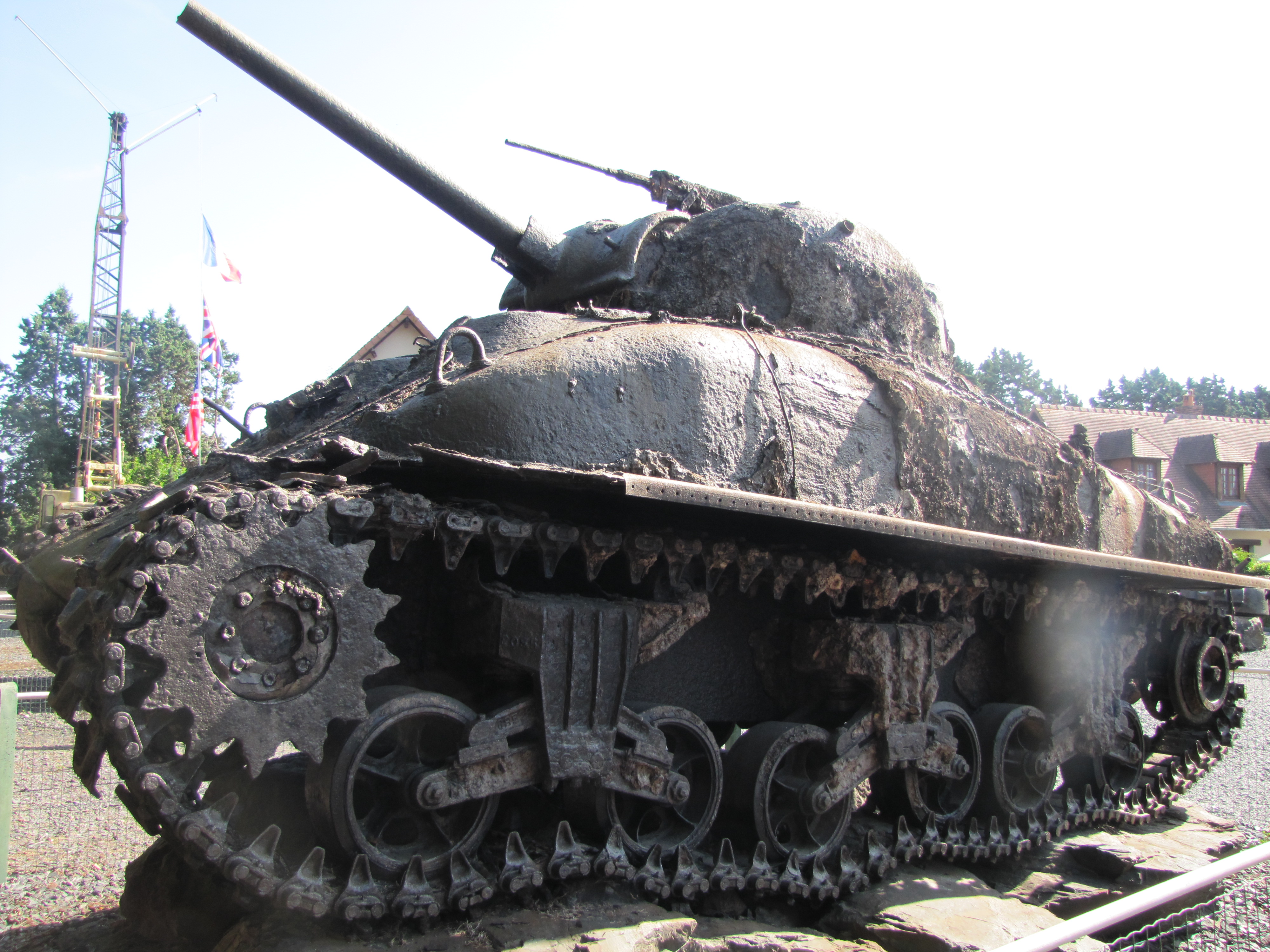

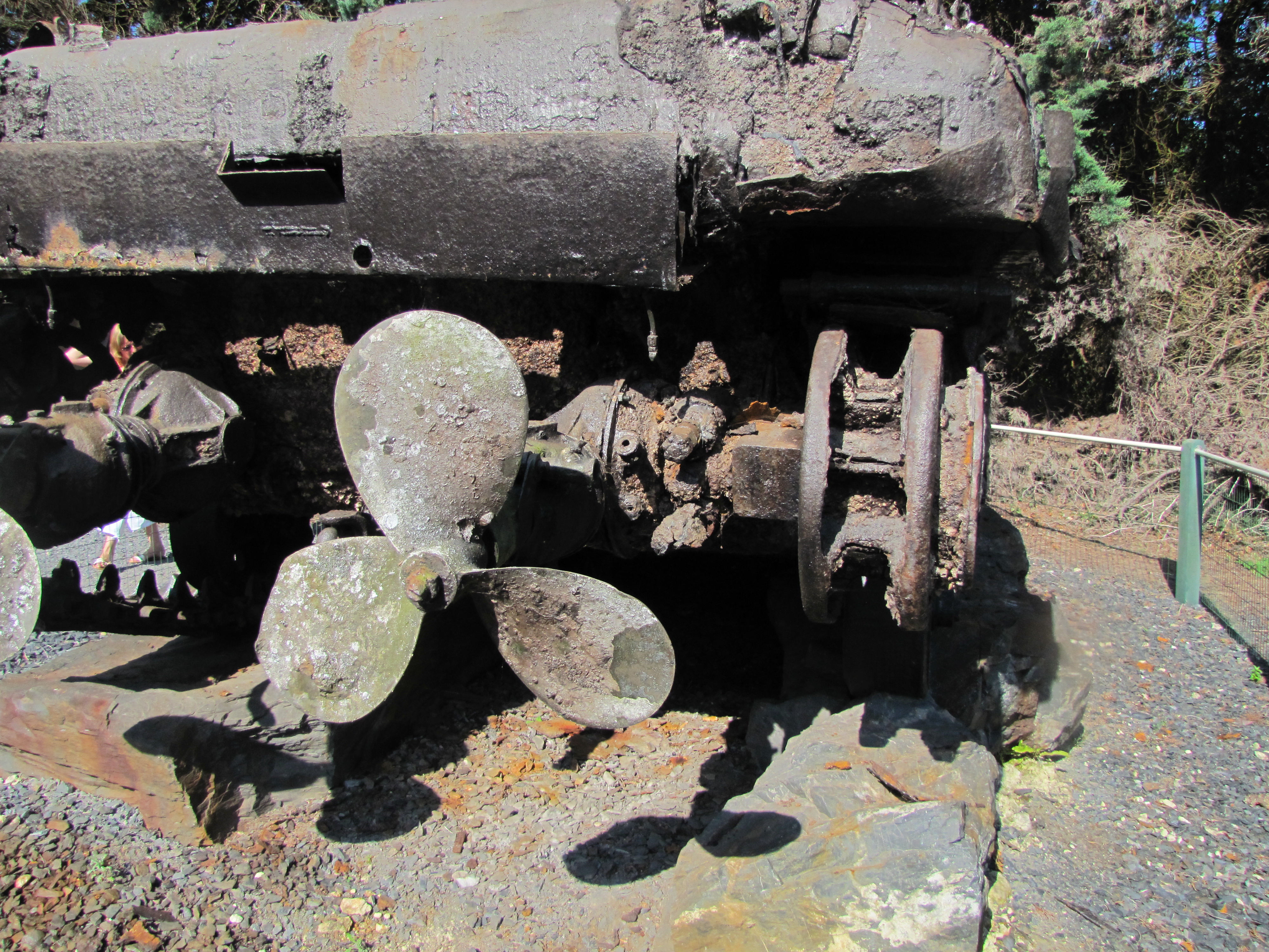

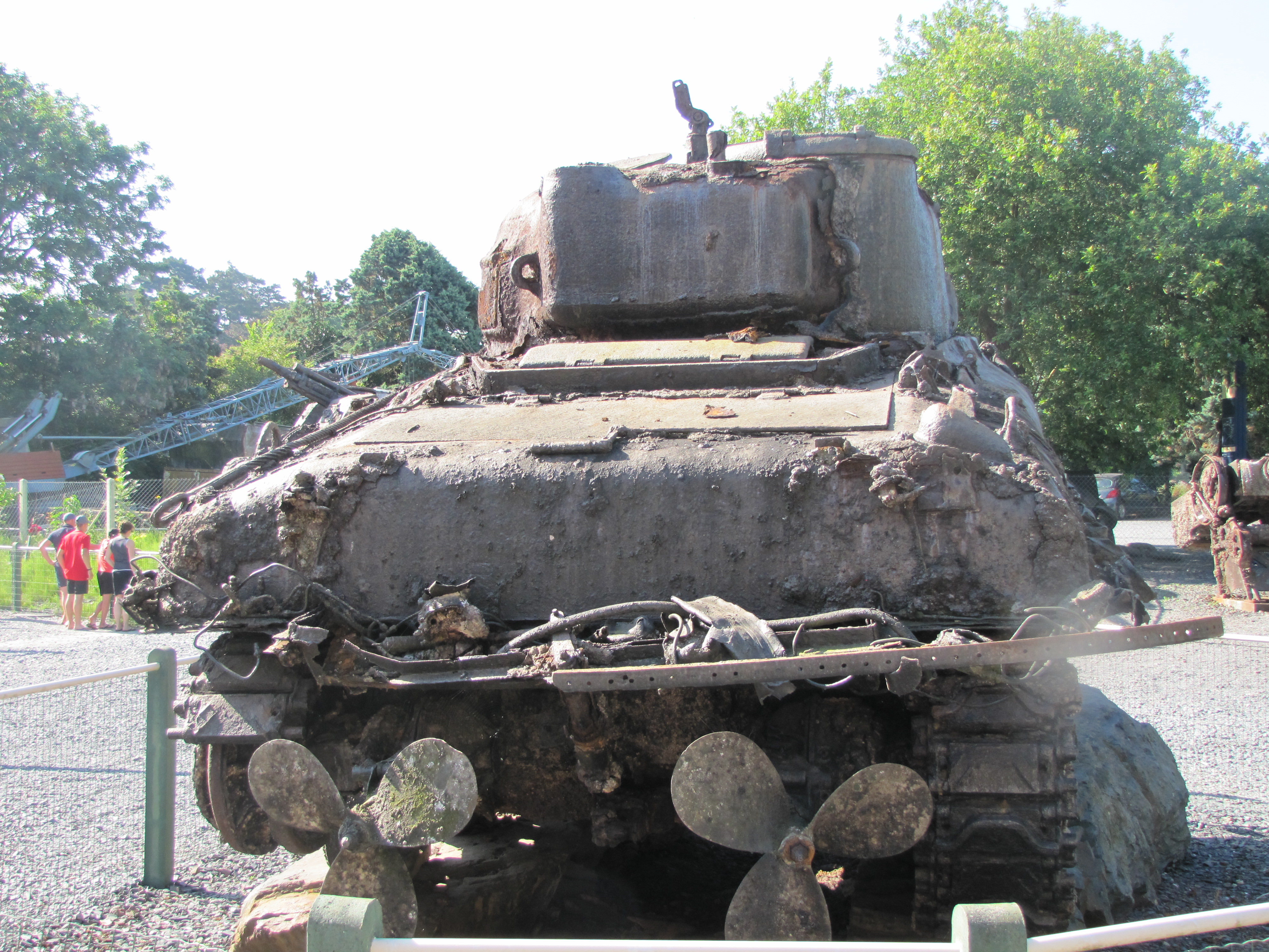

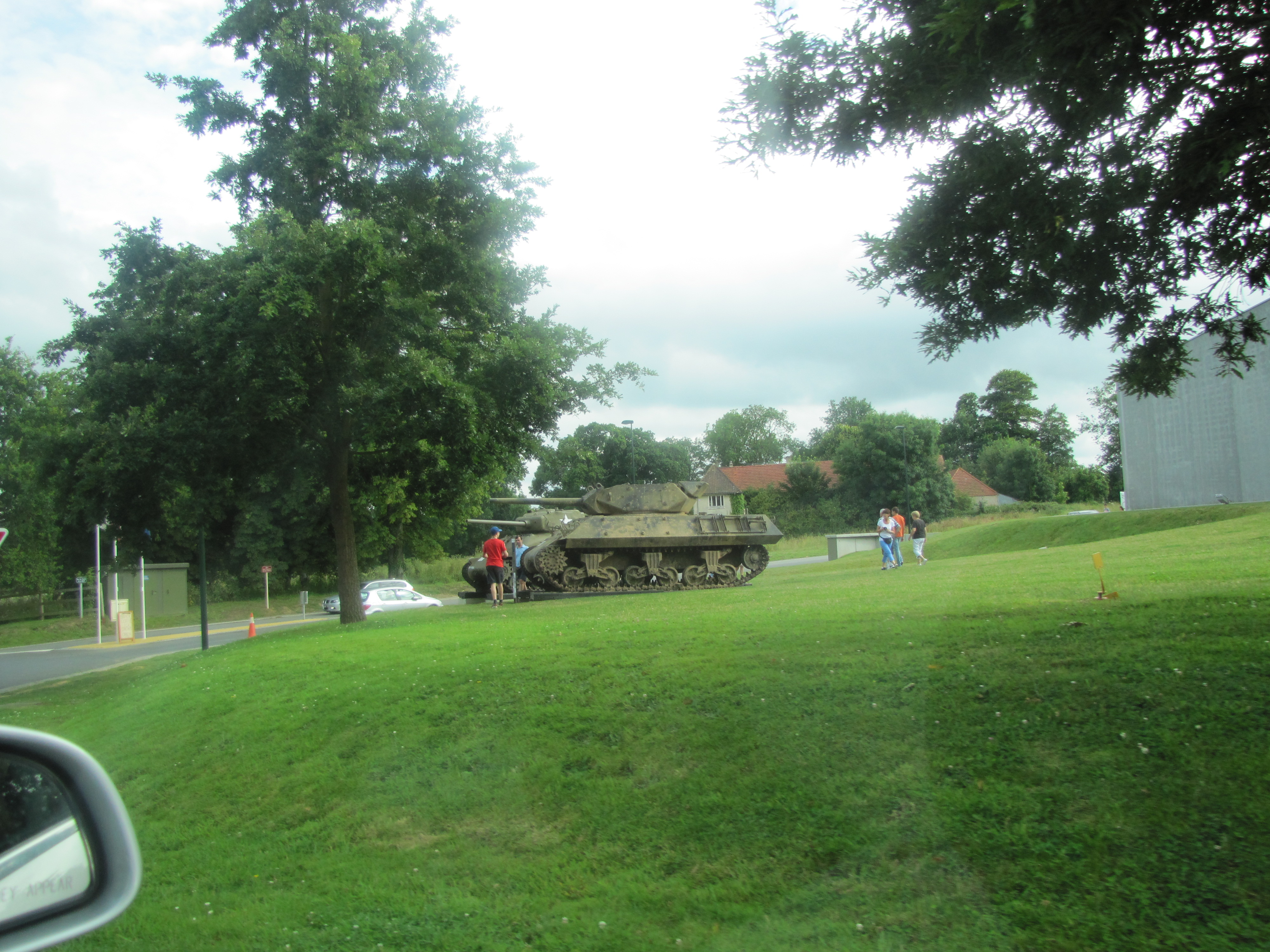

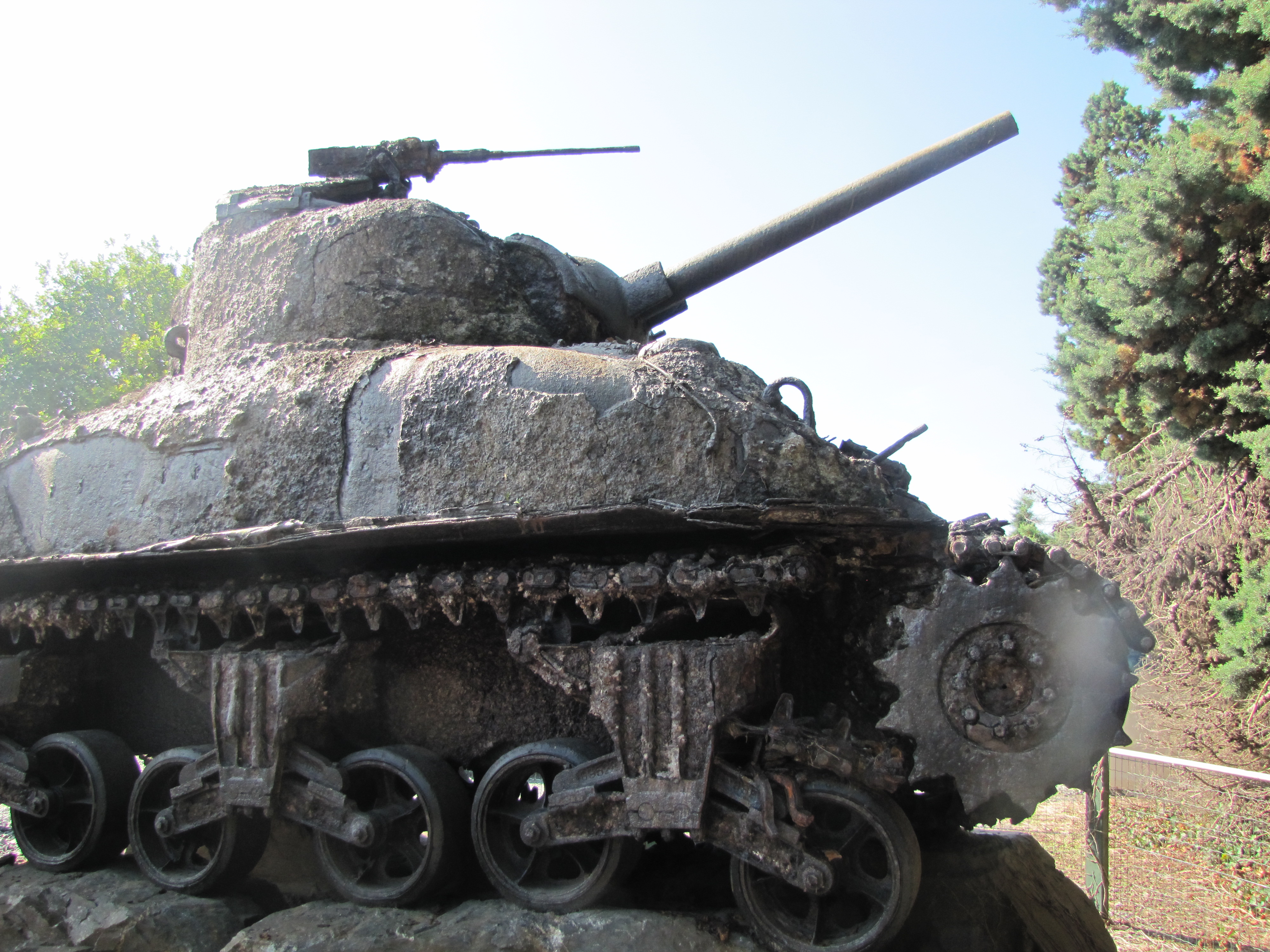

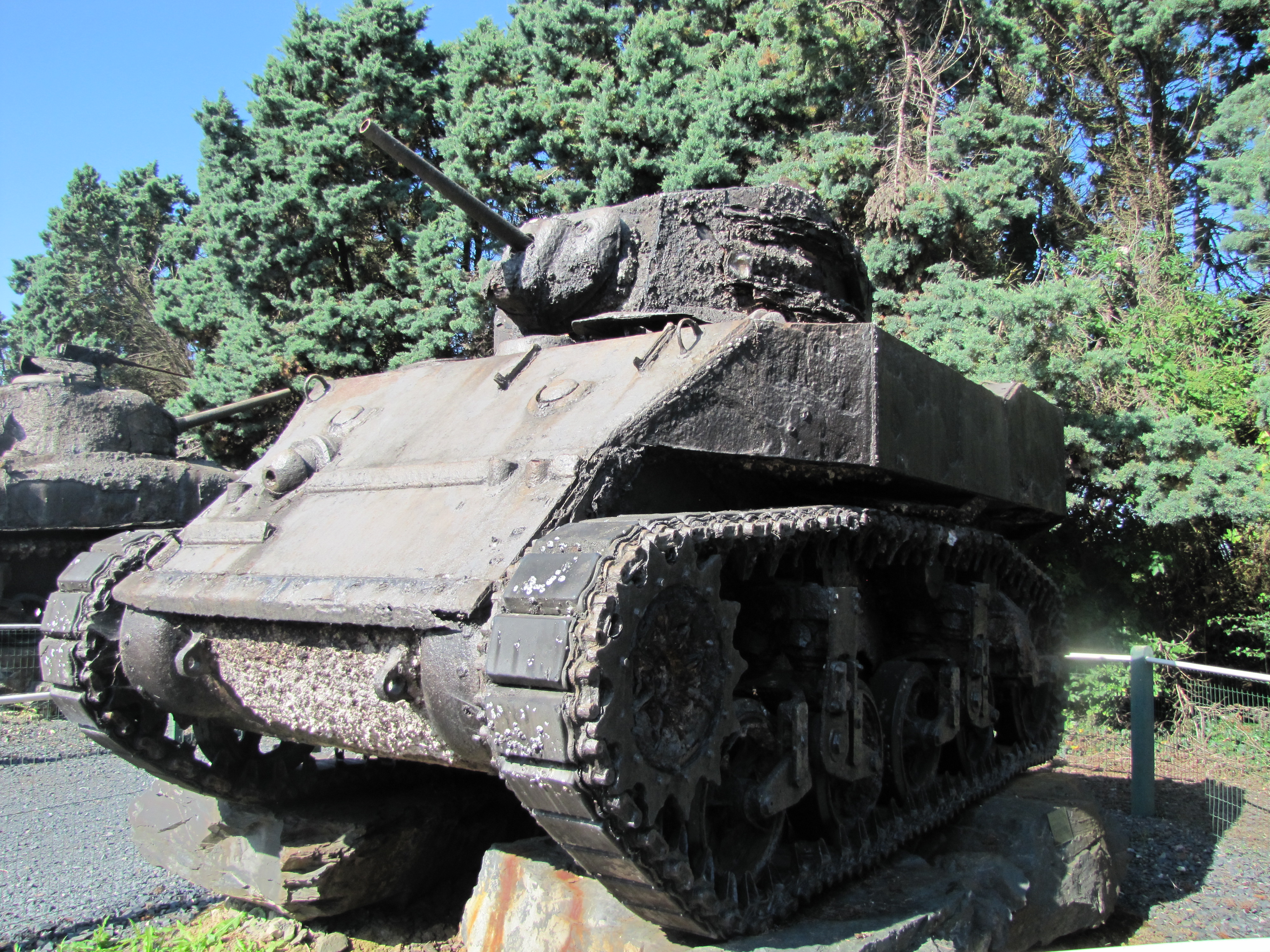

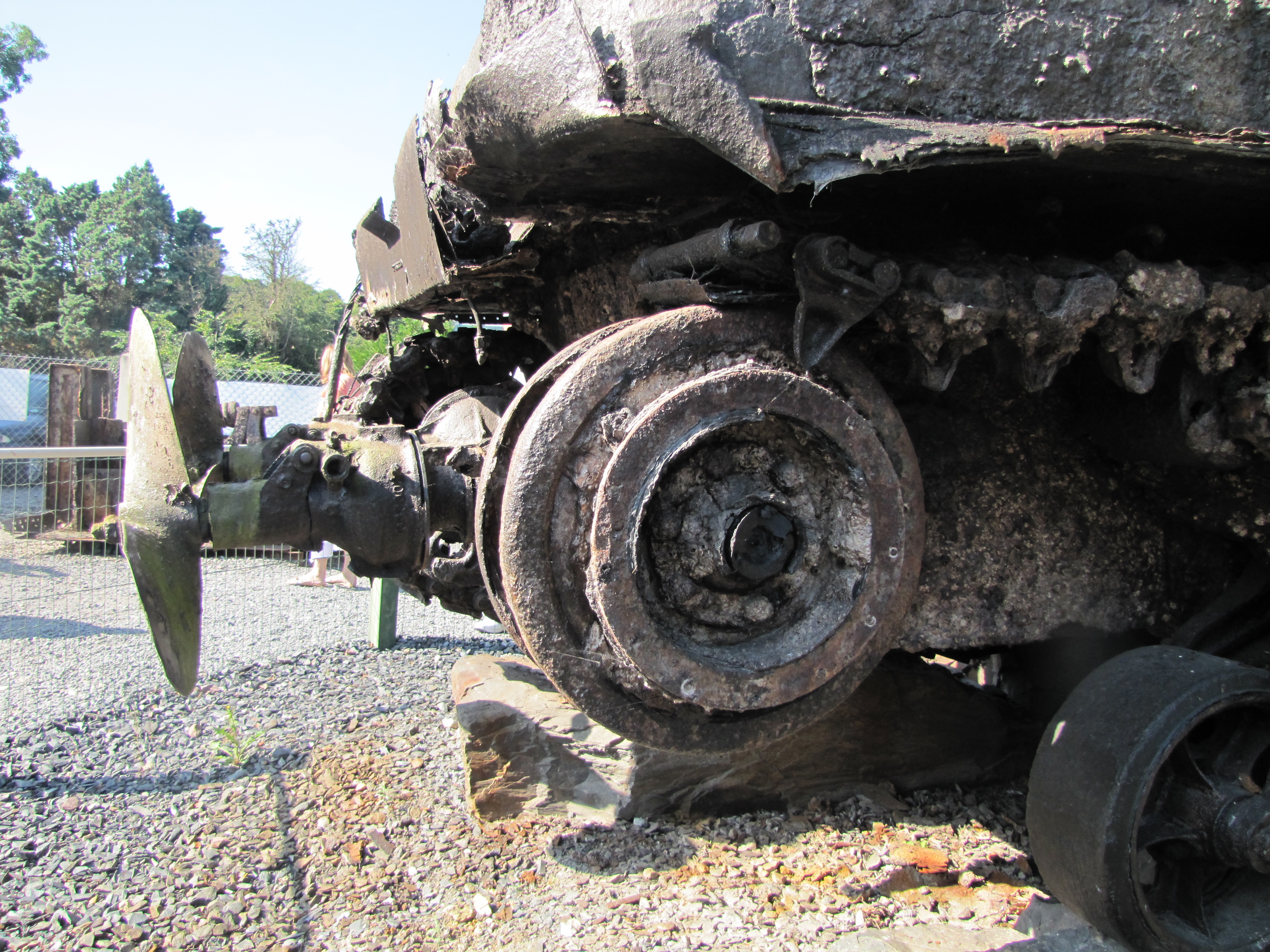

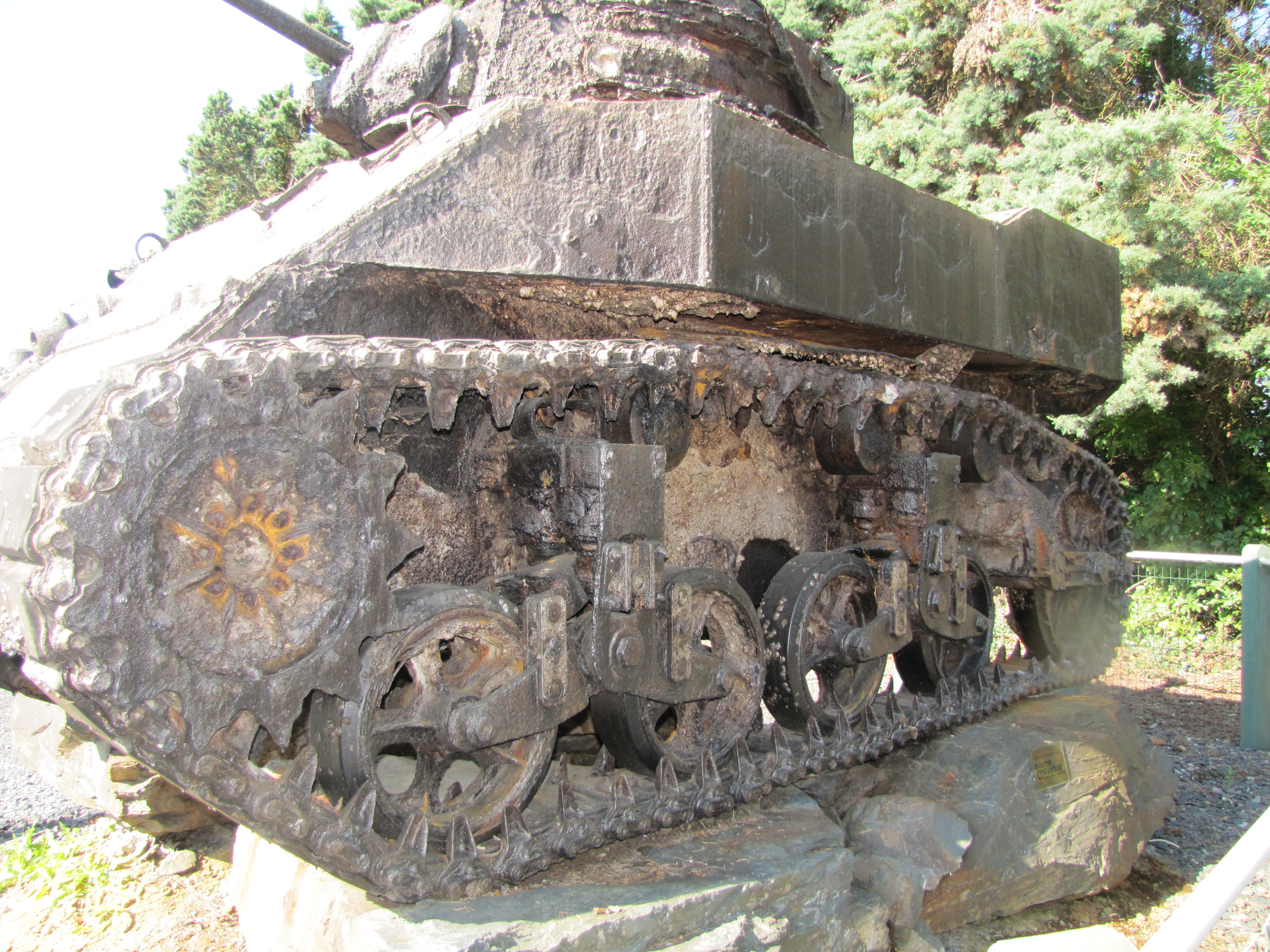

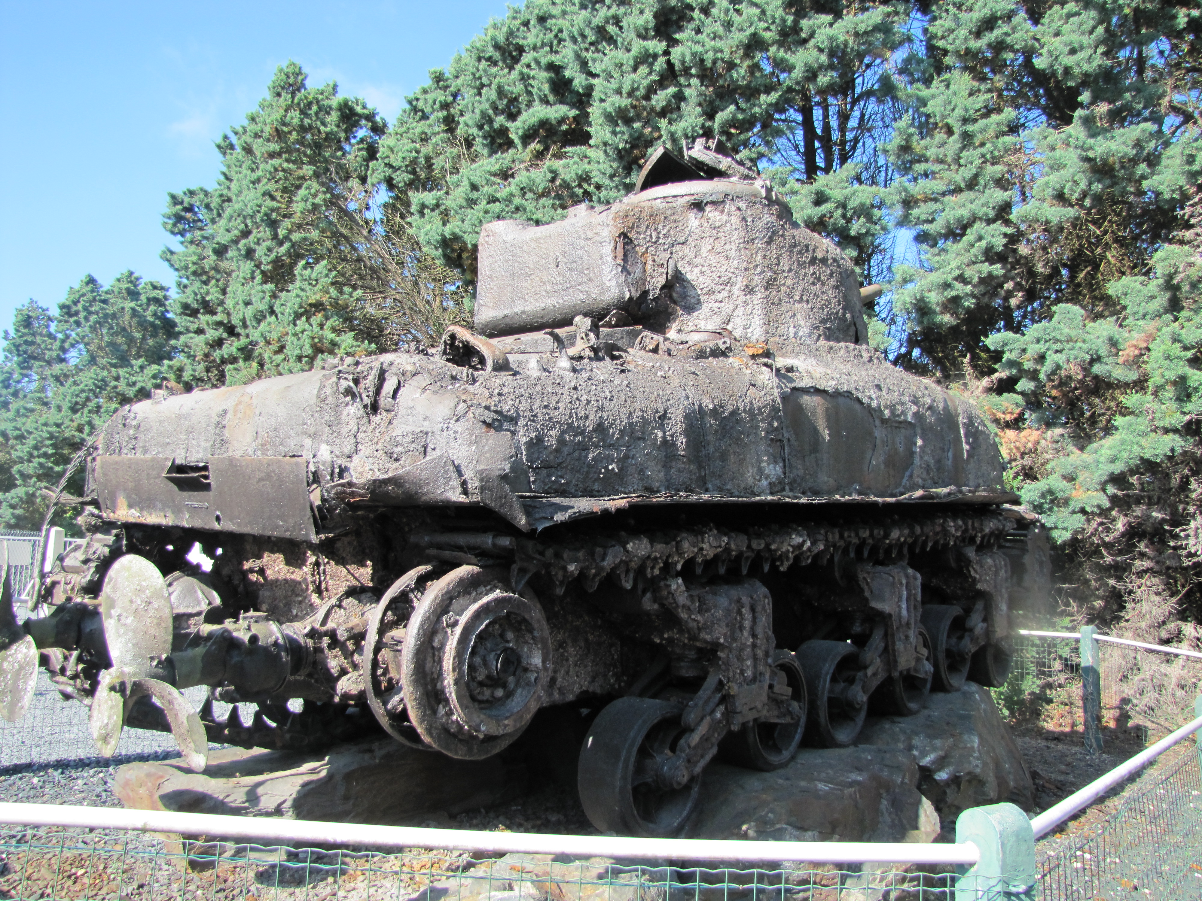

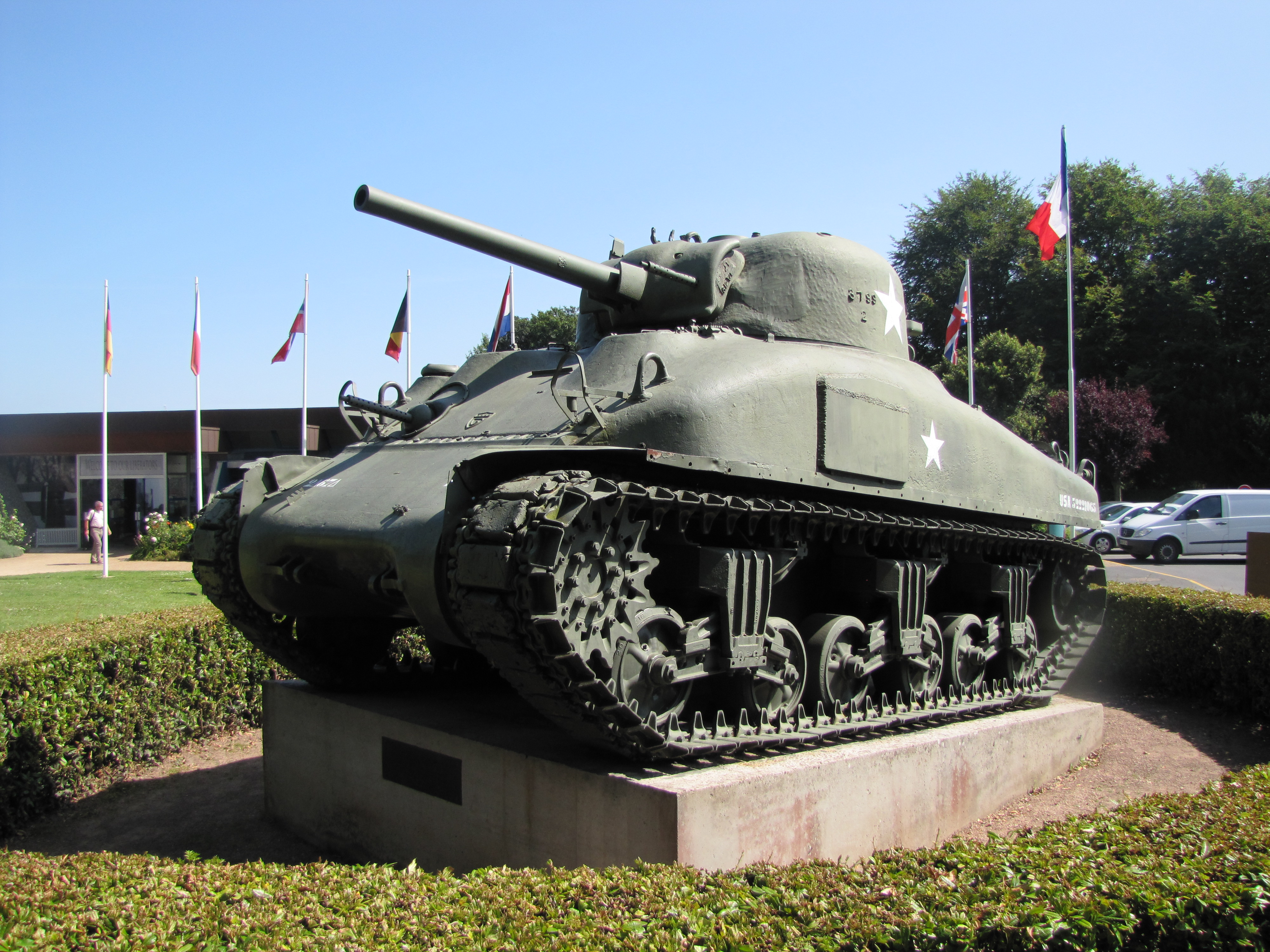

thecommander 08-12-2014 02:29 PM
13 Attachment(s)
Originally Posted by Ex_Pat_Tanker (Post 11859306)
With all the questions today, I figured it'd be best to get that all out of the way in one go :rolleyes:
Martin is VERY knowledgeable.... and loves Shermans.
Every museum we went to in Normandy last month had an "obligatory" M4 on display.
http://www.rcuniverse.com/forum/atta...mentid=2021868http://www.rcuniverse.com/forum/atta...mentid=2021869http://www.rcuniverse.com/forum/atta...mentid=2021870http://www.rcuniverse.com/forum/atta...mentid=2021871http://www.rcuniverse.com/forum/atta...mentid=2021872http://www.rcuniverse.com/forum/atta...mentid=2021873http://www.rcuniverse.com/forum/atta...mentid=2021874http://www.rcuniverse.com/forum/atta...mentid=2021875http://www.rcuniverse.com/forum/atta...mentid=2021877http://www.rcuniverse.com/forum/atta...mentid=2021878http://www.rcuniverse.com/forum/atta...mentid=2021879
He drooled over several Shermans at the wrecks of the English Channel Mus. to the point of dehydration. I saved him from the brink of death repeatedly.
http://www.rcuniverse.com/forum/atta...mentid=2021880http://www.rcuniverse.com/forum/atta...mentid=2021881
I have IR battled a few Tamiya tanks over the years but only started to battle my own M4 & M51 just this past spring. They are great tanks. I was very fortunate to learn much from him first hand Here are a few pix. More to come on my other Europe trip post. I want to thank Martin for meeting my family and I there and for joining me in exploring more of Normandy. I wish he were with me in Bastogne a week later as well. I still have more to see and do in Normandy....with the new museums that have opened or expanded..... the list gets longer ...not shorter.
