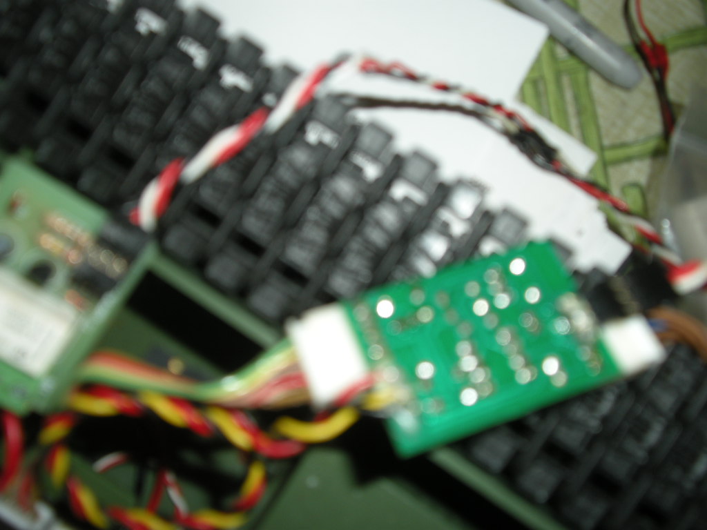

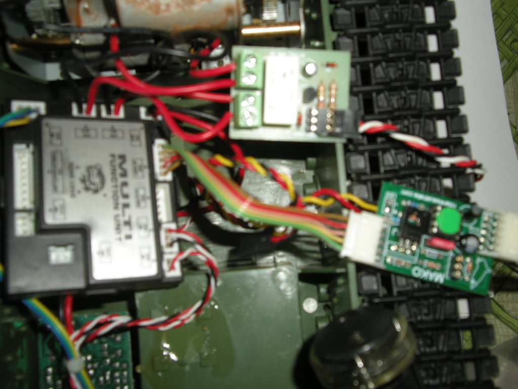

So I got bored and dug out a few old projects and misc electronic hardware I had purchased over the years. I have hooked up the MAKO and ATRC (1a) to a rX18 cpu. I still have the track recoil and super spin which supposedly be eliminated. The tank still acts like a crazy frog when firing the main gun or turning. the apple leds come on for 3 seconds like they are supposed to. If anyone has some intelligence or experience with this conversion, please check my wiring shown in the pics to see if anything looks wrong. i cannot find any info in the instructions that relates to "programming" the hop or spin, just the hits allowed.Near as I can tell I am wired as shown in the instructions. i do not have the Mamba board (loose yellow/red/black wire from the MAKO) but I should not need that unless I want to fine tune the speed decrease after being hit.
ok "rctanksaustraia" got back to mee ad identified a backwards hookup.
http://www.rcuniverse.com/forum/atta...mentid=2044011http://www.rcuniverse.com/forum/atta...mentid=2044012
