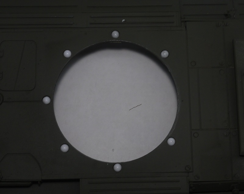

YHR 05-26-2015 06:49 PM
1 Attachment(s)
Here is what I did on my Cromwell
http://www.rcuniverse.com/forum/atta...mentid=2098886
Airsoft pellets were used as bearings with graphite powder as a lubricant.
