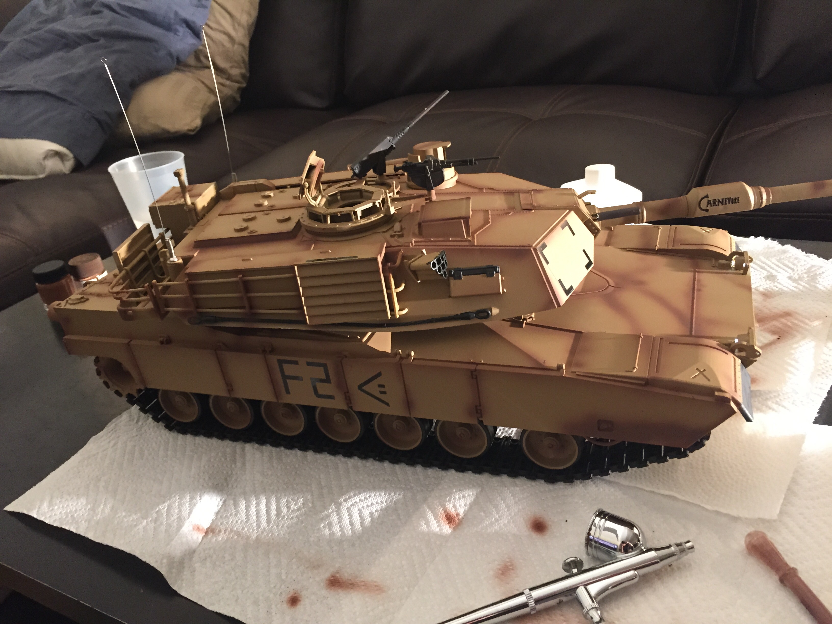

Step 1. Detailing
Step 2. Full metal package - tracks, wheels, sprockets, suspension
Step 3. Hi-po gearbox...the new red plate one with the blue motors. Looking for speed out of my Abrams since it is a fast tank in real life
Step 1 pics - not much to do really since they're all tan.
http://www.rcuniverse.com/forum/atta...mentid=2107889http://www.rcuniverse.com/forum/atta...mentid=2107891http://www.rcuniverse.com/forum/atta...mentid=2107892http://www.rcuniverse.com/forum/atta...mentid=2107893
Going to add a spare road wheel to the turret like on the real ones. I have some army bags and other turret detail items coming.
Thanks for looking!

I agree, keep us updated what you are doing. Detailing, Did you paint the entire tank then weathered it? Looks great. What airbrush are you using? I'm just reading up and practiced a little with cardboard and colored water. My HL Abrams came with the zinc metal gears, tracks & drive wheels. This is my first tank and learning too. I'm waiting to put in the IMEX drive gears, next time I crack it open.
jrbbikerx 07-13-2015 12:21 PM
I used some 1000grit scotch sand paper to very lightly sand the hull to knock off the shine then added the camo / rust detail
the black on it it 75% tamiya black and 25% grey to give it a lighter finish as if it were runner (on the front flaps, which are actually rubber on the real tank
