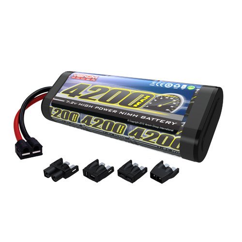

I use Venom 7.2V 4200mAh 6 Cell NiMH Battery with Universal Plug System.
Attachment 2216692
Good quality battery with very flexible lines and the connectors are rock solid.
