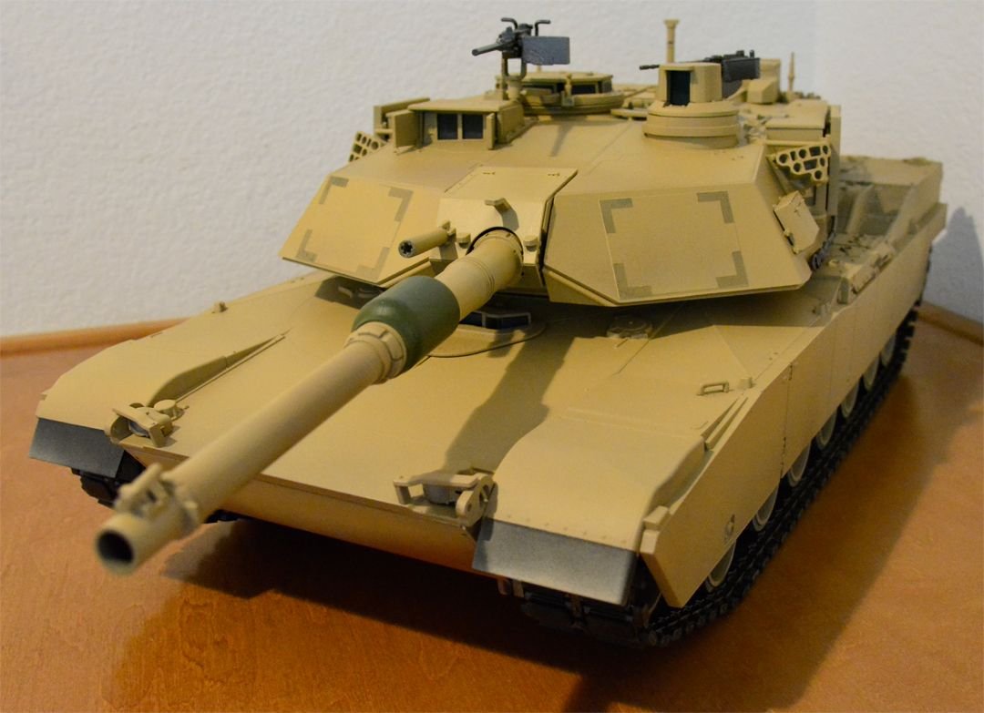

mine also shuts down when firing the main gun. I partially built the tank and havent finished it due to frustration. I am using the 2.4 futaba skysport . Its a great tank but the electronics arent the easiest to figure out
Tamiya USA is aware of the Futaba Skysport 2.4 compatibility issue with the Abrams Kit.
They offered me no solution or fix other than to suggest I change radios and that DID NOT work, because something else failed!
The Tamiya Attack Radio System did work ALL the transmitter tank functions normally, for about a dozen cannon fires and then it didn't!
I am 99.9% sure I have a faulty turret control unit and I think you do too!
Please contact Gary at Tamiya America about your Abram's turret control unit problem.

The fix!
The Tamiya USA email, May 4, 2018, below.
The gun firing shut down problem is fixed!
I did not have the rear light harness hooked up to the “chassis control unit”. So, my fault, builder error, but no mention of that in the assembly and or ops instruction manual. Now we know though, LOL. Enjoy, John

The following tips assume your model is setup per both manuals, everything is plugged in and "all operates to spec", but now it doesn't, with the TBU & LED Emitter installed!
1. Issue. Fresh Battery Swaps with the Tamiya Battle Unit and LED Emitter plugged into the Turret Control Unit.
Your Abrams now shuts down after firing the main gun. The work around FIX: The model is turned off. With the fresh charged battery connected, unplug the Tamiya battle unit receiver base and the LED Emitter from the Turret Control Unit and then correctly plug them both back in. This procedure will restore firing the main gun, without the resulting shut down.
2. Issue. The volume control at the Chassis Control Unit is turned up as loud as possible. When firing the main gun, the model shuts down. The work around FIX: Lower the volume slightly, until the model does not shut down after firing the main gun.
3. No clue as to why these two glitches occur, but at least there is a work around solution without out having to suffer through Tamiya USA's email nonsense!

Well, everything works on the Abrams, except, I have had to dial back the turret rotation on my Airtronics radio. Anything above 50% on the channel setting the turret rotates non stop in the direction I signal and continues until the switch activates, the sound shuts down and the tank basically resets itself. It is an out of control rotation. Even at 50% if I firewall the stick in any direction it's rotation is out of control. I do have the Tamiya radio coming today, that should solve the issue, I can't understand why this is an issue though.
Pcomm1.v2 06-29-2018 08:48 AM
I experienced the same glitch using a Futaba Skysport 2.4 radio system. After switching to the Tamiya Attack 2.4 with the “updated” receiver that strange issue went away. What remained was the main gun firing, tank shutdown issue using the Tamiya Attack Radio. Besides NOT having the rear lights hooked up, my builder bad, the kit’s Chassis Control Unit was faulty. Tamiya USA emailed me an additional rc setup instruction, which is DO NOT fire the main gun until all components are hooked up! They stealthily replaced my Chassis Control Unit (the board in the hull), whatever, the Abrams works now.

Made the switch to the Tamiya 2.4ghz radio. It still has the rotation glitch if I hold the stick too long, so I have to move it a bit at a time. I have no idea why this is happening. It is like it just doesn't want turn off. When this happens it occasionally doesn't want to turn the other direction. This is clearly a Tamiya electronics issue. I have done the setup as per instructions and I am using their radio, so that is not the reason.
Pcomm1.v2 06-30-2018 11:06 AM
Question, you did not fire the main gun until every rc set up task was completed? If so, I think your kit’s turret control unit and the chassis control unit are at fault and require replacement. Contact Tamiya USA and request replacements. Be prepared to send them both your units.

Figured it out. It was the turret rotation limiter switch. I have never seen Tamiya use it before. I noticed that the runaway rotation started at either the 10 or 2 position during the rotation no matter how slow I rotated it. If it started at the 2 o'clock position it would run to the 10 o'clock position and visa versa. Double checked the plug in location, promptly shook my head and realize reading the other manual helps. I had plugged it into the wrong 2 pin location. Corrected! All is running perfect! This was not a Tamiya error but a builder error.
