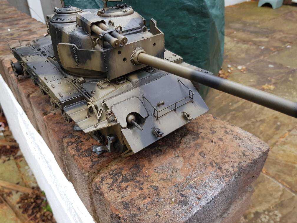

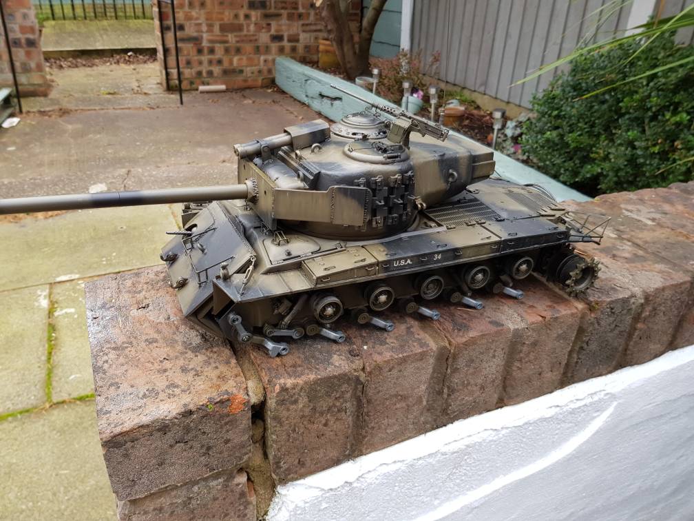

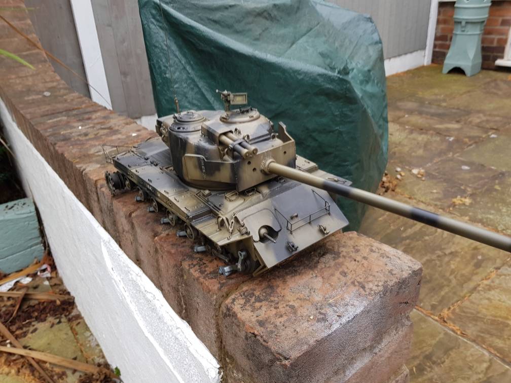

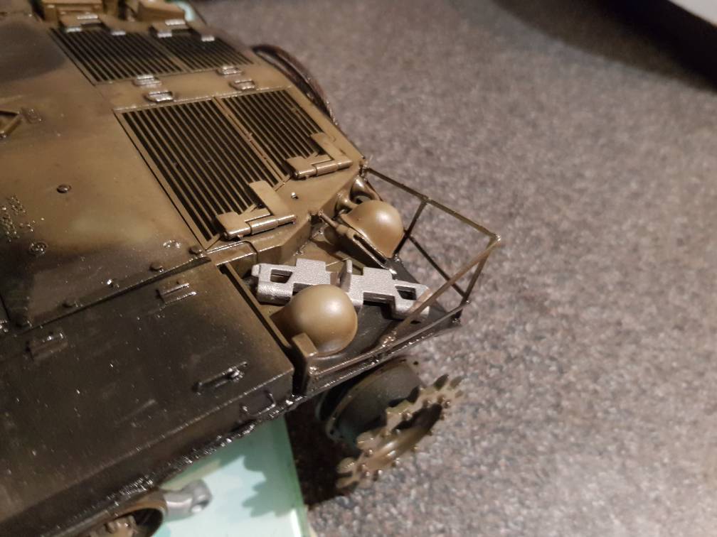

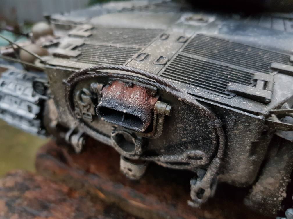

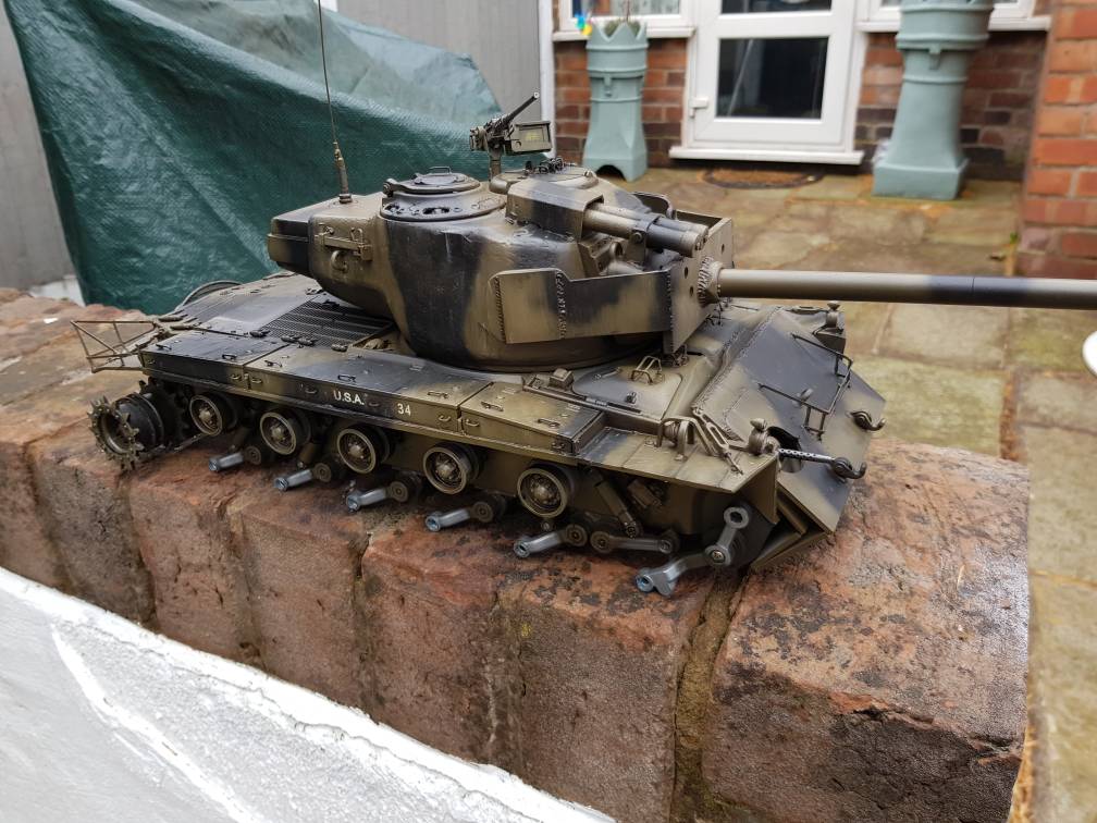

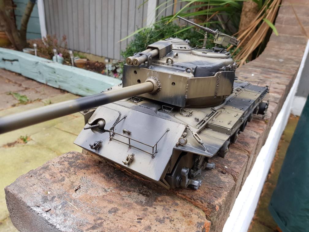

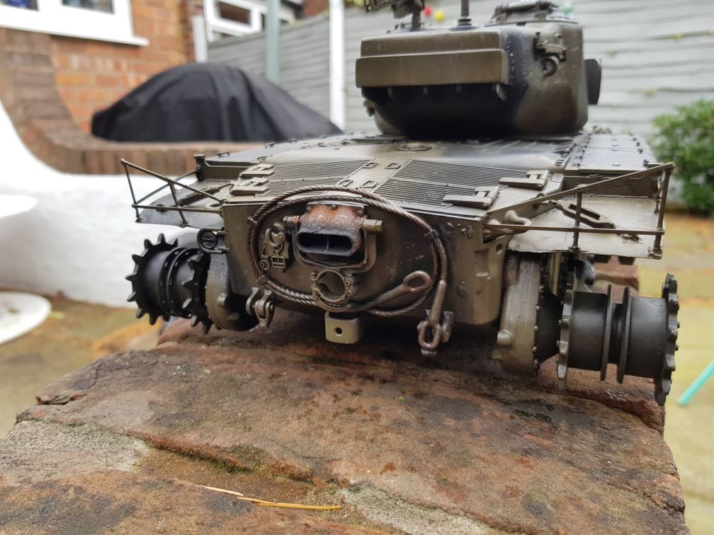

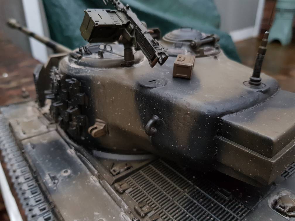

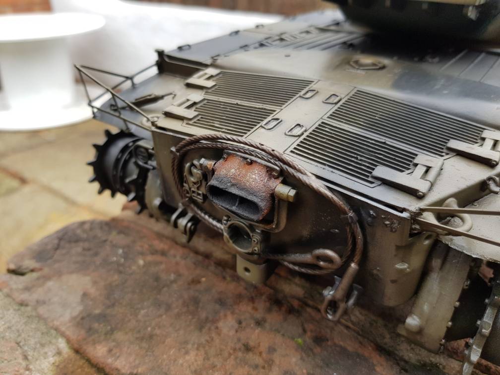

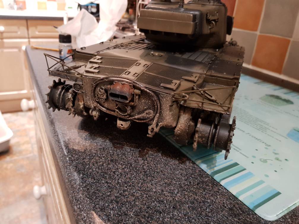

Started on the weathering, streaking and dot filters. This was complicated by some issues with the paint, the ammo colours I used are acrylic but some how the when it soaked in the turpentine I used to streak the oils just took the paint off down to the primer. This meant I couldn't manipulate the oils to the extent I normally would. I think a coat of future and then testors dullcote should give the finish some more resilience and give a base to finish weathering. I've also painted the tow cables, rusted the exhaust, machine gun and done some.other touch ups. Attachment 2262702Attachment 2262703Attachment 2262704Attachment 2262705Attachment 2262706Attachment 2262707Attachment 2262708Attachment 2262709Attachment 2262710Attachment 2262711Attachment 2262712Attachment 2262713Attachment 2262714Attachment 2262715Attachment 2262716Attachment 2262717

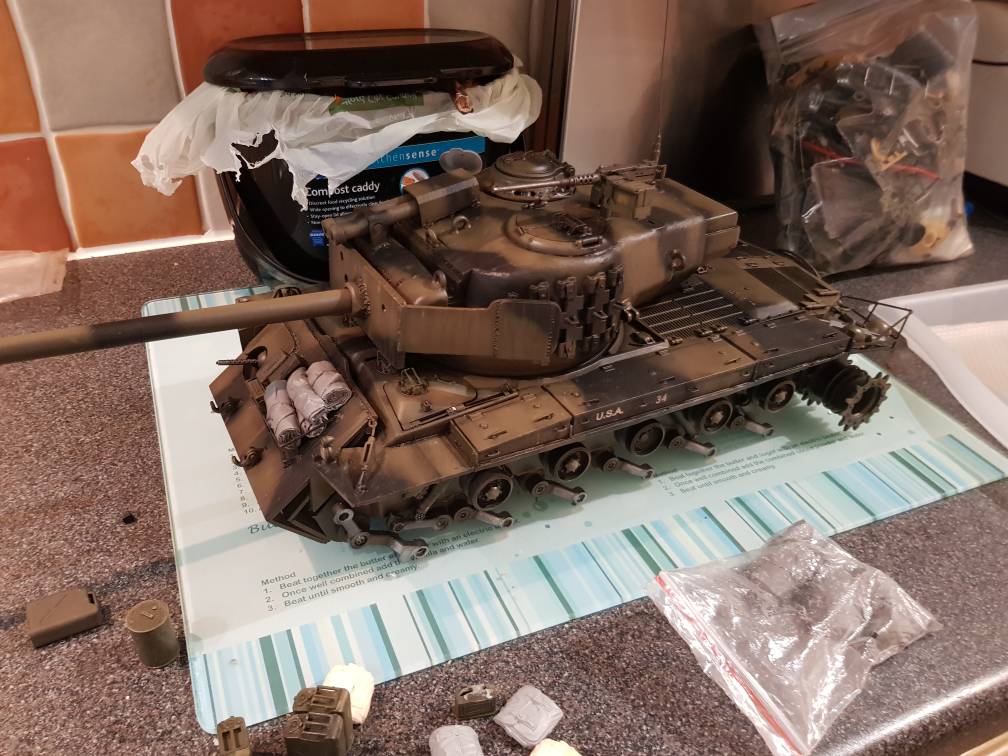

tomhugill 11-25-2018 09:19 AM
4 Attachment(s)

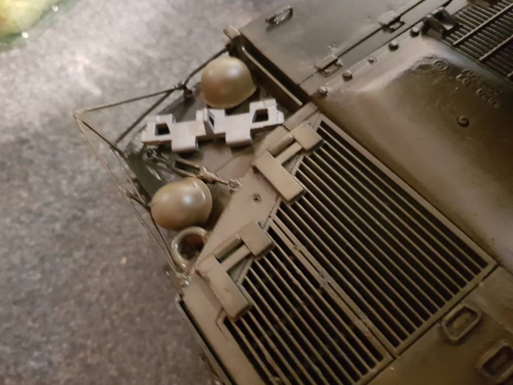

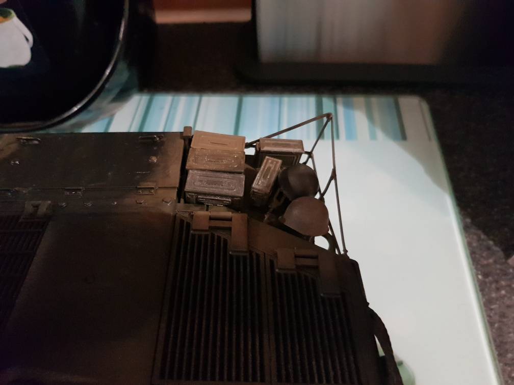

Toying with the stowageAttachment 2262718Attachment 2262719Attachment 2262720Attachment 2262721

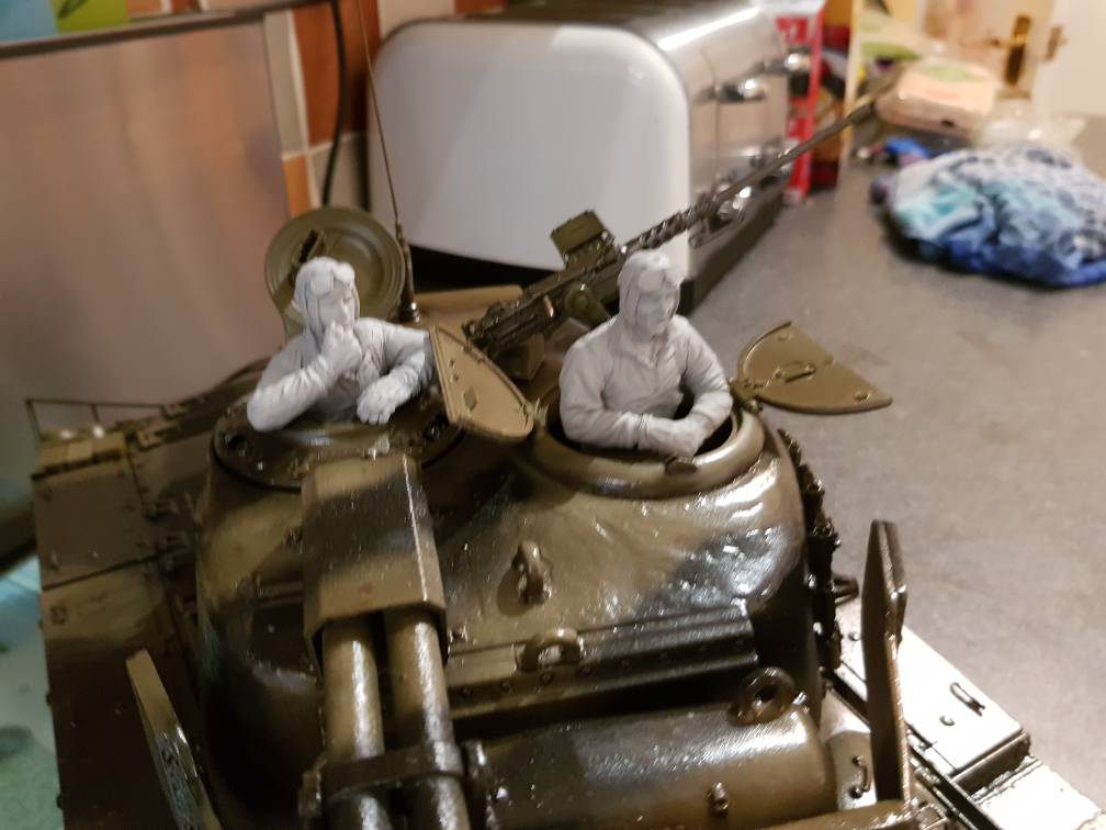

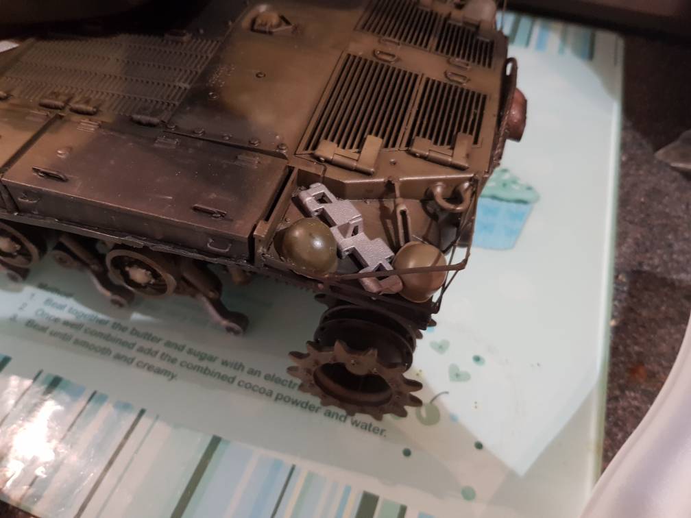

tomhugill 11-28-2018 09:46 AM
9 Attachment(s)

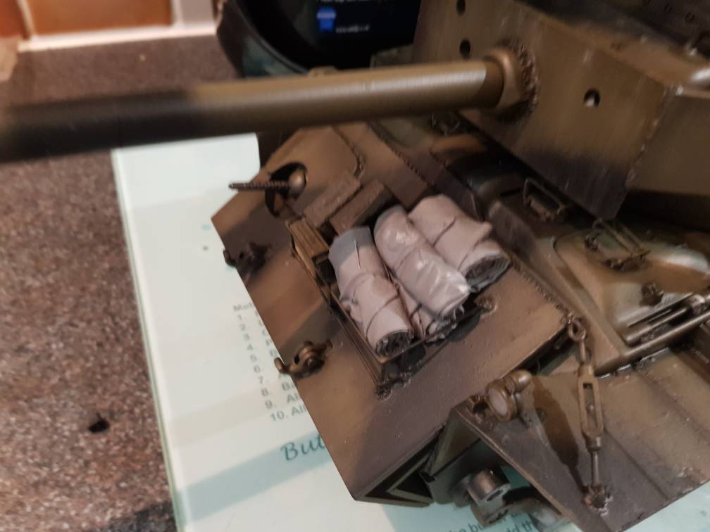

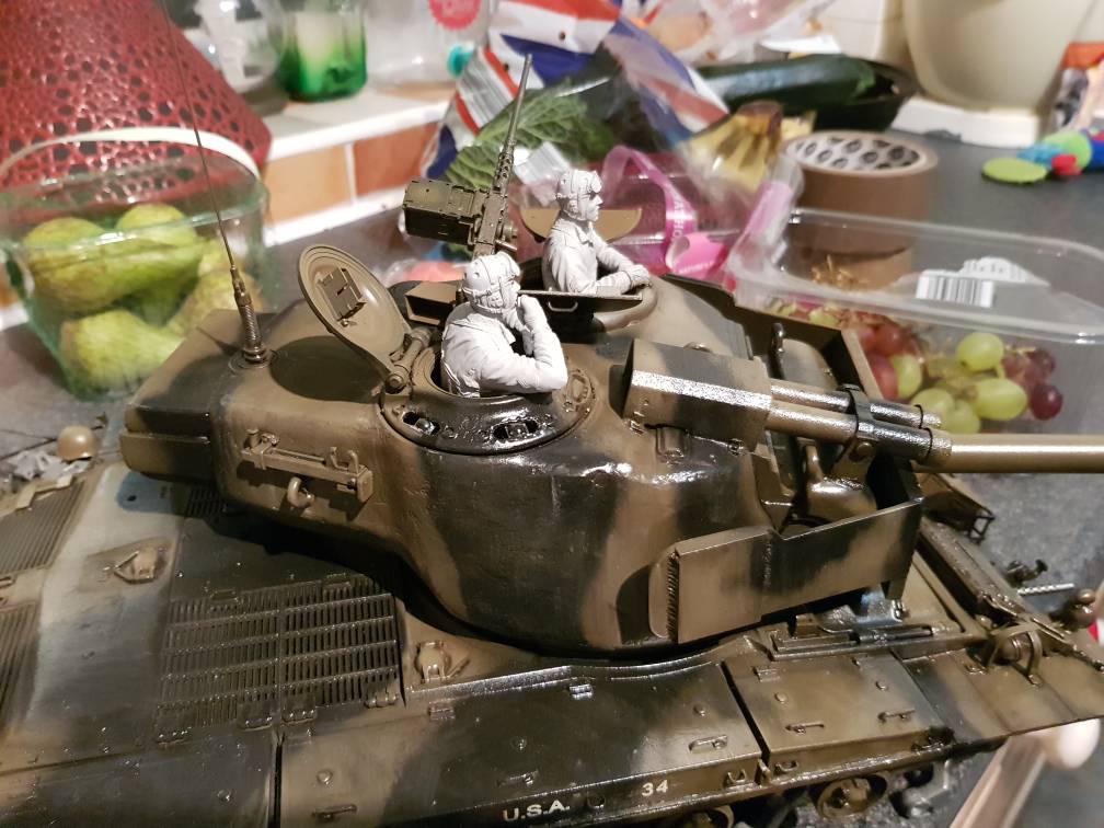

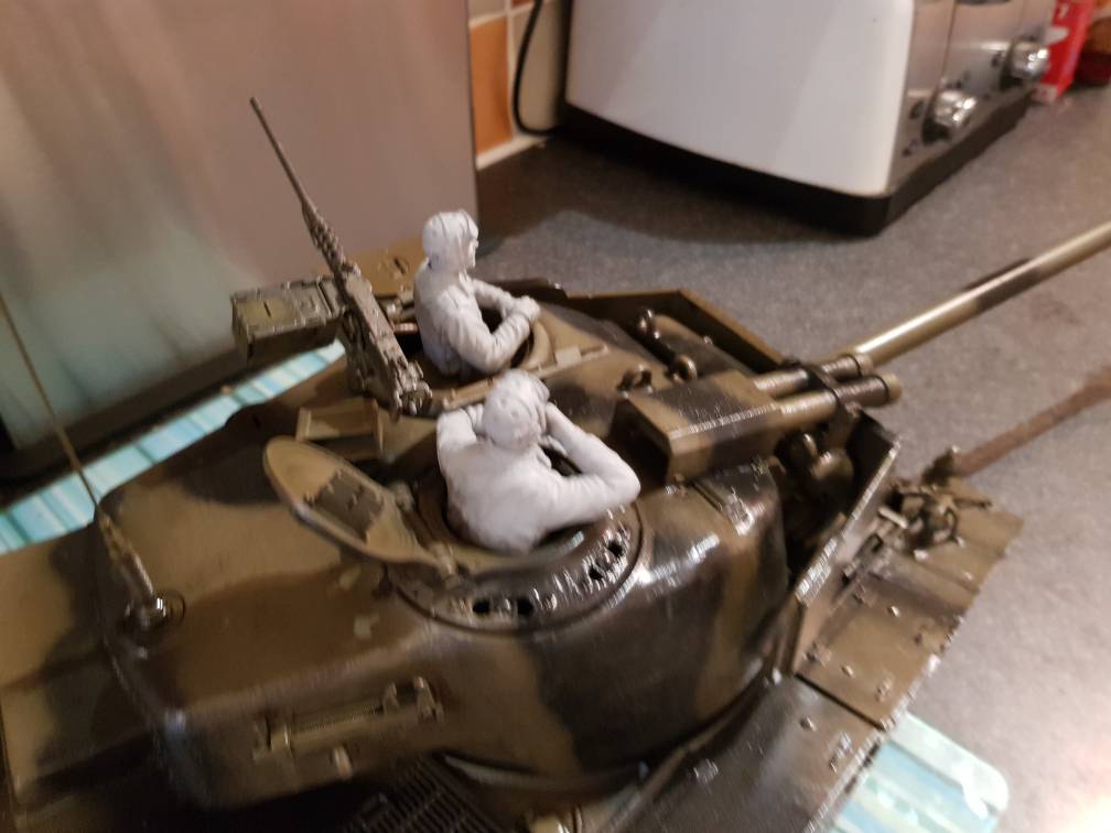

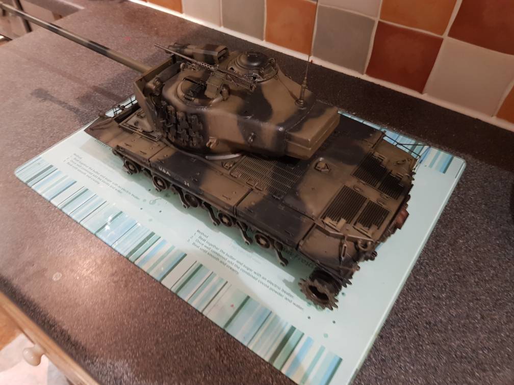

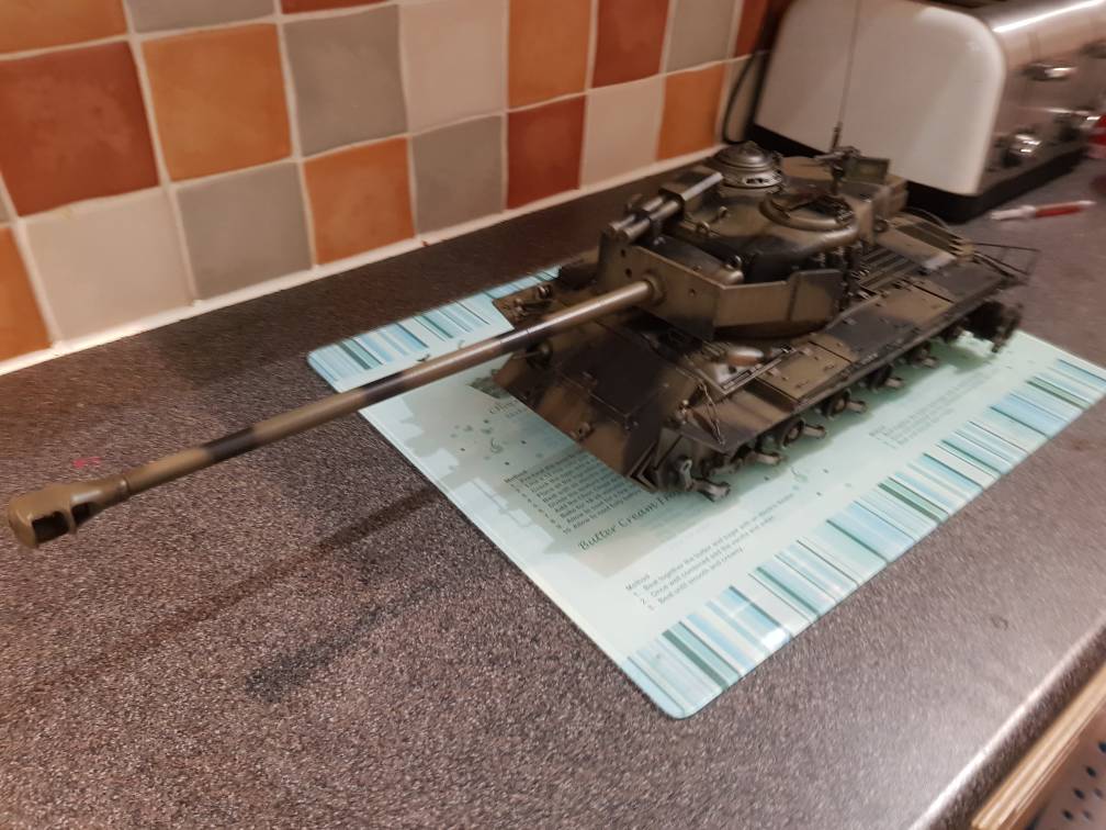

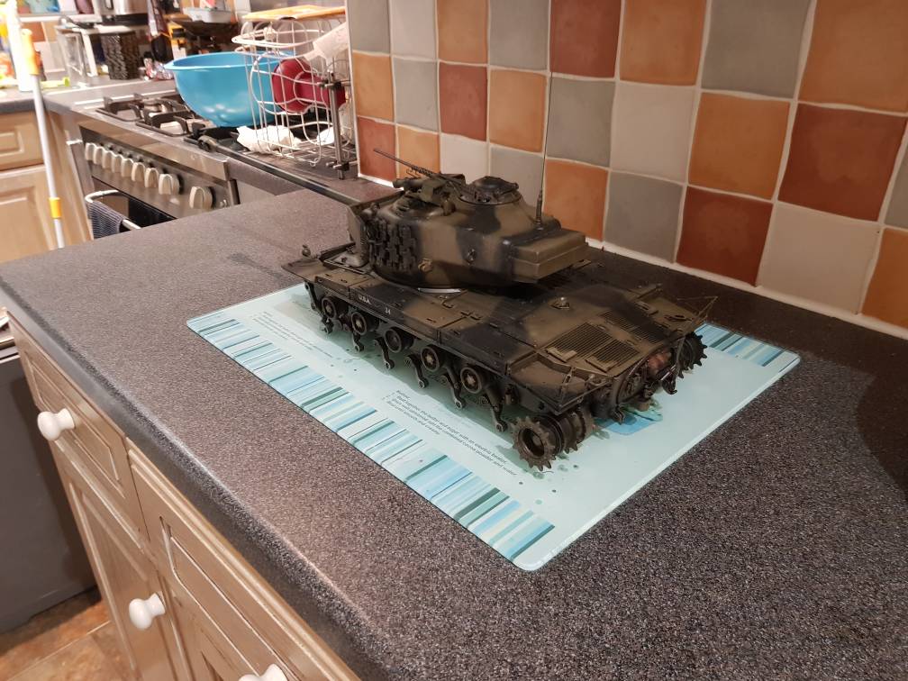

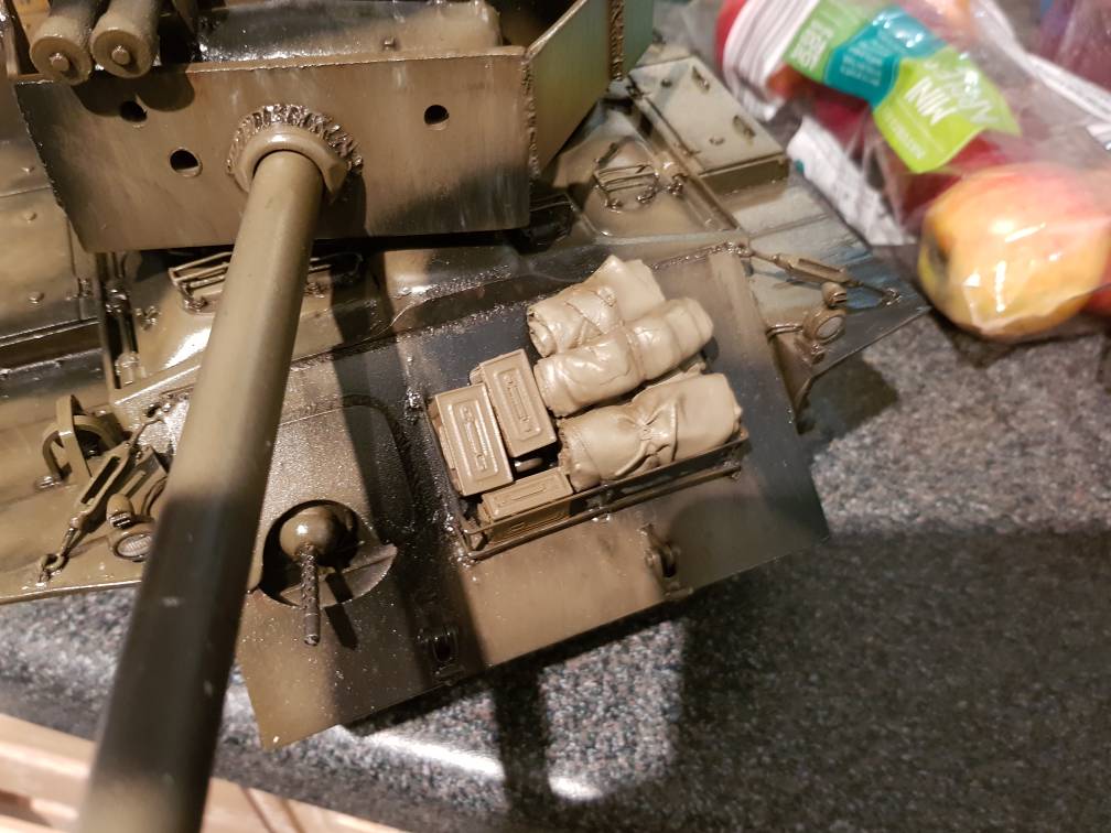

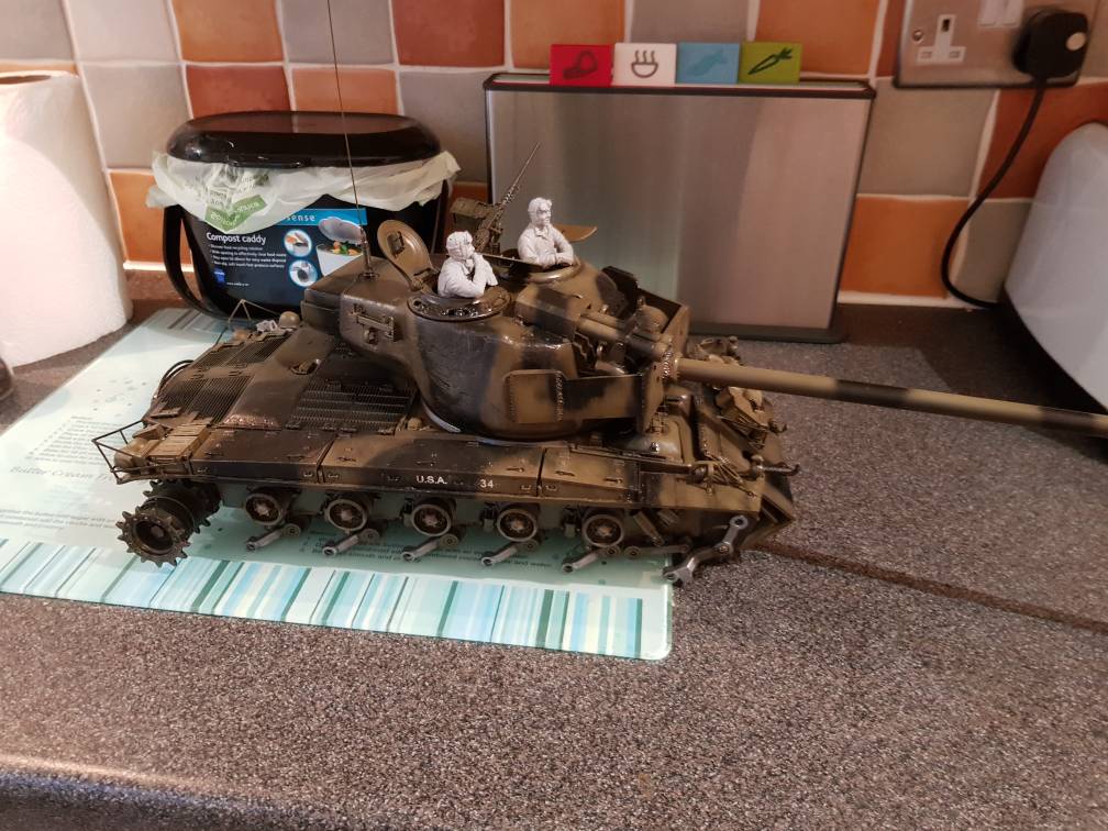

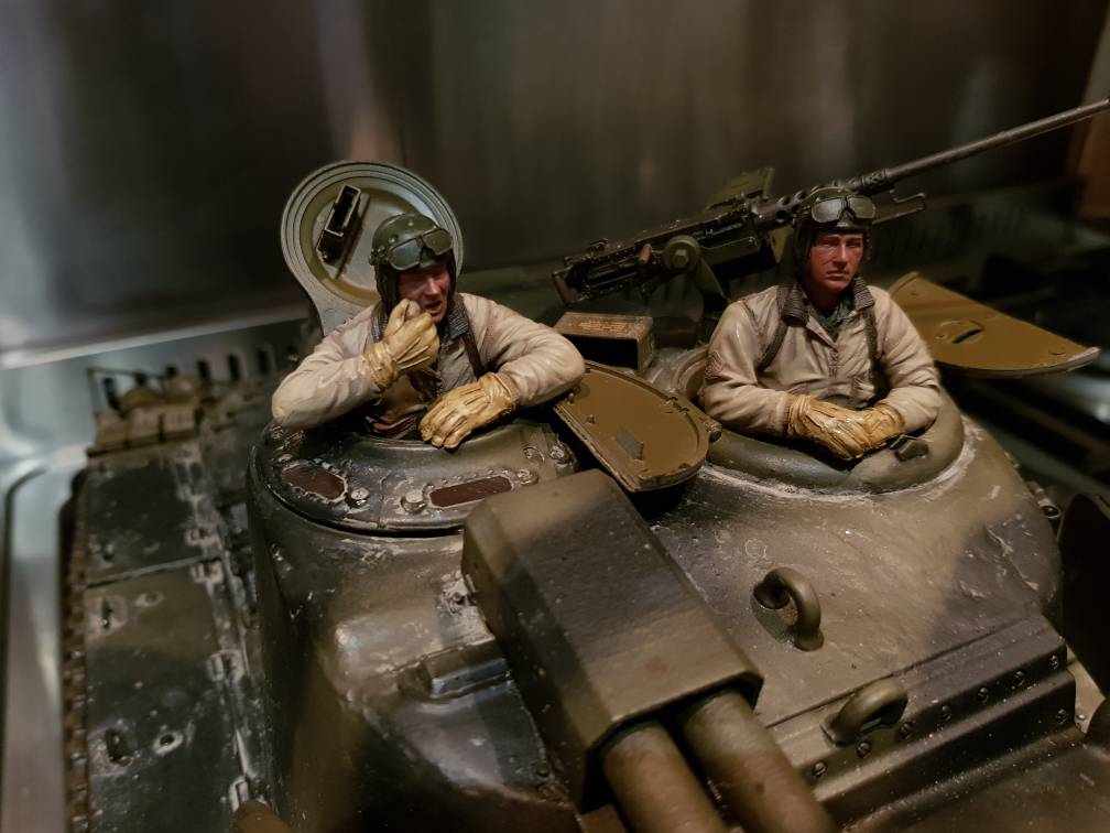

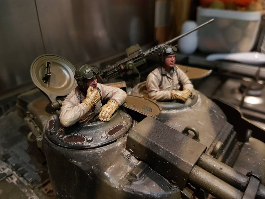

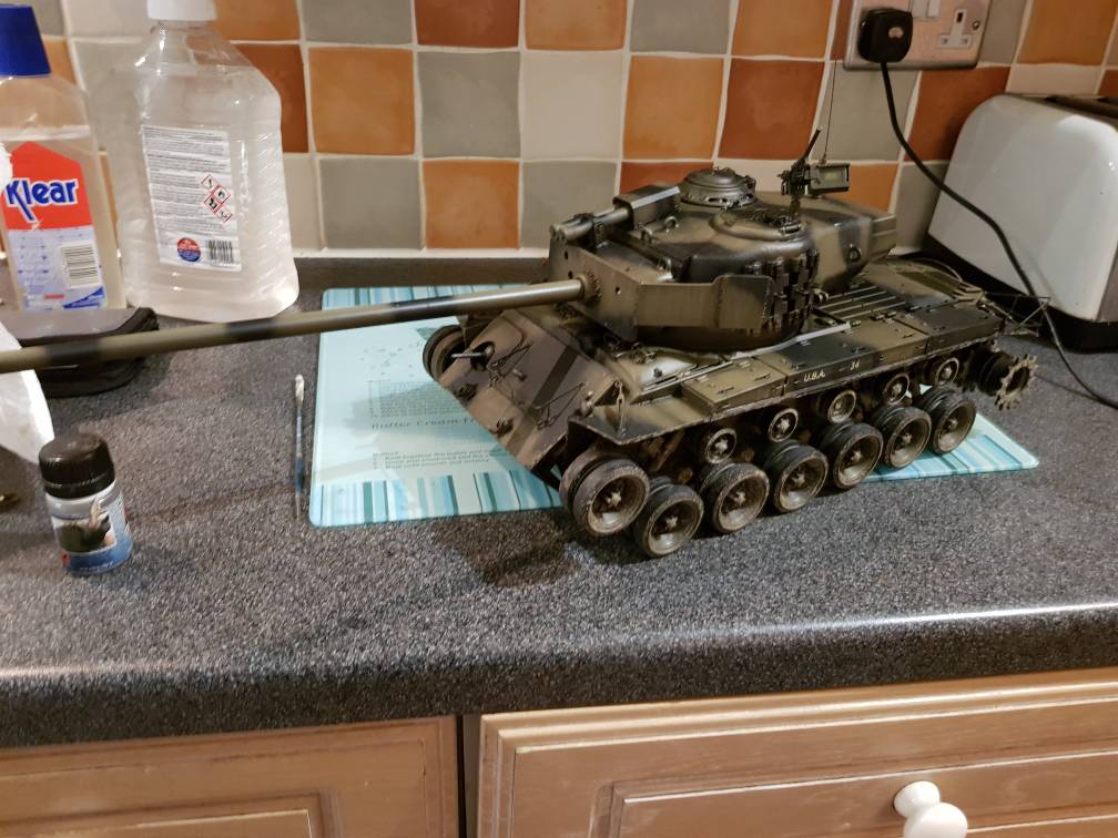

Thanks Erik! Hey guys, little bit more progress on the super Pershing, I was having issues with the turpentine stripping the top coat, so I found some original formula Klear (future) so am using that to seal her before I continue.
Whilst I'm waiting for my testors dullcote to arrive I made a start on the stowage, I had hoped to use it to add some variation to the model but all the references I could find showed that they should be OD, I'm still trying with trying the famous of and some mixes of the two to add variation.

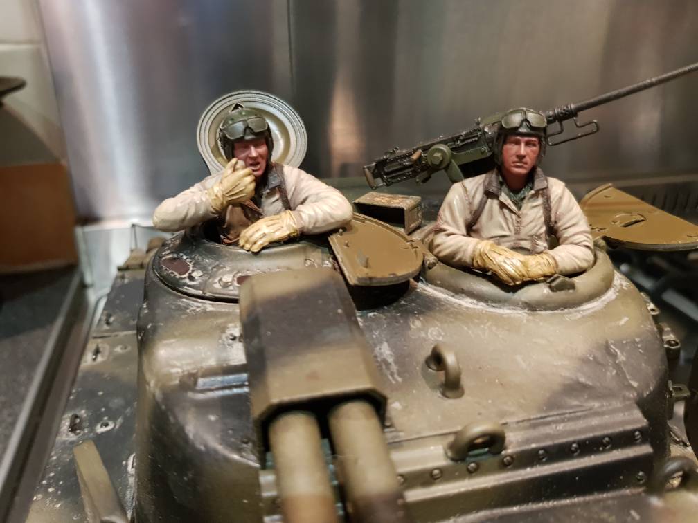

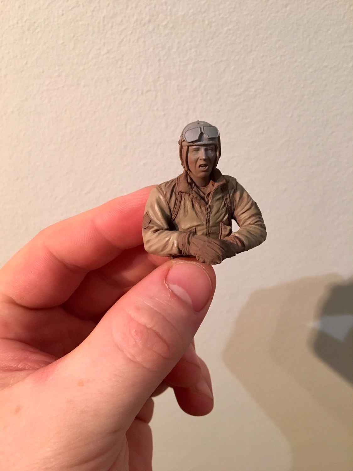

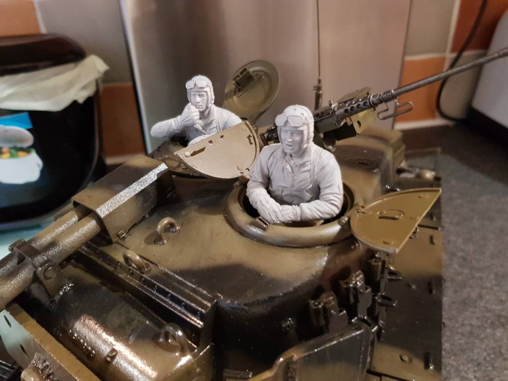

Also I've added half of the sol Sherman crew. These resin figures are superb, they fit perfectly and should add some extra interest to the model. Attachment 2262756Attachment 2262757Attachment 2262758Attachment 2262759Attachment 2262760Attachment 2262761Attachment 2262762Attachment 2262763Attachment 2262764

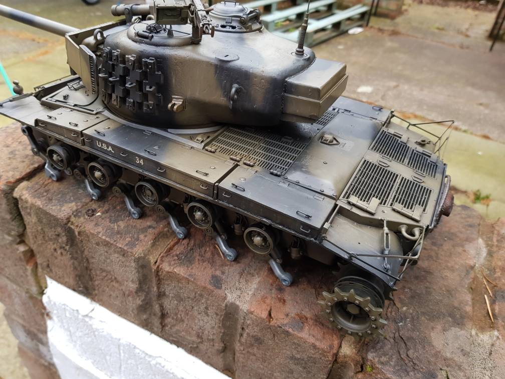

tomhugill 11-28-2018 09:47 AM
5 Attachment(s)

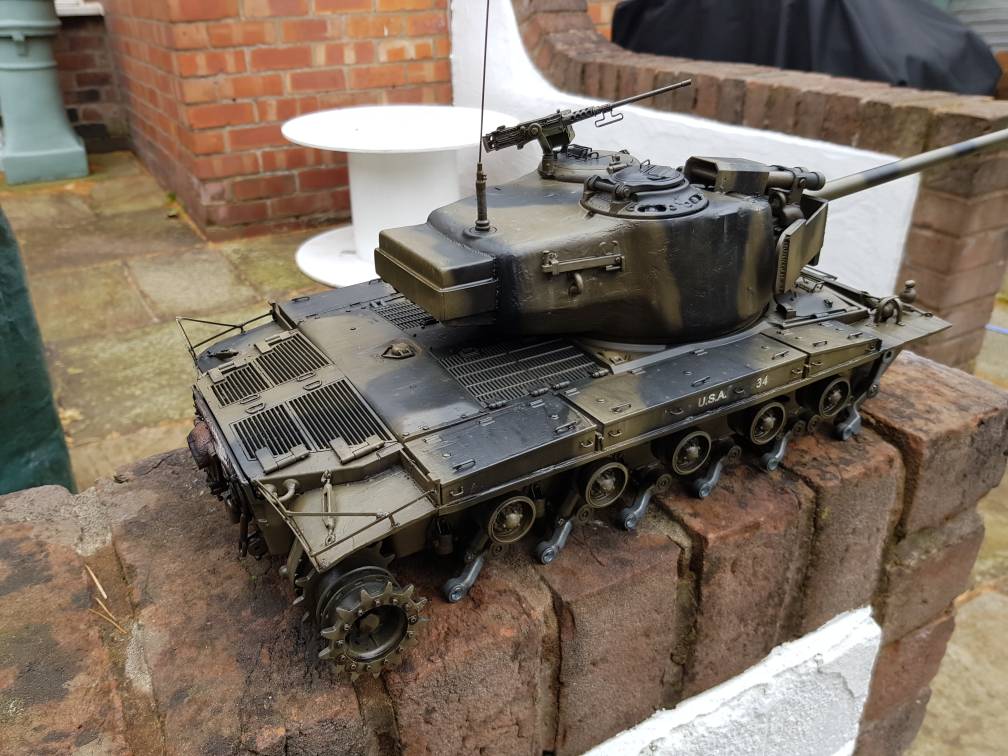

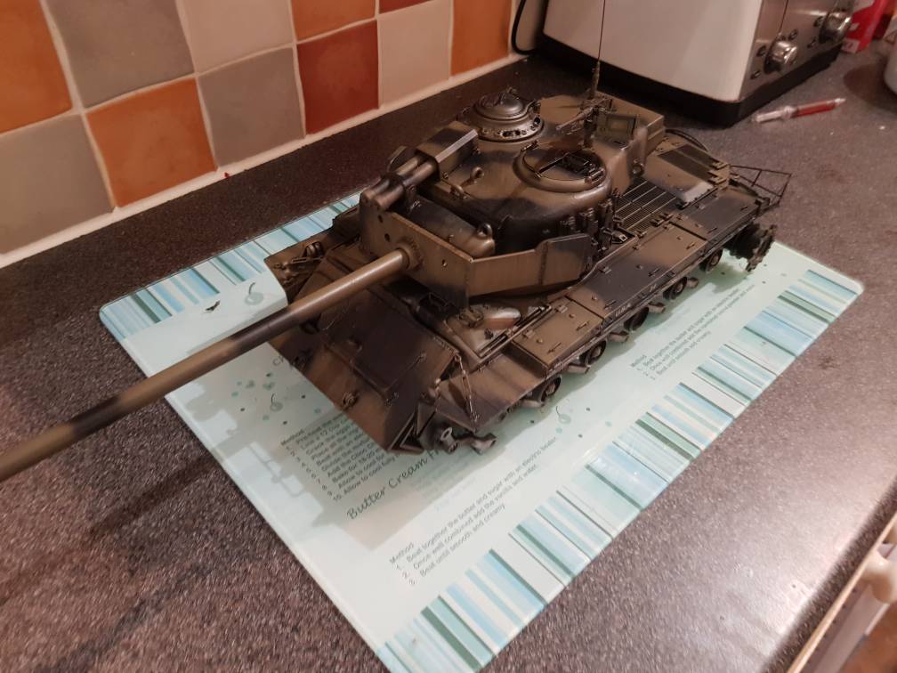

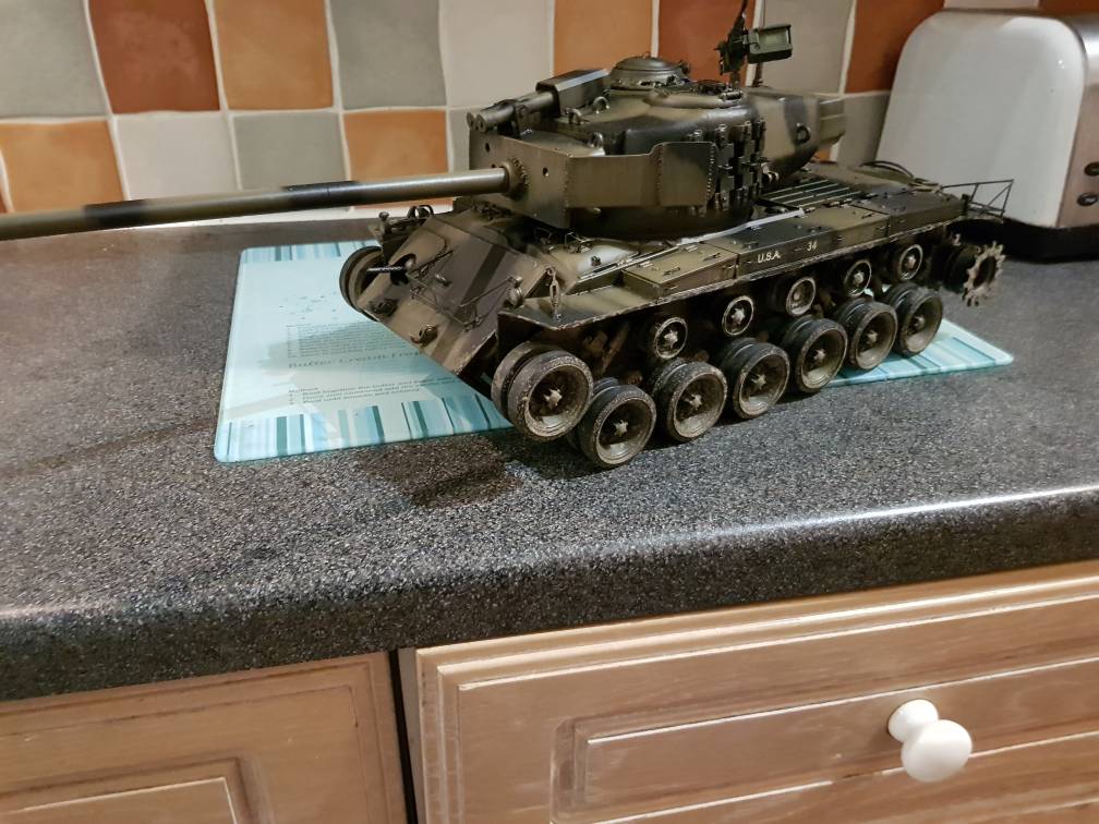

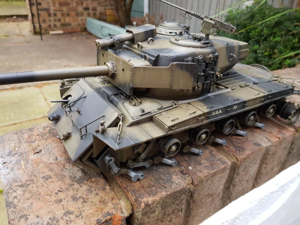

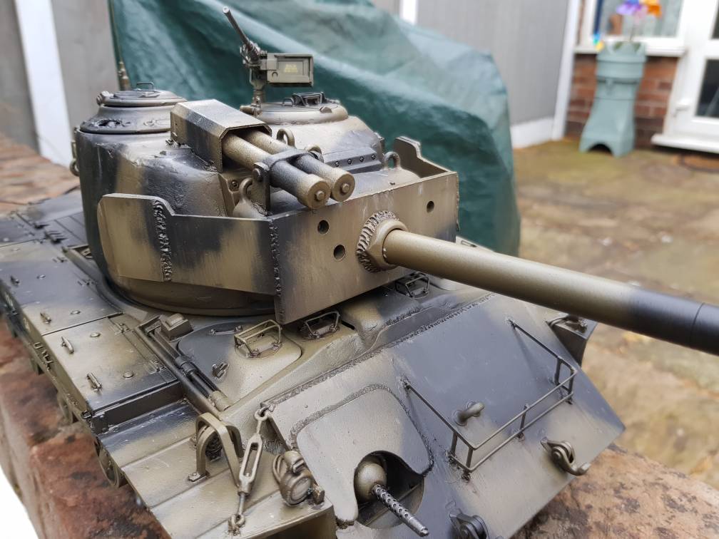

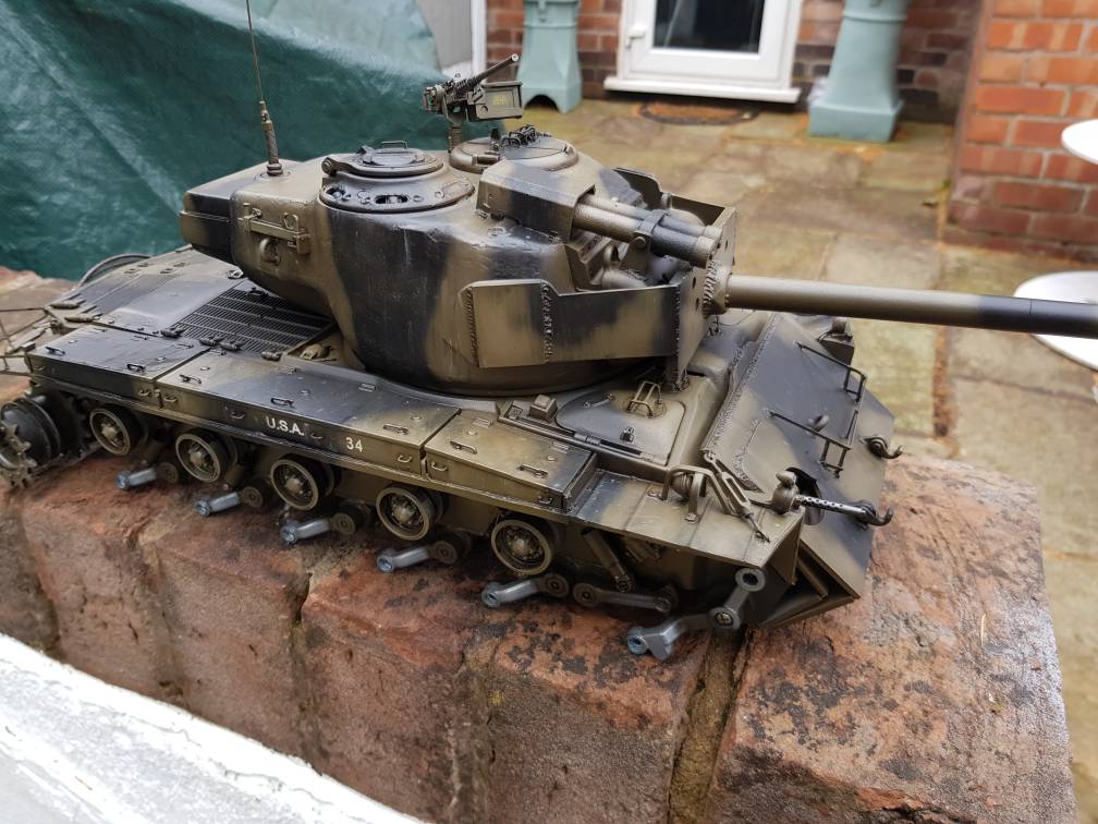

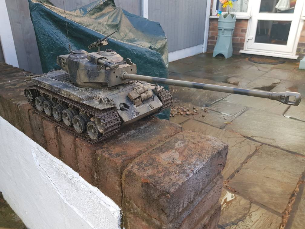

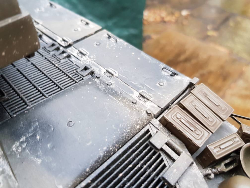

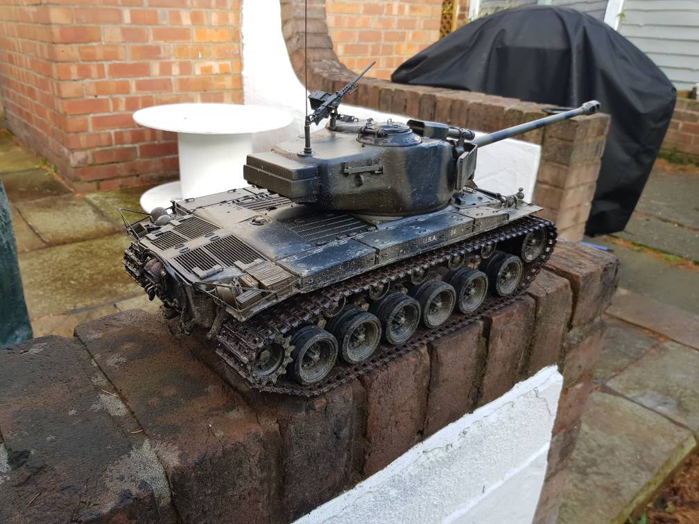

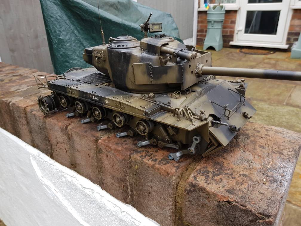

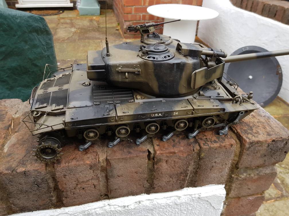

Now here comes the scary part, the final dull coat. I've read so many horror stories of projects having a final coat and the lacquer blooming so much the model goes white and is a write off. With buttocks suitably clenched I tested on a wheel. Hmm was that a hint of lightening. No just the lighting. So took the plundge and did the tank. I'm pretty happy with the final result. Will let it properly cute and then on to mud glorious mud!Attachment 2262765Attachment 2262766Attachment 2262767Attachment 2262768Attachment 2262769
Sent from my SM-G950F using Tapatalk
Maccrage 11-28-2018 10:10 AM
Ah, yes. The dullcoat fears. Ever since Testors changed the formula, I dread doing dullcoat. It ain't dull no mo'.

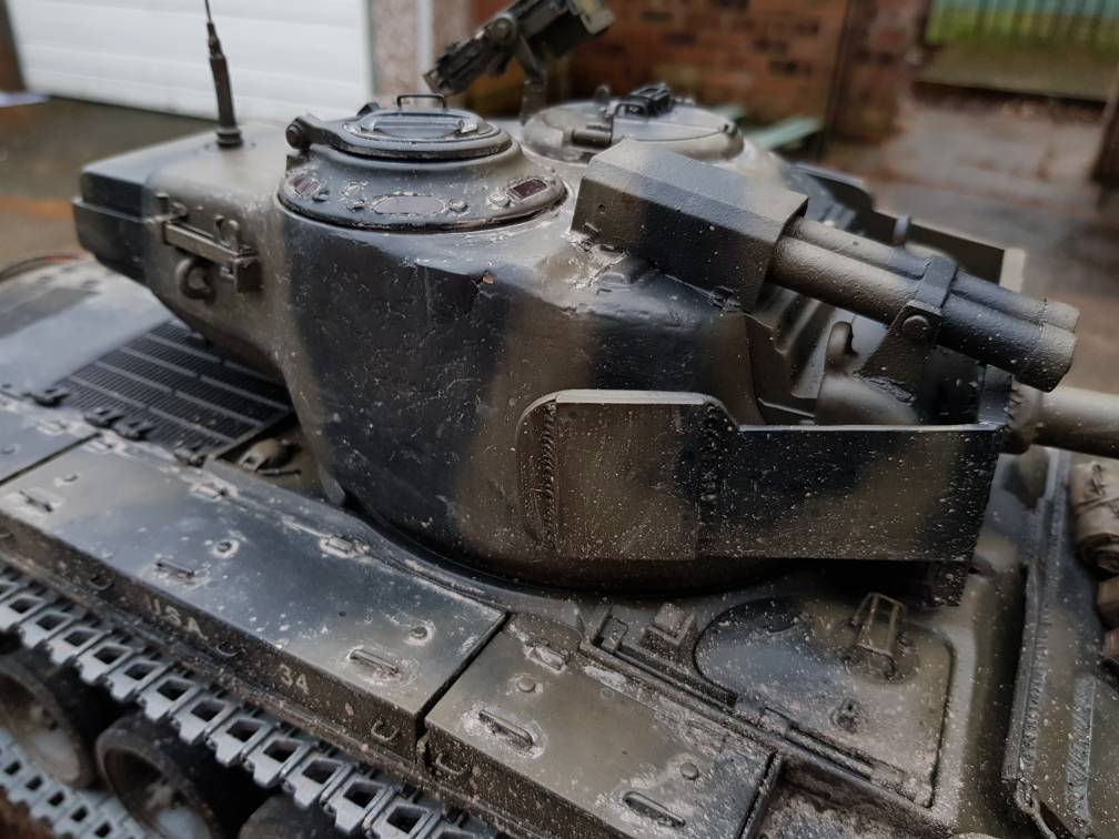

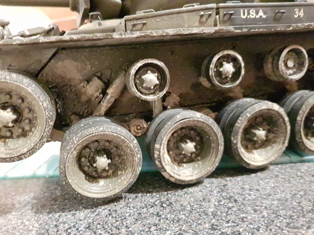

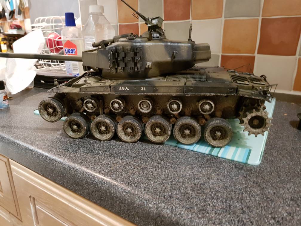

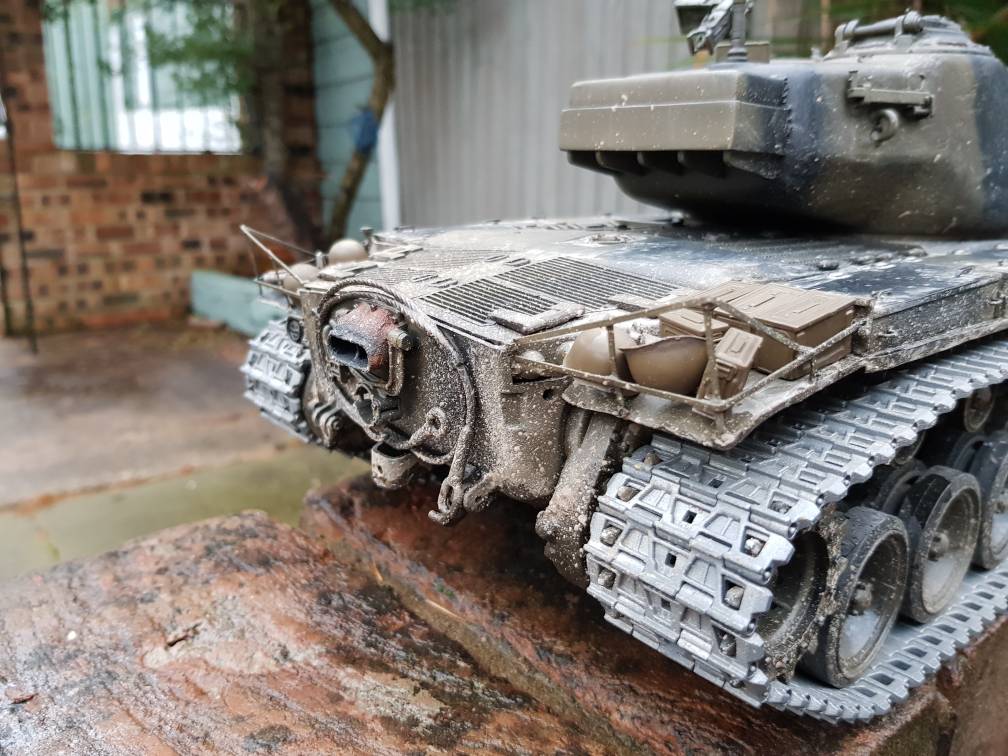

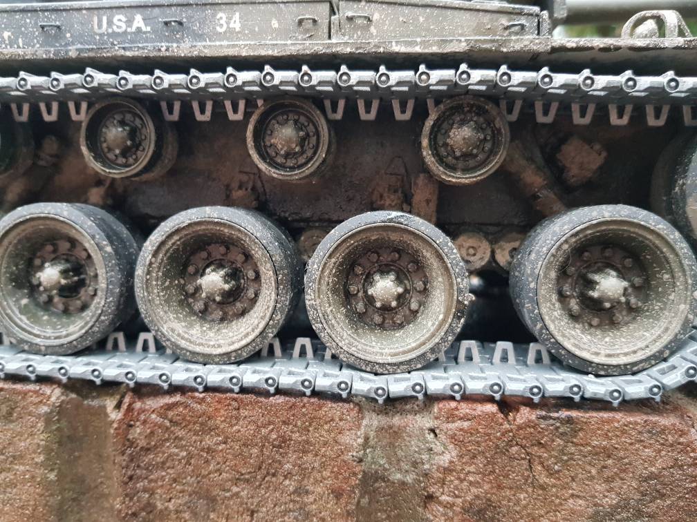

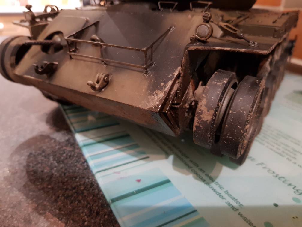

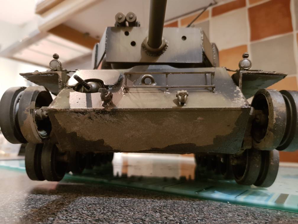

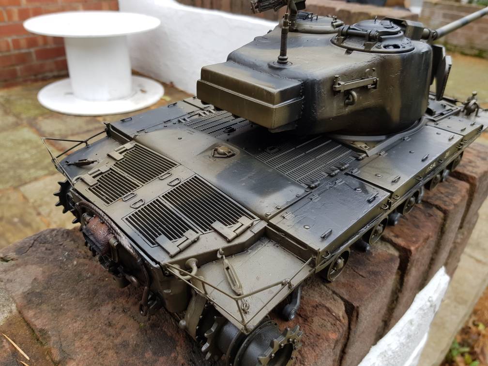

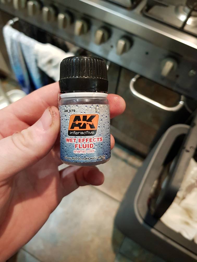

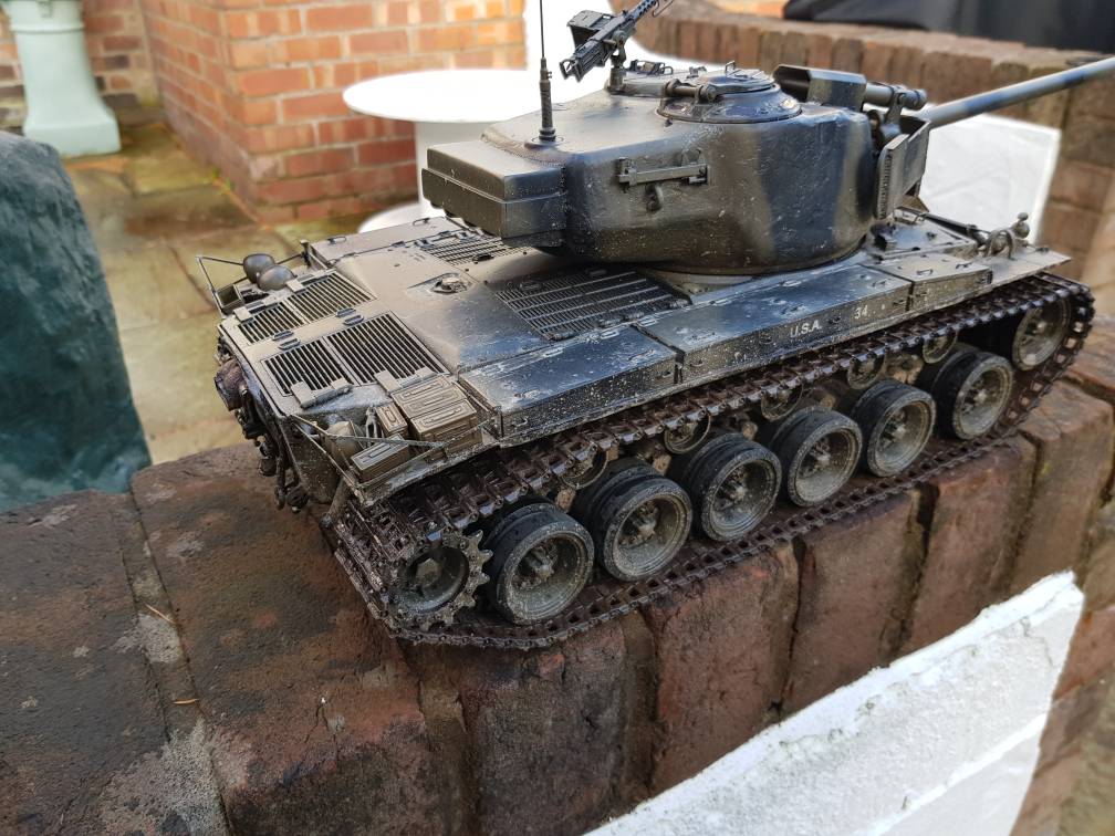

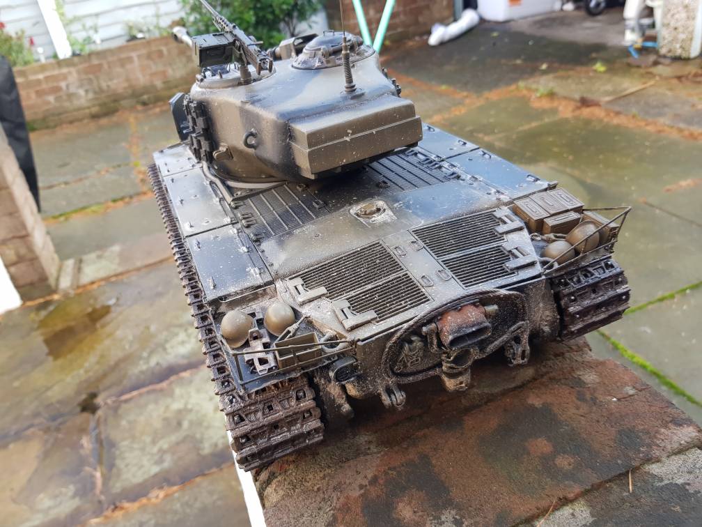

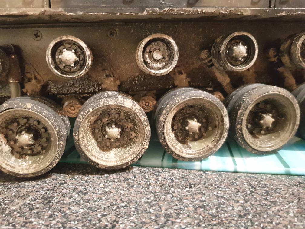

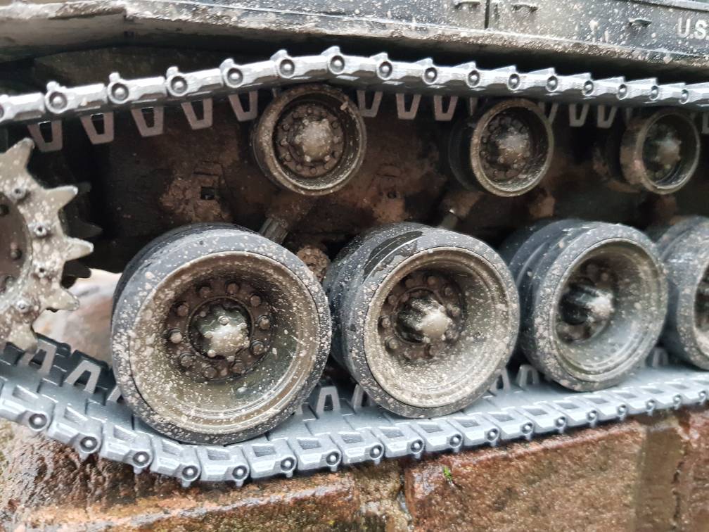

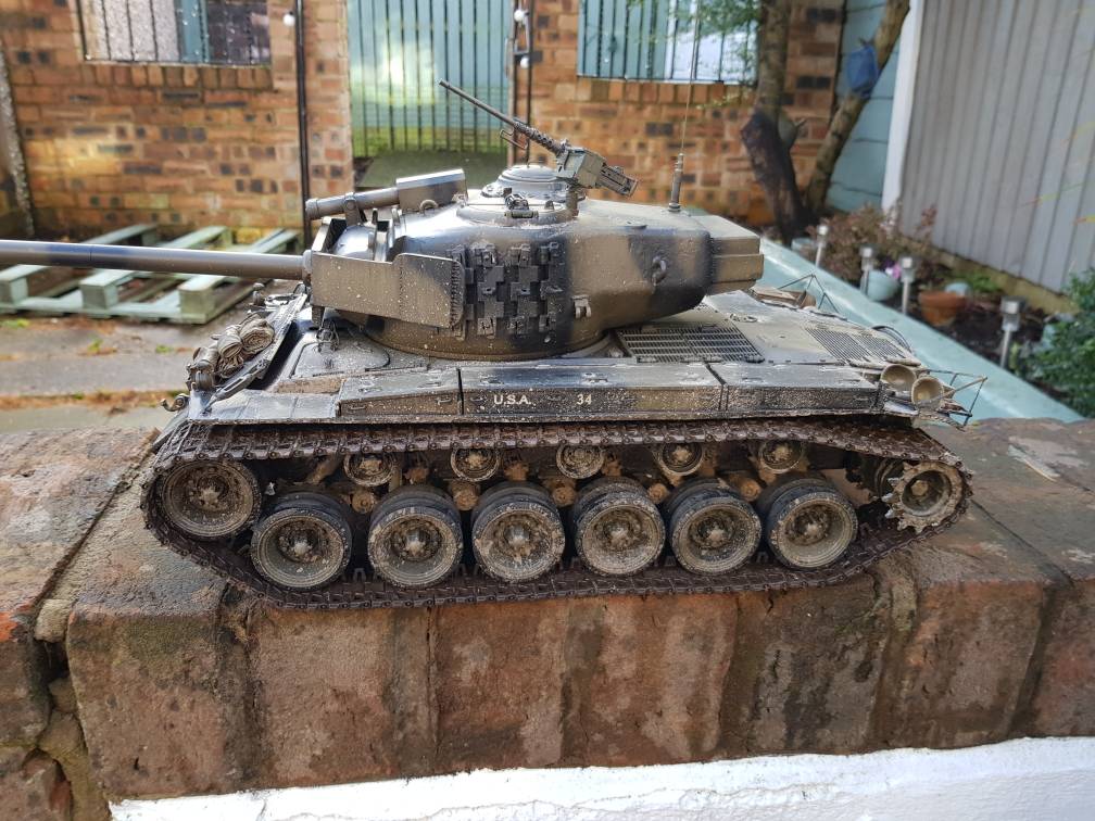

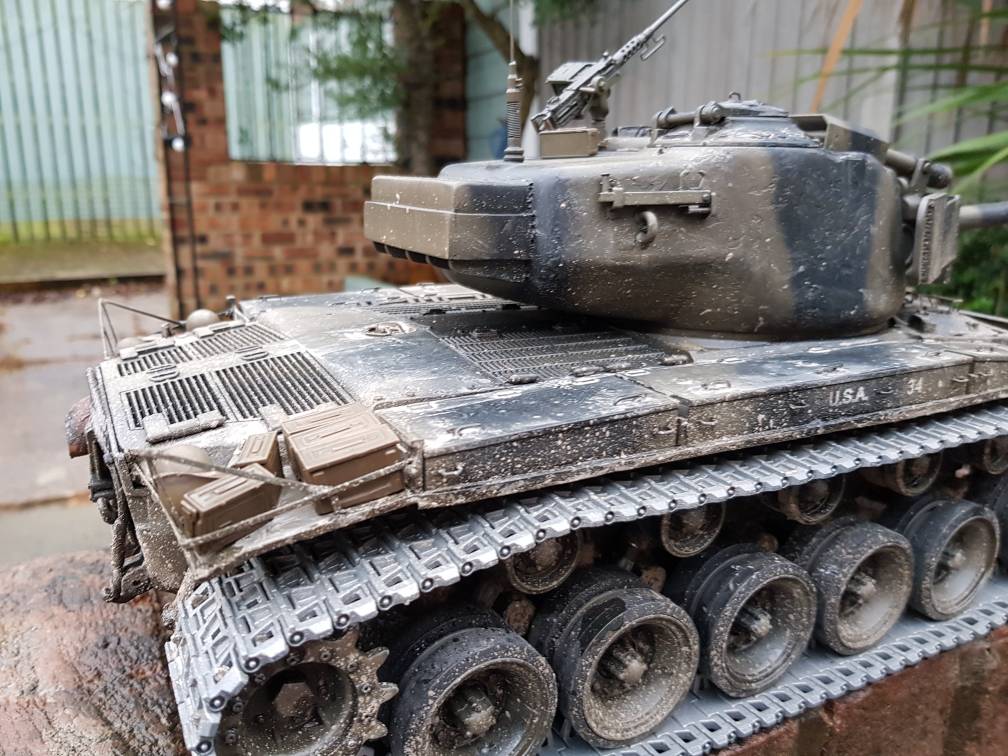

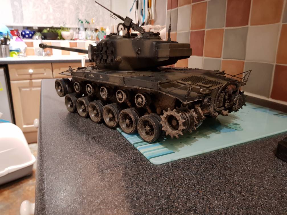

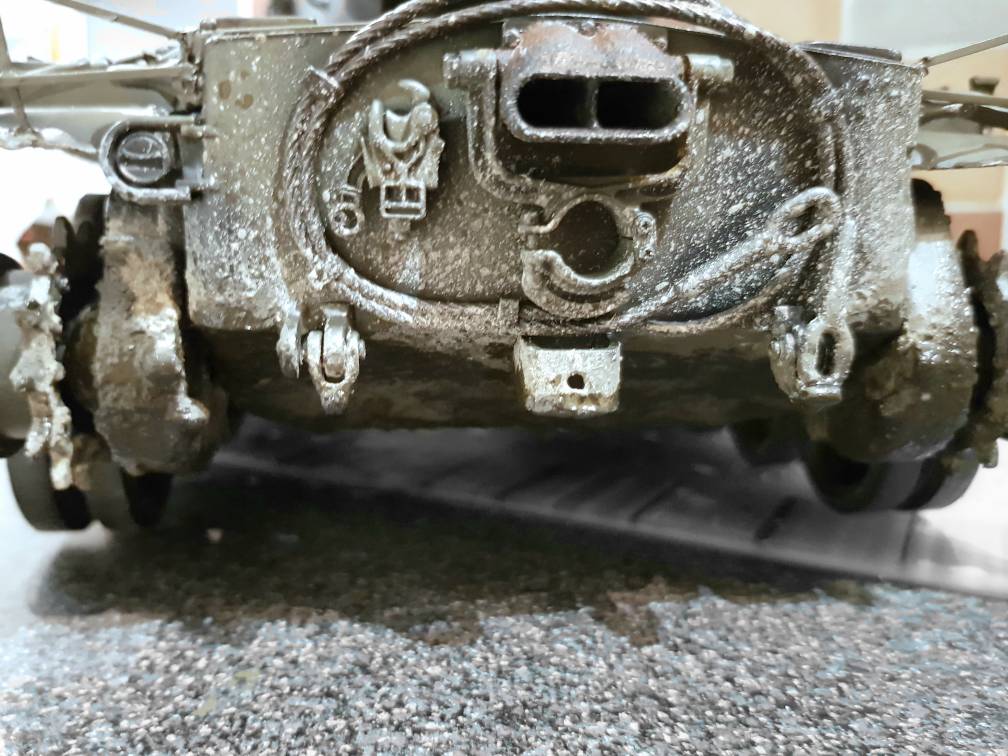

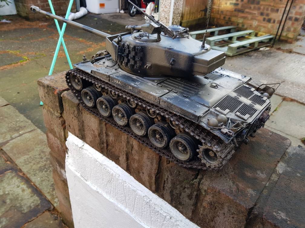

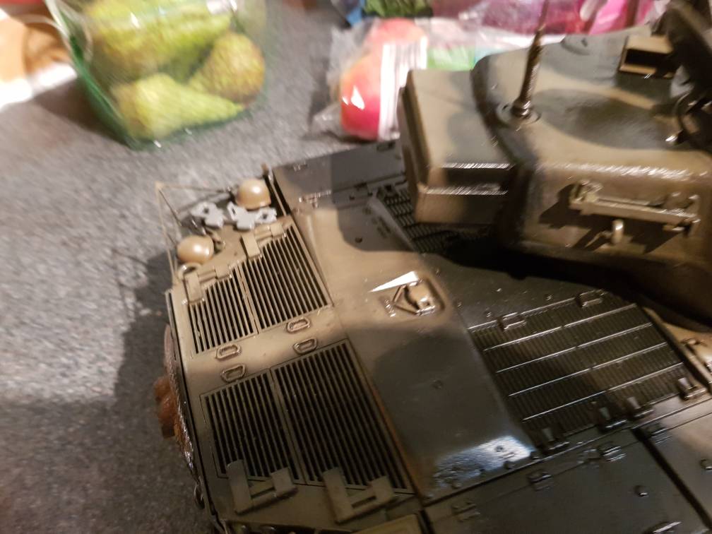

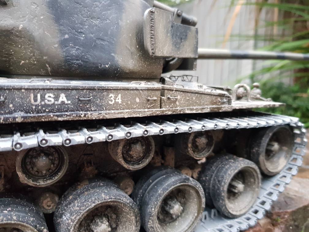

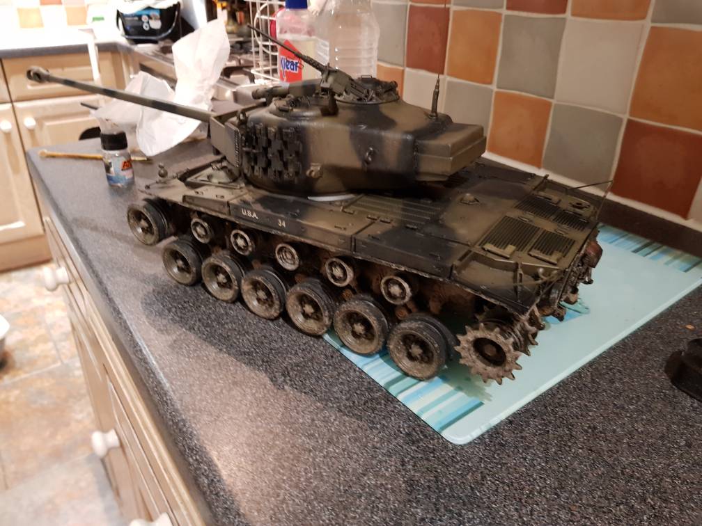

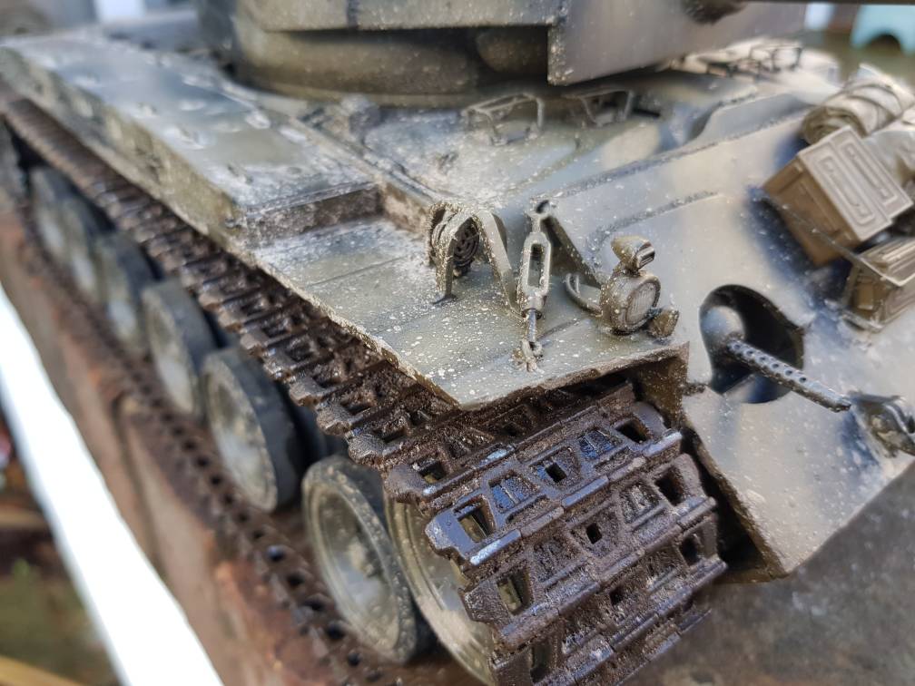

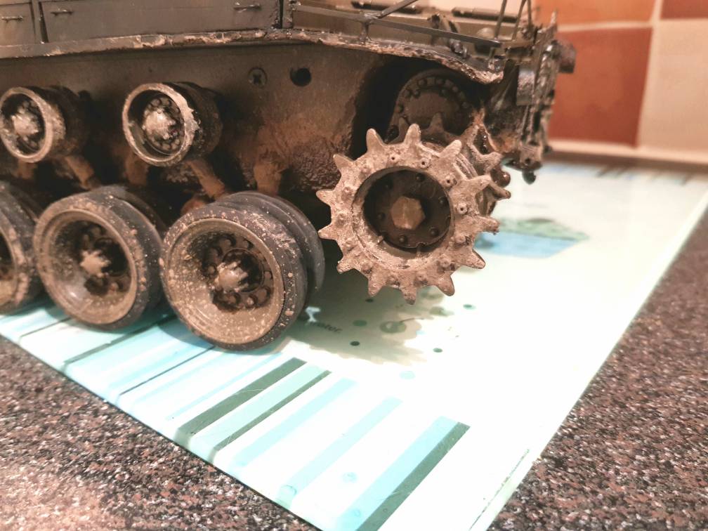

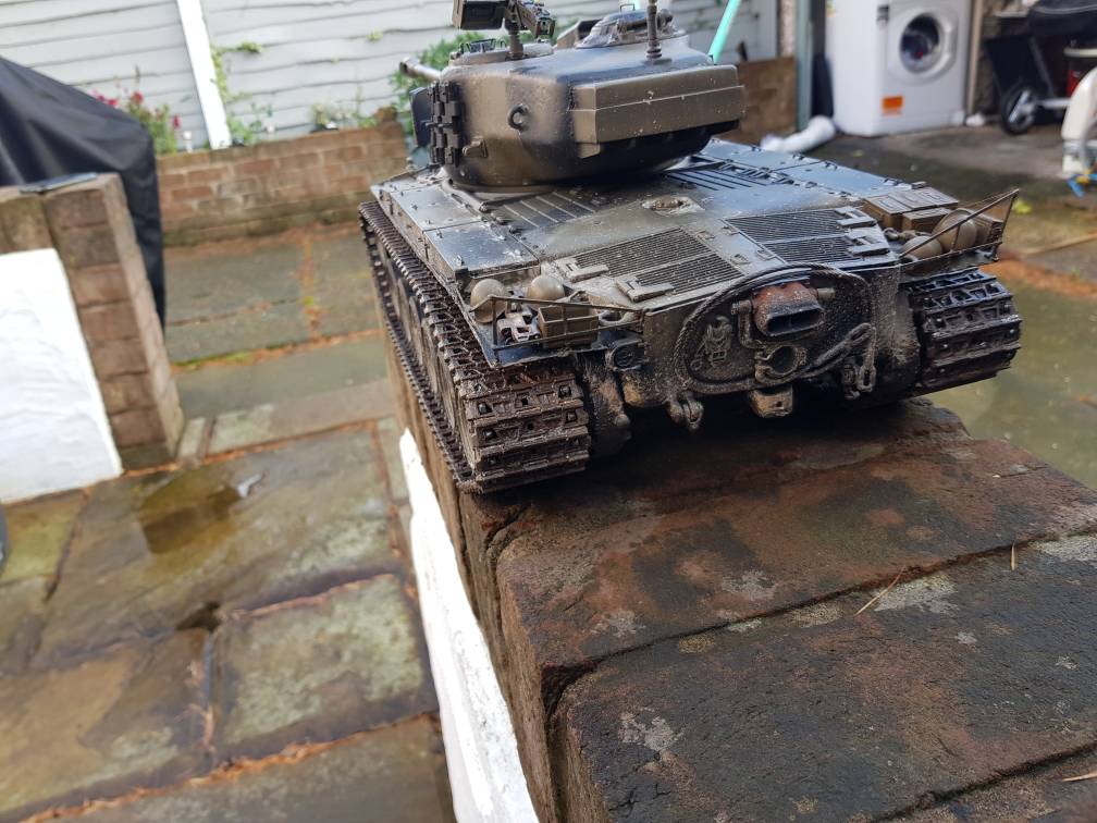

Morning (I'll try and get some better photos when I'm not work during the only daylight hours [emoji2357]). Made a start on the Super P mud and grime now the Matt clears properly dry. Using my usual mix of pigment, acrylic resin, plaster and when darkening added ammo black into the mix. As usual it looks great when applied and drying but when full dried out the dark wet parts greatly fade loosing the contracts and wet/dry effects. This time I tried something a little different. Had some ak wet effects in the draw which I've never used properly but thought what's the worst. This stuff as far as I can tell is viscous enamel gloss clear but it so far is doing what it says on the tin!Attachment 2262782Attachment 2262783Attachment 2262784Attachment 2262785Attachment 2262786Attachment 2262787Attachment 2262788Attachment 2262789Attachment 2262790Attachment 2262791Attachment 2262792Attachment 2262793Attachment 2262794Attachment 2262795

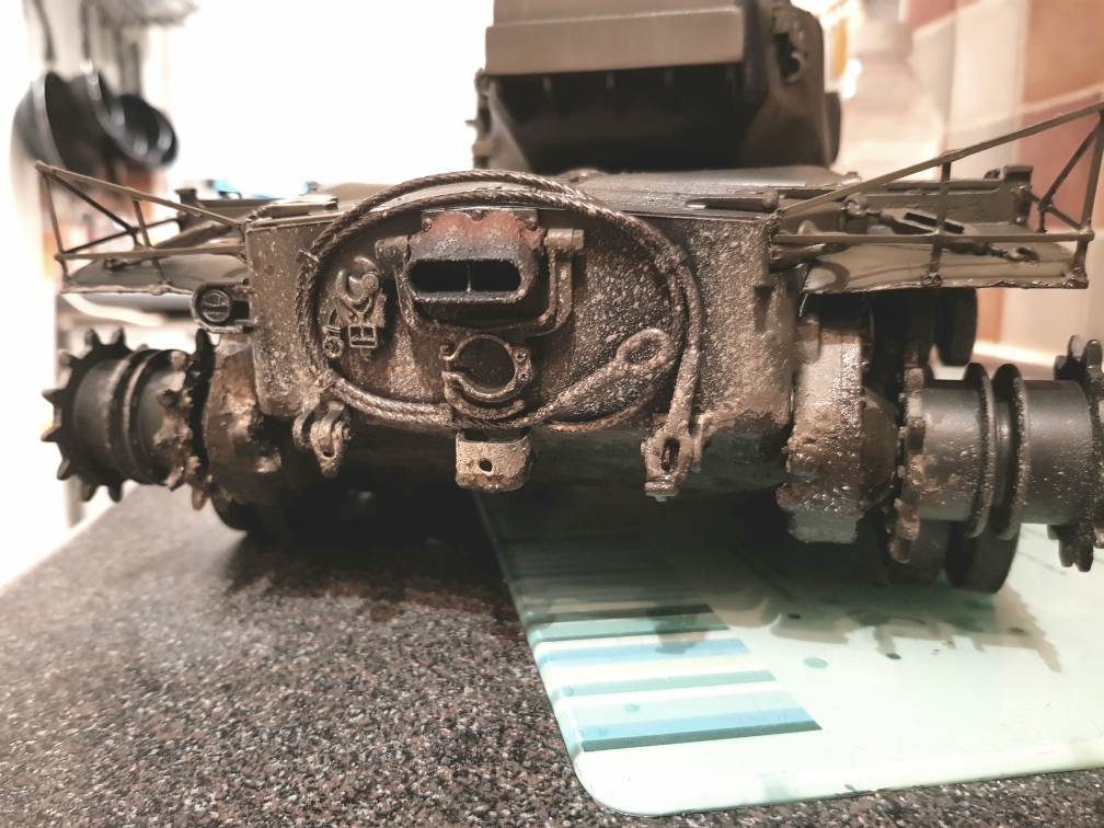

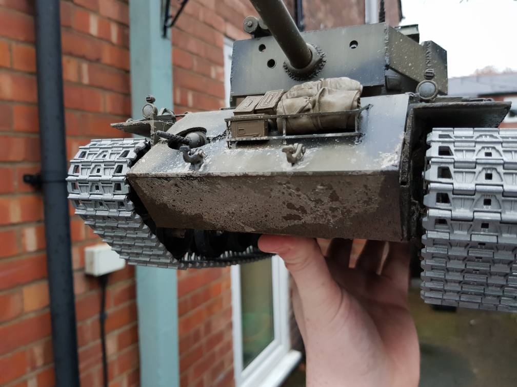

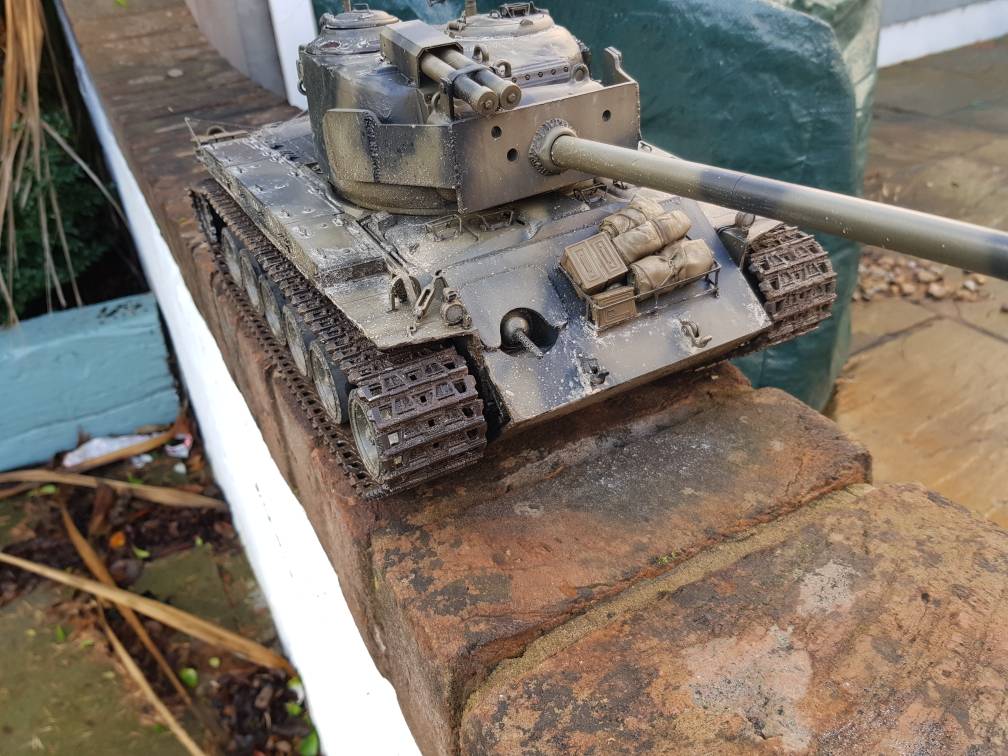

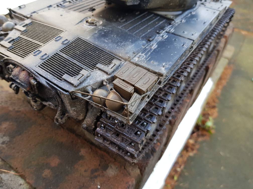

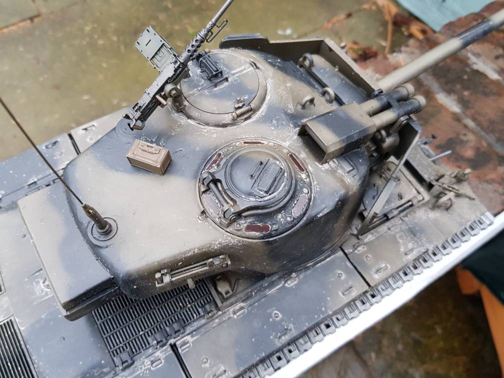

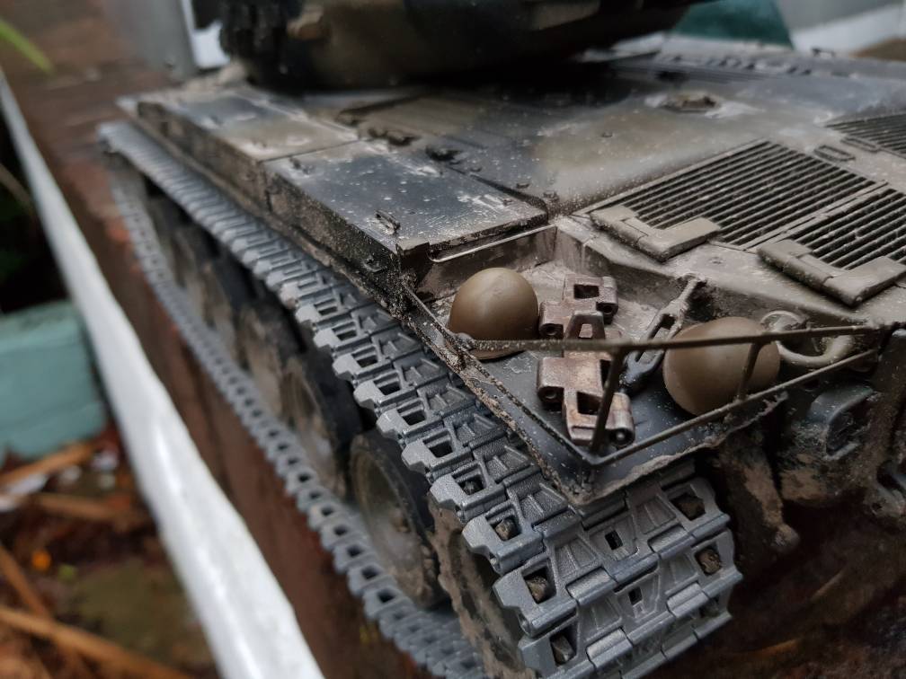

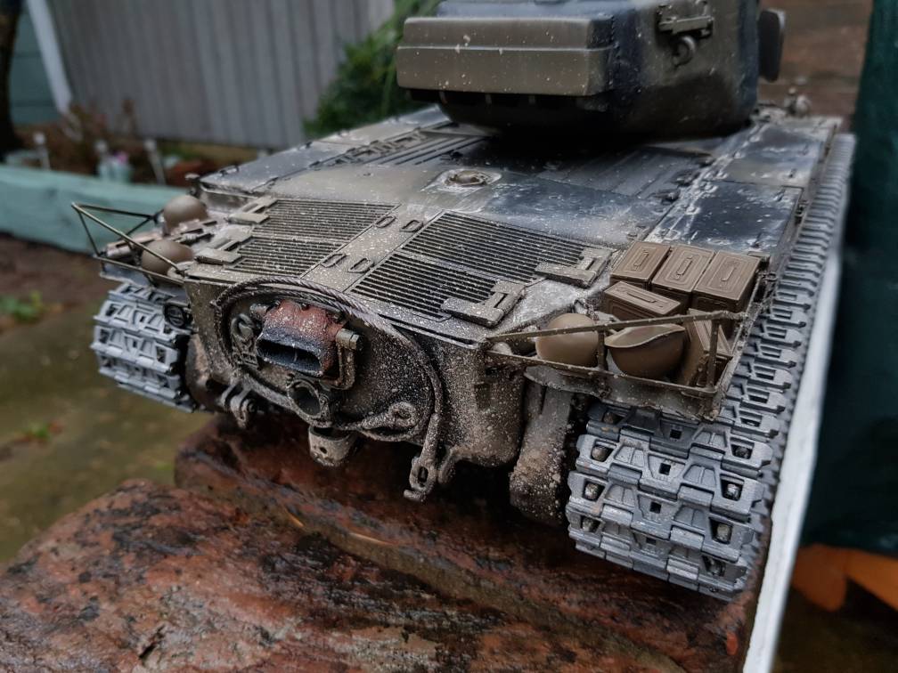

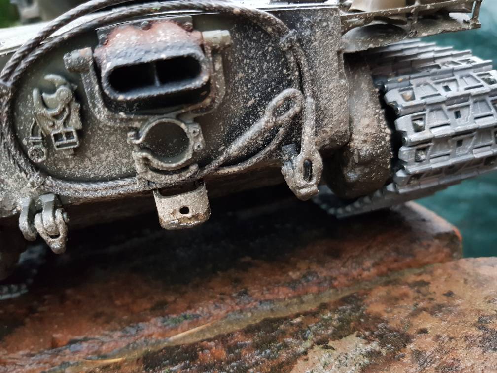

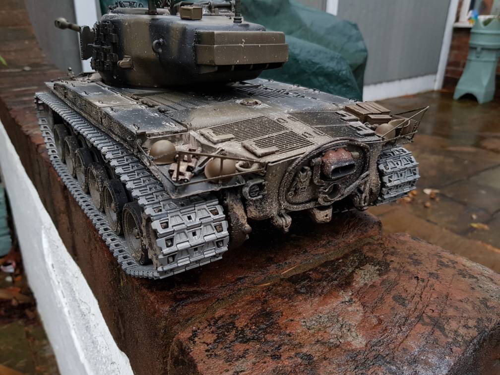

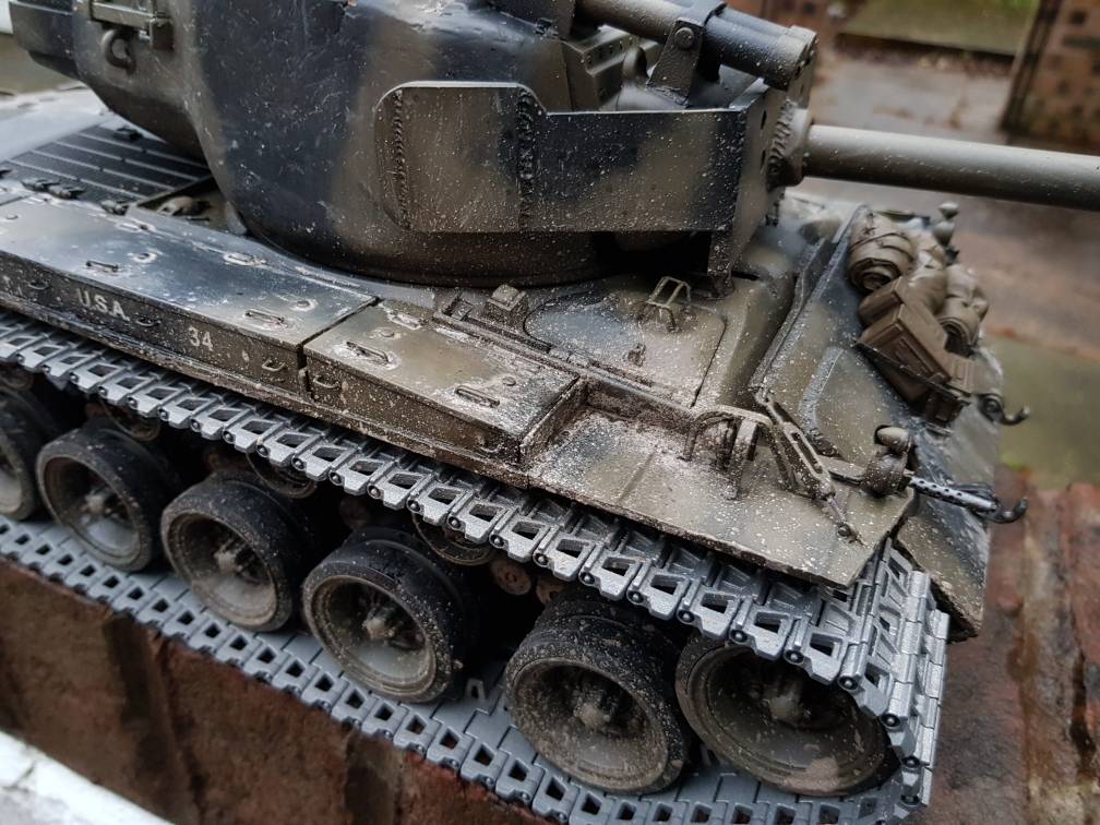

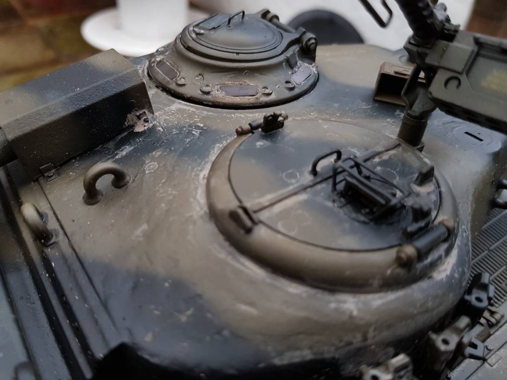

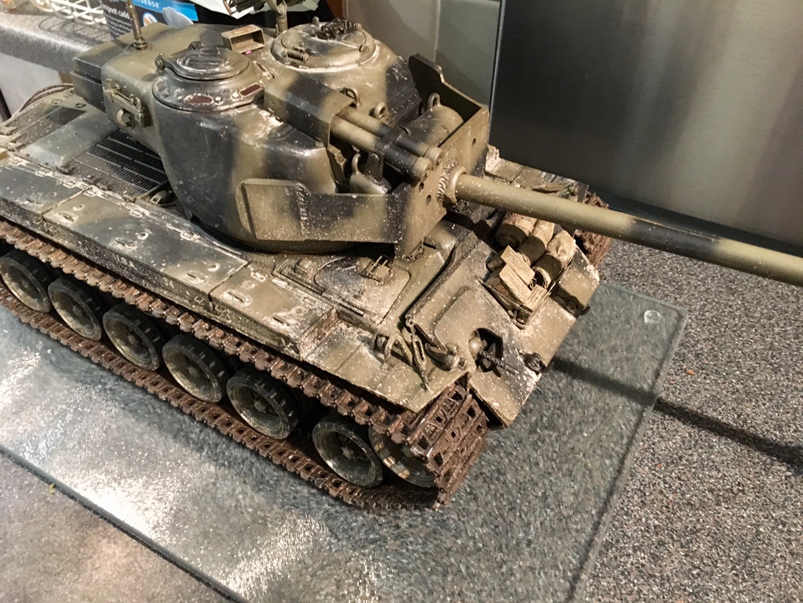

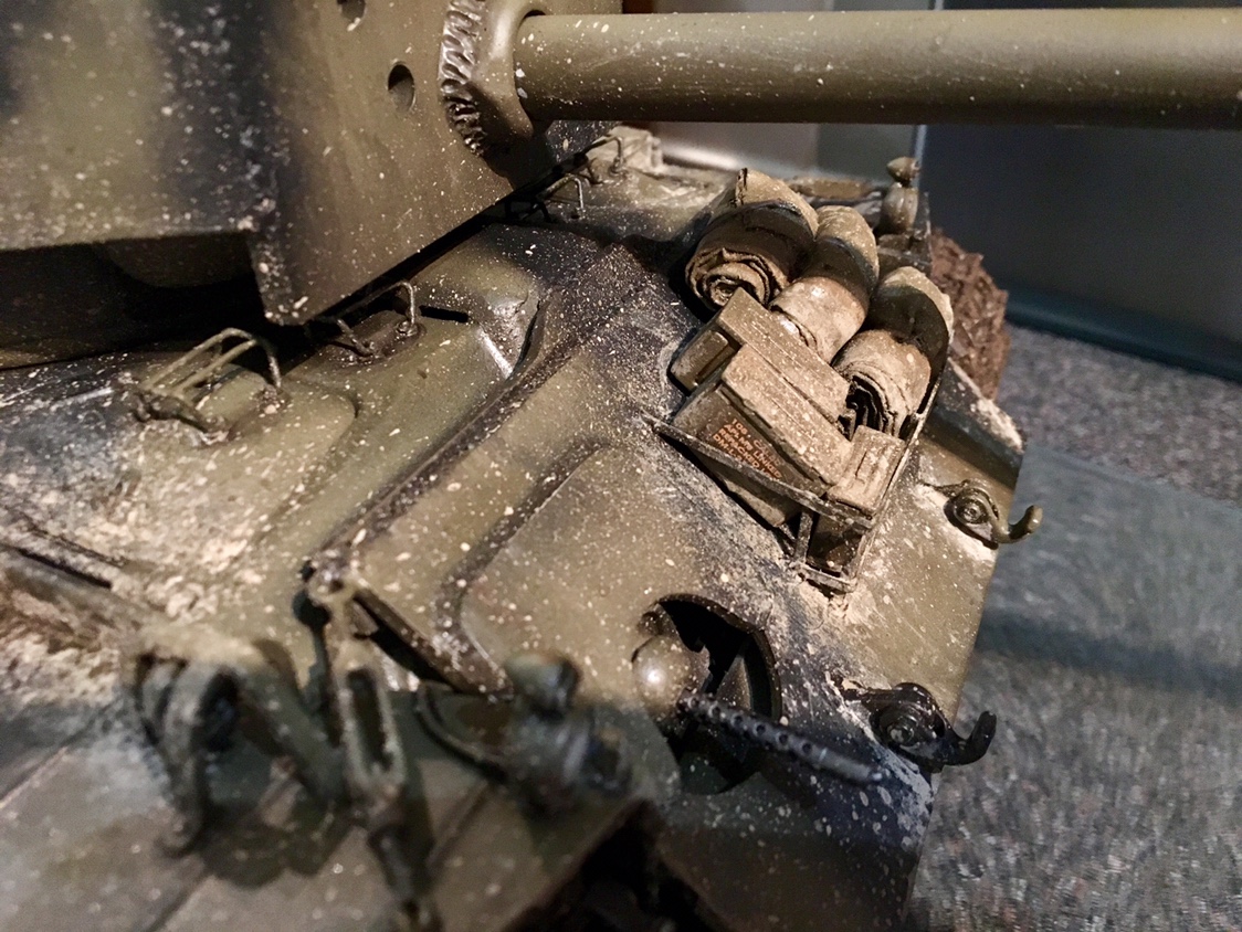

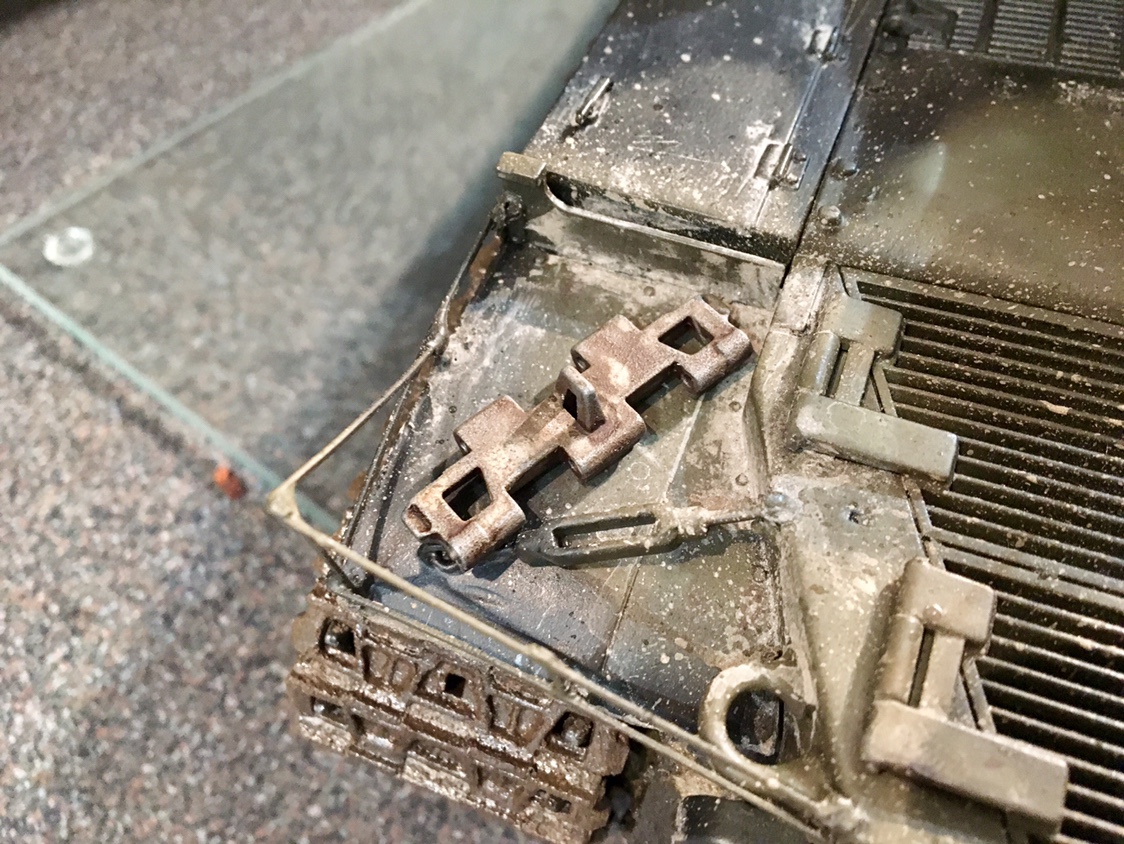

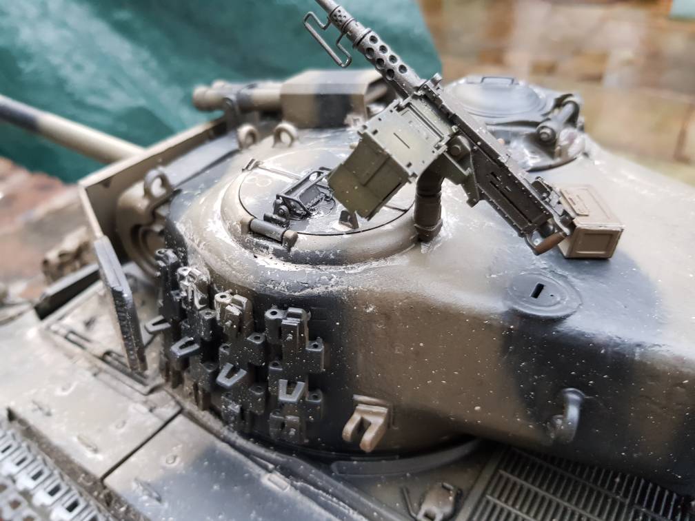

Continuing on with the mud, l wanted to try and make the tank look like the crew had been clambering over it, so adding mud to the areas around the hatches. As the sponsors are cut but there plenty of splatter over the tool boxes and the side of the turret. I've added wet effects in the crevices by the hatches to represent wet mud which hasn't dried, and around the water filler cap. The stowage has only had its base coat, modulation and filter so far, peddinghaus send me the wrong set :(. I think the turret roof could use a bit more mud. Lastly I've added the effect for the cupola periscope glass. I used exposed 35mm film cut down to fit. This covers the bits I milled out and has the added bonus of being a visible light filter but allows IR to pass. Still to.do, finish mud, weather tracks, paint crew and find ISH stowage.Attachment 2262800Attachment 2262801Attachment 2262802Attachment 2262803Attachment 2262804Attachment 2262805Attachment 2262806Attachment 2262807Attachment 2262808Attachment 2262809Attachment 2262810Attachment 2262811Attachment 2262812Attachment 2262813Attachment 2262814Attachment 2262815Attachment 2262816Attachment 2262817Attachment 2262818Attachment 2262819Attachment 2262820Attachment 2262821Attachment 2262822Attachment 2262823

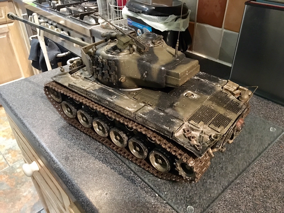

tomhugill 12-03-2018 07:13 AM
20 Attachment(s)

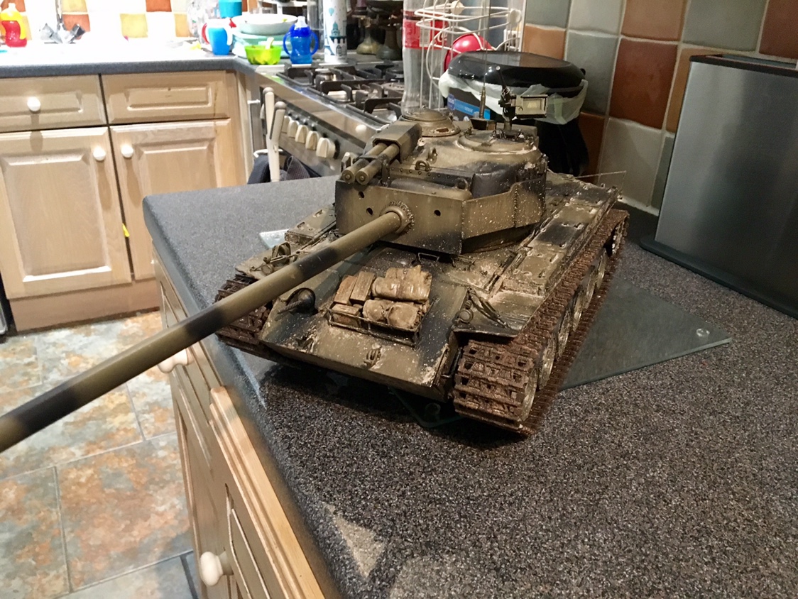

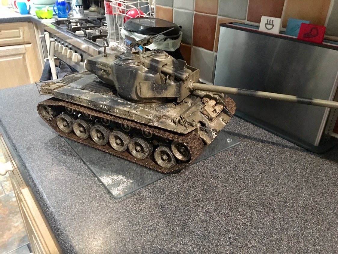

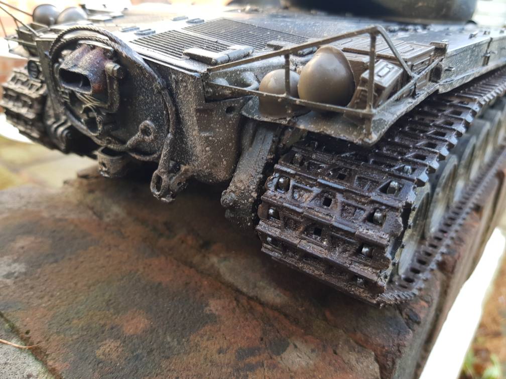

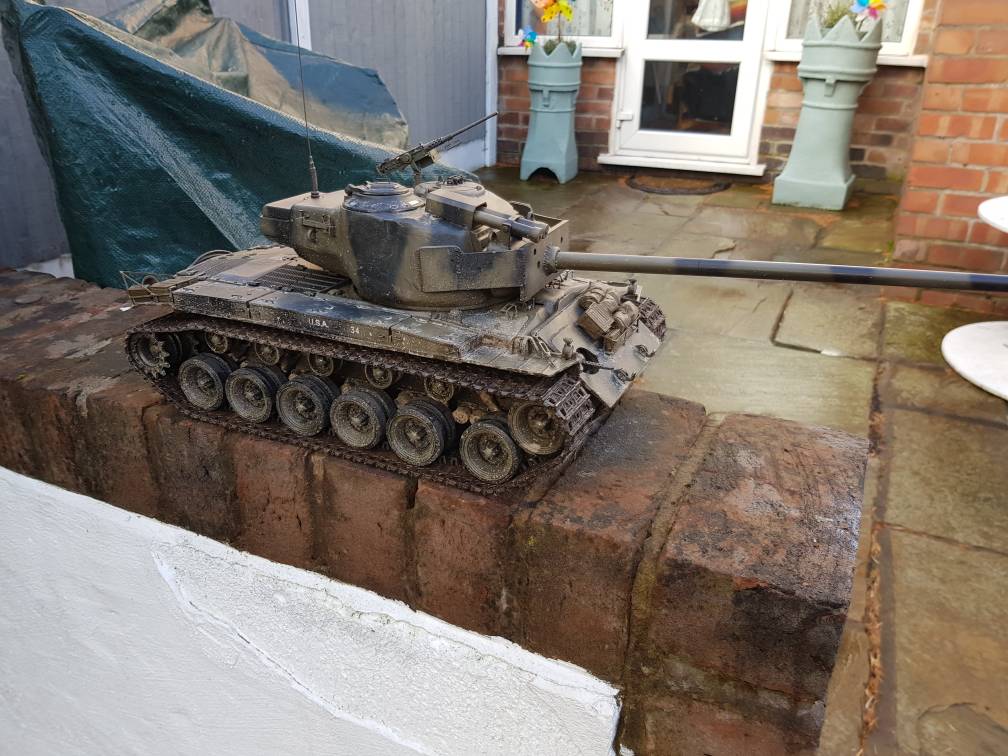

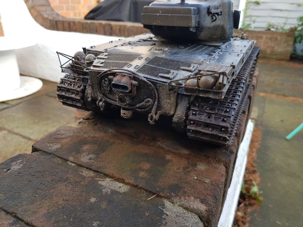

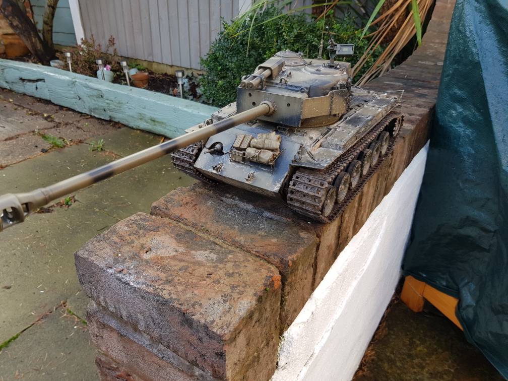

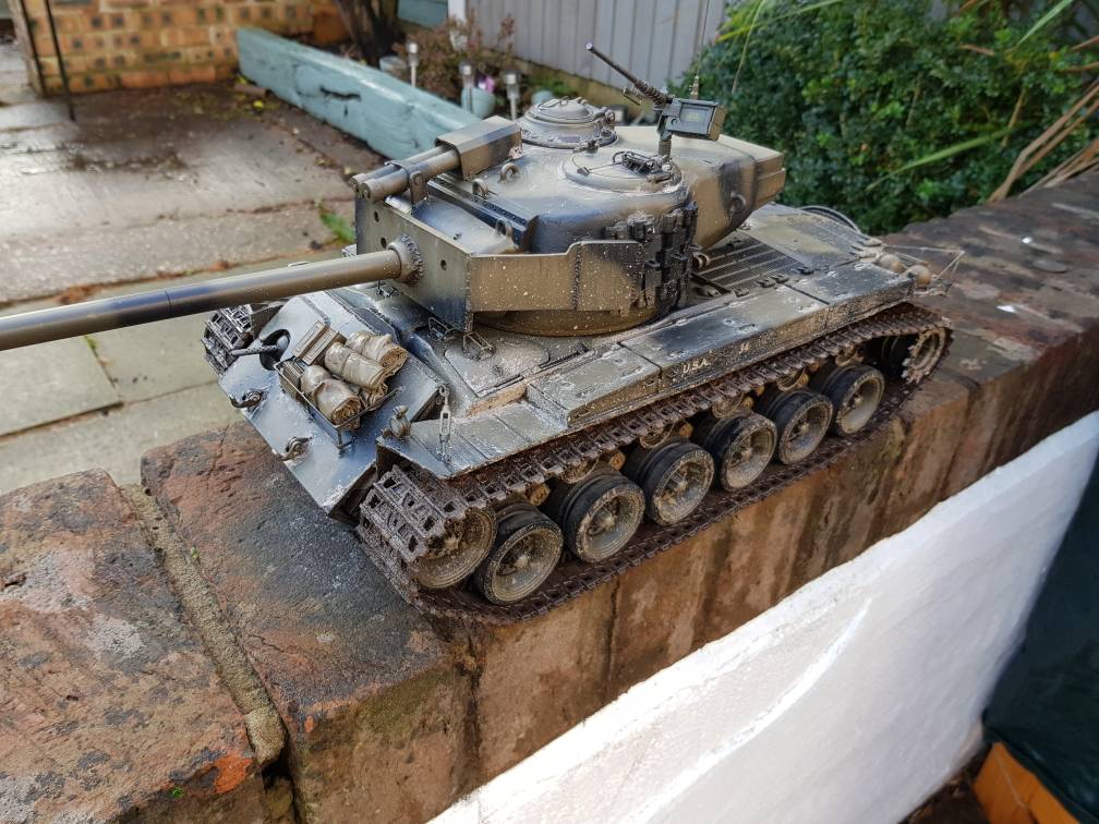

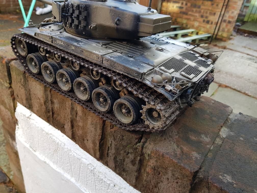

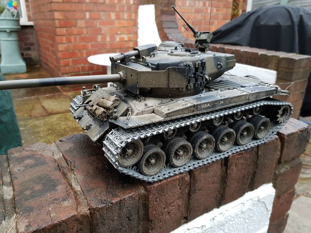

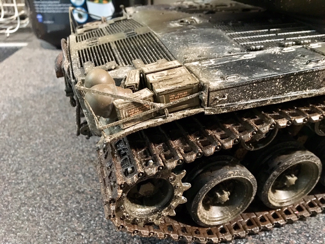

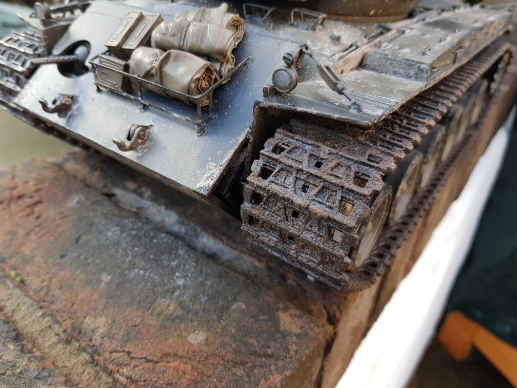

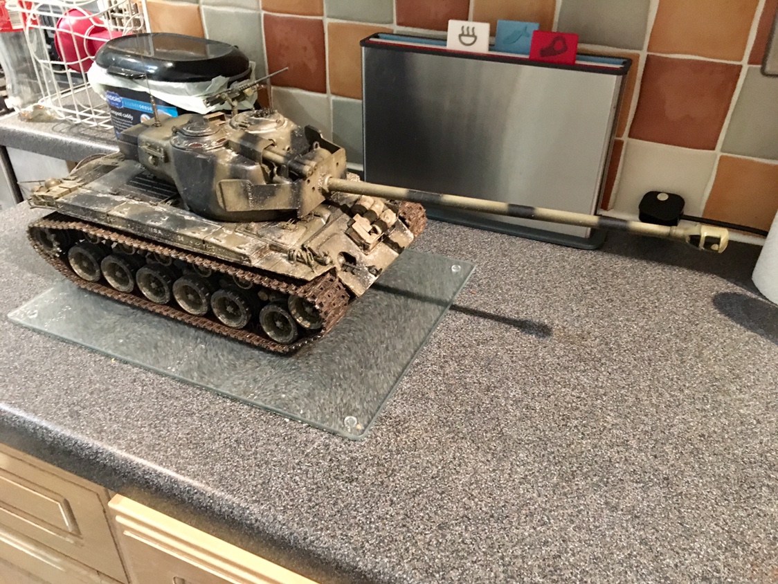

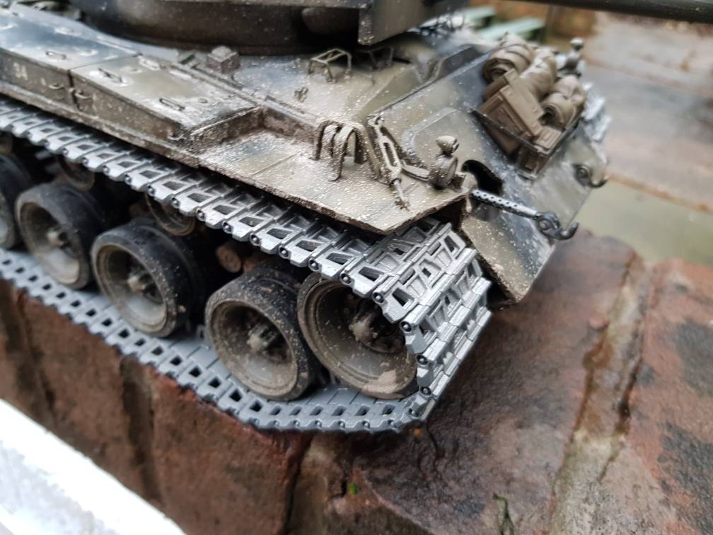

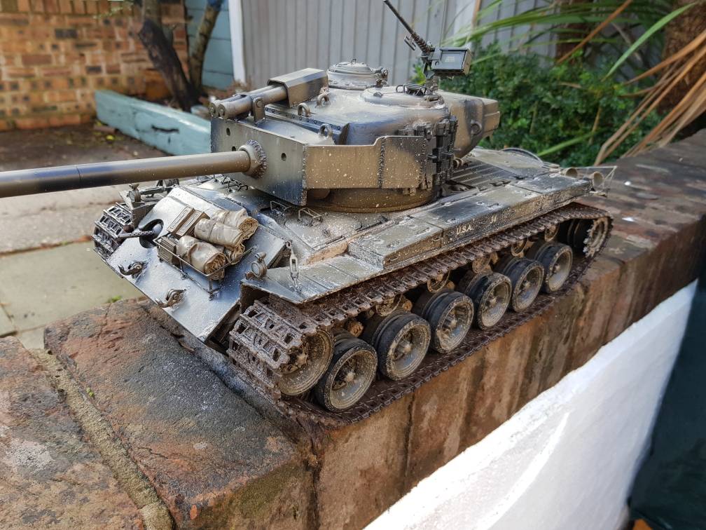

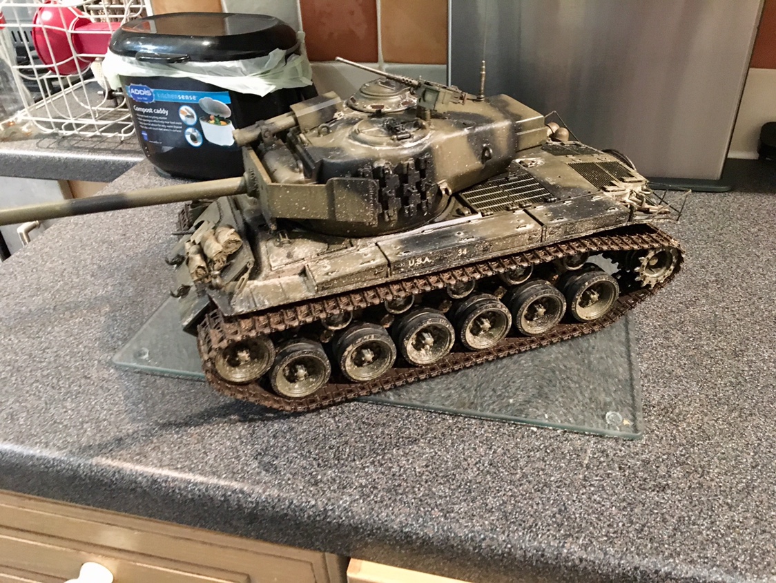

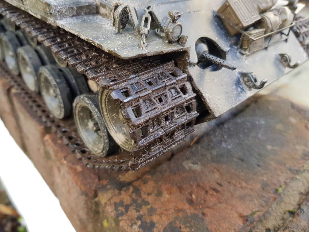

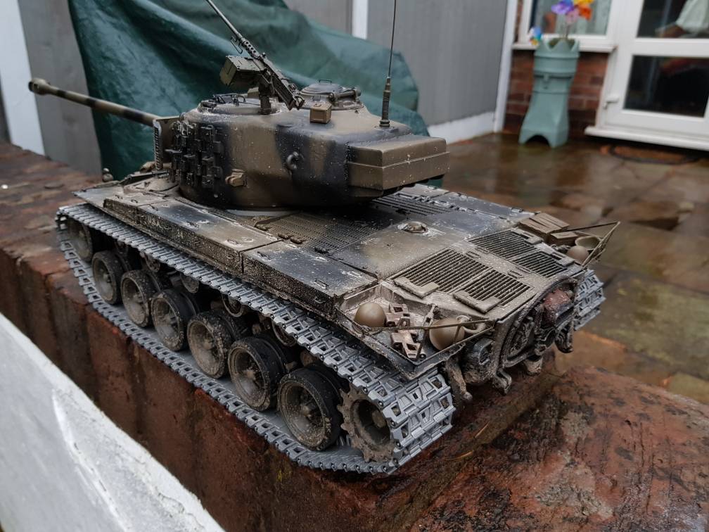

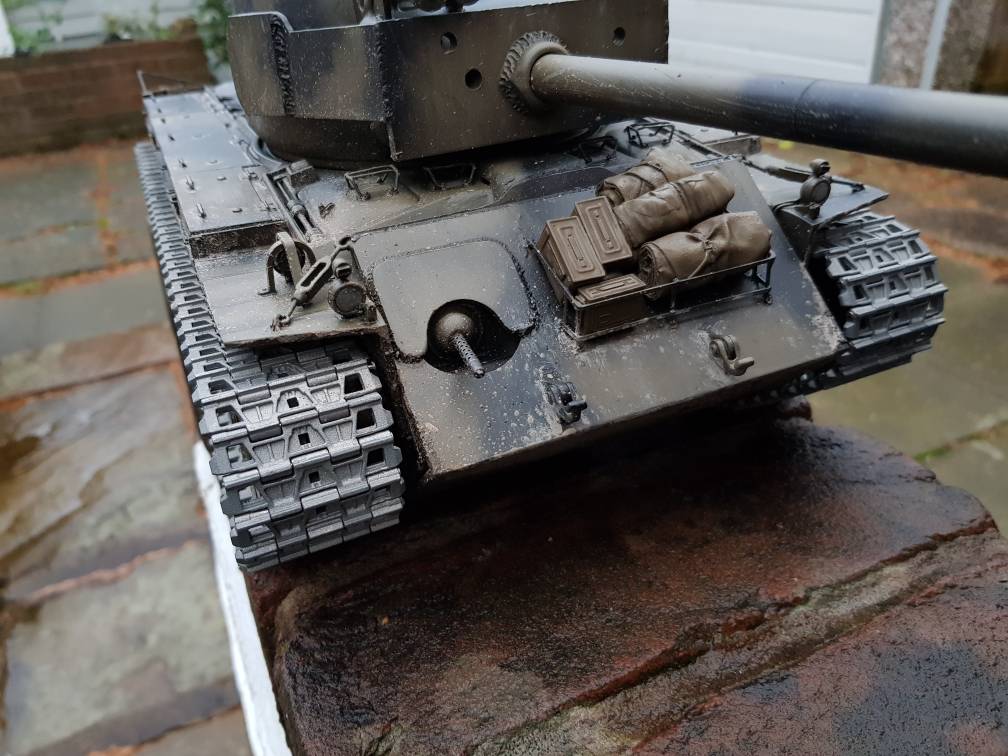

I think it's starting to come together,I always forget what a pain tracks are to paint and weather. I've still got the crew, storage and tarps to get her done.Attachment 2262852Attachment 2262853Attachment 2262854Attachment 2262855Attachment 2262856Attachment 2262857Attachment 2262858Attachment 2262859Attachment 2262860Attachment 2262861Attachment 2262862Attachment 2262863Attachment 2262864Attachment 2262865Attachment 2262866Attachment 2262867Attachment 2262868Attachment 2262869Attachment 2262870Attachment 2262871

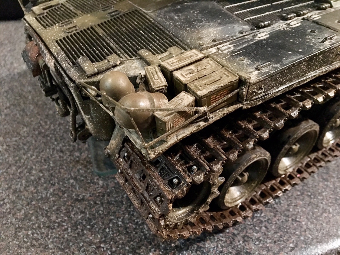

tomhugill 12-07-2018 12:50 AM
19 Attachment(s)

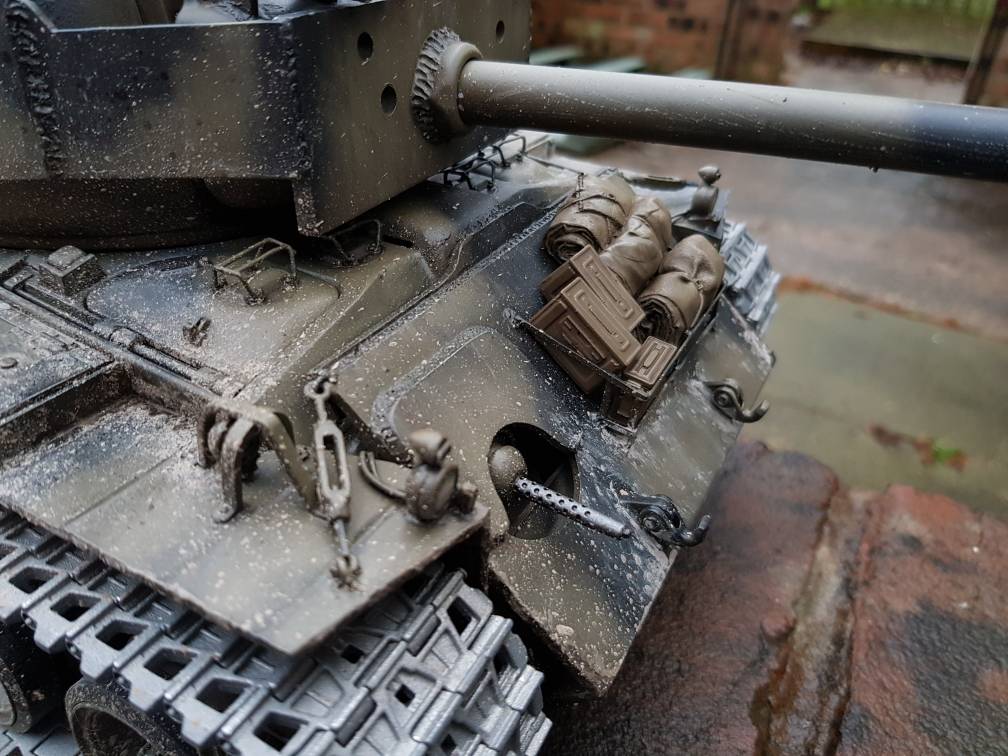

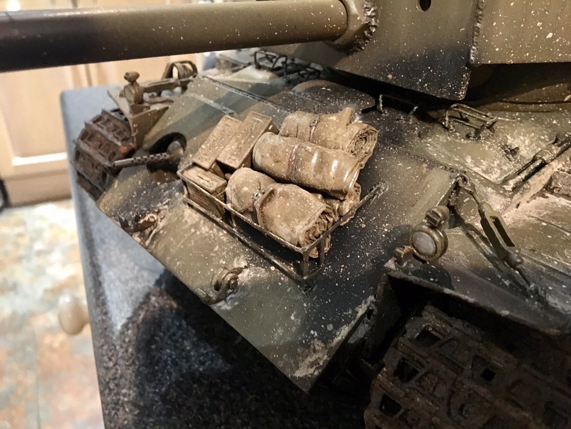

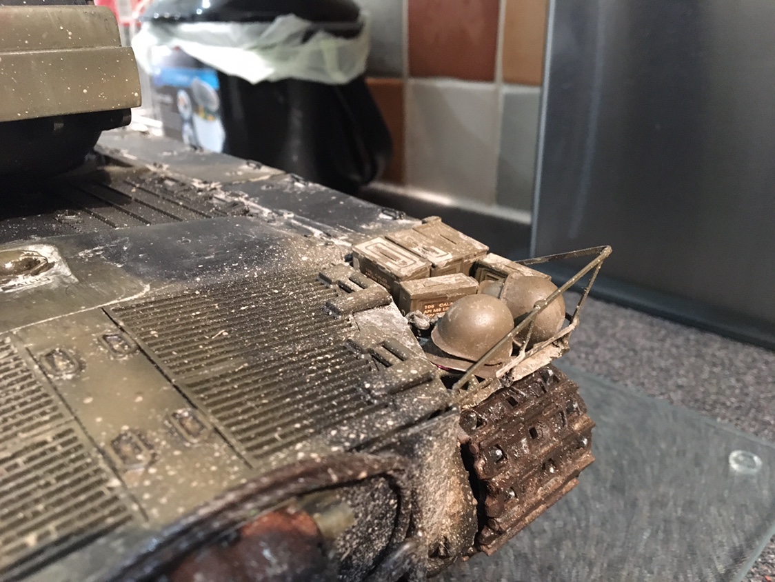

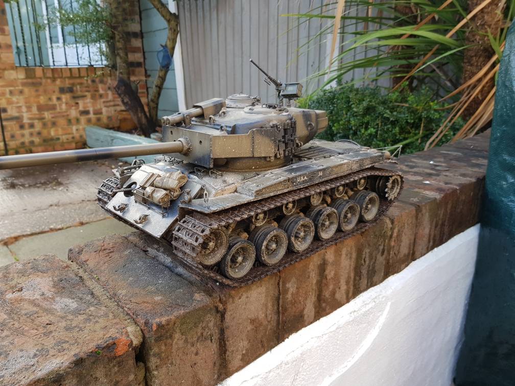

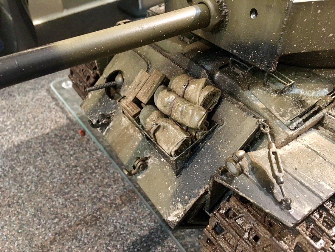

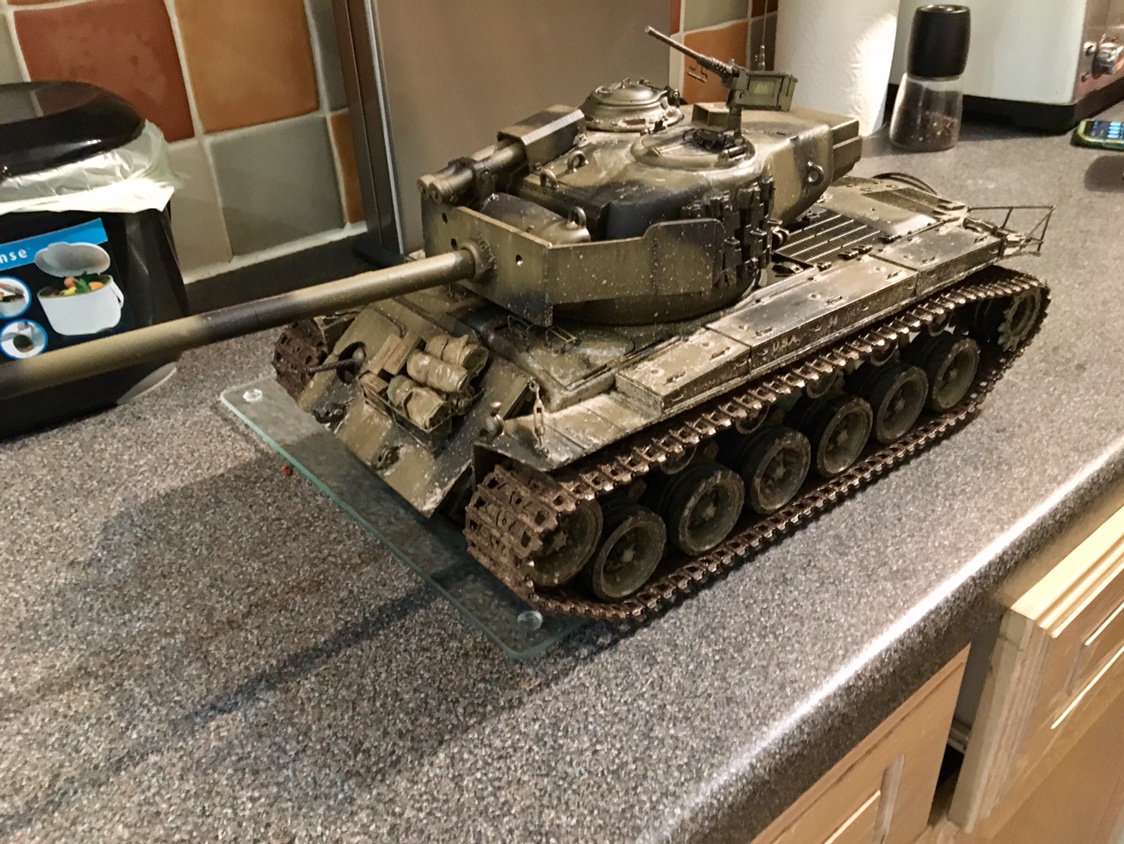

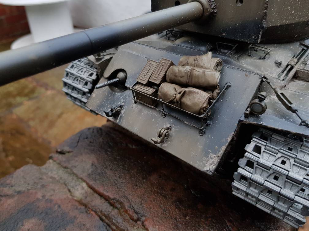

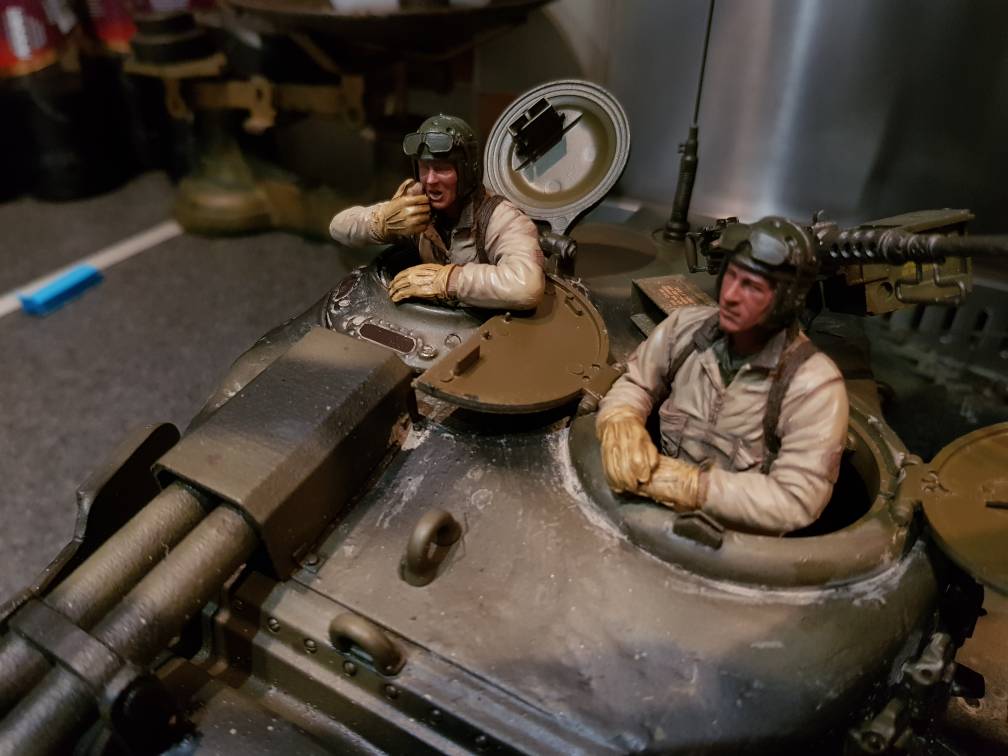

More done on the super P, replacement decals came from Peddinghaus (superb service), so I got cracking with the stowage. Finished the bed rolls and added decals to the ammo boxes. Weathered up and fitted to the tank. I've also made a start on the two crew figures.
Attachment 2262897Attachment 2262898Attachment 2262899Attachment 2262900Attachment 2262901Attachment 2262902Attachment 2262903Attachment 2262904Attachment 2262905Attachment 2262906Attachment 2262907Attachment 2262908Attachment 2262909Attachment 2262910Attachment 2262911Attachment 2262912Attachment 2262913Attachment 2262914Attachment 2262915

tomhugill 12-07-2018 05:45 PM
5 Attachment(s)

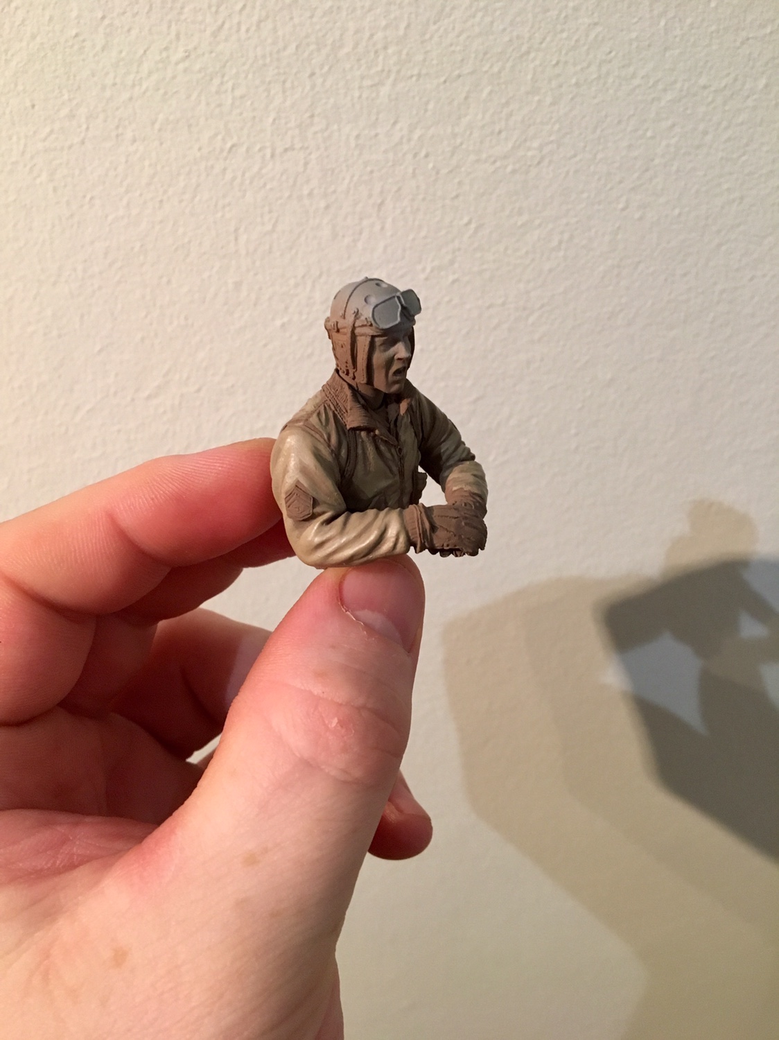

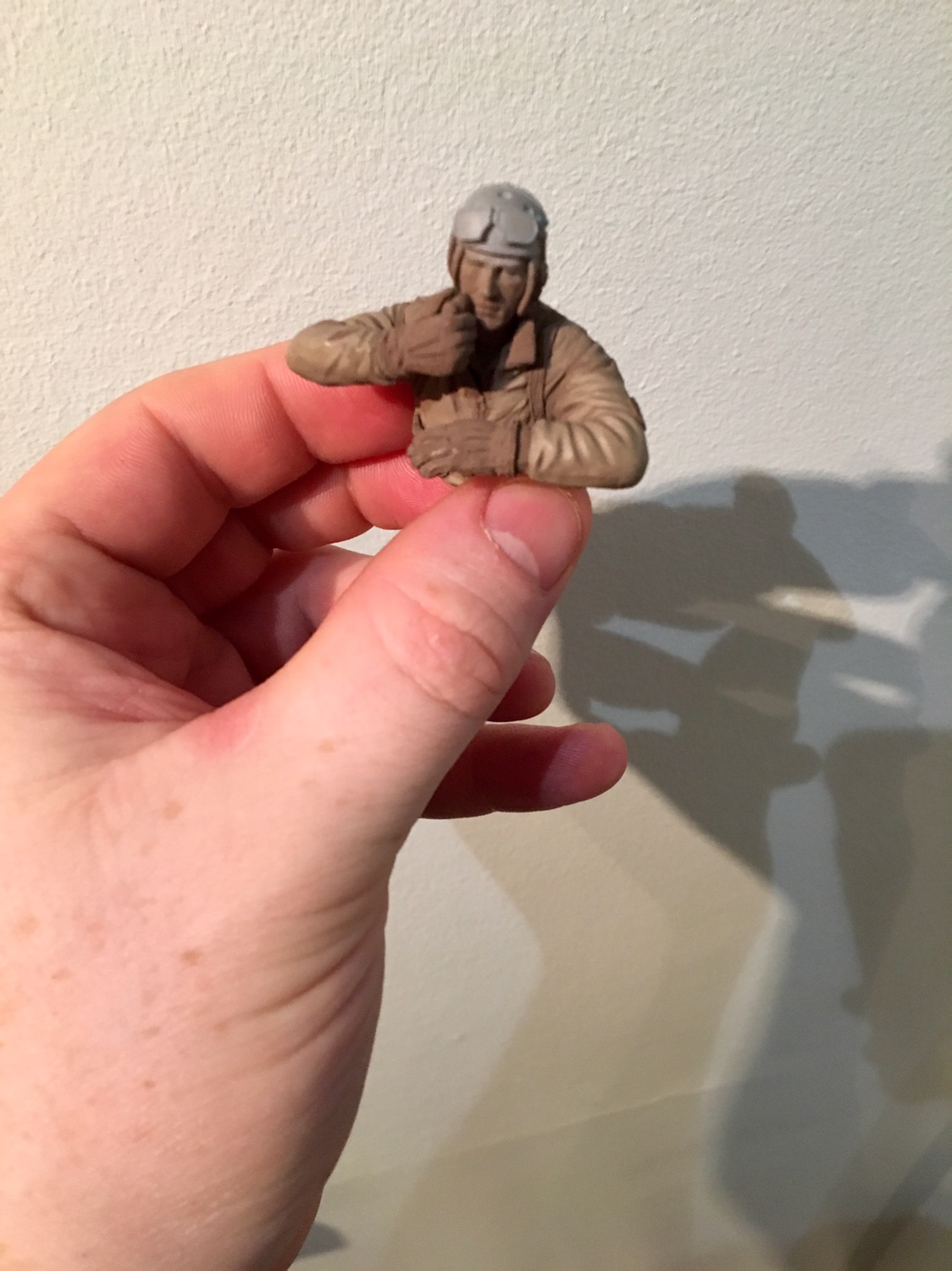

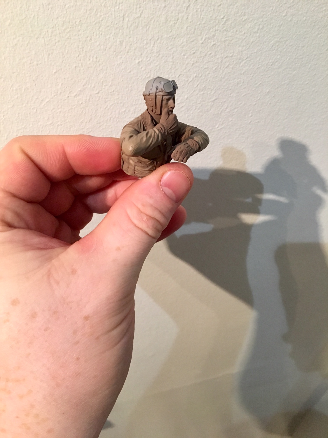

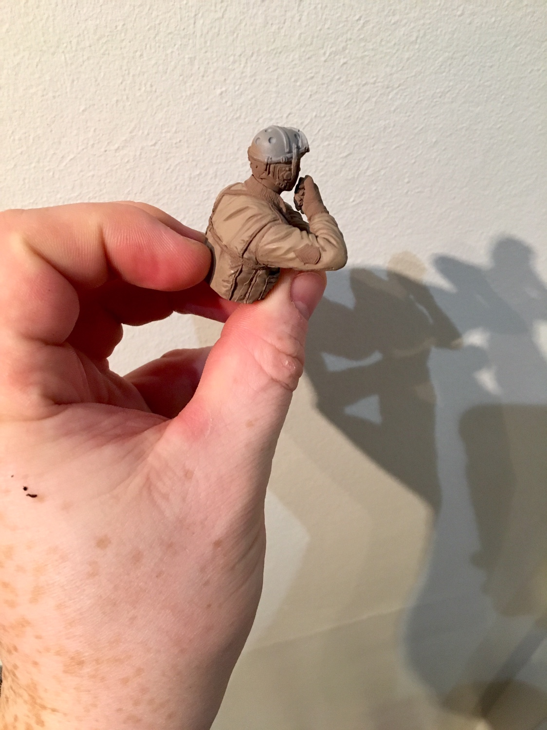

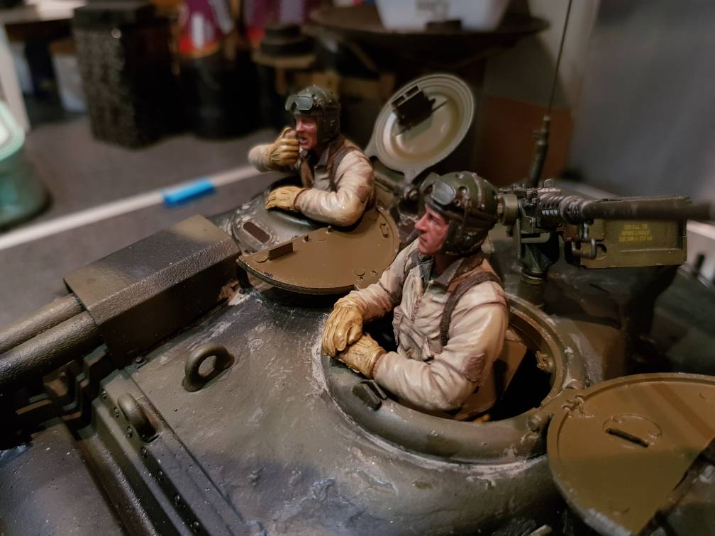

This evening's work, finished the highlights on the jackets and the gloves, based everything else. Fun bit next..faces! Attachment 2262916Attachment 2262917Attachment 2262918Attachment 2262919Attachment 2262920
