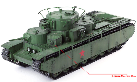

I recently saw a thread of the T34/76 in 1/6 scale. Yeah, I was salivatin' like one of Pavlov's Pooches. And there's a guy on RCTW that's 3D printing a T-35 (massive multi-turret beast) in 1/6 scale. 1/6 scale!! Talk about a monster. It's over a meter and a half long! It's so big that if he assembles it in the room it was printed in he won't be able to get it out the door. Here's a photo of the T-35, imagine that in 1/6! Shows what a madman Wayne is. I love it!! :)

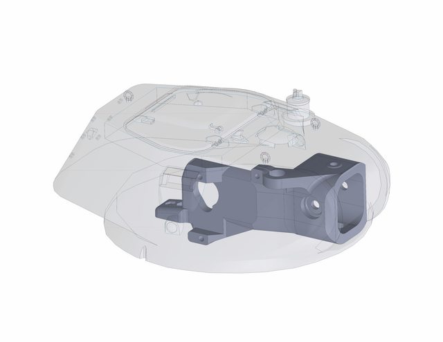

There's a guy on RCTW that just designed a new recoil/elevation unit that should fit nicely in that small space. Let's see if this shows the photo
Attachment 2263103
and you can see more here. Scroll almost to the bottom until you see the T34 turret in a 3D model.
https://www.rctankwarfare.co.uk/foru...26539&start=20
Dusty Steppes 01-01-2019 09:49 AM
I'll have to look into that recoil system. A little more progress. Moved the power and volume control to the engine compartment and tried to hinge one of the turret hatches. I'm not really pleased with the hatch. The plastic in this model is too soft.
