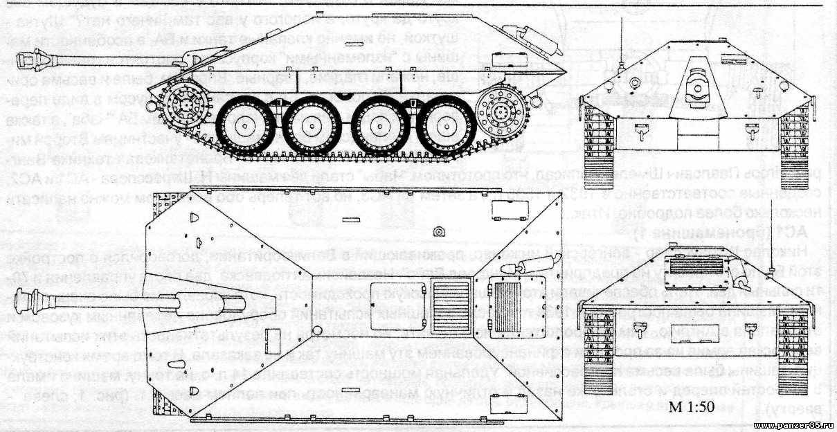

The Maresal vehicles were a series of domestically produced Romanian anti tank guns which proceeded from the prototype M-00 to the final series of prototypes designated M-05 and M-06, the M-05 being the one of interest as it was the one which dropped the T-60 chassis on which they were being built up to that point.
https://cimg9.ibsrv.net/gimg/www.rcu...57bd24fac3.jpg
https://cimg0.ibsrv.net/gimg/www.rcu...317f2835a2.jpg
The M-04 was field tested in early 1944 and this testing was witnessed by a German officer called Ventz and another one or two according to some historians. The M-05 was tested in March of 1944.
The Romanians planned to produce the Maresal domestically (I imagine with German help) and a battalion was formed specifically to use the M-05 of which 200 were initially planned. Testing continued through out the summer of 1944 and the M-05 compared favourably to a Stug III in field trials during June 1944, again in front of German officers who reportedly liked it very much.
https://cimg1.ibsrv.net/gimg/www.rcu...60150bd93b.jpg
Wikipedia has the following to say about the assertions as to Hetzer/Maresal relationship.
"British historian Mark Axworthy suggests that the design for the Hetzer was likely rooted from the Romanian "Maresal" tank destroyer. In November–December 1943, a Romanian commission ordered from Germany and German-occupied France several components which could not be made in Romania, and this drew German attention to the Maresal. Hitler had approved the development of the Hetzer on 7 December 1943. That same month, Marshal Antonescu (Conducator of Romania at the time) commended the Maresal project to Hitler. Soon afterwards, on 6 January 1944, Hitler was presented with the plans of the Maresal M-04 prototype. Axworthy notes that the Hetzer's armament, armor configuration and chassis broadening were very similar to those of the M-04. He also reports that in May 1944, German Lieutenant-Colonel Ventz (a delegate of the Waffenamt) admitted that the Hetzer had followed the Romanian design solution. American historian Steven Zaloga writes that "The Germans were impressed with the overall layout of the Maresal, and it is credited with being the inspiration for the German Jagdpanzer 38(t) tank destroyer."
Im not getting into a discussion about whether or not the M-05 being the Hetzer inspiration is true or not but I thought it would be a nice thing to build.
So my plan is to build a Maresal from steel. I need double horned tracks so my plan is to use Sherman tracks and a modified sherman sprocket. Everything else will be scratched. Likely problems are the very sloped nature of the casemate which will be tricky regarding a gearbox and the leaf spring suspension which I have never tried beofre. Otherwise one would think it should be relatively easy as it just seems to be massive slabs of armor and very little tricky detail parts.
This will serve as a place holder thread as I busy sort of with something else so cannot promise this will proceed rapidly until I am finished elsewhere.
But I cut and shaped the first steel bits yesterday and I will see how it goes from there. Humble beginnings and all that.

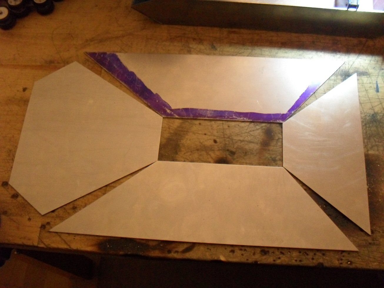

lposter 10-01-2020 10:08 AM
I reckon I'd have to be Da Vinci to put the stupid thing together.

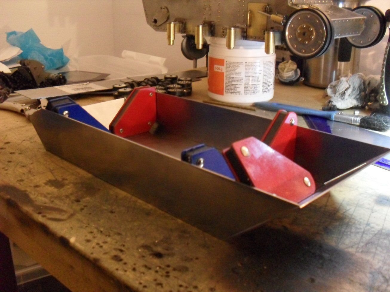

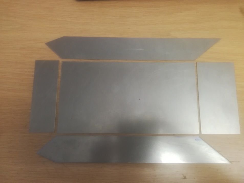

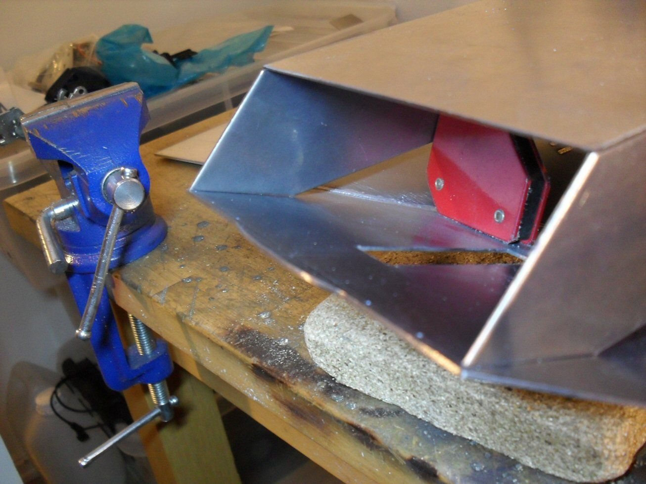

I test fitted the bottom bit today. Seems straight forward.
I cut out the main bits of the top.... and there is not a normal angle in it. Anywhere. Somehow I have to hold it together to get it soldered.
I dont know how magnets could work as there are no right angles (or anything like 45 degrees or 60 or whatever). I may use some kind of wooden board with nails in it or something.
I have to think about this.

Imex-Erik 10-01-2020 01:24 PM
If you can think of a shape you need and draw it out for us I'm sure someone can print you a jig with some magnet inserts in it. The Hetzer is one of my favorite tanks, I'll be more than happy to offer to help there. Can you draw it up for us on a piece of paper or in something like Tinkercad?

lposter 10-01-2020 09:14 PM
I might have to take you up on that! I'll probably take one shot at it in the old fashioned way before I give up and seek assisstance.
BUt you could be on to something with the idea of a jig and magnets.

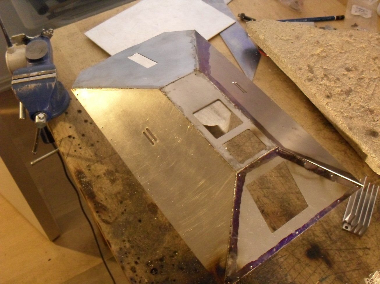

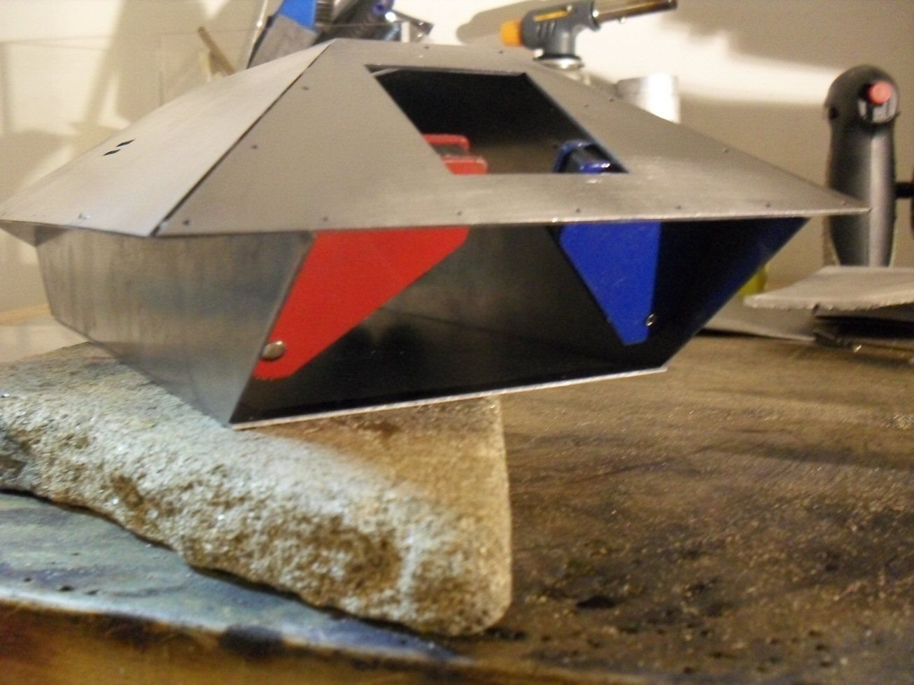

lposter 12-04-2020 06:03 AM
Hello

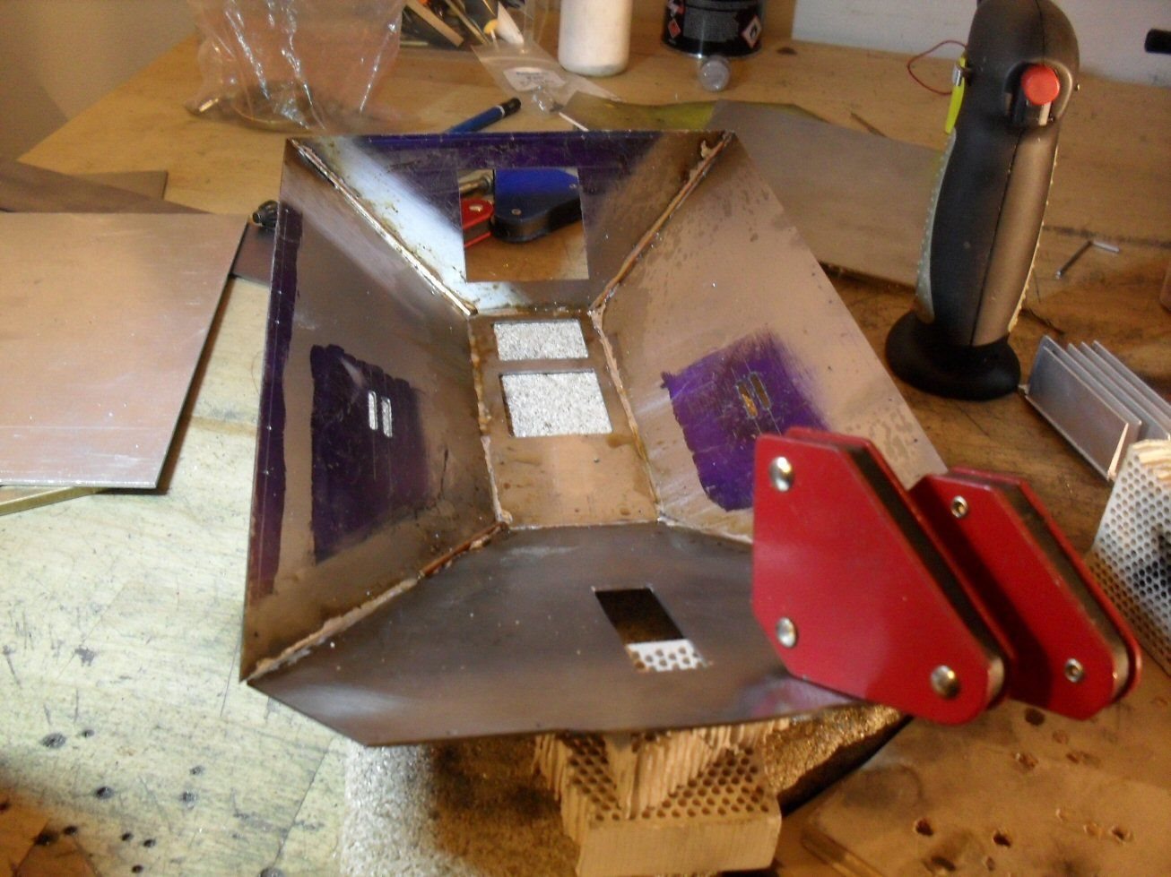

It was time to p**s or get off the pot with this Maresal so I drank a lot of water and got stuck into it.
To be fair ... over the past few weeks Ive been doing a lot of filing and stuff and had a lot of the bits ready to go. The trickiest bit was always going to be (actually the second trickiest bit) this shallow turtle casemate over the top. The angles have to be spot on or deviations will propogate down through the rest of the model.
In the end I gave up on my adjustable protractor and all the cardboard templates and just slapped the five bits on a flat surface and raised them up incrementally until they all came together like a flower or something.
I used some brass bar down the widest angles to beef up the fillet and to serve to fill up some of the gaps and form a foundation when I start slapping on the filler and sanding. Otherwise...quite pleased.
It looks rough as hell but its even and flat along the bottom which is the crucial thing.
Apologies for the roughness but Im not wasting time sanding and cleaning at this stage.
P

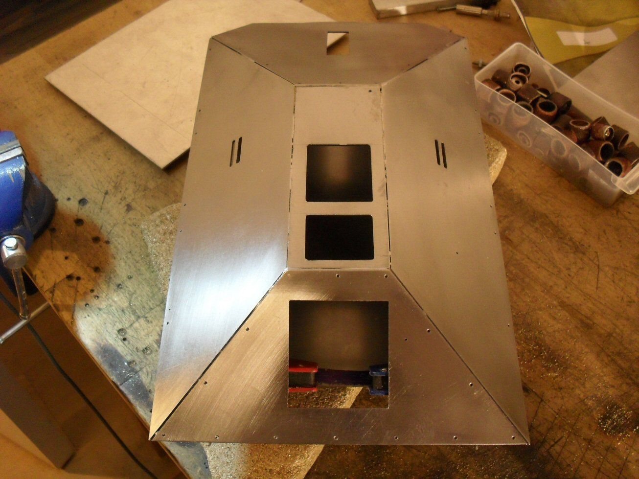

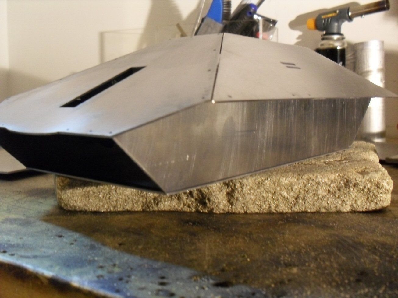

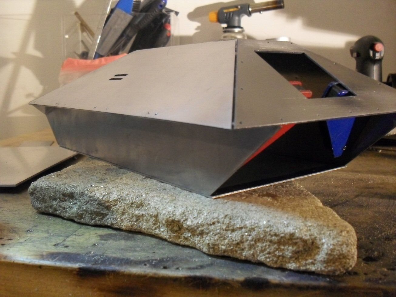

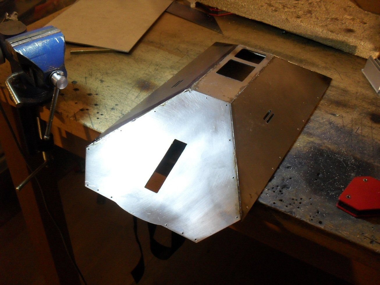

lposter 12-04-2020 08:26 AM

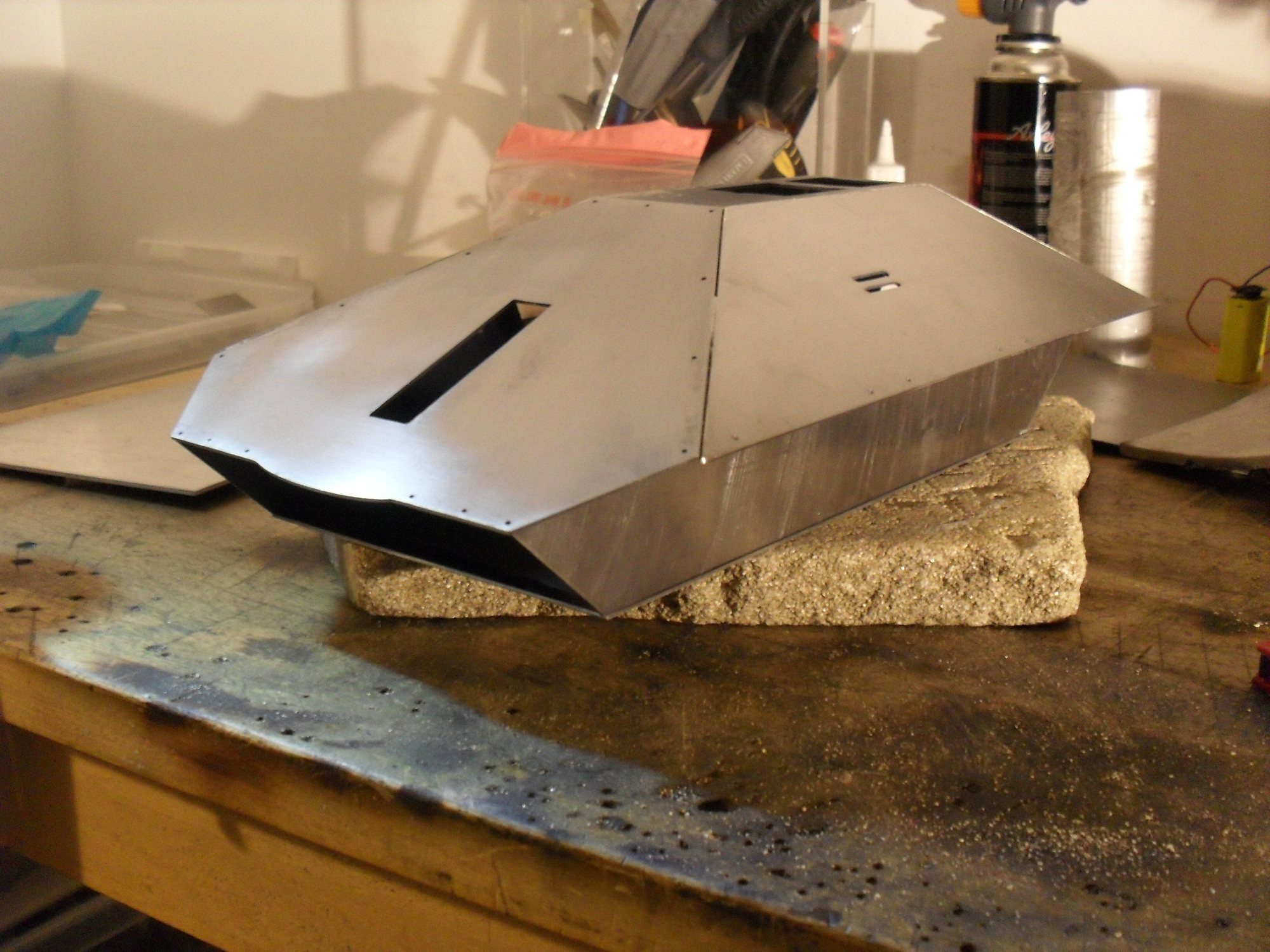

There wasn't a hope of me sleeping tonight without knowing whether or not the top piece was going to line up with the bottom of the hull so I wiped off the crud and started fitting the main pieces of the bottom hull to th etop bit.
And was pleasantly surprised!! Not more than half a millimeter out and maybe half a degree on an angle or two!!! Kaaaacchiing!!
Really got lucky and this will save me a whole shedload of frustration!
I really like the sports car look of this tank and am really hoping the rest doesnt prove problematic!

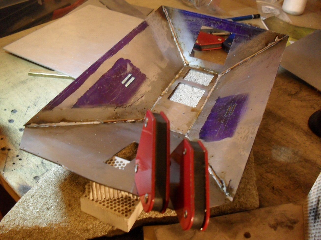

jarndice 12-04-2020 08:52 AM
P
https://cimg9.ibsrv.net/gimg/www.rcu...f39158aba6.jpg
https://cimg0.ibsrv.net/gimg/www.rcu...3aacc3af9b.jpg
I work a lot with Photo-Etch but I rarely use a soldering iron instead I use a Butane torch and "Fryolux" Paint,
With a job like this I would cut a length of a bean can to the right length and tack solder the end of the bean can to the centre of the plate then pull the adjoining plate in place and tack solder the other end of the bean can strip to the centre of that plate
This allows the correct angle to be held, If needed a support can be placed under the plates when they are being held together.
The two plates being held in position you can now PAINT the "Fryolux" liquid solder along the seam and run the torch flame along that seam and job done--continue with the rest of the plates then "Desolder" the bean can strips.
A word of warning "Fryolux" liquid solder is very toxic, It will kill fish and young children so keep it somewhere safe,
It is expensive but lasts forever...
