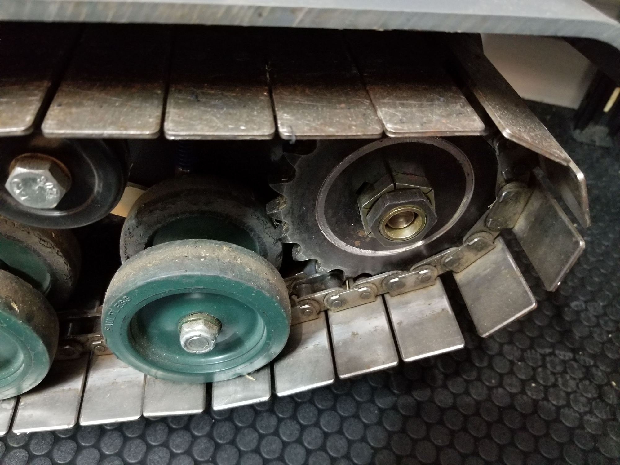

tankme 06-21-2021 05:07 PM
I would agree with the brushed over brushless setup, but that's because I've also used the brushed scooter motors in my 1/6th scale 150lb KV-2 paintball tank. It's actually really hard to control a tank at high speed with slick tracks. So for your purpose you will need to have a lot of grip on your tracks, but that also hurts you when you need to turn.
https://cimg7.ibsrv.net/gimg/www.rcu...f4704cf464.gif
40 pitch sprocket on 450W 24V motor.
https://cimg9.ibsrv.net/gimg/www.rcu...34fdcd204e.jpg
Direct chain drive.
Crius 06-22-2021 04:42 AM
That looks a lot like the setup in my hetzer, scooter motors with the chain drive. Those Motors are ridiculously powerful, I'm using a 2 x 32 sabertooth and a FlySky I-10 radio and I set the endpoints for throttle at just 50% and it still has loads of power. I've got some video of it in action somewhere, if you want to see how it performs let me know and I'll post a video or two when I get home from work tonight.

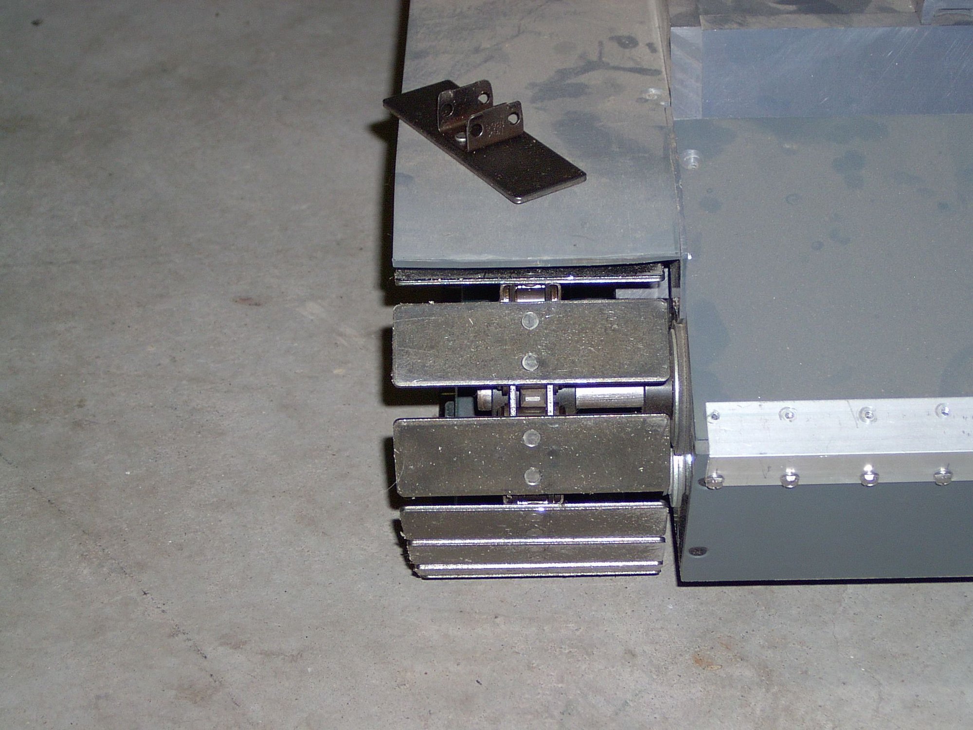

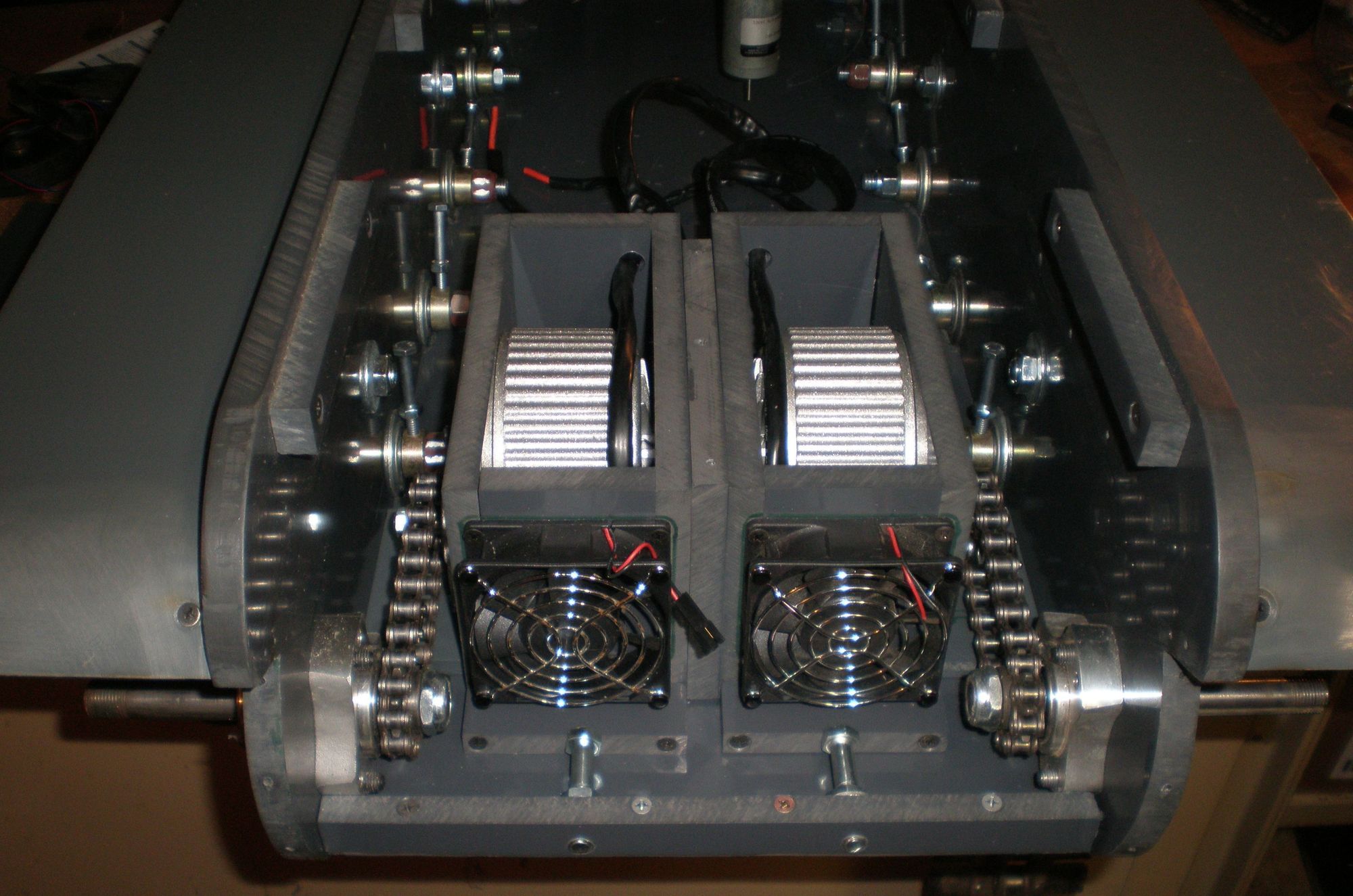

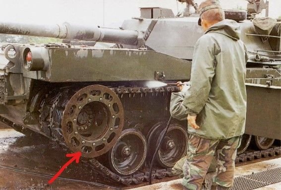

tankme 06-23-2021 06:44 AM
Originally Posted by Kensei (Post 12683251)
Im thinking of putting my drive gear in front, also will it be possible to not use a break function to turn but rather run one track forward and one track reverse to turn?
Stresses on the track will be alot less then.
Thank you for the photos. They are reqlly helpfull!
Like it's been said, no matter how you turn the vehicle the tracks will try to slide sideways off the sprockets and under the roadwheels. It's the nature of the beast. Friction is trying to keep the track in place on the ground when the motors are pulling it in a different direction. The more grip your tracks have, the worse it will get. Even a real life Abrams tank that has had millions of dollars of development work will shed its tracks if you do a neutral turn (one track going forward and the other in reverse) too fast or for too long. There are ways to try and keep the tracks on though. You can use large high center guides (which only work with large sprocket and idlers due to the need to wrap tightly around them), you can use really stiff tracks like I did, you can use tracks with guides on the outside of the track (like the M5 Stuart tracks), or you can use "track retainers" on the sprocket and idler (basically rings mounted on the outside of them that reduce the chance the track will come off). The original Abrams used a track retainer on the outside of the sprocket, but no longer does. It's all a balancing act.
https://cimg7.ibsrv.net/gimg/www.rcu...59e261b316.jpg
Abrams retaining ring - will only stop the tracks from riding over and off the sprocket if the tracks don't have enough room to as shown. The sponsons are close enough to the ring so that the tracks can't ride over it. If there is enough room for the track to come over it, they will when something gets drawn into track and over the sprocket. Not compatible with the M5 track type below. Pretty much only works with center guide type tracks.
https://cimg8.ibsrv.net/gimg/www.rcu...f9959e7b41.jpg

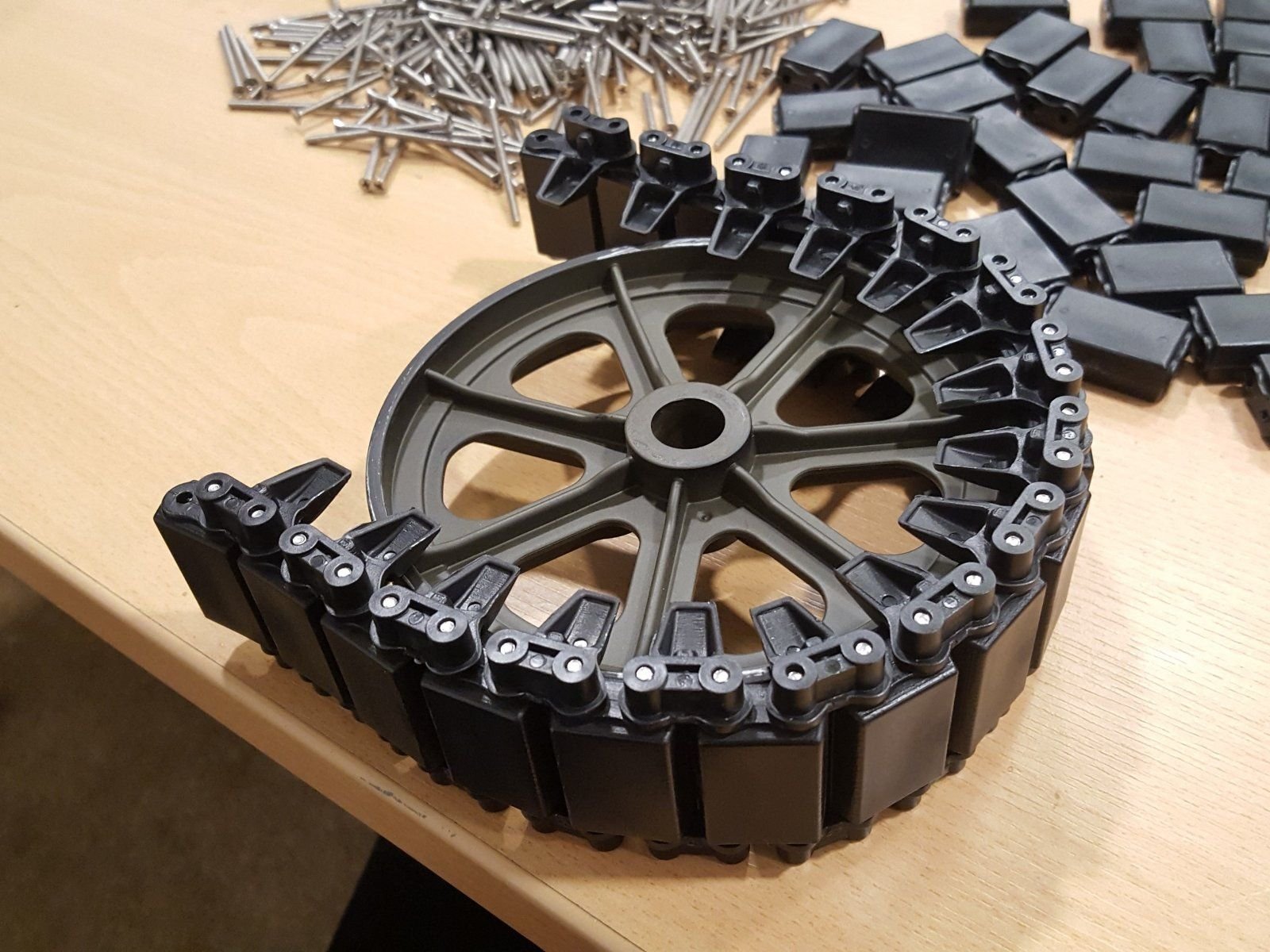

M5 Stuart type tracks with guides on the outside.
https://cimg1.ibsrv.net/gimg/www.rcu...cefb7d2af8.jpg
Very stiff center guide tracks.

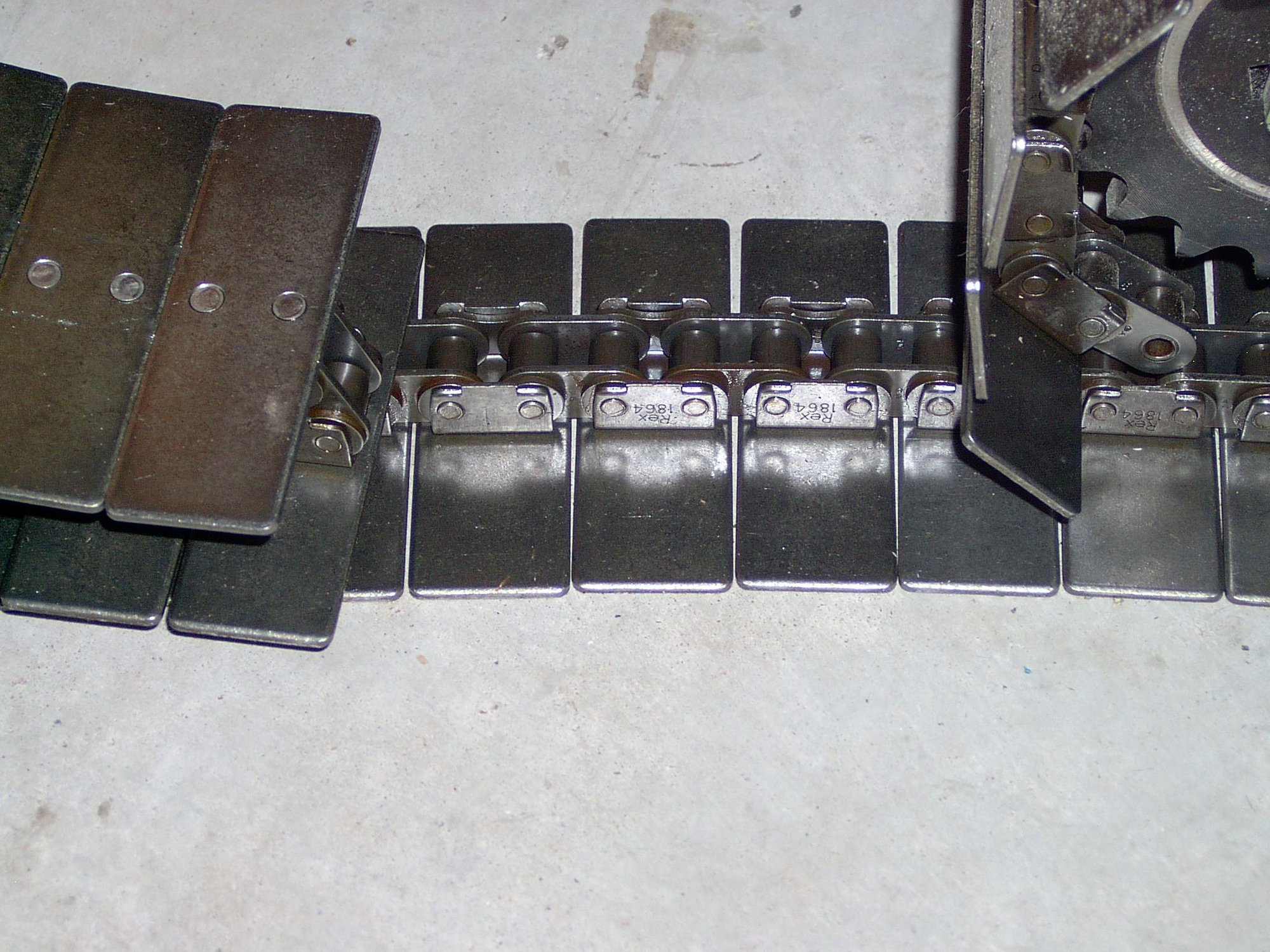

https://cimg2.ibsrv.net/gimg/www.rcu...db21f64a9b.jpg
Very stiff with almost no left to right deflection. My tracks are off the shelf Rexnord 1864K4 conveyor chains with a K1 attachment. In this case the track type is Rex 1864. The K4 in the model number means K1 attachment, 4" width.
https://cimg4.ibsrv.net/gimg/www.rcu...5f54324d69.jpg
Very slick surface which helps reduce friction with turns, but causes the tank to turn too quickly at high speed. Tracks will actually break free if you gun the throttle.

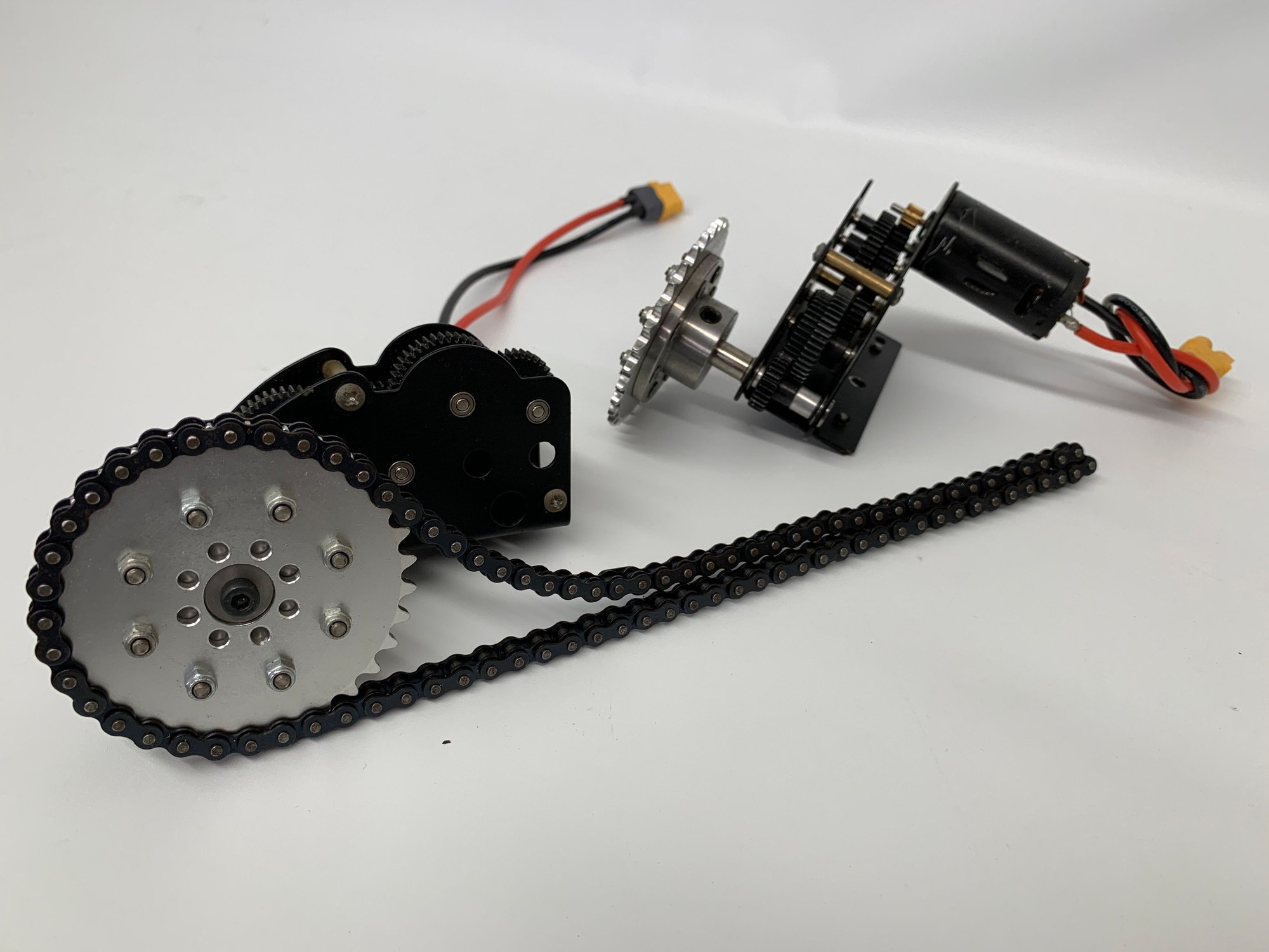

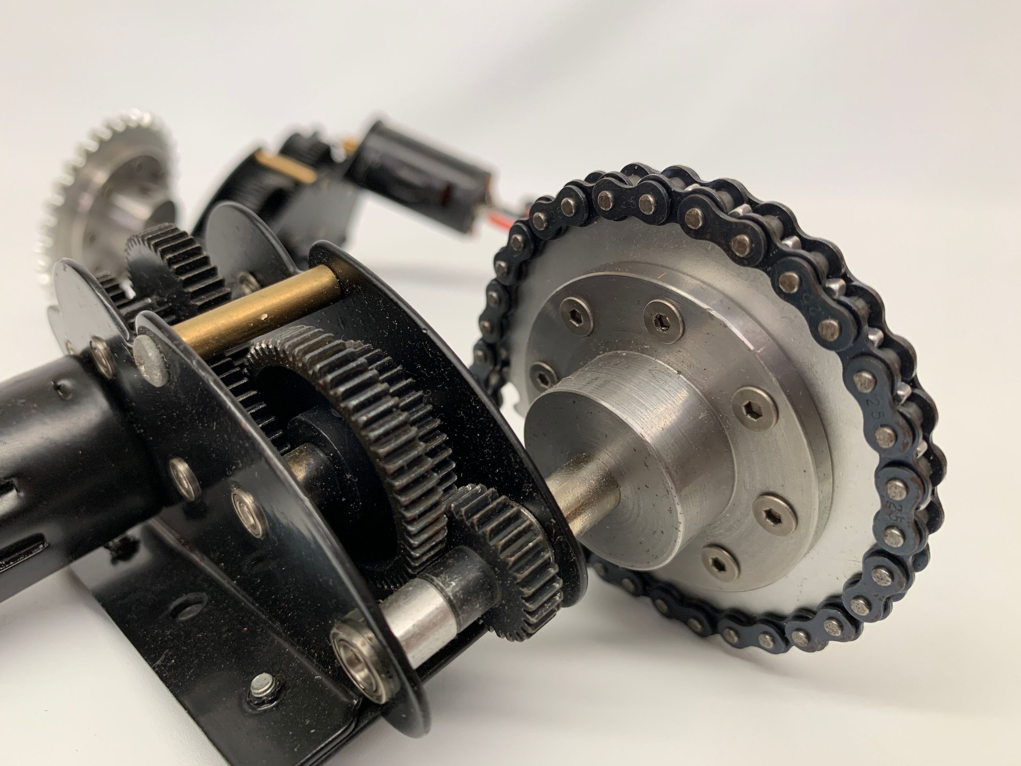

Imex-Erik 06-25-2021 01:38 PM
I think all us seasoned tankers are in agreement here with the brushed versus brushless, I think we have all tried at one point honestly and wanted it to work. Brushless motors are much more common these days and getting different spec motors is much easier than brushed motors. The prices aren't too terrible either really. Just for our heavy slow speed application brushed is better ATM until sensored brushless motors/escs come down in price.
Also just a heads up controlling the tank is the easy part, almost all the aftermarket boards out plus the Taigen board allow you to run your own ESC/Motor combos and if you just need to control the main motors without a controller you can always program your radio to a delta wing mix and connect each drive motor to the respective channel output. The transmitter will mix the input and output a signal perfect for driving tanks and doesn't require a control board at all. Heck if you want to get real brave you can always retrofit a current gearbox out now to run a chain, that is what I did. I had a friend make me a set of sprockets to go on the TG gearboxes to adapt a chain and use that to power a mower. That project didn't get finished but I do have everything to finish it when I find another dead mower to play with (I got a rider now so the RC lawnmower took a backseat).
Imex-Erik 06-25-2021 01:43 PM
https://cimg3.ibsrv.net/gimg/www.rcu...b015af91c.jpeg
https://cimg5.ibsrv.net/gimg/www.rcu...174a39bc3.jpeg
Pictures for reference. Pretty cheap this way and tons of gear reduction
