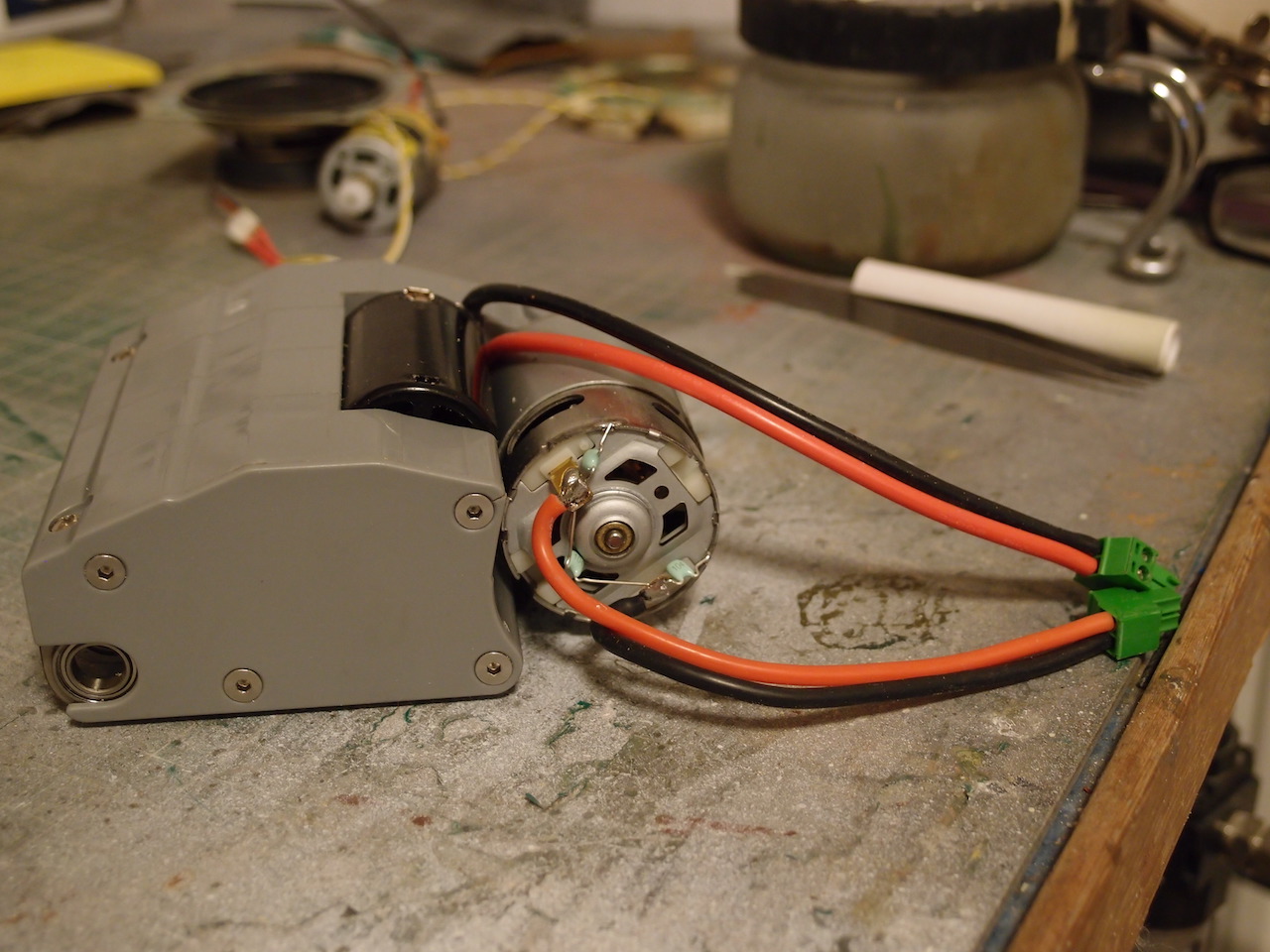

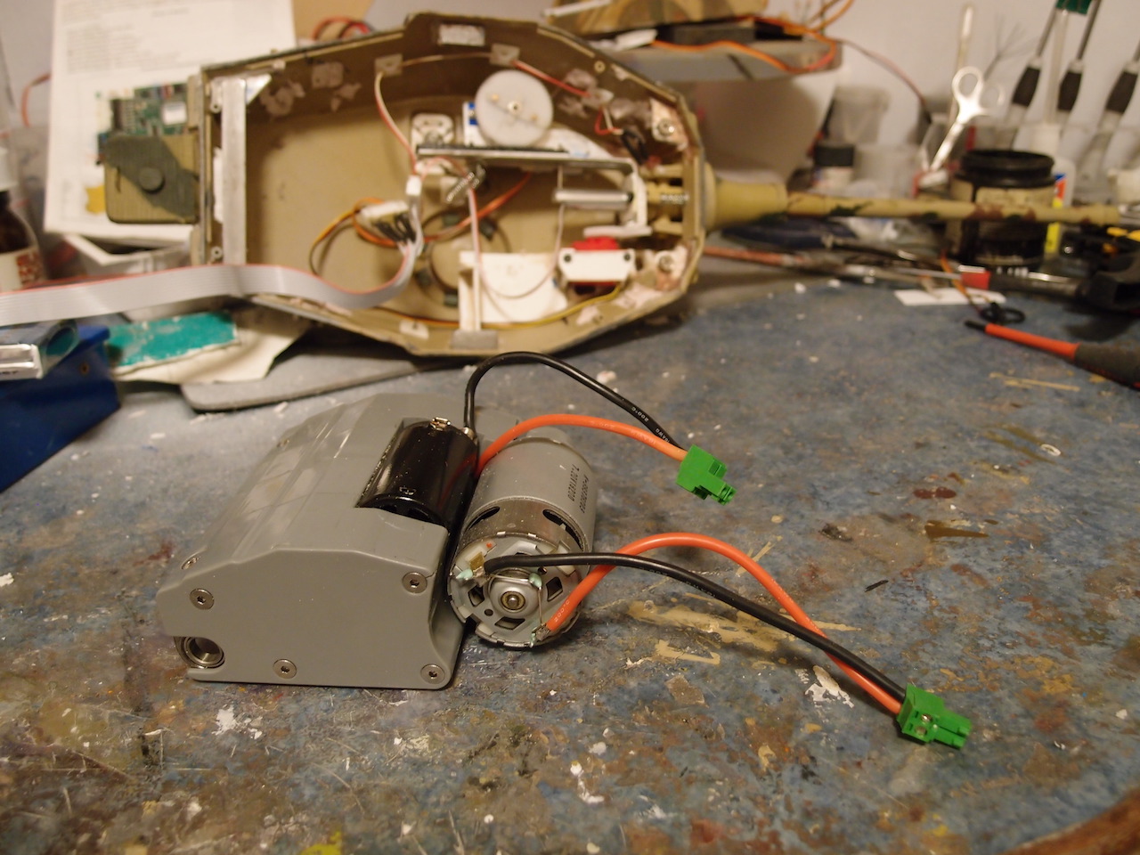

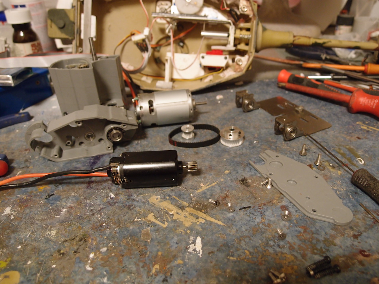

The motors are on the wrong side for an Elmod board ,one of the leads is short due to motor fixing. Stripped gearbox down as the short lead is hidden, you need to disassemble the side with the toothed belt. Will colour code the plug and socket to avoid mistakes .Attachment 2271142Attachment 2271143Attachment 2271144
ronnie42 12-13-2021 01:04 PM
Part 2 of the maintenance, was going to add some grease and found a possible problem . One of the gears has bearing recesses that are not round, have part of another position for a different gear. Filled the upper section with epoxy as the bearing might move and destroy the gears.

I would open up the HL gearbox,if it’s a copy it will have the same bearing positions . Looks like a money saving design using the same housing for high and low speed gearboxes. All depends on the Al used as Al has many grades, If it’s a soft Al same result will happen 😳. The bearing is only held in a 2/3 housing.
