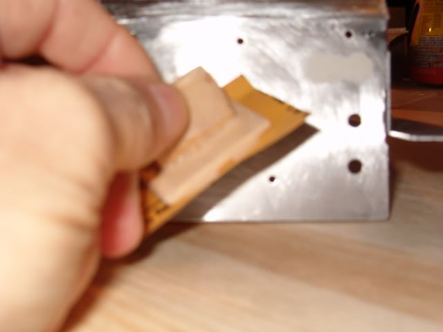

Thought I'd show where I'm at and what I've done so far. After my first Sherman build I noticed that pieces B15 and B14 (that are supposed to look like track tension housings) are mounted way too low and when the idler assemblies are mounted at the right height, they do not line up at all. So, I filled, grinded and epoxied them to the correct height.
Attachment 2239533

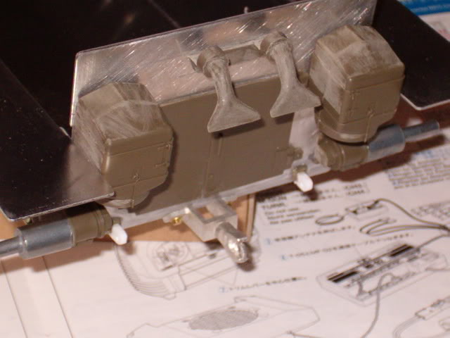

While I was at it, I also made some towing eyes that were completely overlooked by Tamiya.
Attachment 2239534
Also, I went ahead and added the tow pintle.

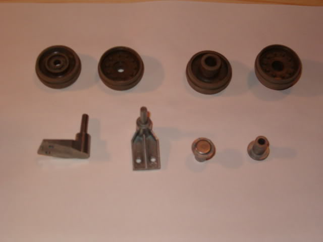

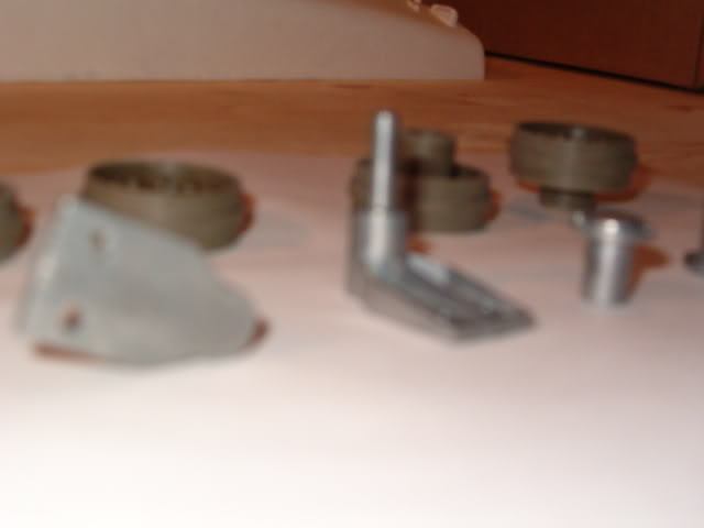

And, to add to my list of corrections for the Sherman kit, I will be adding bearings to the rear idlers. Especially since metal tracks are to be added, this is a must modification!
Attachment 2239535
Just need to drill and measure for some nice ball bearings!
Attachment 2239536
