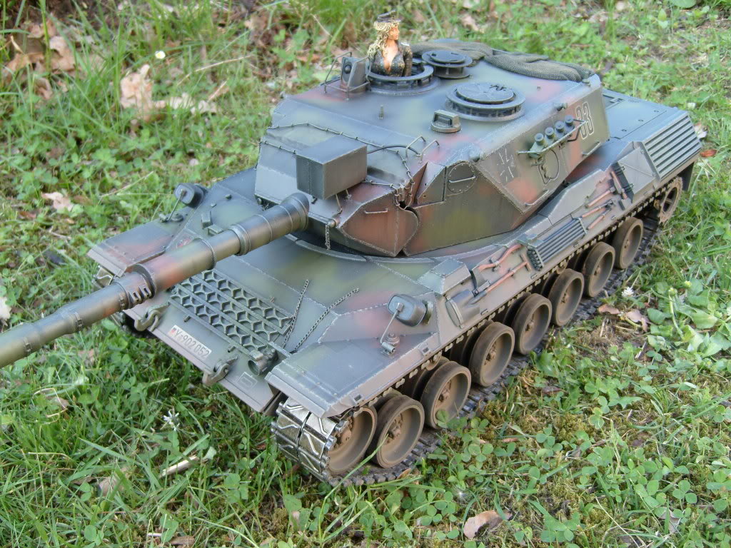

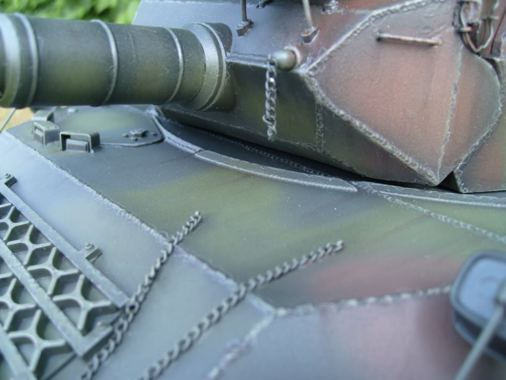

Tamiya Leopard 1A4 mit HL electronics package
1. Tamiya Leo1 that i got second hand, 1970s vintage.
2. HL StugIII electronics package + HL turret ring + Matorro T34 turret turn gearbox.
Attachment 2238612

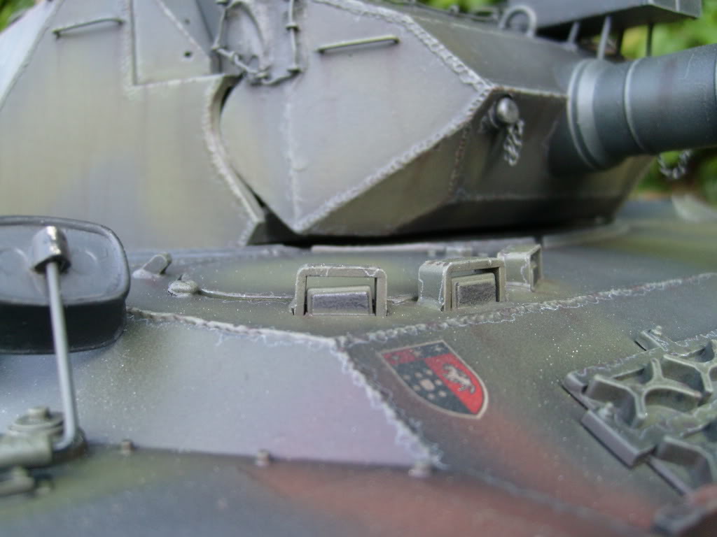

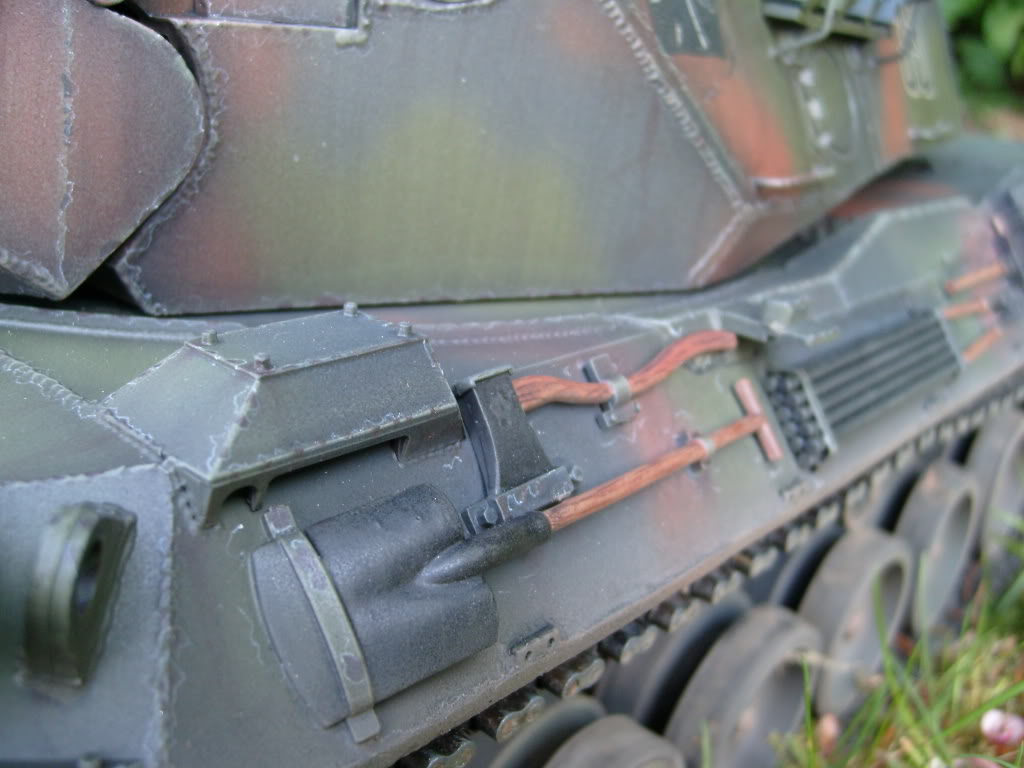

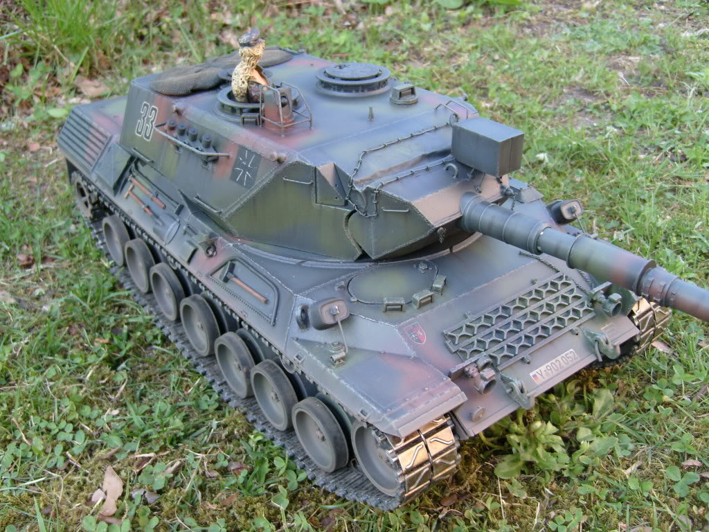

3. Extra details.

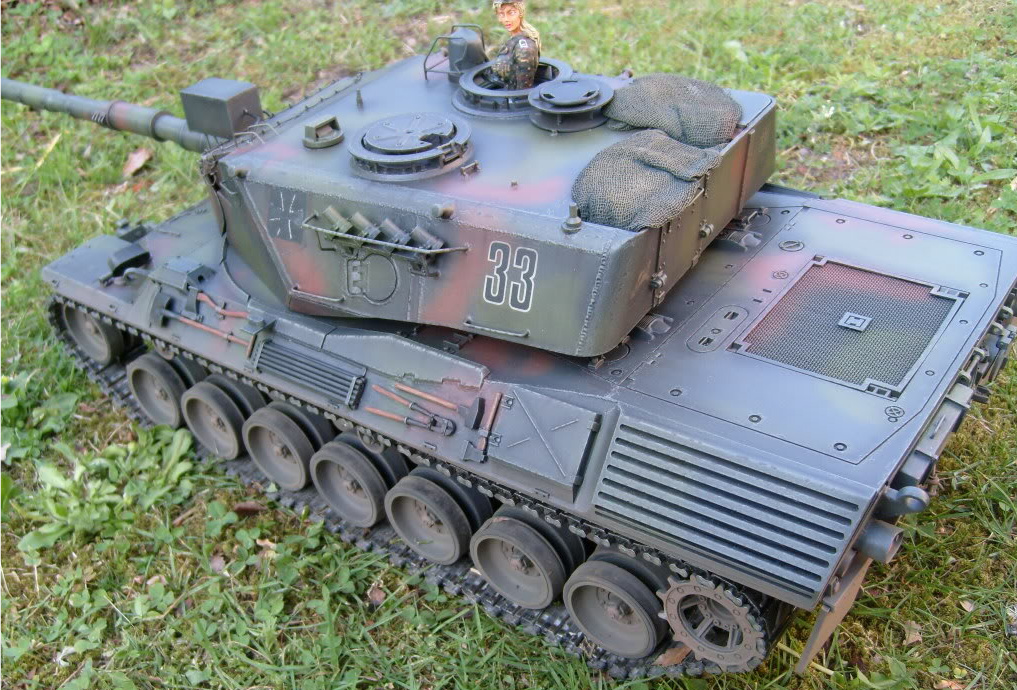

4. New paint job.
The power and performance does not do the real thing justice but at least it moves.
Film: http://www.youtube.com/watch?v=e9g3GJBxhL8
Bilder:
Attachment 2238613
Attachment 2238614
Attachment 2238615
Attachment 2238616
Attachment 2238617
Attachment 2238618
http://i468.photobucket.com/albums/r...et/Leo1014.jpg
Cheers
Alan.
HG1980 05-01-2009 03:21 PM
RE: Tamiya Leopard 1a4
damn thats nice
swathdiver 05-01-2009 04:16 PM
Bill's gonna be after your Fraulein! [:-] Nice overhaul except for the ALICE TRACKS! [:@]
Nice cleavage shot BTW! :D

Nice job!! She can be in my crew any day! I have one waiting for restoration. It has the twin gearbox - single motor. How did you mount
the gear boxes and what did you use to make the "canvas" mantel cover? I plan to put a complete HL system it.
Also, your tracks are on backwards, mine were as well. Great job!!

As for a 'canvas' mantlet cover, I'd suggest cotton tea-towel or thin cotton hankerchiefs, and then soak 'em in the color of paint you desire. Dollar Store latex for kids diluted 50/50 works a treat (its how I make my tarpaulins/tents/camo tarps, and color my sandbags) If you want it stiff, or even waterproof'd, then paint the inside with white glue, which can also be used to tack the edges into place if you don't wanna make the wire frame w/ the bolt-down points. If you've lost your original, I have one from my pair of 1A4's thats near-mint, and could make up a template for ya.
Gotta say, its nicely done, though the chain for the mantlet plugs, etc. seems a bit large scale-wise. And then after the point of adding that chain, he didn't put the chains on the smoke-pot caps (like on the 2A6) I've got some for mine, but its on the to-do list... (amongst many other things)

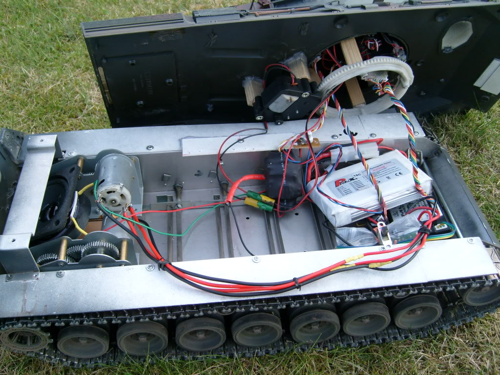

The company in Germany that makes the conversion plate for the tamiya gearbox is called AFV and their stuff is top rate aber teuer. There is another company called Scale that also make great Leo parts. I have an aversion however to buying relatively expensive add on parts when you can make them yourself for next to nothing.
I made the canvas mantel cover out of silk and then made eyes out of staples and threaded some metal wire through.
The HL motors are mounted on a 12mm thick piece of wood.
Yep the chains are a bit thick I should have used a smaller gauge of chain. Just did not have any to hand at the time. I could put some on the smoke dischargers too.

I beefed up the electronics with Tamiya Pershing DMDs + Jamara 480 Motors.
This is how it now looks inside:
http://i468.photobucket.com/albums/r.../verden001.jpg
It makes a big difference to the handling I can tell you: http://www.youtube.com/watch?v=jMHVB6l0nCo
AL

Beautiful job, but you should really get some grease in those gearboxes and make some covers for them so the grease does not destroy the speaker.
