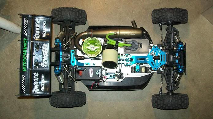

Im new here and to the RC nitro world. I always wanted to get in to the gas/nitro RC cars. But fear got to me when i read all about nitro powred cars need alot of care and what not, so i stayed with electric cars.
Fast forward to about 2 days ago, Iwas playing my traxxax stampede when a guy stoped and asked me if i would like to buy a nitro car, and that he had 2 cars 1 is good and the other is for parts, i thought i would take a look, and i liked what he had he wanted $200 for every thing but i offred him 100 and he accepted due to the fact he has 2 new borns coming in the house soon and doesnt want all the small parts and nitro gas laying around.
The car is a DURATRAX "RAZE" the last owner has done alot of upgrades on the car and he also gave me all the bills that he bought parts with. Along with the car, came another car that was in parts there where parts that were still brandnew sealed in the bags so for $100 i thought i got a killer deal.
He also have upgraded the engine to a AXIAL 28RR Spec 1.
I ran the car yesturday for a few runs, but had alot of problems starting the car today took me about an 1h to start it and then started to play with the high speed niddle to make it stop bogging and what not, the guy told me that the engine has 2 gears in it, and if tuned right i could hear it when 2d gear kicks in, but so far iv been playing with the car and its hella fast but i dont hear that 2d gear kick in.
A problem that im having is the engine is getting really hot to the touch some times it has reached 230 For so. I read online and stuff and some say keep the engine between 200 to 250 F and some say from 200 to 300 F
Q:
1. As for the gas, that the guy gave me its 20% nitro and 16% oil is this gas mix good for this engine?
2. does this engine have 2 gears? and what would i have to tune to be able to hear the 2d gear kick in.

when tuning a nitro engine always make sure there is smoke emiting from the exhaust.
because you bought it used and really have no way of telling what the last guy did you should always check the needle settings to make sure you are in the right spot to begine with. the temps you listed you should be ok .
the axial .28 i have says never to go above 270 degrees and that between 240-260 is normal.
as far as hitting second gear which is in the transmission but depends on engine rpm to shift.
once you have the engine tuned properly it should shift fine.
if it still does not shift it may be a simple adjustment in the tranny.

Being new to nitro, you will be suprised how much an "off" mix (tune) will effect your car.....whether it be shifting or starting, the tune you have is very important. Problems you face will 90% of the time be solved with a slight adjustment of the hsn or lsn. It took me awhile to grasp this when I first started......that my hours of frustration were solved by an 1/8th of a turn on the hsn. Educate yourself on tunes and how lean and rich mixtures behave...you will be lost at times, but when you do find the issue you will feel silly at the frustration caused by a simple turn of a needle.
Issues can lie elswhere of course, but from my experience the tune dominates your problems especially if you are new.

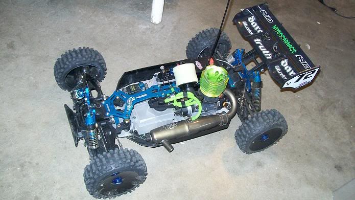

im getting a hang of the tuning a bit now, when the car is warm and i shut it off and come to turn it, it turns on with 1 pull
but i was still wondering about the 2d gearing i thought i heared it last time but wasnt sure it sounded like it changed to 2d gear but after watching some youtube videos i heared how 2d gear kicks in but ima take it to the hobby shop and have them take a look at it and tell me about it more in detail

so i guess the buggy has only 1 gear. HELP!!!!!!!!! i got back from the hobbyshop got the car running and i started to tune it, i got to a tune that the engine was ok not over heating and got a good speed going, when i got that i did the pinch test and the car reved up and died in 3 or 4 secs i turned the car back on, and it turned right away i gave it gas and the car just died it didnt move but it revs really really hard when i punch the throttel but the car goes slow no punch to it or any thing but it has high rpms what could this be from?

i took the clutch apart and it wasnt it, it was from the differential, the screw was loose the car is fixed now.

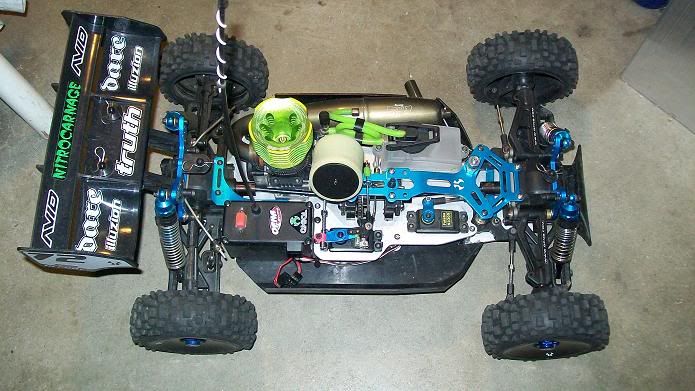

I have another question, the guy i bought the car from gave me 2 galons of nitro one was half and one is full well i ran out of the other one that was 20% nitro and 16% oil, but the full one that now i have to use is 20% nito and 12 oil would that effect the engine in a bad way? i already ran 1 tank on the 20, 12 oil i tuned it right and every thing seems ok does it matter if its less oil
generally a higher % of oil is used during break in and then for your performance after the fact some switch to a lower oil content.
it should be ok as long as temps are good and she is running fine.
i run byrons 20% nitro/12% lube and i have no issues and to be honest i used for break in as well.

Ya today i ran her for about a tank and a half on the 20/12 she pulls hard "I think so" but im sure i can get more from this .28 engine but im afrade of going too lean and blowing the engine or worse but anyways thanks guys

here is a pic of my buggy and seems to be very similar.LOL
it's a 2002 ultra mbx OFNA
i used a 18 tooth clutch bell and she rips
