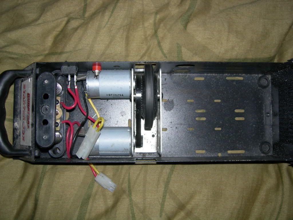

hey jombo this is my duratrax starterbox. has twin motors but wont turn the ST-1 over w/ 2 stick packs.... ill hook it up the my moms SUV and see if it will turn over. think it will???????????????? i use it for my buggy but has no compression compaired to this thing! i duuno ill hook it up tomorrow...

Max - that looks just like the ofna box I had. You hook two 8.4v batteries up to it and I guarantee it turns your st-1 over. Granted it may also end up in smoke like mine did, but your car will be running - LOL!!!
Also, I think the short in mine was 100% due to a botched wiring job that I did to get the two batteries lined up in series. If you actually spend the time to wire them correctly, they should work amazingly.

lol! ok thanks! thats what I wanted to hear!

Madmax thats the same as the first box i bought for my Nosram. It only lasted one day at the track and then the motors burnt out [:@] now i use the thunder tiger box with 2x7.2 volt 3000mAh Intellect batteries and its perfect. Starts up instantly, i dont even hear the starter box turn over, the engine just fires on contact with the wheel. Its more like a switch than a starter, i push it and the engine turns on lol

LOL! i have had it for a wile now! i never set the pegss up so it takes me 5 mins to get it on the box so it would hit the fly wheel. lol!

madmaxx22 you need this cable to hool up 2 8.4 batteries, its not worth making one for the price of this and that should turn it over http://www3.towerhobbies.com/cgi-bin...?&I=LXMTZ3&P=X

here are the speed 500 motors , geared their rated at 12 v each so tecnically you could run 16 to 18 volts with no problem
http://www.hobby-lobby.com/speed500.htm

if you have to much pinch try to give the starter cord a little yank when you ingage the stater box it will usually get youg motor spinning

I came with it and the one to put up to a car battery

Yes, definitely buy that connector Madmax. If your box doesn't have the tamiya connector to start with coming from the motors/starter just take your time wiring that up. I tried a McGuyver job and with that much power coming through it doesn't surprise me that I smoked the box. There again at 12yrs old you're already more r/c advanced than I am so I'm sure you won't run into this problem! It really does start up so effortlessly with this setup.

yup i have all the connectors. ill go try the car batt in the basement and hook it up to that in a little. I hope i t works! THe onlything about the starter box if I stall i cant just run over yank on the cord and be going again. ohh well... Ill live.

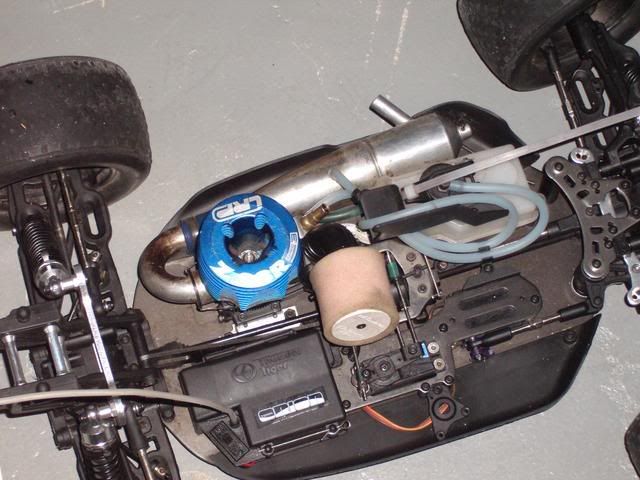

Got it in
Had to use a bumpstart backplate the SW .26 one. Also running the 15T bell. So hopefull will be alot faster then the mach 427. I didn't want to cut the backplate for the spin starter. Shimming wasn't feasable either way to high maybe 5-6mm gap don't like the idea of the whole motor sitting much higher on washers.Can't wait to try it. Looks so nice now. I might just be able to keep it if I can sell two memory cards locally when they come.
Would probably work with the proper rotostart backplate which is smaller and a spinstarter .12-16. instead of the pullstart backplate which is larger and the spinstart .21-.28 backplate.
More pics here
http://s81.photobucket.com/albums/j2...cem/Rc%20cars/
