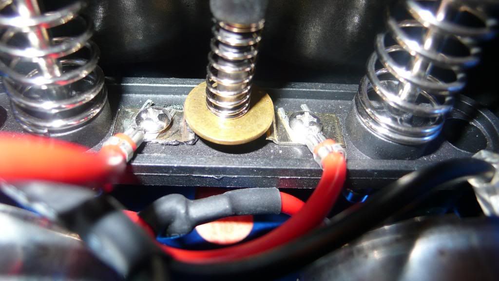

ok i recently (a couple days again) i bought a new http://www.amainhobbies.com/product_...ducts_id/12542 and i was tryin to position my losi 8ight-t on it and it worked good so i took out the batteries and turned it off. so i wake up the next morning to try to start car i put in batteries turn it on and push down nothing happened so i tryed a differnet battery same thing what happened. the motor wont spin nothing happens when i push down.

What batteries are you using.
Check these lil tabs and see if they've melted into the plastic, it happened to me, use an Exacto Knife or a blade and scrape the plastic off those lil tabs.
If your using a 12V, check the connections to the batteries, they broke the first day I was using.
And if you can, screw all those lil' tabs, solder all the connections, it'll work GREAT.!

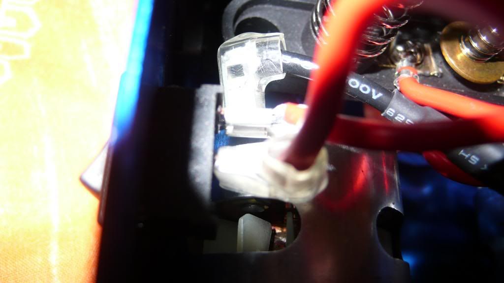

These are the tabs
If possible, solder ALL of them. They're prone to go wrong.

im using a 1800 venom 7.2 and a 3600 venom 7.2 but im makeing connections for a 12v
thanks ill try it

Yupp, 14.4V bats are what melted mine.
Just check the connections to the plate closely. Most likely its melted into the plastic housing due to the heat.

it doesnt look like it i took off the screws to the wire in the first pic and it came off the plate cleanly and i checked the other connections too

ok the batteries are good i tested them so im sorta thinkin the on/off switch could be bad any1 have this happen
