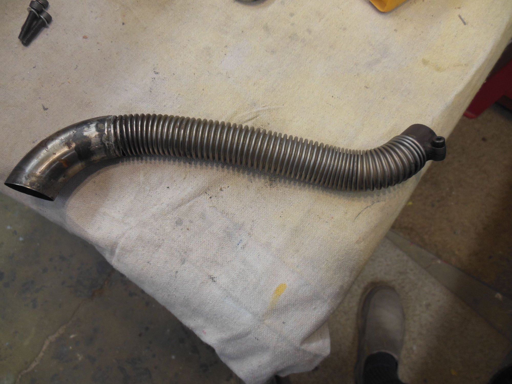

Looks good Gary. Can you show any detail on the exhaust exit from the inside. I am interested in how the flex pipes are connected to the exhaust outlets in the fuse.
thanks!
Old 10-27-2018, 08:13 AM
  #940
ram3500-RCU
My Feedback: (221)
ram3500-RCU's Avatar
Join Date: Aug 2002
Location: n. canton, OH
Posts: 9,737
Received 12 Likes on 6 Posts
thanks!
Thanks Craig. I'll look for a picture showing the interior. In the meantime, what you see is one pipe which connects to the engine collector ring, goes through the fuse and out where you see it. It has a built in clamp on the one end, and a stinger pipe, cut on an angle, on the other. Not sure where Graham got them.
Gary

Found a picture of the pipe Craig. we

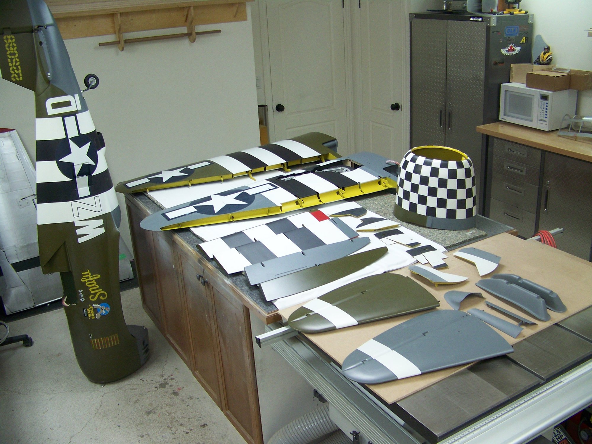

Operational cowl flaps built and being painted on the inside.

The exhaust bends are from KS-See attached link. I can't remember which size. They are then Tig welded to the moki extensions. Hope this helps-
Mike
KS Custom Header Parts
Mike
Thanks for filling in the blanks Mike. One thing I want to add. The pipes are not welded to the Moki collector ring itself. The welding is to the end of the flex pipe. I'm not sure if the is a Moki part or not.
