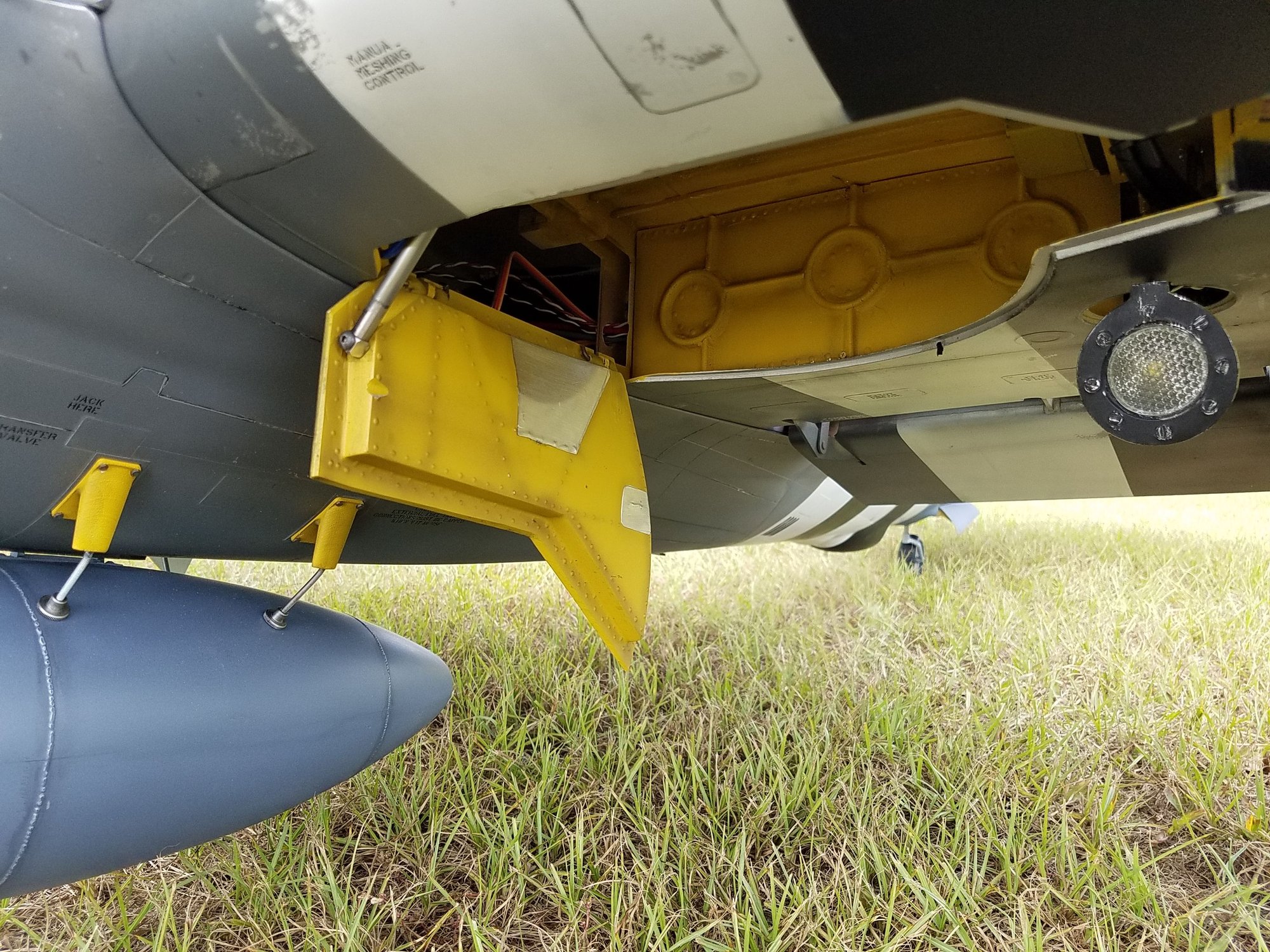

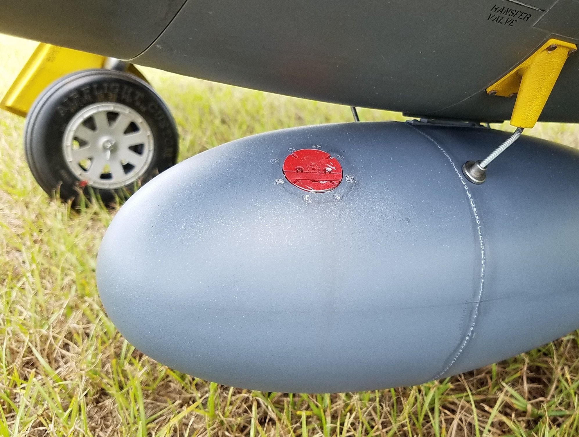

Default My Latest Project...

Default P-47
Originally Posted by Craig B. View Post
Absolutely superb looking model Mike! Great job. I just need to get mine finished. It is in the same scheme.... love it. Could you please describe how you fixed your exhaust outlets and how you did the detailing plate around the exterior of the tips? They look fantastic.
Thanks for the kind words, guys.
For the exhaust, I used the Moki extensions from Vogelsang, coupled to some K and S exhaust bends from Aircraft International. I had them welded at a local shop, but there is a product out there now called Fiberfix Heat Wrap that I think I will use next time to save the expense of the welding job.
On the outside, I took a large grommet that I found on Ebay (had to buy a small bag of them) , and opened it up slightly with the Dremel. Glued it down with Zap Goo. The trim underneath is Flight Metal on top of some thin G10 Poly Ply, with some rivets made with brass tube. Some Model Masters Scale Detail Wash (Black) to dirty it up a bit and presto....
The exhaust bend itself is not attached itself where it exits the fuse, but rather'floats' through the hole. I thought heat might be an issue, but so far no worries in that regard.
My first attempt at all this BTW, so there might be a better way to accomplish the above, but so far so good.
-Mike

Hi Mike, great info thanks! I have that exhaust flex tube and I and s tip but had no luck soldering it. Might have to get it welded like you did. Can you post a link to the grommets you bought?

Default Grommets
Here is the link to the ones I used-you still have to mod them a bit with the dremel, as the id is still a bit snug for the pipes.
https://www.ebay.com/itm/Grommet-Eye...r=490305944233
