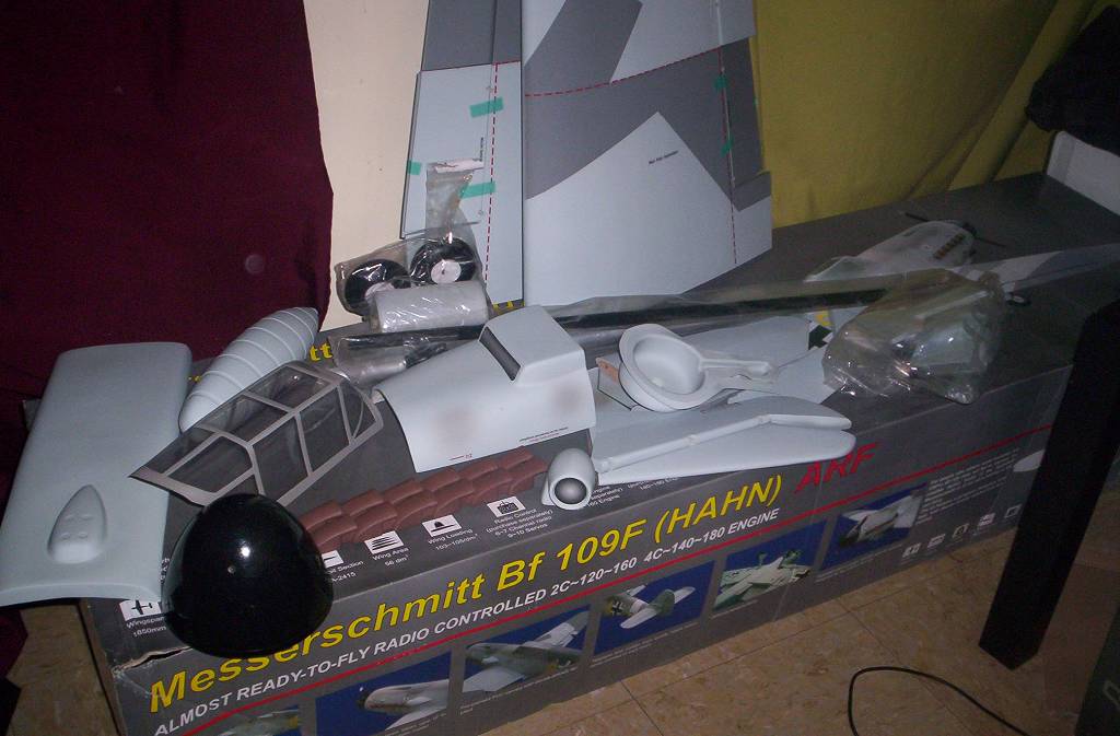

soon to be converted to a G series. anyways, I'm VERY impressed. it arrived nicely packed, and NO damage
what-so-ever. the Canopy was not foggy like I've been reading, & not damage. the fuse is very nice. the wings
are perfect ( covering wise). The fuse is AWESOME, no cracks or damage. same can be said of the rest of the
acessories. that drop tank, me likey! looks pretty darn close to the actual one used on the later G models. seems
that tis particular "F" has alot of "G" styling cues to it. all the hardware looks to be robust & good quality as far as I
can see. I like the fact the include the strut covers.
while looking at the spinner right away I seen the problem of the backplate fracturing. it need to be drilled out
and tapped 4/40 and needs screws to go all the way to the back of the spinner backplate.
I'll post more as I progress.. not so much of the build, becouse frankly the other thread covers it in spades.
but the bash to come.. thanks for reading.
PS, the crosses SUCK. those are gonna go. much nicer to apply them with paint anyways.

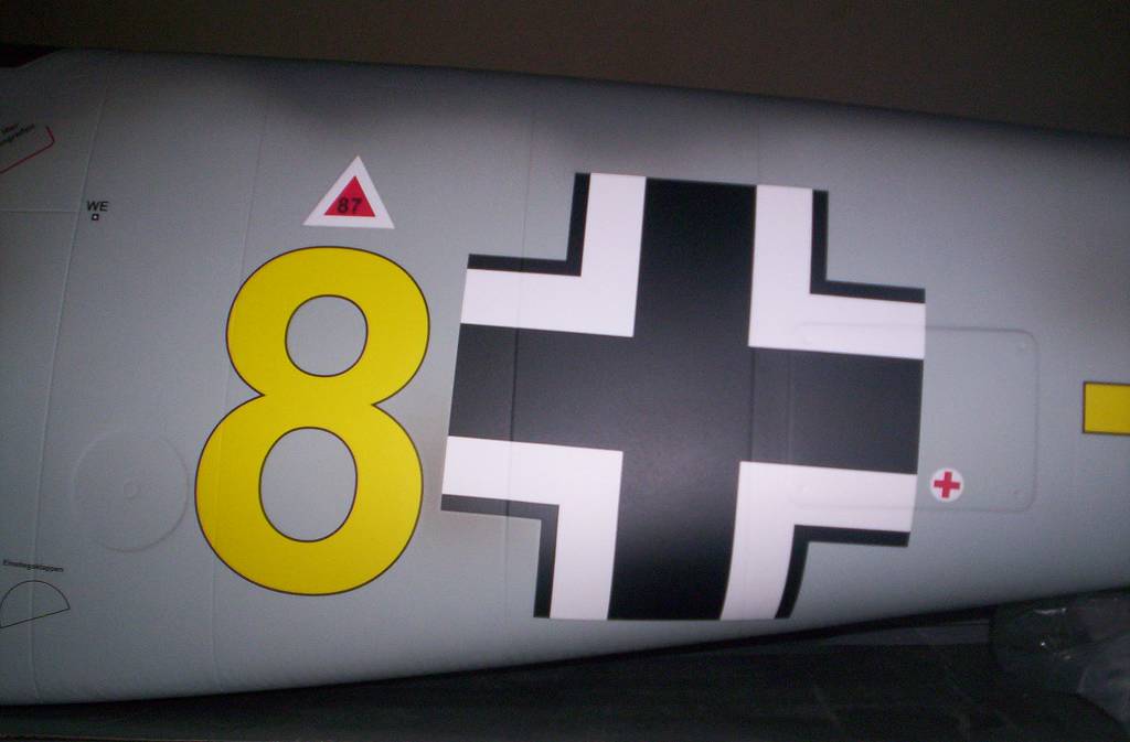

heres a pic of some of the pitfalls of an ARF. those in the know will see the ginormous error here.
so I'll just remove the cross and paint it correctly. as a matter of fact, I'll replace all the decals. it'll
only cost me some ink, & wet transfer paper. very easy fixes.
Pic 1. shows the cross misaligned & the wrong design
Pic 2. some I made up for my P-40. easy as pie to do for
the 109 as well.

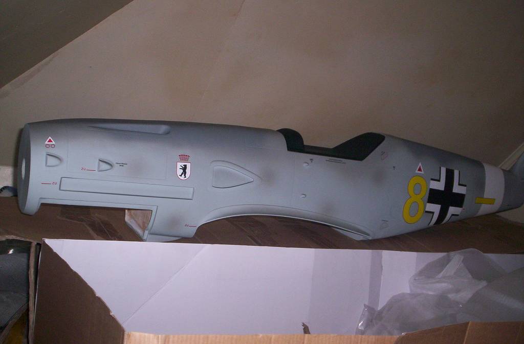

you betcha (this will be the non-trop version)after I fill in the divets inside the fuse.also will be adding the two fresh air intakes just foward of the windshield.
this will be the non presurized G.
heres a couple pics of the engine moved back. after modding the oil cooler duct ( later, to G-10 specs), everything will be
hidden. hate to have any part of the DLE20 sticking out. the back part of the oil cooler duct will open just like the 1:1
109.. so cooling won't be a problem. generator scoops will be functional too. actually, all the cowl ducting.
