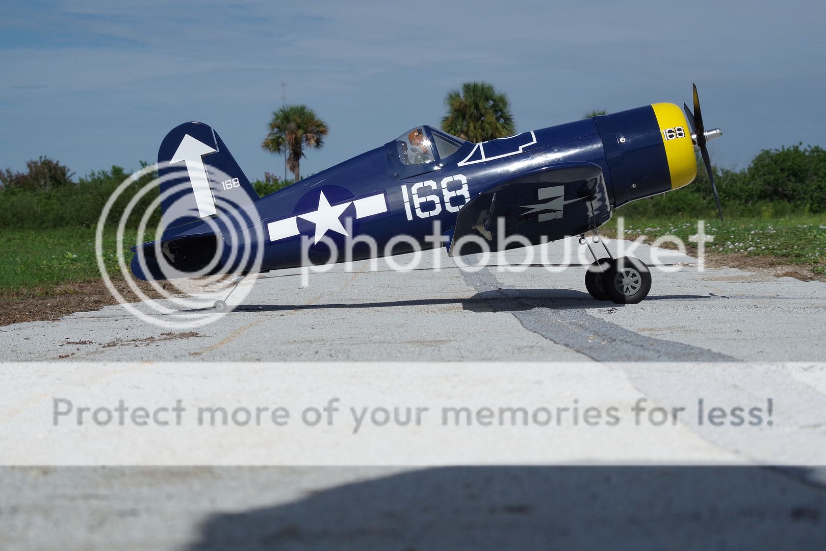

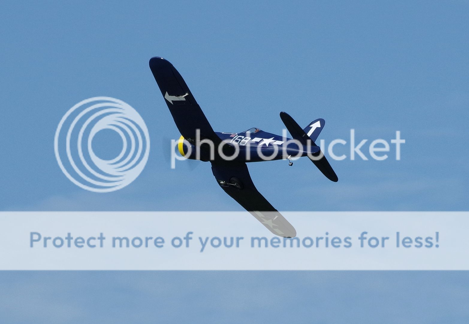

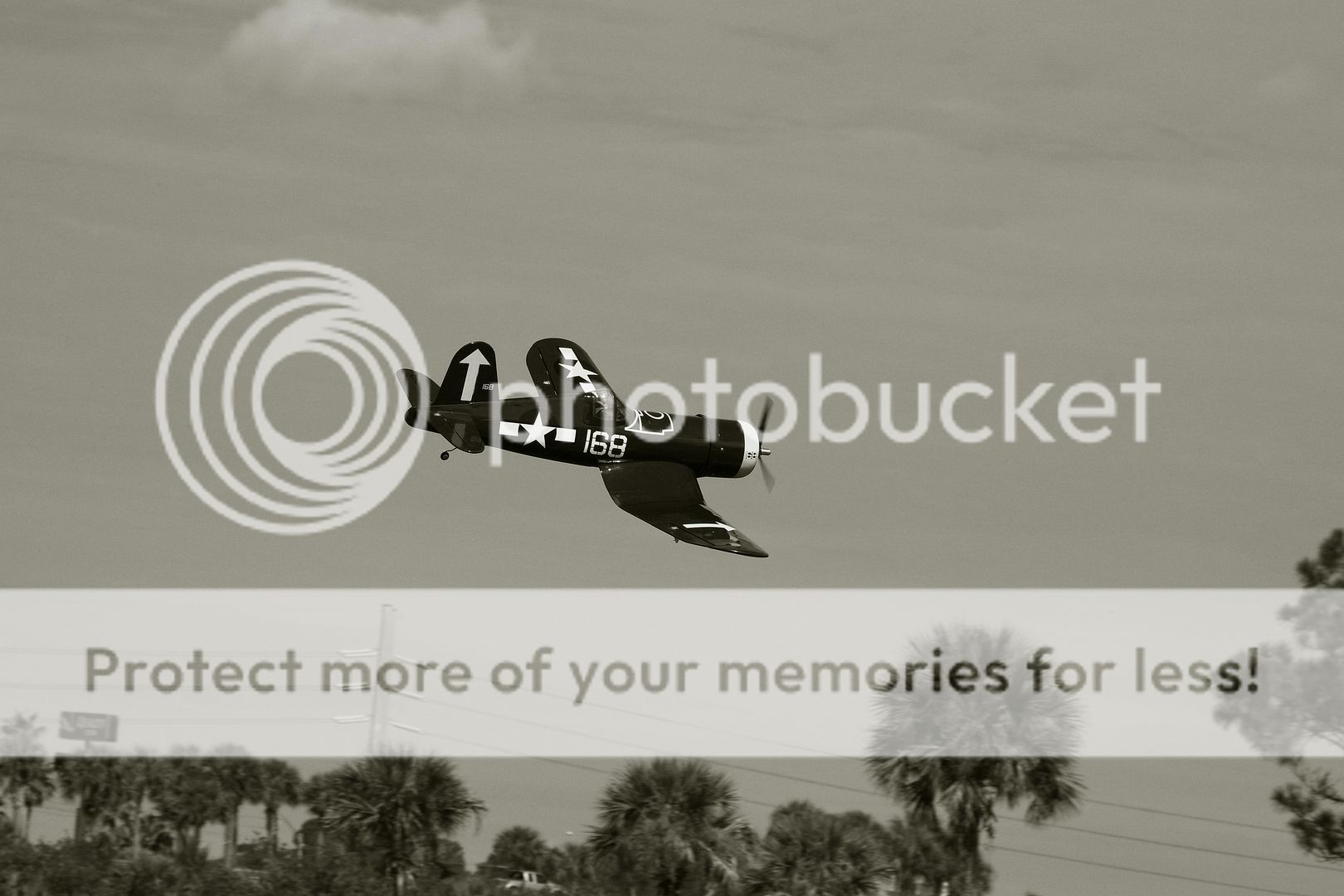

We finally had some of the best weather conditions here in Central Florida and it was almost DEAD Calm and I wasted no time and came with my Beloved Hangar9 F4U-1A 50-size Electric.
This model is just an amazing flying model. Everyone just stood and watched and yes, I was the only one at the Pilot's station.
Flew it for two wonderful flights and flew it like I stole it!
The landings were picture perfect!

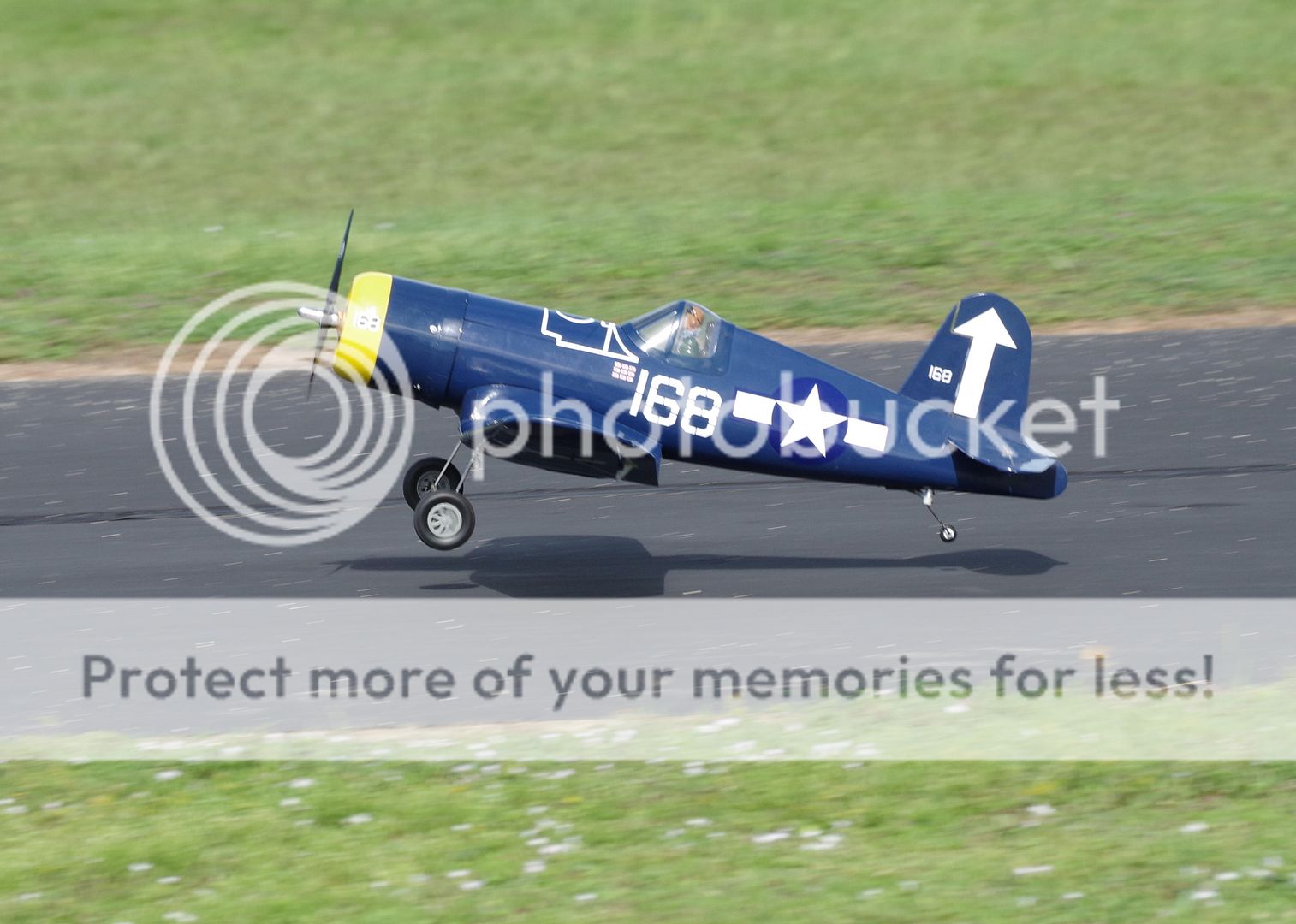

Been a long time and took my beloved Hangar9 F4U-1A 50-size Electric to the RC Club field early this morning and had two wonderful flights with it and it flew like a speed demon with the Turnigy 5-Cell, 4,000mAH, 35C, Lithium Polymer Batteries (Had two packs total).
Dead Calm so the model over shot the Textile Runway and onto the freshly cut grass and it did so very majestically. I didn't want to take any chances as this is a heavy model compared to my other Park Flyers so, I wanted good amount of AIR SPEED on approach and it didn't disappoint. Touch down was performed by setting down the model on its mains and giving it a touch of down Elevator to avoid the bounce and it stayed on its mains like the full size and everyone there applauded!
One picture of it after first flight of the day.

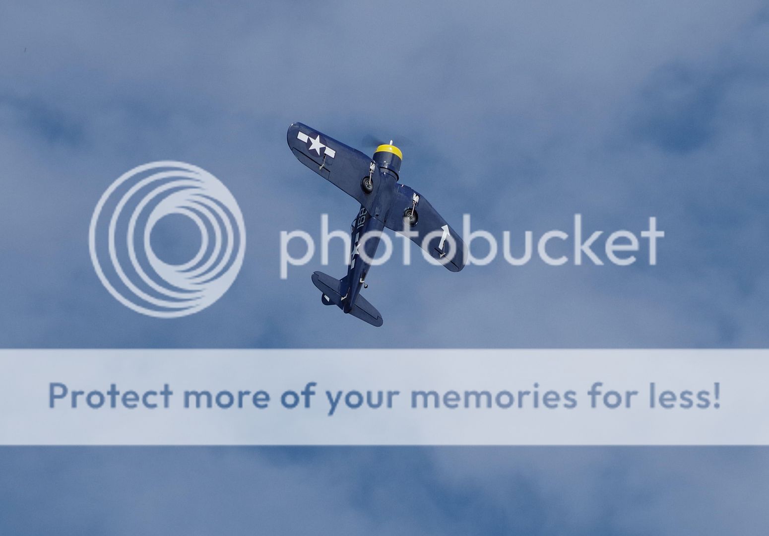

Took out my beloved Hangar9 F4U-1D 50-size Electric Corsair and wow, it flew for two wonderful flights almost dead calm conditions!
My buddy Gerry was there and took some new High Resolution pictures with his Nikon DSLR camera and zoom lens.
