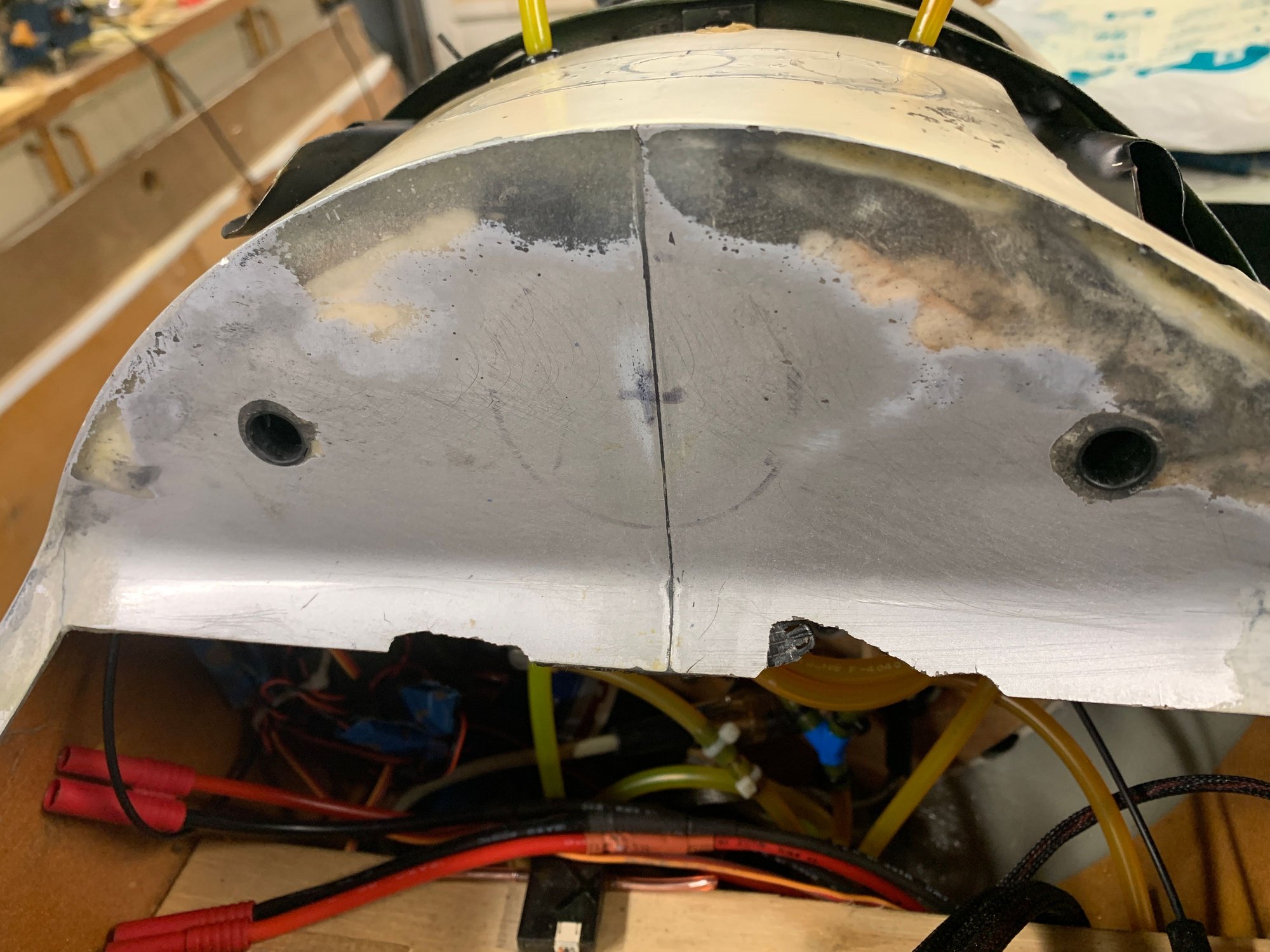

I have a Carf Corsair that the leading edge wing dowels are starting to get worn. I got a replacement 3/8" solid carbon rod that I am going to drill out the old dowels and replace with new.
Wondering if any others have seen this wear pattern on the dowels and what you did to repair.
Also have you done any other modification to attaching the leading edge of the wing?
These are the two carbon dowels that are wearing out on the leading edge of the wing.
A close up view of the worn carbon dowel.
This is the receiving end on the fuselage for the two carbon dowels on the leading edge of the wing.
Old 10-13-2021, 08:53 AM
  #3789
BobH
Join Date: Mar 2003
Location: Springfield, VA,
Posts: 8,049
Received 21 Likes on 21 Posts
What I've done in the past is to use a rectangular section of Air Craft ply. Attach this to the wing section and cut a rectangular bit on the Fuse. Works pretty well and seemed to wear better than just the dowels.

I had to make a jig and drill out the old ones. Bought a 4 ft solid 3/8” carbon rod to make new pins. Will use the jig for fitting and gluing in the new ones. This was a real pita to do getting the old ones drilled out straight. Got it done and it fits like a glove now! Can't wait to get this bird back in the air!
