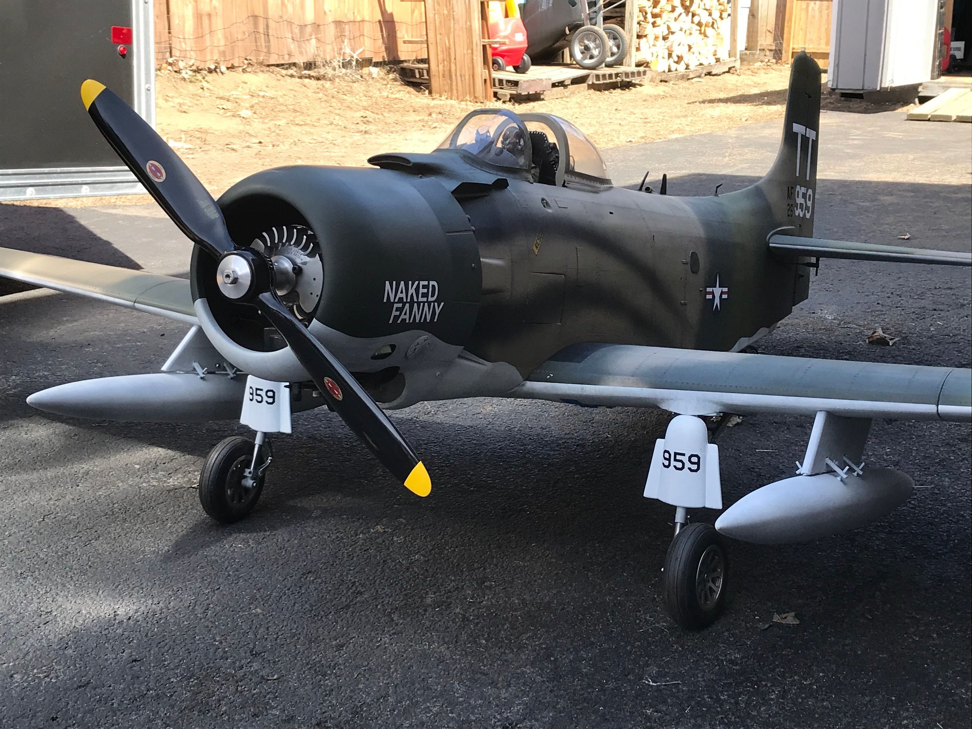

Old 01-29-2019, 08:19 AM
DOC
My Feedback: (57)
Join Date: Mar 2002
Location: Chino Valley, AZ
Posts: 156
Still No CG answer !
Old 03-04-2019, 01:47 PM
Fili
Fili's Avatar
Join Date: Oct 2002
Location: Queensbury, NY
Posts: 755
Received 23 Likes on 21 Posts
Here are a few pics from the plan. It looks like 5 1/4 to 5 5/8 with gear down. Mines almost done and I'll be balancing soon. I found some other info...
"I balanced mine with the gear down and set the cg about 3/4 of the way back in the cg range. first flight was effortless and it was a perfect spot for the cg.i didnt have to change it at all.
his designs are well proven and i would do as he recomends" from a thread on another site.

Just finished cycling the batts. Just got to install and balance. The fields are still wet up here, but hope to get to the maiden soon. I will have video and pics

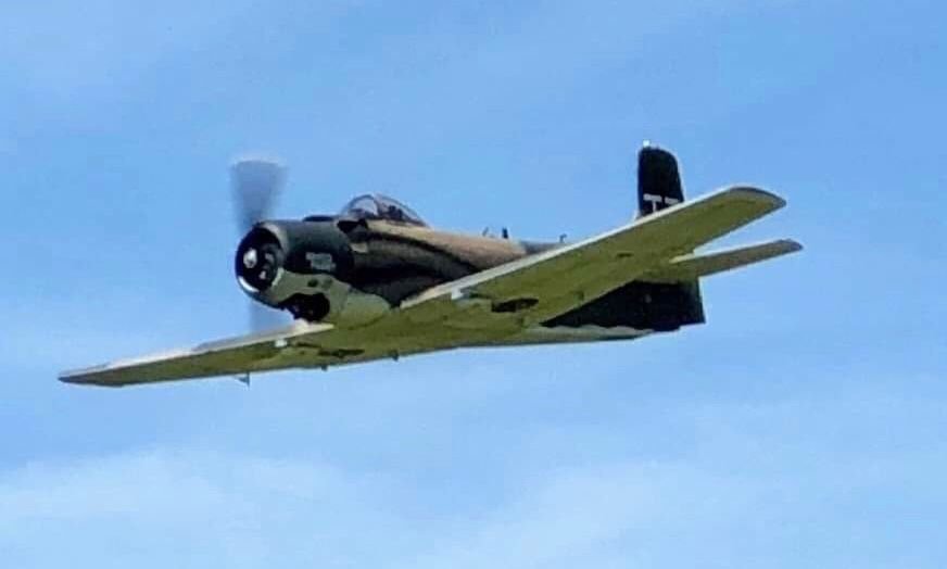

Old 06-10-2019, 03:53 AM
Fili
Fili's Avatar
Join Date: Oct 2002
Posts: 755
Second and third flights this weekend, very smooth flier!

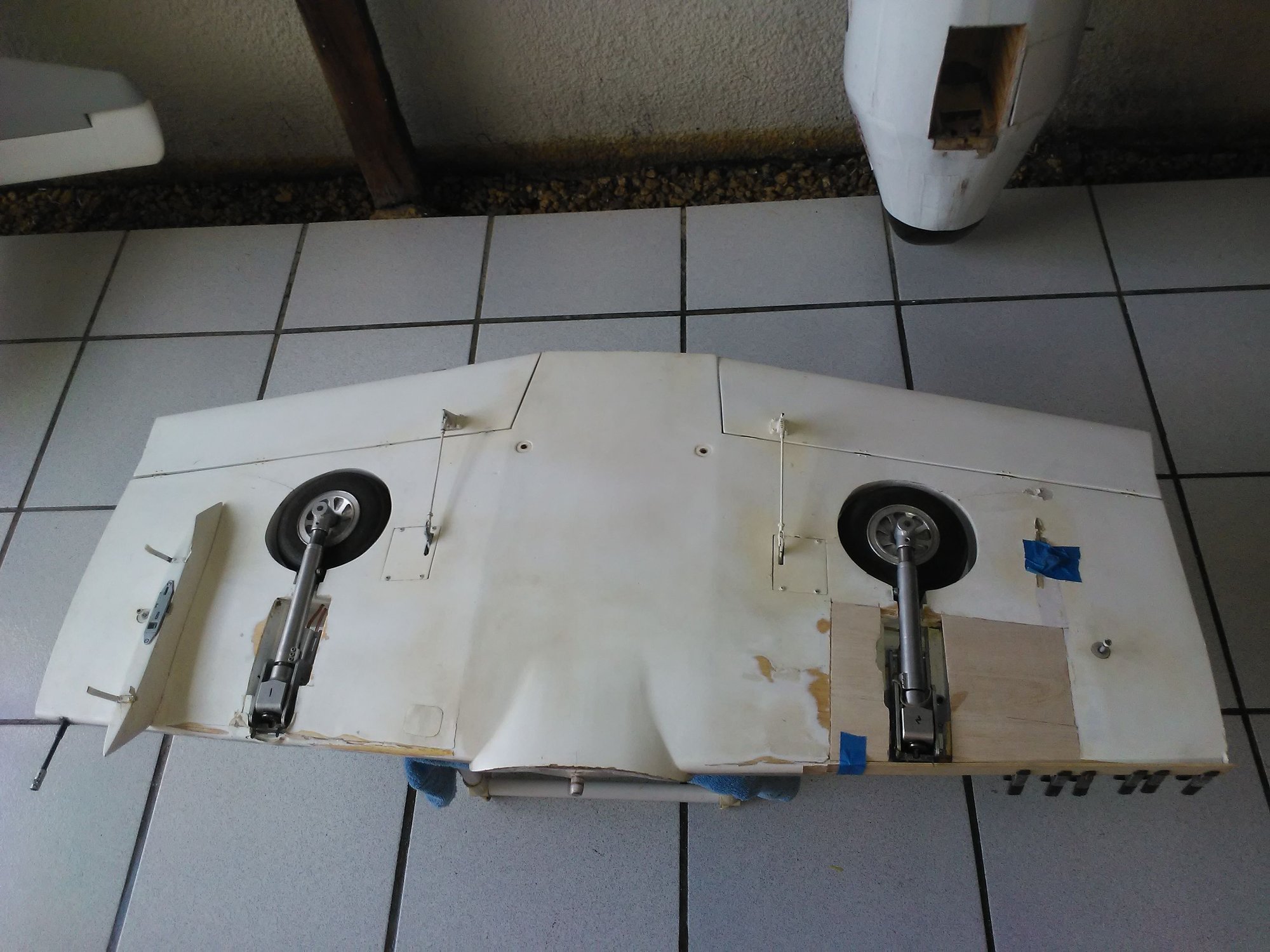

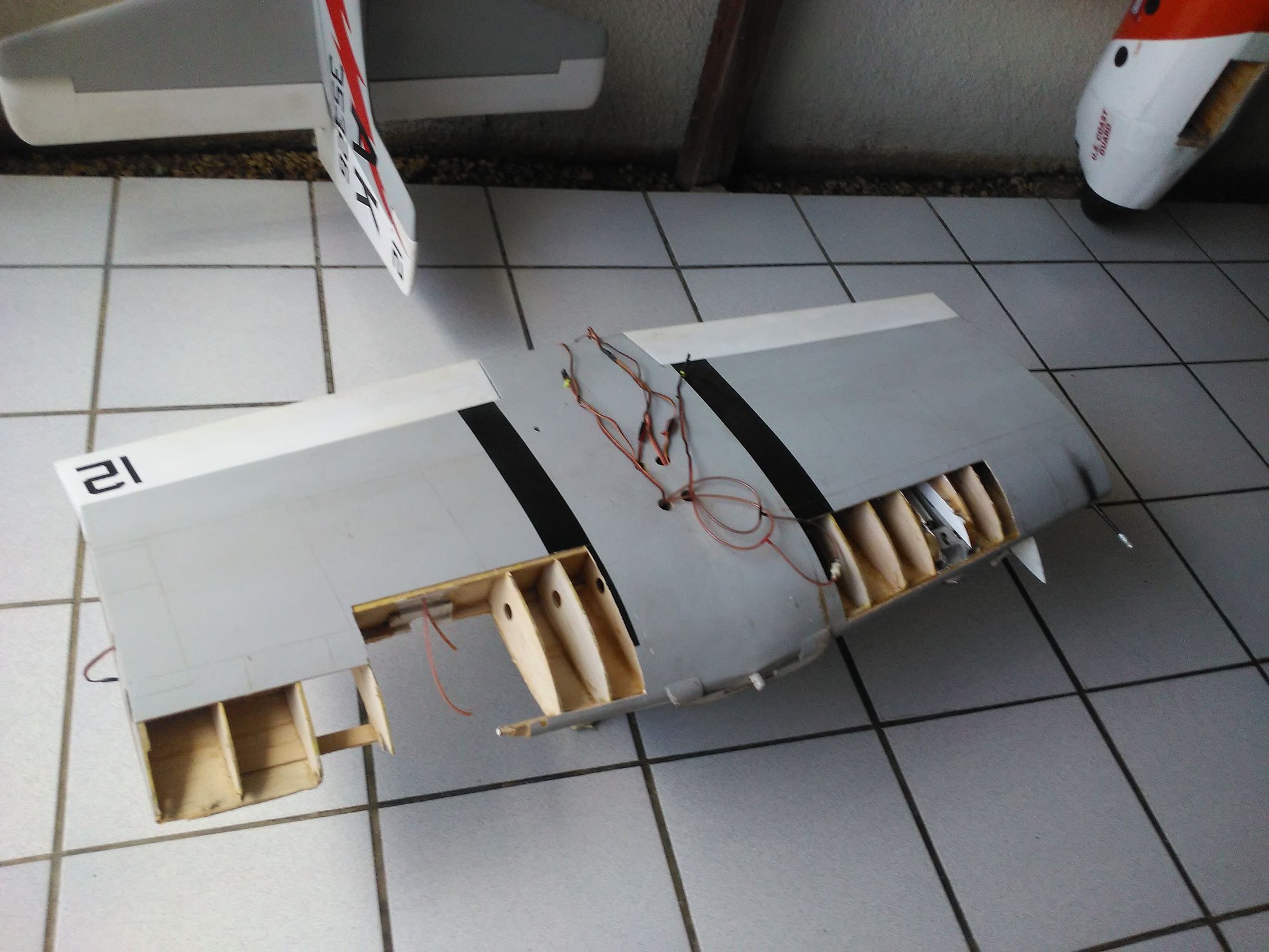

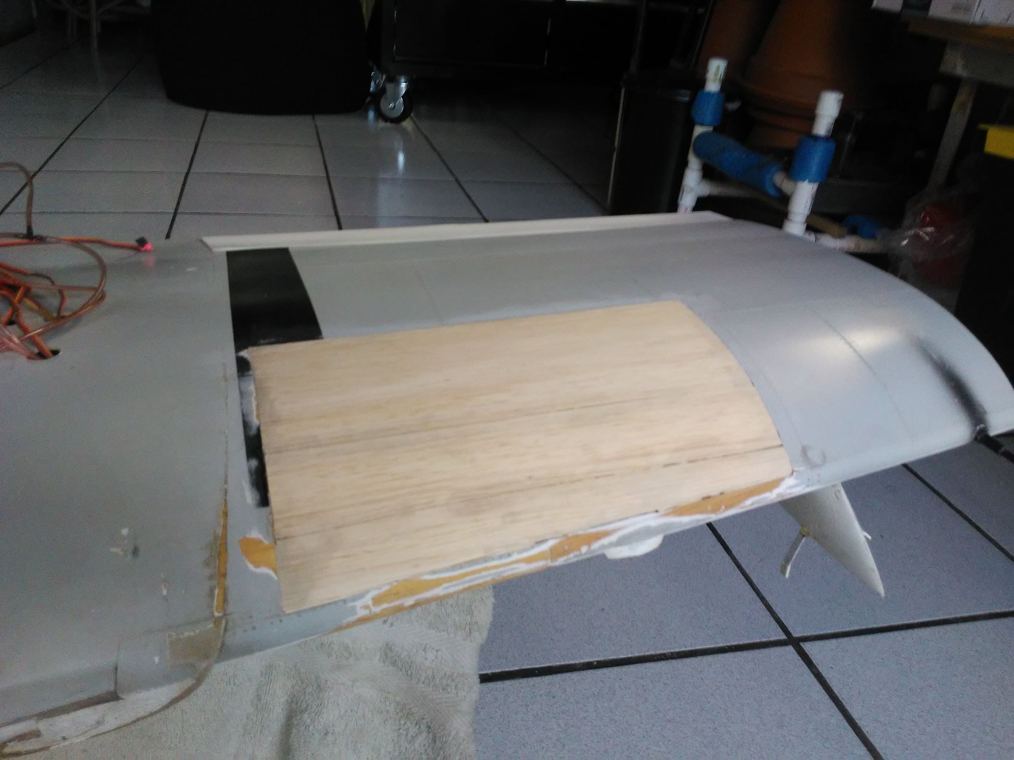

Had a mishap a while ago with my 100" Ziroli Skyraider.
Came a little too hot on the landing, had a small (really small18" the most in height) bounce and upon contacting the runway once ore with the mains, one of them gave way breaking the lead edge and ungluing the two main ribs in which the retract assembly was mounted.
I always thought that the design of the landing gear mount on this model was not strong enough. Having a full spar in which the partial ribs are glued to without the pass through thru the rest of the rib to the trail edge, is not solid enough. Also a 1/8" plywood rib to mount the retracts on a 30 - 35# model is calling for perfect landings or frequent repairs.
I decided to do some beefing up of the A1's center wing lead edge and ribs in the area around the retracts. I made the two retract ribs out of 5/16" aviation plywood and double them with the original 1/8" rib. Also doubled with 1/8" plywood the balsa ribs on each side of the retract ribs. Did the same on the other retract which had no damage in the bounce.
Also installed two hardwood stringers tying the four ribs together for added strength.
Added triangle stock to tie ribs to main spar and lead edge pinned with 1/8" wood dowels. Not much can be done to strengthen the lead edge due to retract location.
After cleaning the damage, this are the areas that needed reconstruction. The right sisde was opened to beef up the area so what happened on the left area does not happen again.
Old 03-18-2021, 05:40 AM
gonzalobures
gonzalobures's Avatar
Join Date: Oct 2013
Location: Toa Baja, Puerto Rico
Posts: 174
Received 28 Likes on 23 Posts
Repairs and beefing up what I consider a design which can be improved.
Both sides repaired. Also triangular stock was epoxied to main wing spar/rib joint pinned with hardwood dowels.
Left wing
Doubled 1/8" original retract mounting rib with 5/16" plywood and balsa rib with 1/8" plywood. This was done on both ribs on the other side of this same retract as well as on the right wing. Hard wood spars were also installed tying uo the 4 ribs since the lead edge is not a strong point due to retract penetration.
To improve lead edge strenthgt, a 1/4" plywood brace was epoxied tying the lead edge to both ribs.
Done on both sides of the ribs and both wings.

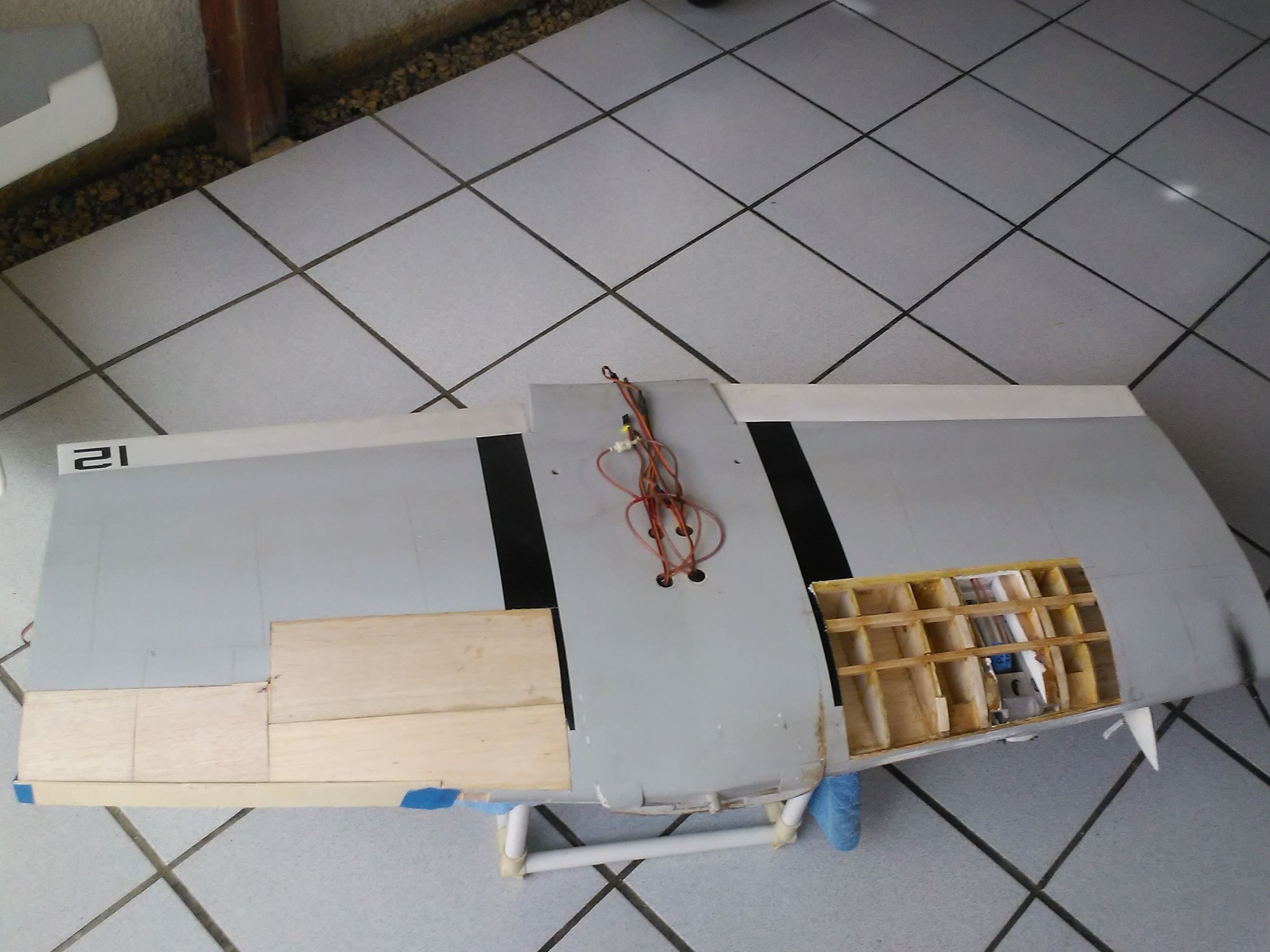

Old 03-18-2021, 05:45 AM
gonzalobures
Join Date: Oct 2013
Posts: 174

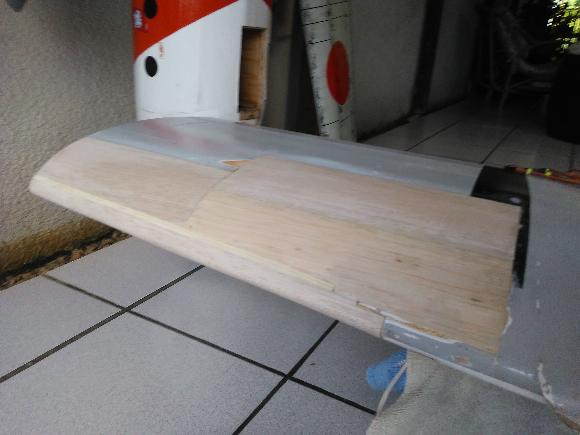

Planking and finishing the repair
Bottom side planked
Left side top planked
Right side planked. This side had received no damage in accident. It was opened to prevent future damages due to weak structure.

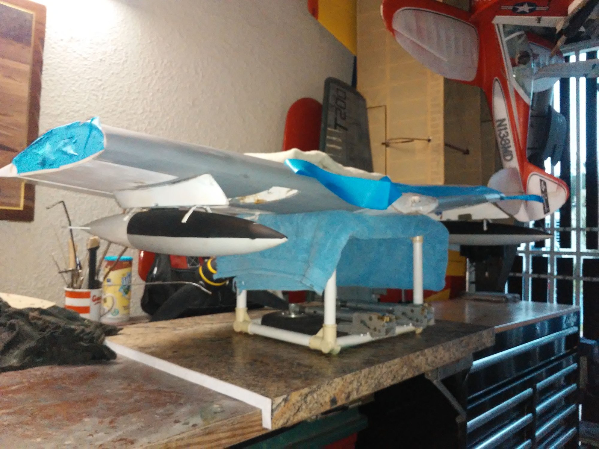

Old 03-18-2021, 05:49 AM
gonzalobures
Join Date: Oct 2013
Posts: 174
Glassing the structure repaiered
Old 03-18-2021, 05:51 AM
gonzalobures
Join Date: Oct 2013
Posts: 174
Priming and painting

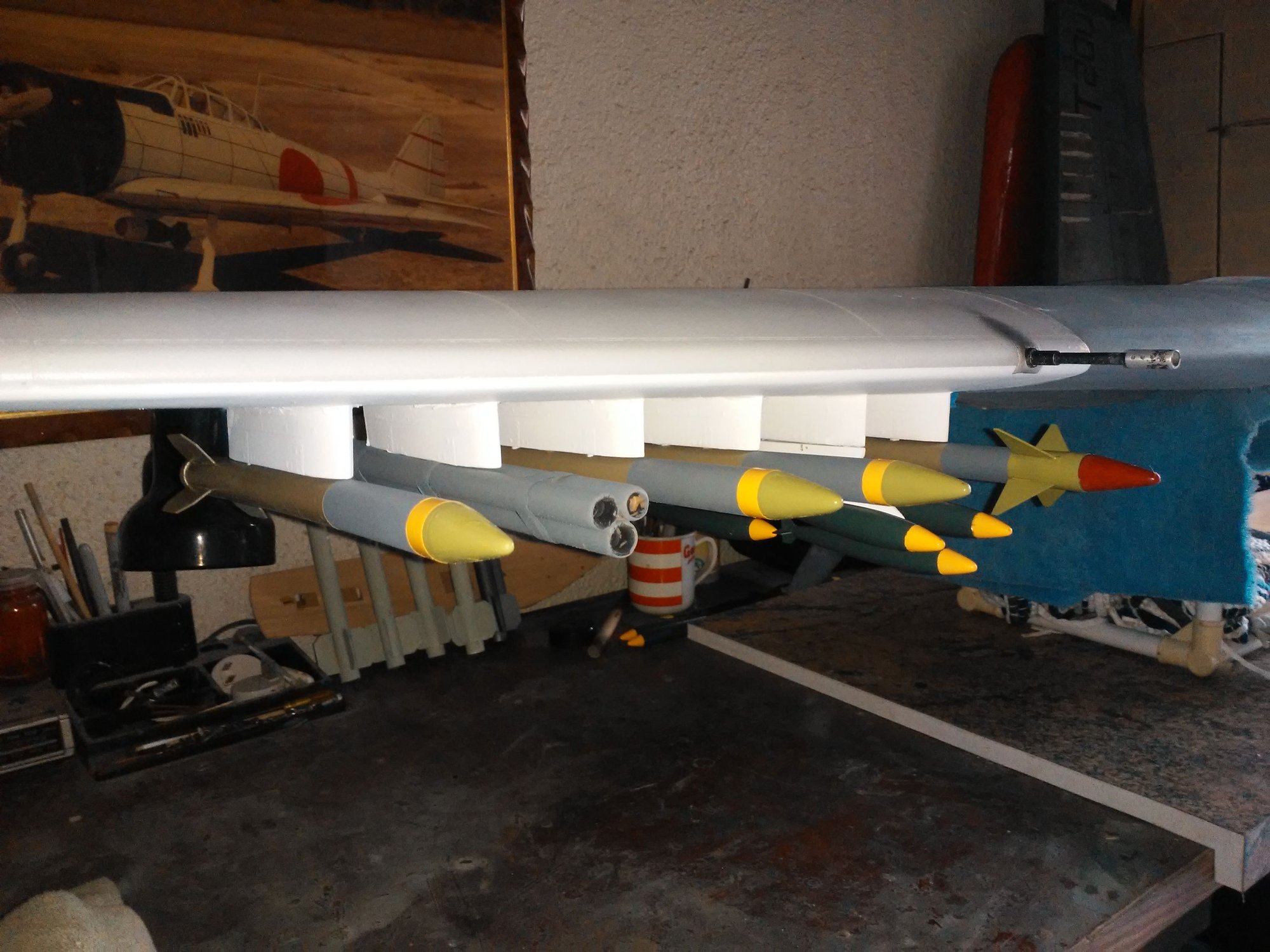

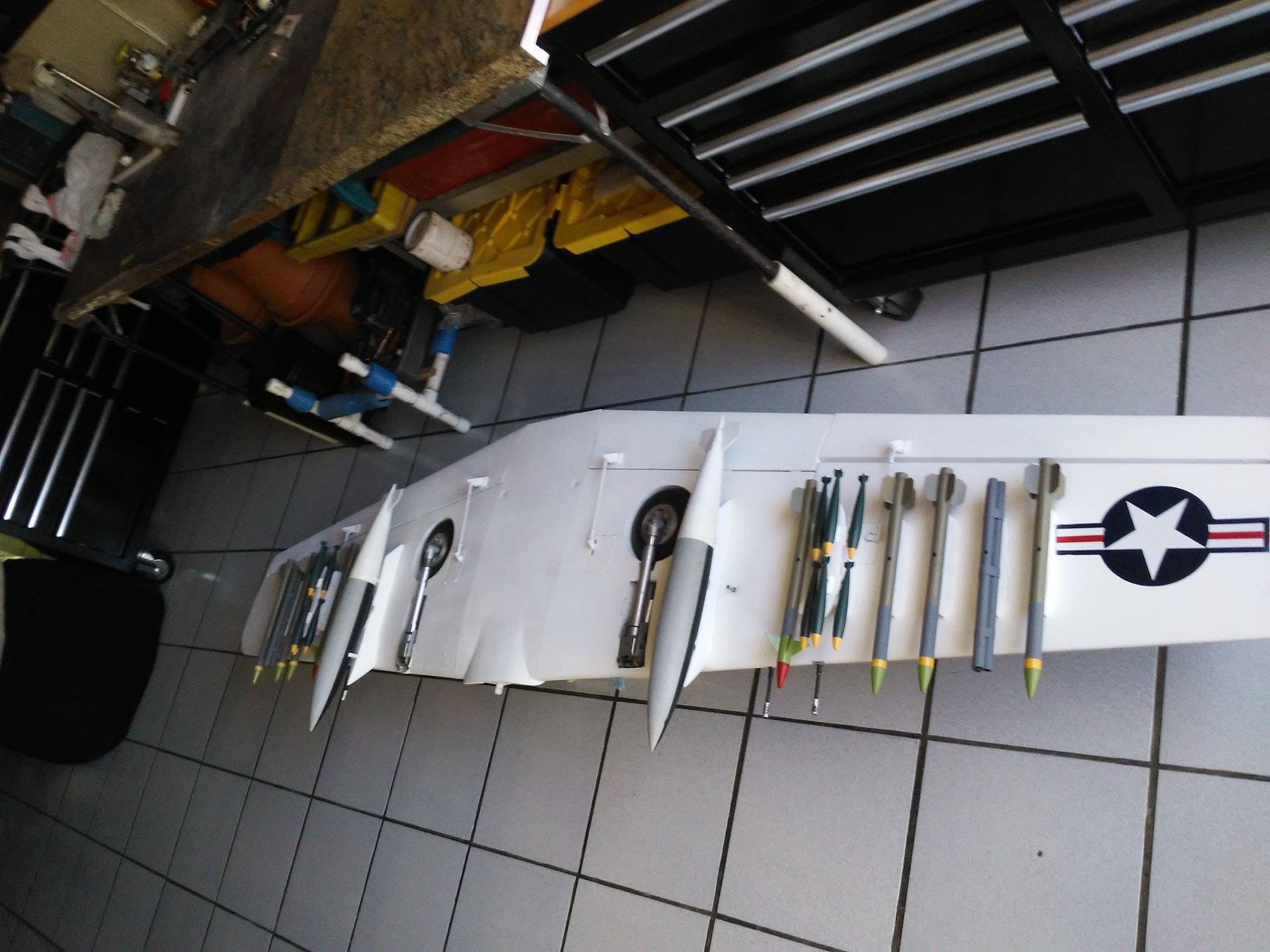

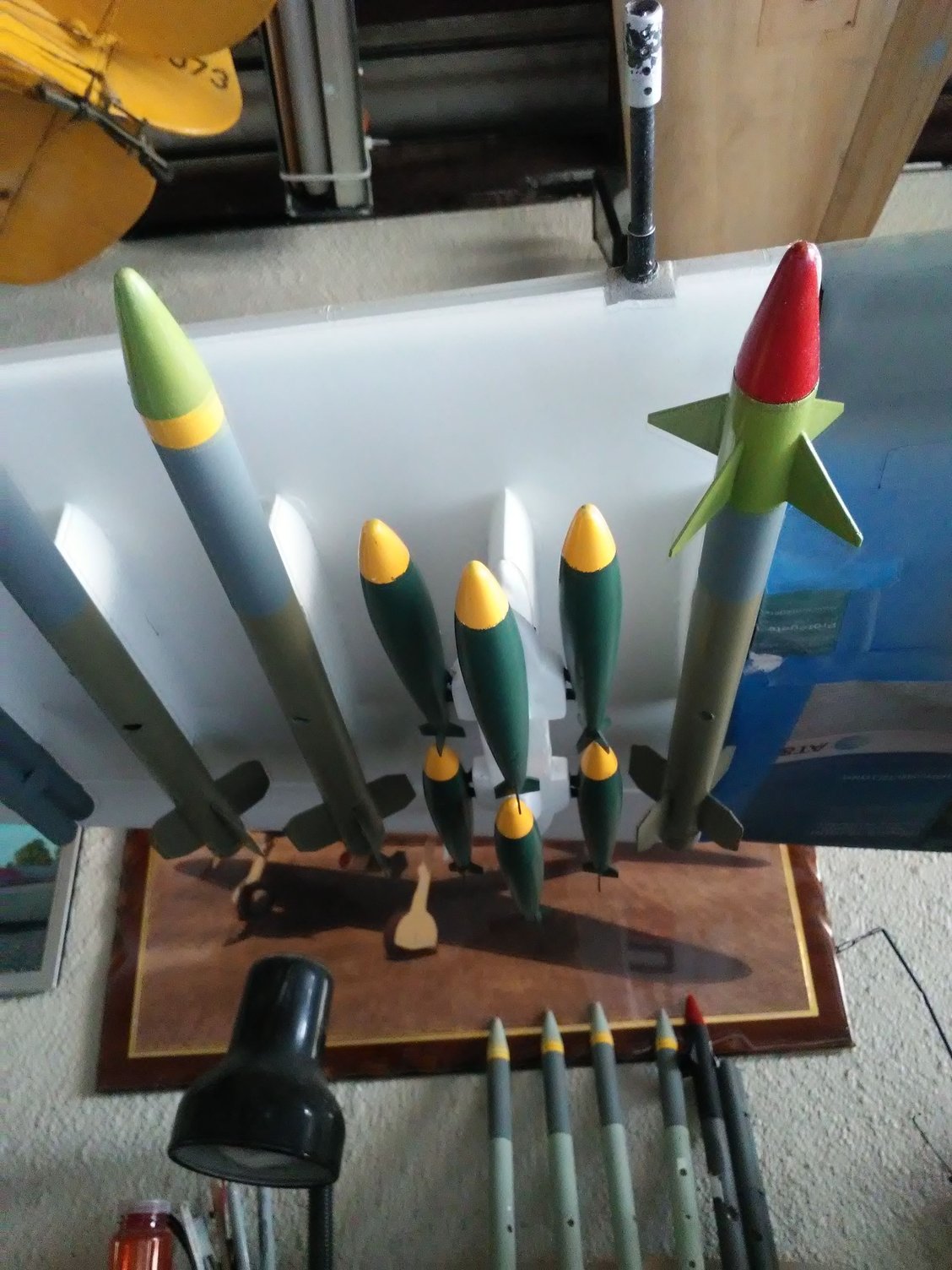

Old 03-18-2021, 05:59 AM
gonzalobures
Join Date: Oct 2013
Posts: 174

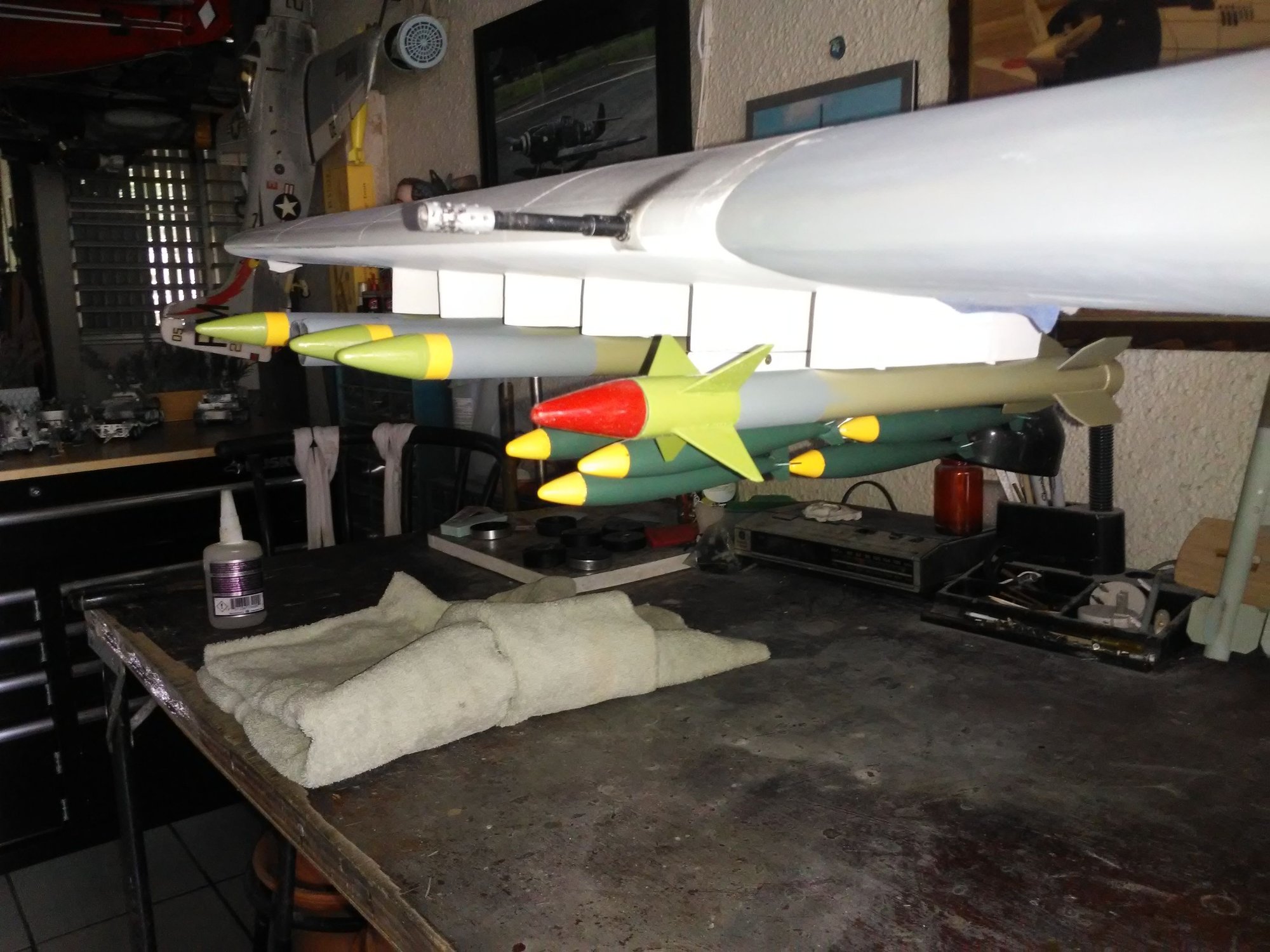

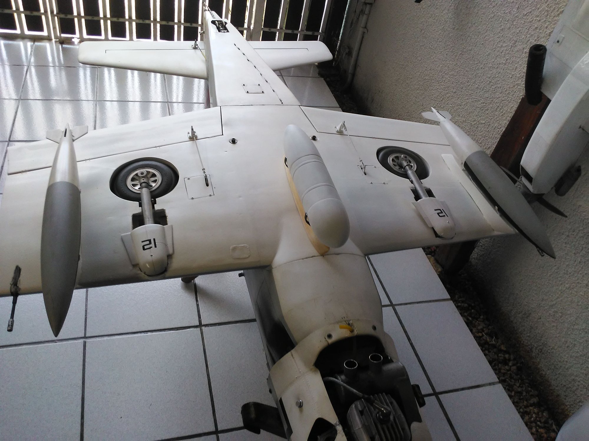

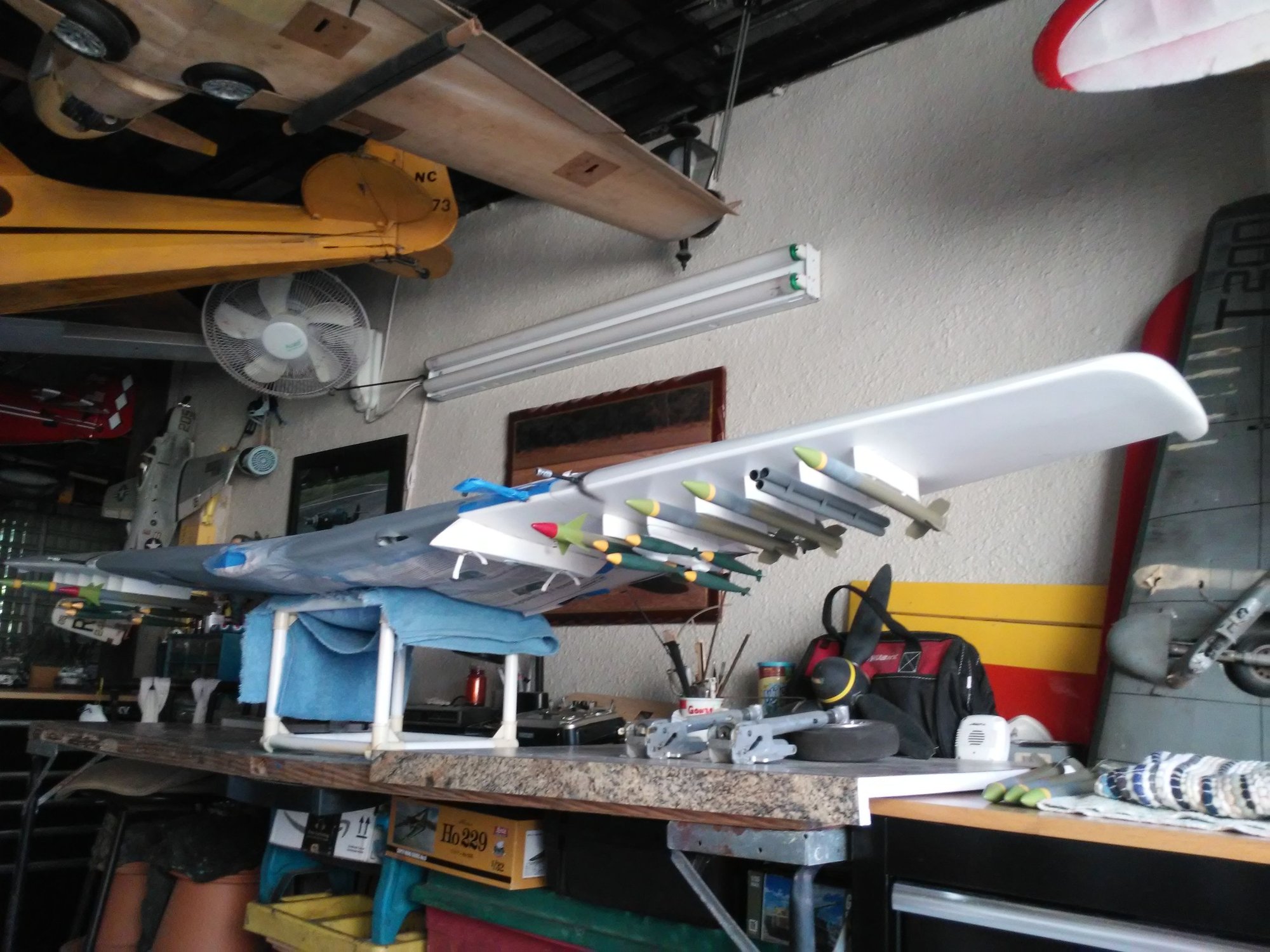

Static payload and releasable payload.
External Left wing payload
External right wing payload.
Releasable Napalm tank in left wing
Releasable Napalm tank in right wing

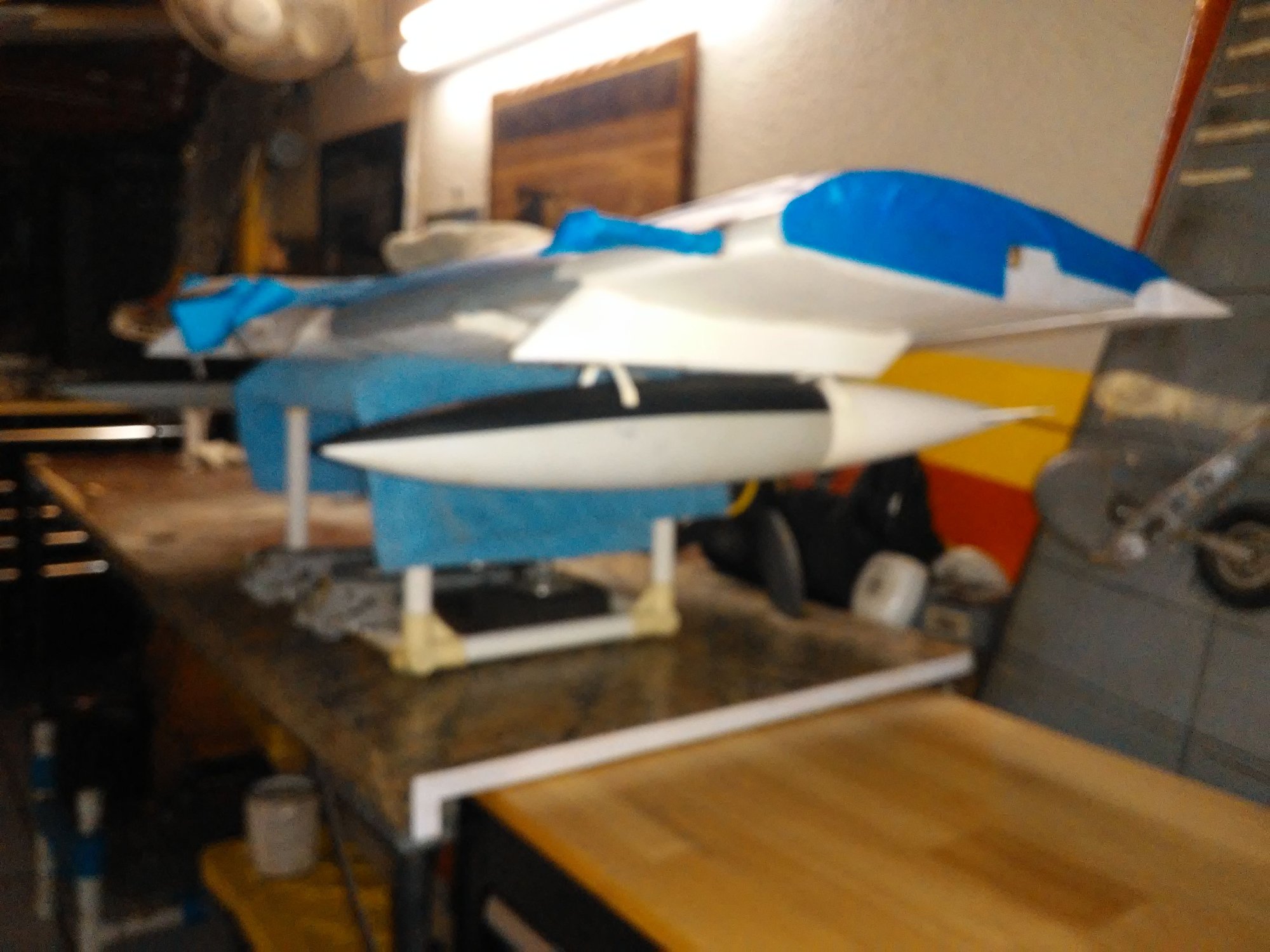

Old 03-18-2021, 06:08 AM
Fili
Fili's Avatar
Join Date: Oct 2002
Posts: 755
I did that two seasons ago... A relatively "easy" repair, just a big pain in the butt. Nice job!

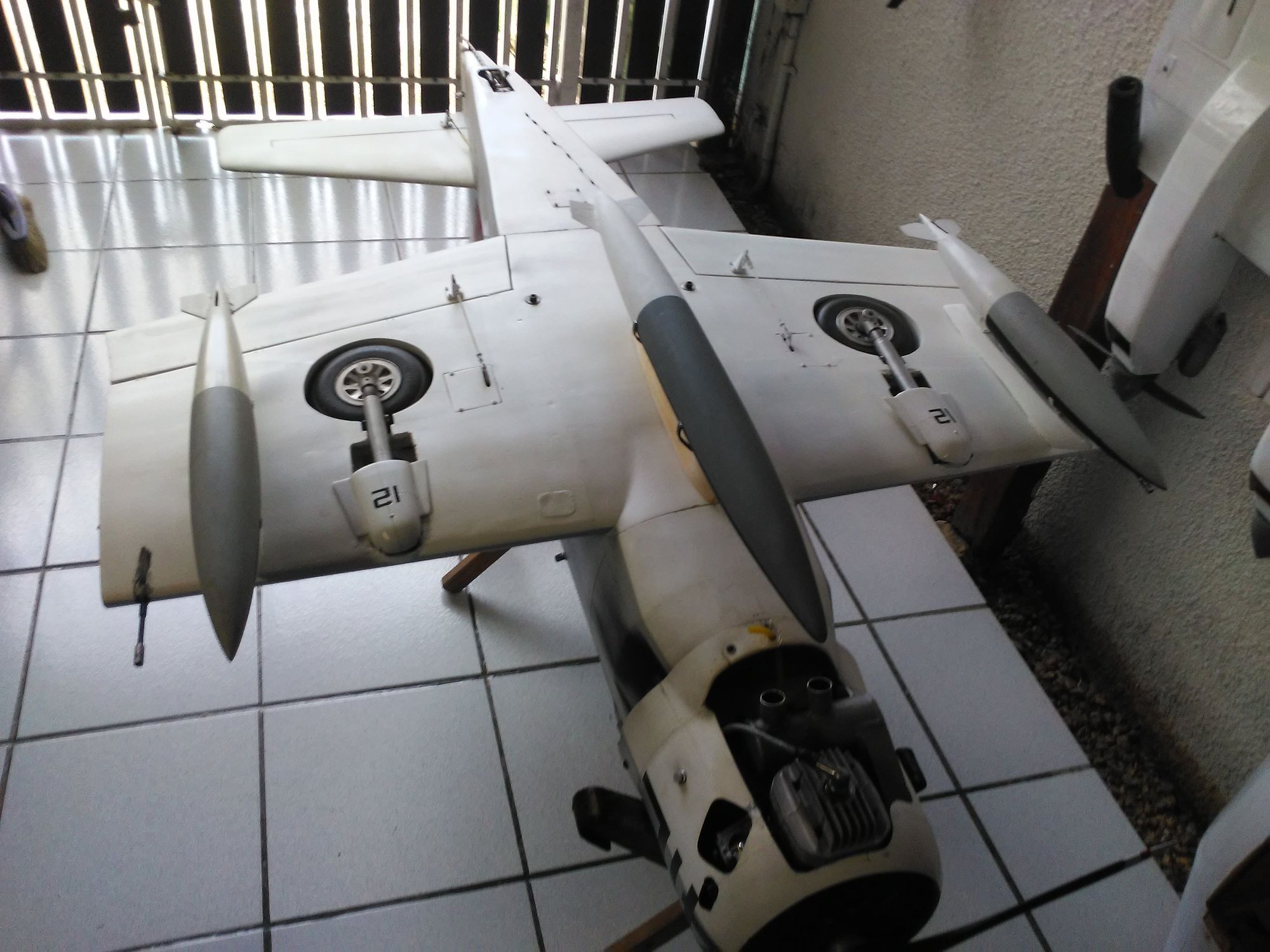

Adding center pylon with releasable mechanism. It will carry an additional napalm tank or an external fuel tank. Have not finished yet. Pending installing release mechanism and painting.
Center pylon with Releasable external fuel tank
Center pylon with Releasable external 3rd napalm tank
