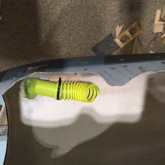

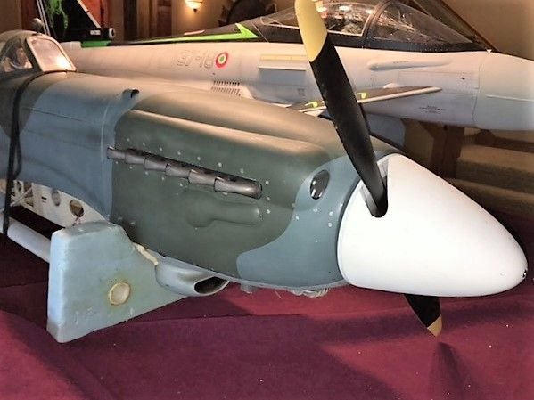

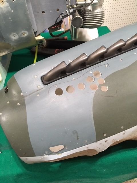

Have you had anymore problems withe over heating on the DLE 61?

Enough of the cylinder sticks down that overheating wasn't the issue, but I was having problems with the carb heat soaking due to stagnant air. I did some modifications. I added holes in front of the scale exhausts and routed air to the carb with a tube. I also opened up the scale exhaust openings to let even more air out. I also added some openings in the side with some reverse scoops to draw hot air out (non-scale). In the end it would run good even in hot weather.
When a carb gets hot you can tell because the engine starts to run rough a bit into the flight, and may even die.
Here's some photos of the mods I made.
