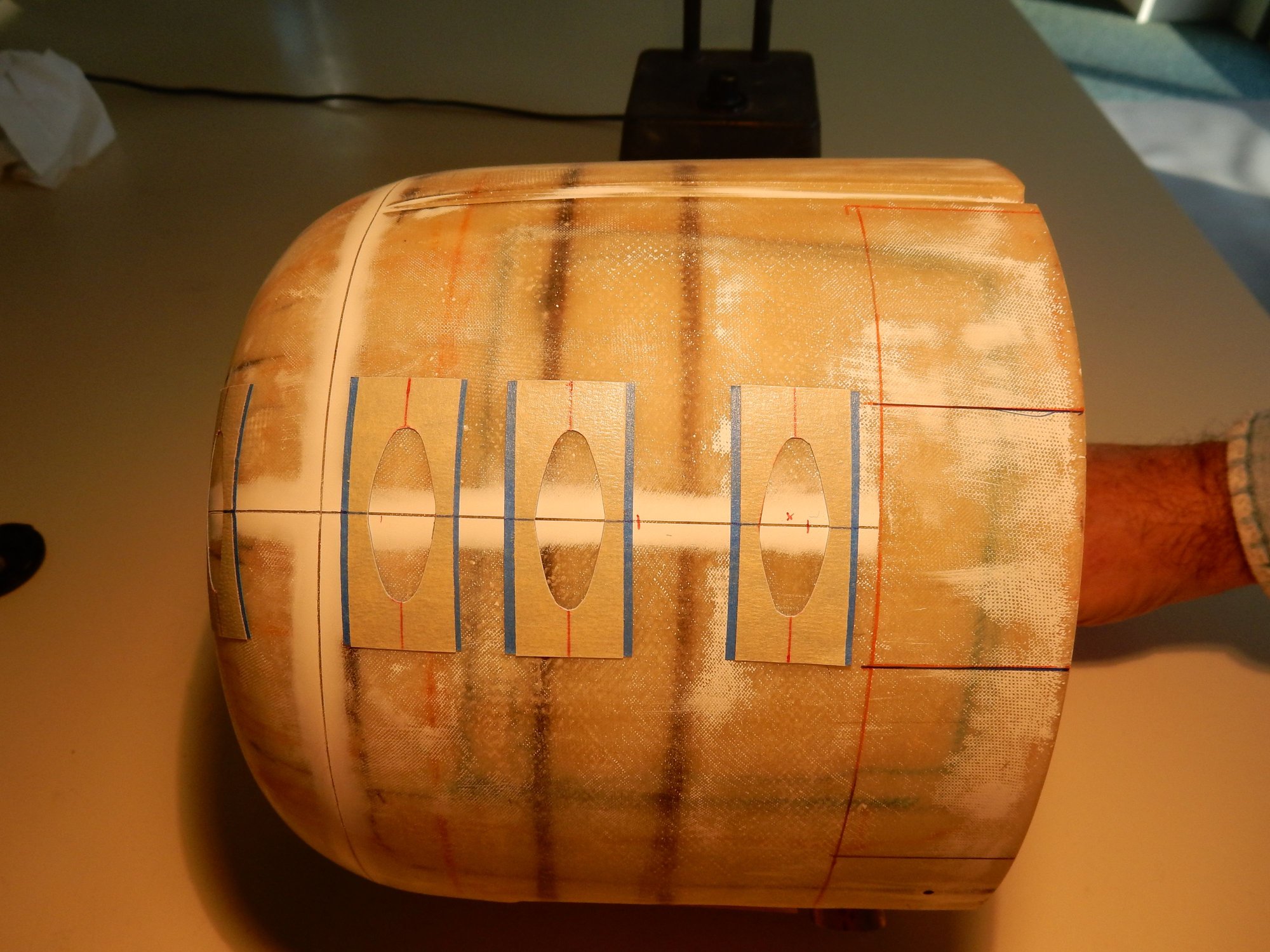

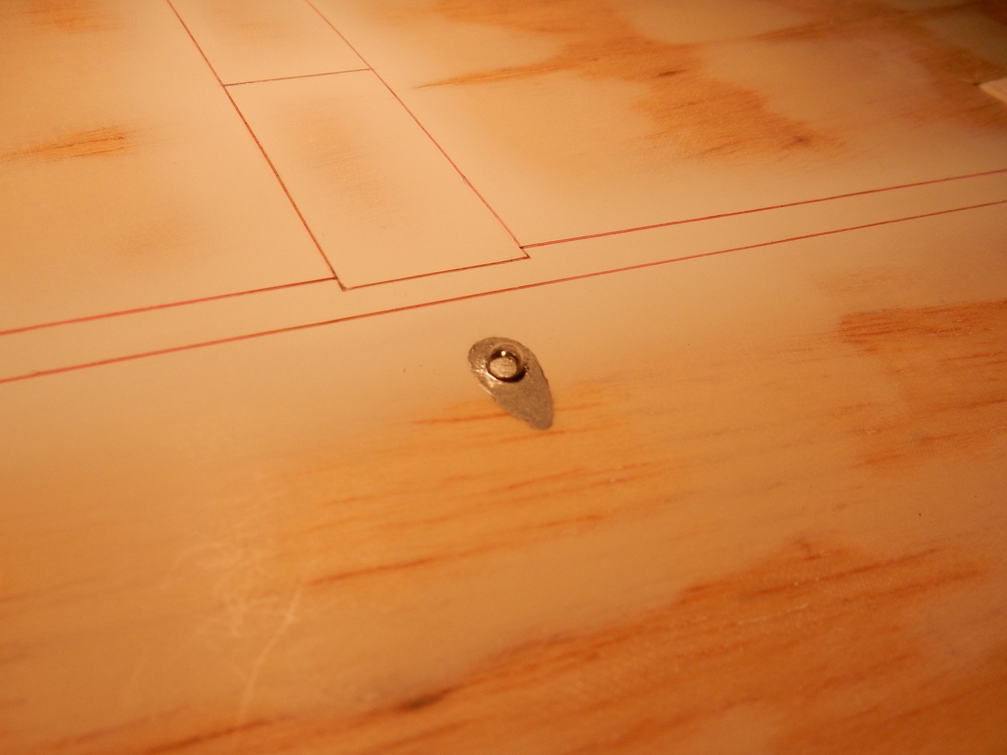

Cowling Latches: A layer of painters tape covered w/ masking tape w/ latch outlines pre-cut. Resin & Micro-Balloon mix trowelled in. When dry, sanded flush to tape. Perfect!

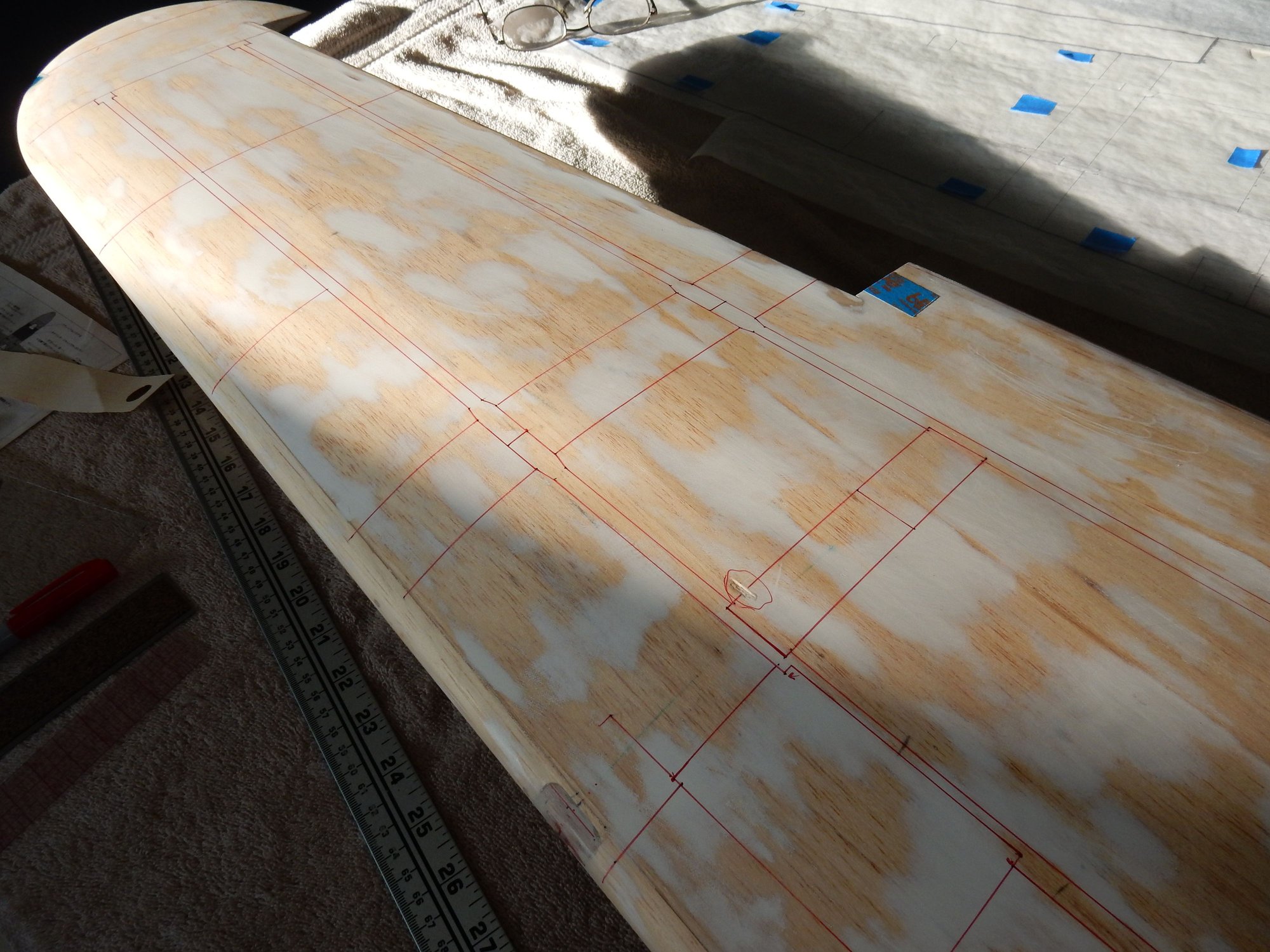

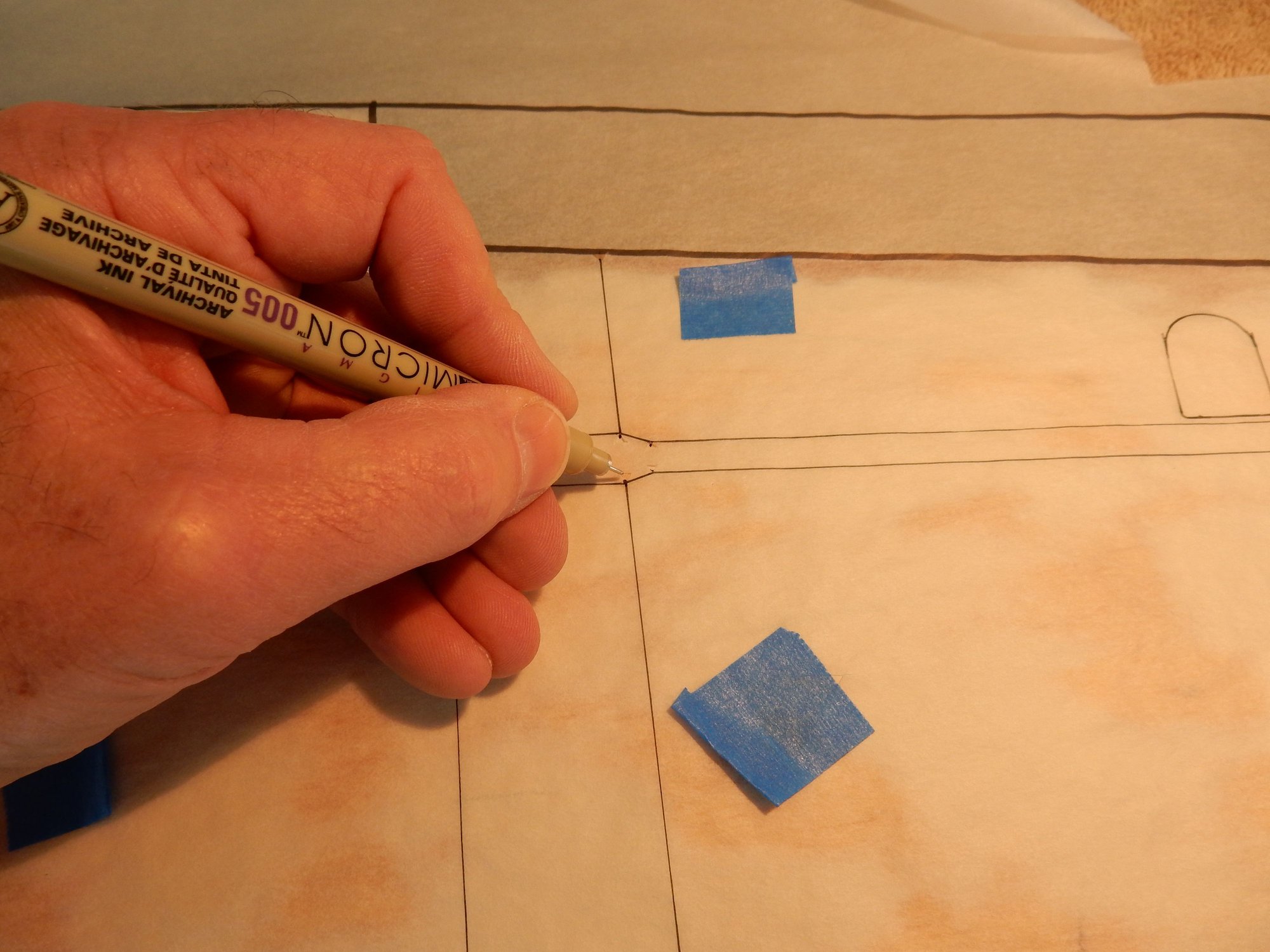

Tracing paper, panel lines already on it, laying in place on wing surface, ready to transfer. One tracing for wing top, another for wing bottom. Tracing flipped over for opp. wing.
Blue tape over triangle cut-outs keep tracing in register. Fine marker used to tranfer reference marks to junction points on wing surface beneath.
Red SHARPIE lines connect register point junctions. Ready to lay 1/64th panel tape directly over line work.

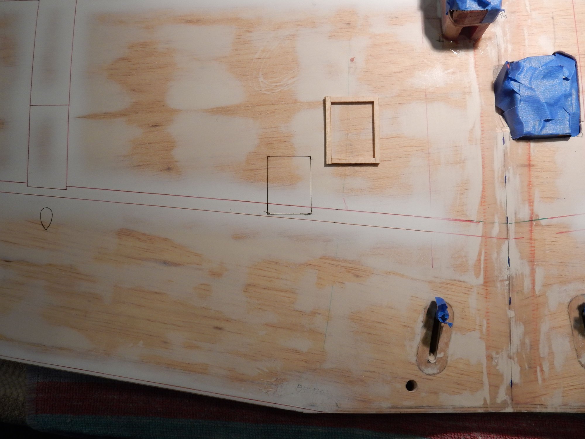

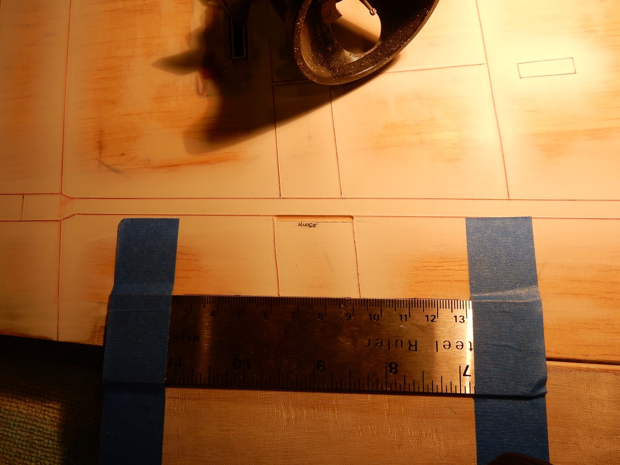

With"fence" ruler guide in place, ammo door piano hinge slot on underside of wing ready to router in a half-round channel to receive hinge.
Channel finished, ready for hinge.
Hinge cemented in place w/ half diameter proud of wing surface.
A 1/8" bamboo skewer, sanded down to 1.4mm dia. gets partial grooves cut into by rolling it under an X-Acto blade at 3mm intervals. Surface of dowel pre-treated w/ C/A.
Wing-step box laying next to its intended position on port wing.
Box frame in place w/ 2-sided tape along perimeter. Resin & Micro-Ballon slurry troweled inside.
Sandpaper about to be placed face down on wet mix and covered w/ glass plate to even it out.

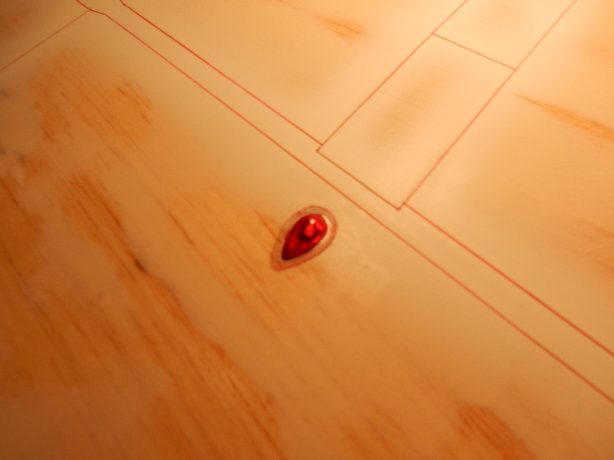

Clear plastic sheet getting heated under a heat gun until soft, ready to pull over form to make clear formation lights.
Plastic pulled over butt end of appropriately sized drill bit, ground to a teardrop shape to make bulb.
Inboard location of formation light, drilled and ready to cement bulb & dowel assembly into place.
Bulb cemented into place. Top of dowel painted silver before unit cemented into place. Surrounding area painted silver to mimic aluminum wing skin under blister.
Unit in place. Inside of clear blister airbrushed w/ transparent acrylic red, then coated w/ epoxy to make it appear clear instead of \"frosted".

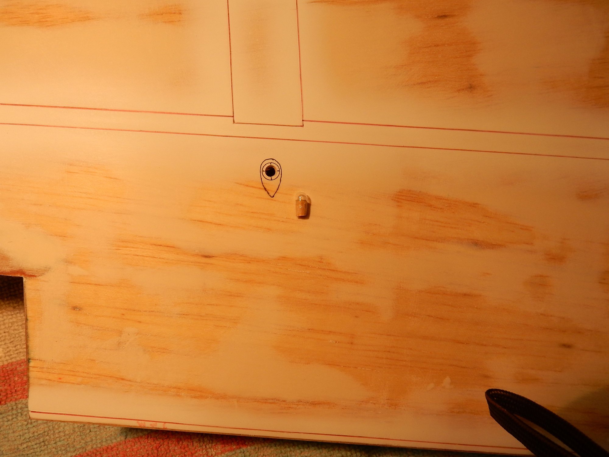

Here's the missing text to go with the latest photos: Sorry this is post-pic posting, but I hope the issue will be resolved by the next posting.
Photo 1: An actual sized card stock roundel was used for positioning reference. ( Note the hole in the middle to mark the wing w/ soft lead pencil as a positioning aid.
2: Locking compass w/ blade to cut a perfect circle in the center of a 9" X 9" square of Frisket paper.
3: With the center "peep hole" cut out and cut circle taped to the surrounding mask to re-join everything, everything gets pressed into place once the pencil dot on the wing is located. Though the paper backing was pulled away from the outside circle mask, the backing on the circle itself was left on to facilitate the circle's removal.
4: Ready to airbrush, now that the perimeter is burnished down, especially around the panel lines to prevent over or under spray.
5: Finished starboard wing bottom in the sun, showing panel lines, cannon breach blister, cannon shell ejection chute & hinges on ammo and cannon servicing doors.
6: Port top of wing w/ wing-walk pad, formation light blisters. ( Note lightening hole detail on inside rib of wingtip.)
7: Formation light blisters displaying transparency w/ clear bulb beneath.
