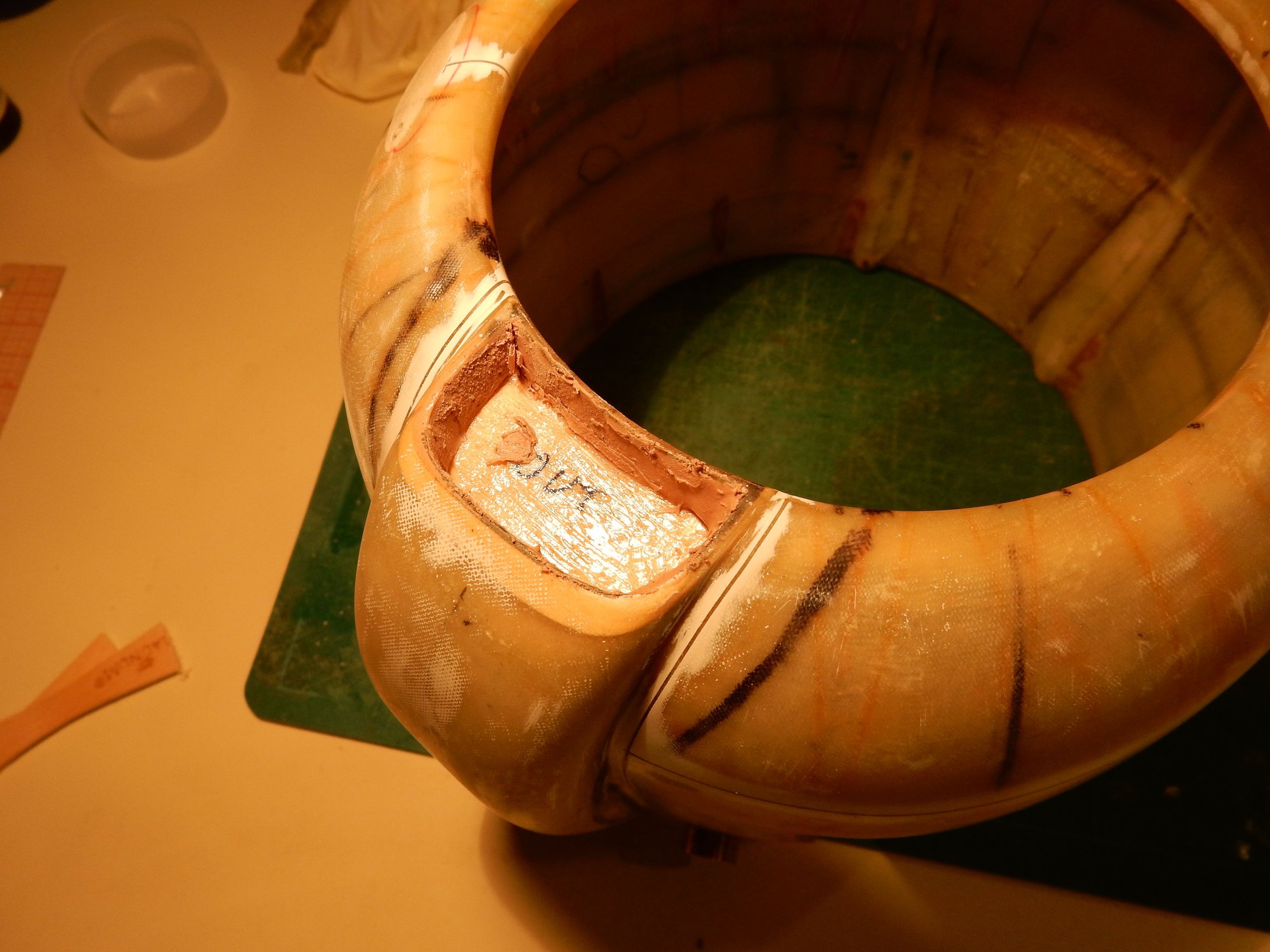

COWL FLAPS: Razor saw cutting & separating ( as opposed to painting on lines.)
Sanding edged to smooth things over.
64th ply strips cemented over separation cuts, then edges sanded and glassed over for strength to reinforce cowl flaps. ( Strips cemented in first so excess resin doesn't flow past fiberglass and fill spaces between cowl flaps.)

Project continued.... Carburetor screen installation ….
Five layers of .75 oz. glass & resin over strips, sanded smooth, job finished.
Cowl flap separation. Careful filing & sanding yields acceptable results.
File stock outline of carburator screen frame opening for inside carb lip area.
Outline transferred to 1/2" ply. Brass already in place at top w/ wood cut-out used to keep top piece clamped in place. Sides just soldered in place.
Remaining side pieces clamped down & soldered.
Finished frame w/ ply core still in place. Core was then removed and 1/2 MM sanded off perimeter to allow for double screen's width.
Screen's perimeter med. C/A'd in register and placed over form and edges bent over. Everything clamped in place to maintain shape. Form will later be used to push screen into frame in background & then glued in place after frame is cemented inside cowl chin.
Joe. (02-04-2020)

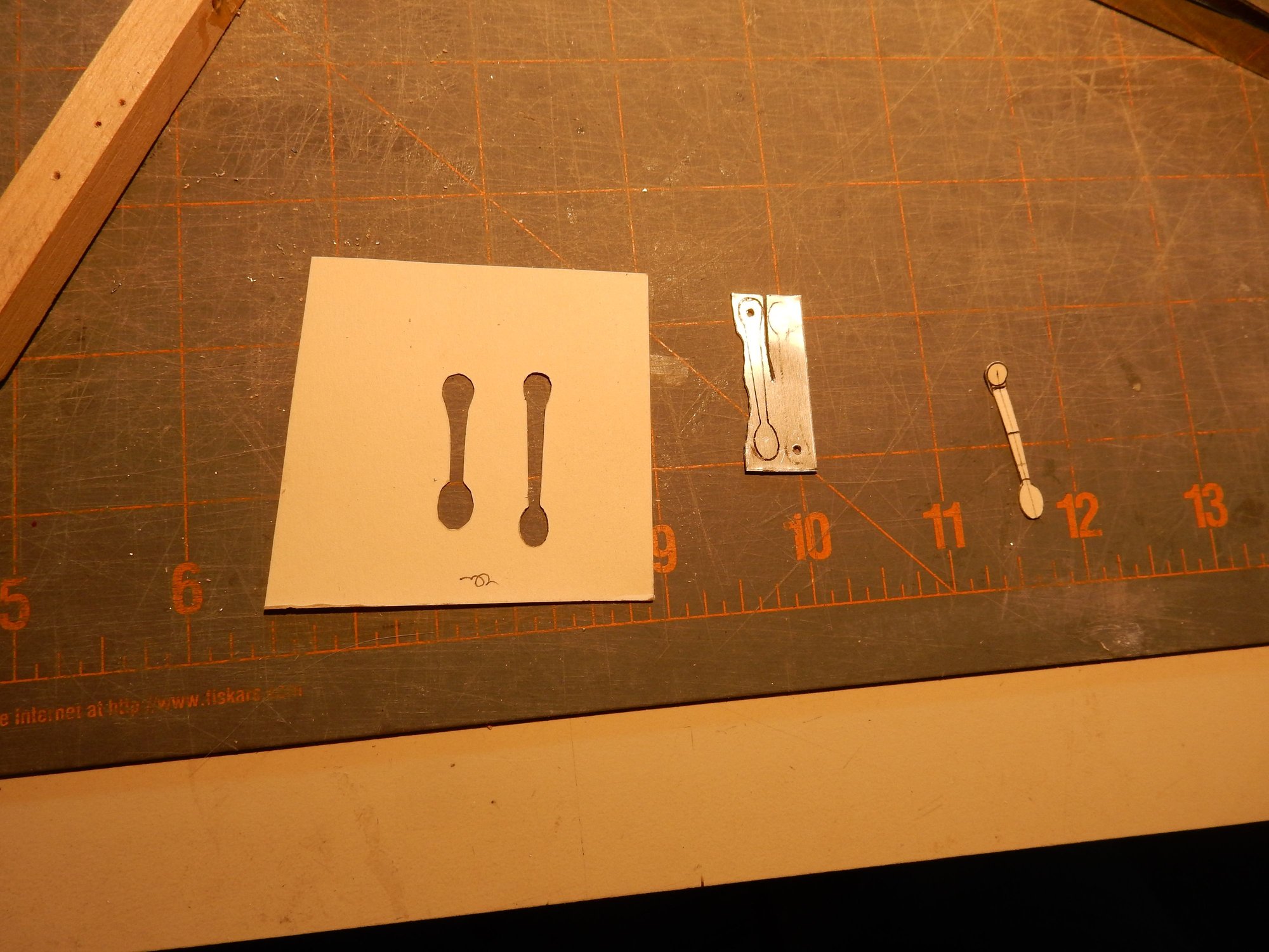

Side support rails molded from bondo in place, excess sanded away and canopy ready.

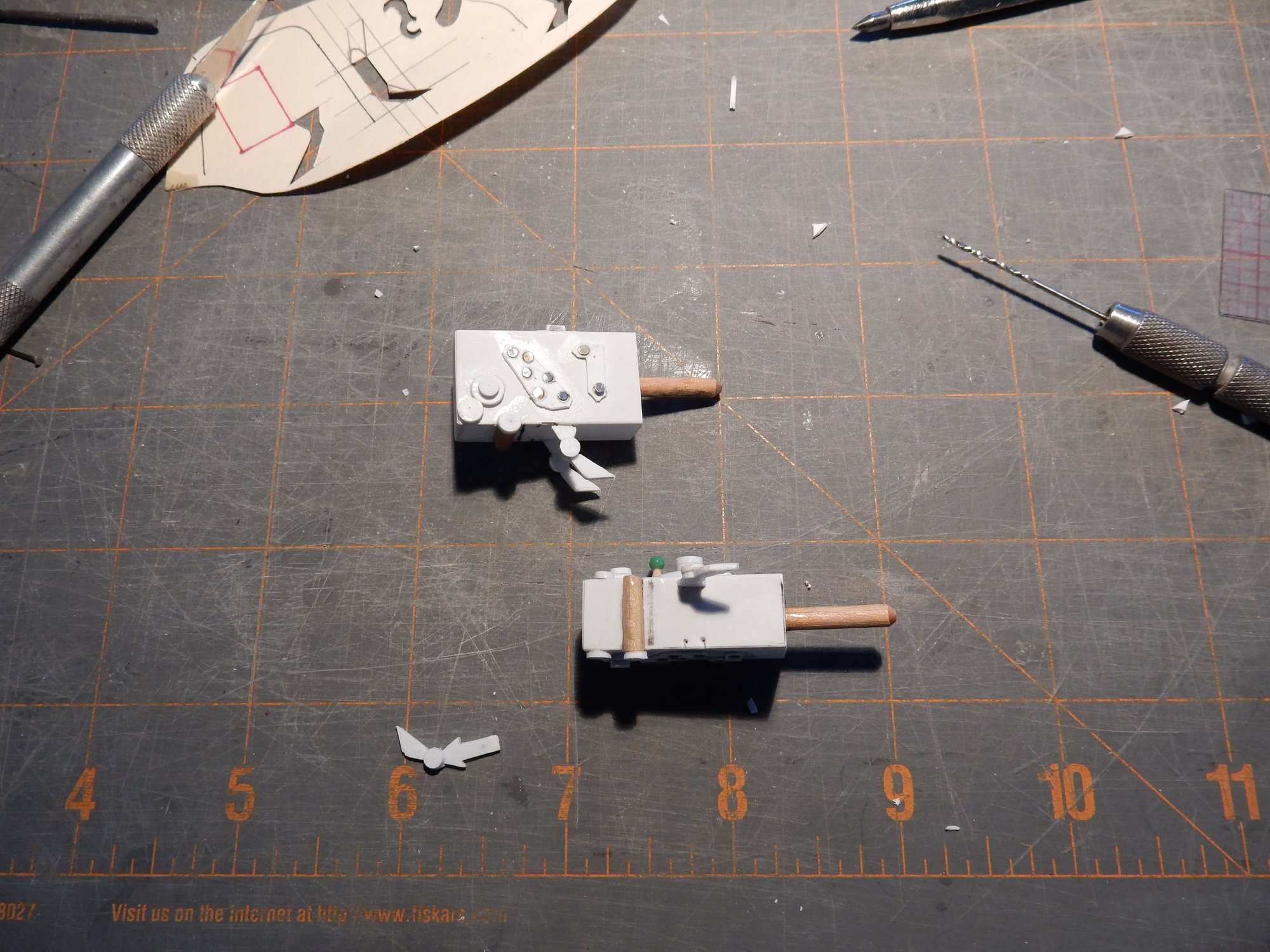

Foredeck ground and sanded out to make a "shadow box" for the twin .30 cal. gun breeches. Will be painted flat black to add depth.
Styrene-clad instrument panel backing temp. in place. When completed w/ instruments, etc., will be painted Jap Navy int. green.
Styrene-clad balsa breeches w/ detailed "bits" added. Here, a series of holes are drilled in a row to simulate bolt travel slots. A #11 blade opened up the channel afterwards.
Channel opened for a convincing look. Bolts were made by drilling a small dowel and inserting a dressmakers pin into it, then taper-sanded and cut to length w/ excess pin shaft used to help glue it in place.
Cocking handle outline (right side on folder stock) cut out and ready to be glued to aluminum sandwich.
Template glued in place, excess outline to be ground and filed away. Hole drilled in bottom of handles already glued together.
Shaping done, pieces separated and ply handle knobs glued in place on handle on left. Finished shaping & sanding complete on handle on right.
Joe. (05-06-2020)

.30 Cal. machine gun breeches. Long dowel is for mounting into foredeck block. Smaller inset dowel underneath is drilled out to accept cocking lever. Small styrene supports are gun mounts to mounting tube behind panel.
Gun breeches temporarily shown in place on notched mounting tube.
