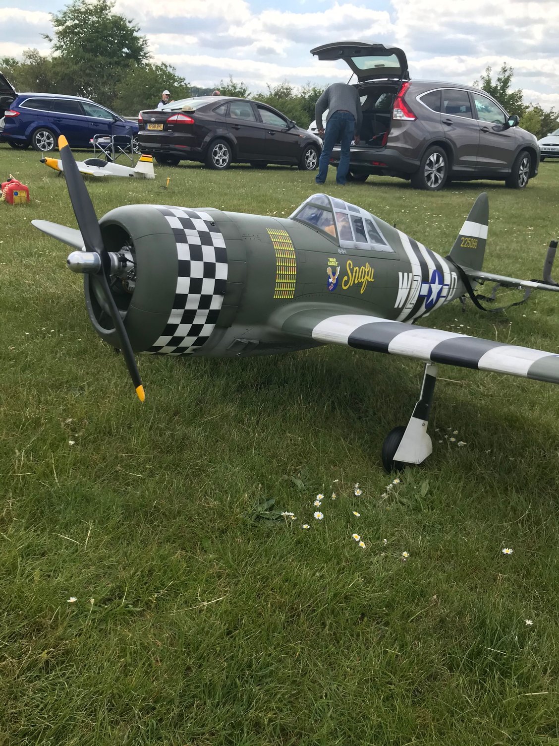

I finally had some time today to head to a field with a runway long enough to try it out.
Overall I am quite pleased by it. First take off, I had the elevator on too high rate, and I found myself off the ground too soon.
However, I was able to bring the nose down and gain enough airspeed to complete the climb out. The airframe was very forgiving.
Switched to low rates, and it required a few clicks of
down elevator to trim. In the end, I found that 18 mm on the elevator and 20 mm on the aileron was a good combination.
Flaps required another click of down elevator.
Unfortunately, on landing I must have caught something, since my right gear collapsed (the previous owner had already repaired it). It did some damage that will need to be repaired, and I will take the time to beef it up. If you guys have any suggestions, I am all ears. I was thinking about using carbon fiber strips to reinforce it.
Also, I should have used full flaps rather than half flaps. Live and learn.
Telemetry logs shows a maximum speed ~ 90 kts in level flight. Plenty enough for me. As far as stall speed, I estimate it between 25 and 30 kts. These values

as restrictions have lifted a little in England we are now able to fly. I managed to get 2 flights in on the P-47 and I have to say it’s very nice to fly. I ended up with around 25mm up and down on elevators and around 18mm on ailerons.
the 84cc Radial pulled it around the sky ok.
not unlimited power but plenty to fly it scale.
i to had to put a fair amount of down trim in which would suggest it’s a little tail heavy and in my opinion it flew that way to. The only issue with putting more weight upfront will worsen it’s tendency to want to nose over.
other than that it’s a superb model 👍

I am almost ready for my maiden. I use a saito 90 r3. What is the cg that u use? I put it on 160mm from leading edge. Is this oké? It is exact 14 kg of weight. What do you think of the strenght of the plane? I think the wings are verry flexy. When it is on its wheels and you push on the top of the fuselage it bents al lot i think.

Nice Work on P-47. I set mine to 155mm and for me its just about right. I have to push forward a little when inverted and it come out of barrel rols with very little input on the elevator.
At this C of G it does want to nose over abit like any warbird but I put the flaps up as soon as it touvhes down and this solves the issue.
I would love to here how yours goes with 90R in it

Today was the maiden. And we did 3 flights. It is really a smooth plane. Verry good flight characteristics. I put the cg on 150 mm from leading edge . And that is spot on. Elevator 30mm up and down with 40% expo. Aileron 20mm up and down with 40% expo. The Saito fg 90 r3 is a perfect engine dit this plane. Enough power to fly scale and some aerobatics. Total weight is 14.2 kg. I've added 400gr lead in the nose. Verry easy to land . It floats verry well. No bad habits. And no nose over. Full flap with 3mm down. 1 minute warming up and 8 minuten flight i use 200 a 250 ml fuel. It is a verry Nice flyer.
