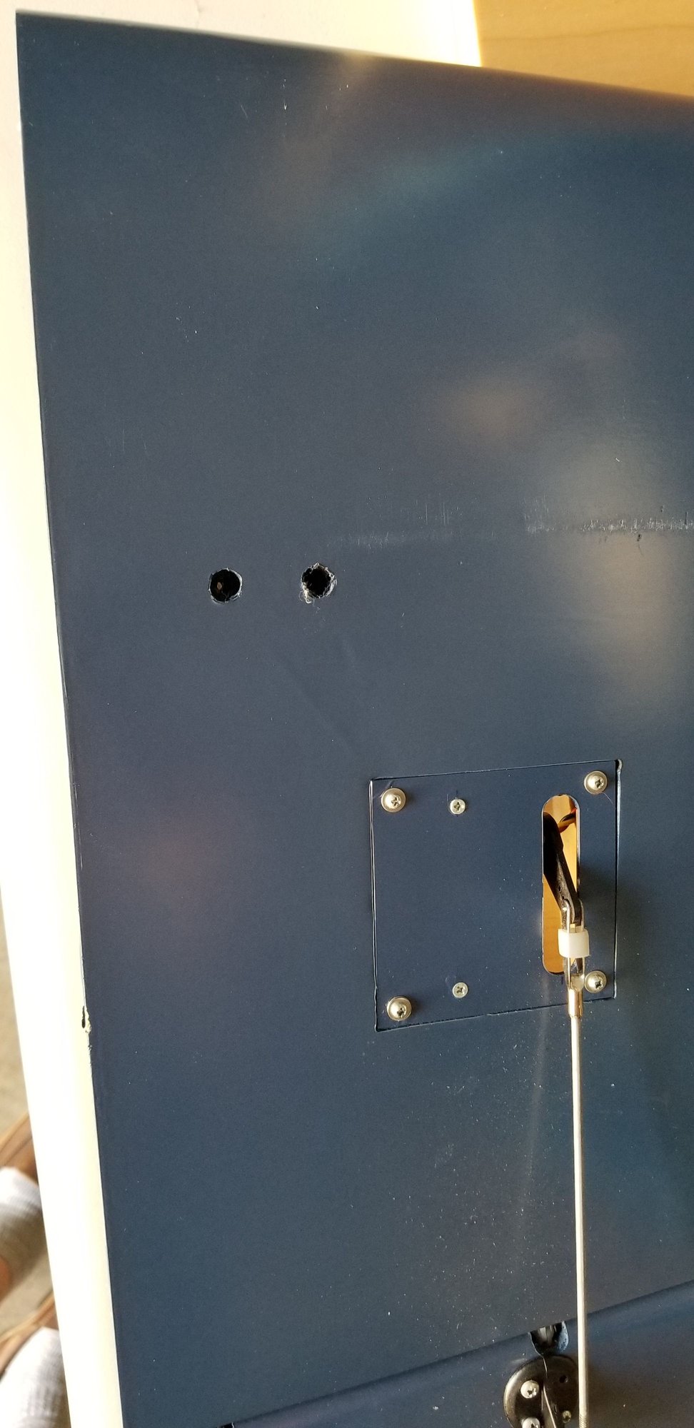

Glad to find this forum and hope it is still active. I was lucky enough to find a great condition F4U and have figured out most of the previous owner's build and setup. But need help in properly securing the outer wing panels to the center sections.
As you can see, the top of the outer panel has 2 bolt holes fore and aft. The bottom of the outer panel has 2 bolt holes side-by-side.
The top of the center section supports has a small hole thru the cf rod, and an indentation on the alum. spar.
The bottom of the center section supports has again, the hole in the cf rod, and 2 indentations on the alum spar.
The bolts that came with it are 1 inch with a thin neck and 3/4 inch and seem to be same head size. The black bolts are also 1 inch.
None of these bolts screw very nicely into the cf, btw.
So am I to assume that you guys use for bolts to connect the outer wing panel? I don't want to force them in at the moment and get me in a jam.
Thx for the help! DSA

The outer wing bolts, 4 per wing, can be assembled at the field. The center wing section is bolted to the fuselage with two larger bolts and the plane can be easily transported gear up or down this way.
The round fuselage makes it hard to transport it without the center wing wing on unless you make a custom stand.
You will probably find out that you have to check the 3 outer wing bolts each flight. The 4th bolt, I call the Jesus bolt, never comes loose because itís tightened into hard plastic and itís pretty long. If you lose that bolt in flight and the others come loose then you get the picture. Make sure that one is installed every flight. Iíve landed with all of the bolts loose or barely tight before.
You can also file a flat where you can see the the tip of the bolts have already made an indentation. This helps make them safer from allowing the wing to slip off even if the bolt is not seated tight.
See the aluminum bulging where the bolt has deformed the spar? This makes it hard to slip the wings on/off. Go ahead and file that bulge off and make it smooth to match the spar.
Also, the threaded inserts in the wings that allow you to tighten the bolts will wear out or strip if your are heavy handed. They can be drilled out and replaced with brass self threading inserts and I have shown that on this thread.
