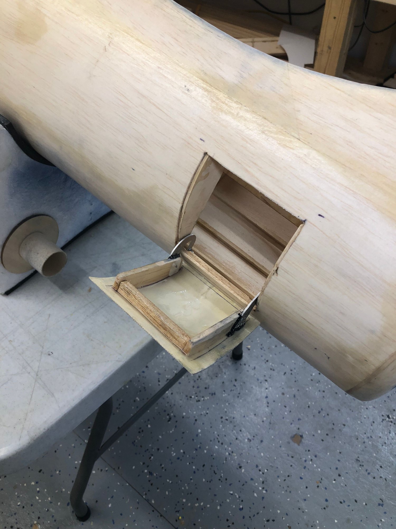

Got it covered ready for paint and got another hatch made

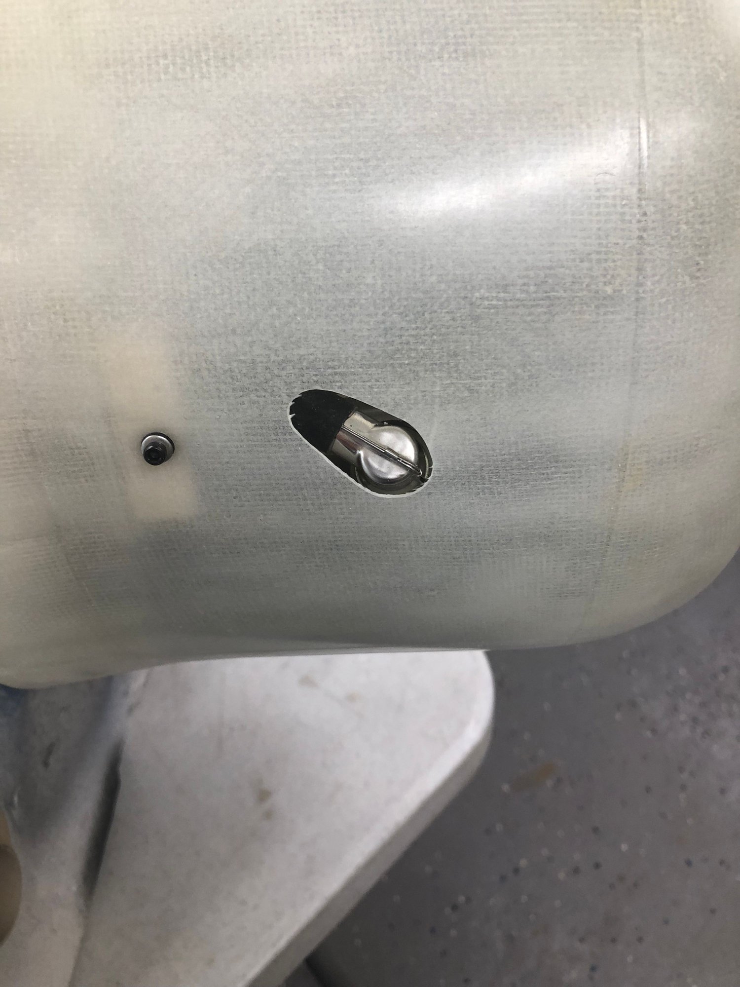

Cowl is fitted had to cut a small relief for a plug cap will make a blister to cover it

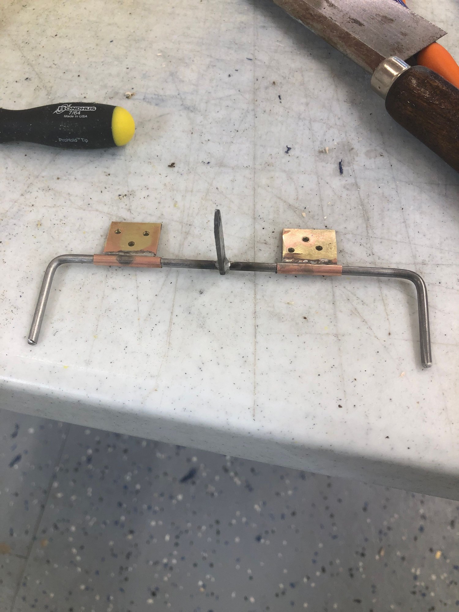

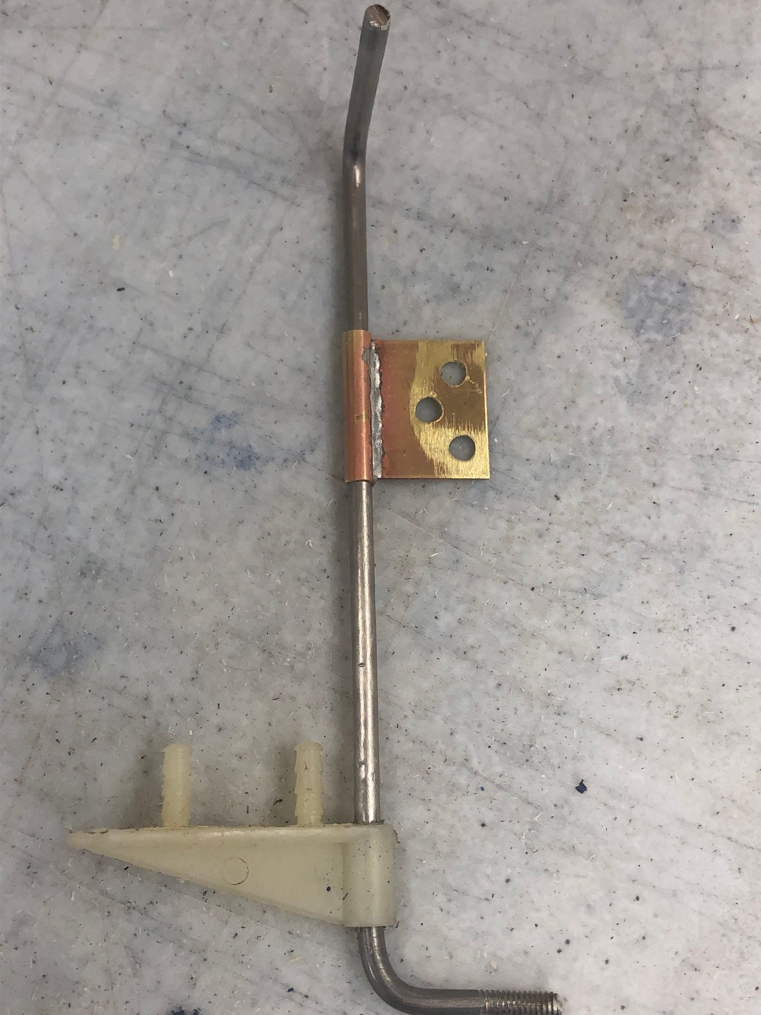

Made new torque rods for the rudder and elevator out of music wire to fix the flex problem in the control surfaces
also made the elevator a common rod for 1 servo
also added new hard wood blocks to the rudder and both elevator half’s

Dusturbd that elevator linkage you made is a good idea but I would be concerned with relying on that solder joint to take the torque load.
A better design would be to make the wire loop and twist so it’s one continuous wire. Then solder a couple plates or a tube over the center section to box it in. This way is bullet proof and will not fail. Just a thought...
thanks for the idea
that is a silver solder joint I have used that same setup many times since the early 90’s and have never had 1 fail not to say it can’t or won’t but I have had good luck with them
