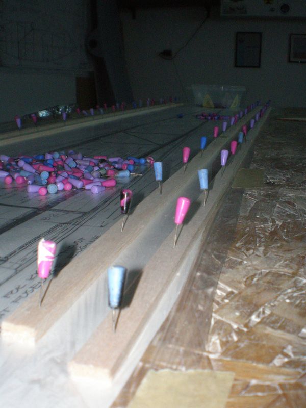

On plan spars are 12x6 mm, but here I can't find spars in that dimension. So, I made spars from 15x5 and 15x4 which glued together...
So I got much stronger spars, but need to made bigger space in every rib...

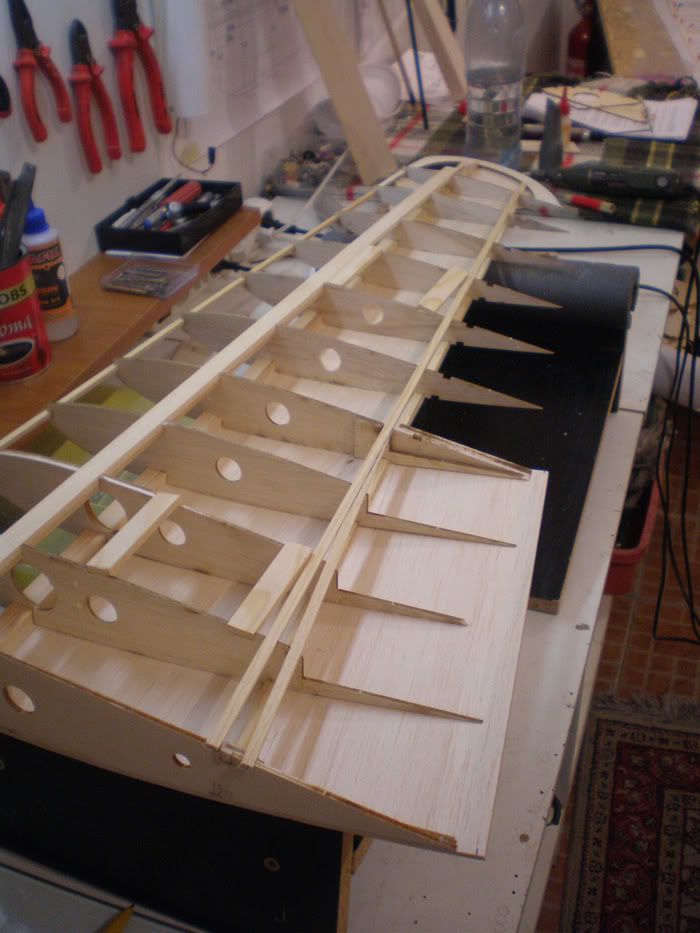

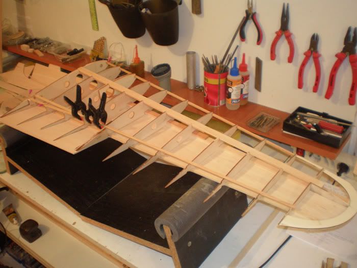

I prepared plan and parts for right wing...

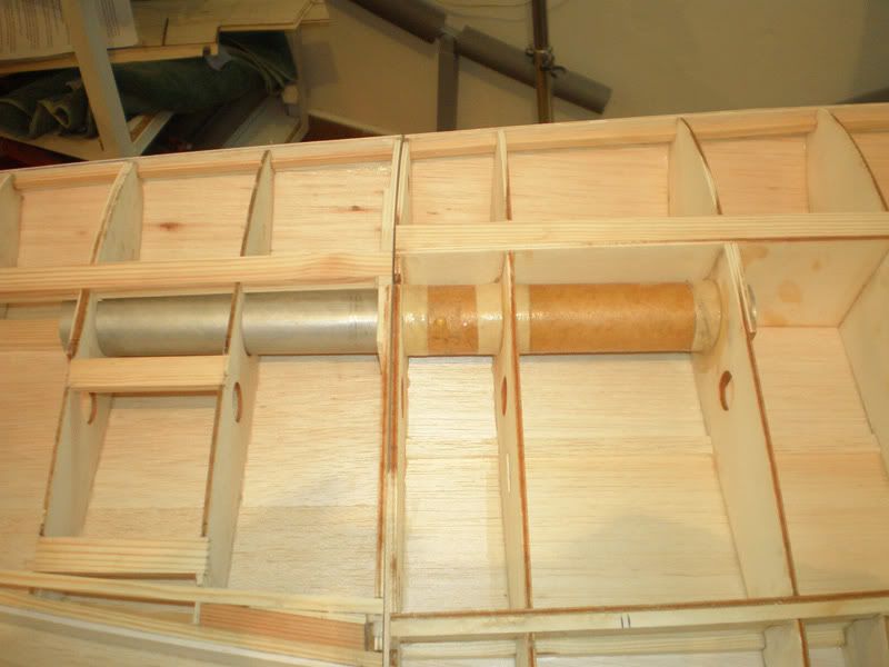

For outer wings I made "my" spars also. But because wing is not so big, I made double spare just on 2/3 of the lenght...
I strengthened ribs for aluminum tube, which will connection wing with center panel...
...and finally ribs...
I put plans on workshop wall to have better view on P 38...
Soon, all ribs were on positions...
To be sure that everything is in line, I use thread...
After that I glued upper spar, and add balsa plates on upper surface...
When the glue has dried I take wing from the work table...
Than I cut down aileron...
...and made space for flap, add plates for servo cower, and round wing tip...
That was it for this wing. In that moment I wasn't have wing joiner, so I made left wing.
Procedure was the same, copy - paste...

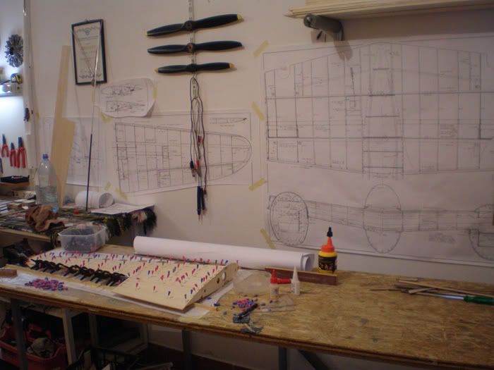

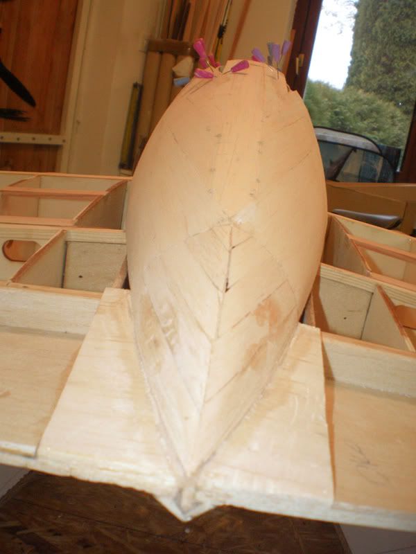

Finally all balsa strips was glued on fuselage...
After sanding, P 38 start to be one "sexy" plane...

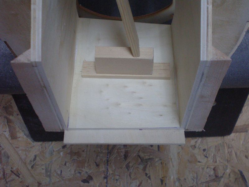

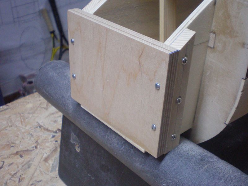

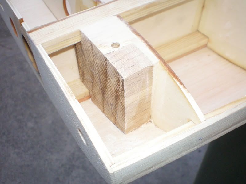

Before cover center panel with balsa, I must put inside parts made from hard wood. Those parts used for guide for booms screws...
There are 4 parts, and every is diferent. My friend, carpenter made it for me...
I glued it in right place...
Wing joiner, and wing joiner tube are glued also...

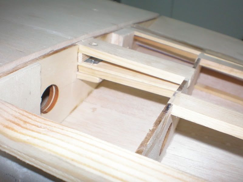

Before cower lower center panel side, I glued plate for fixing center and outer wing panels...
Than...
I made holes for boom screws...
In outer wing panel I made system for panel fixing...
With hard wood I filed gaps, so later there will be position for flap hinges...

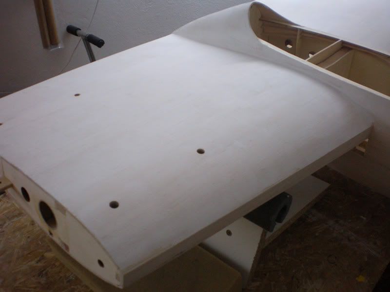

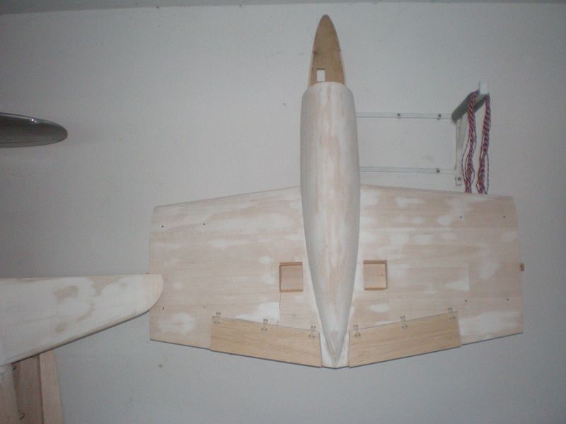

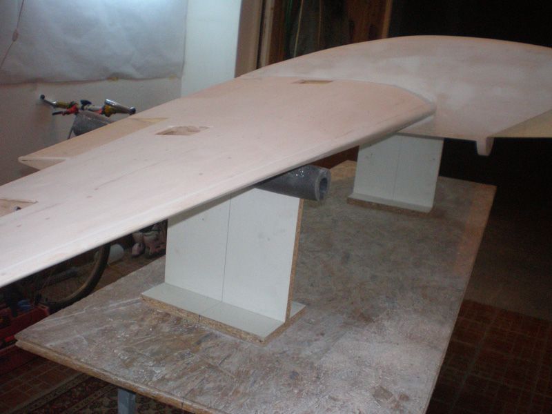

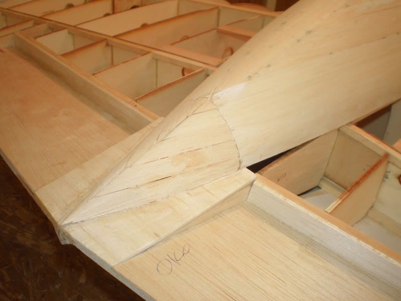

On center wing section I put thin layer of acrylic filer. When I sand it down, surface is very smooth...
In meantime I put balsa on outer wing panels also, and same like on center section, fill it with acrylic filler.
Than I put wing together...
Transition from wing to outer panels was very good and don't need much sanding...
Working on leading edge was next step...
But before get such a nice surface, you need to made this...
This part of building is over. I put P 38 near my Ziroli Hellcat, just to try to compare this two models. But Lightning is so huge that can't find good angle for making pictures...

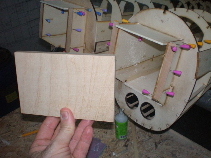

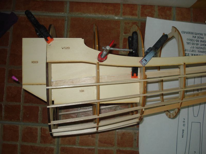

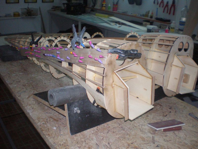

Pictures from my last topic here show that P 38 was ready for fuselage building. First I made balsa frames for fuselage ribs. Frames are long, so I need to glued two balsa strips to get right length...
Soon, frames was made...
Before adding ribs I must check plans. In kit you get one template for ribs angle...
I used it for every rib...
Little by little boom frames was finished...
Than I start working on balsa strips which connected all ribs...

First I made all flaps...
For control horns I used G 10 plate...
For made this horns I need less than 45 minutes. With ball links it look like this...
High is same like Dubro biggest horn, but it look much nicer...
I glued horns in the flaps. Unfortunately I wasn't made pictures how I made support left, right and in the middle of every horn...
On center panel flaps look like this...
Than same procedure on flaps on the wing outer panels...
To made trailing edge straight I used metal ruler...
Than I take down all flaps and add balsa plates on inner side. I made upper and lower plates purposely moved, to get better trailing edge...

I made elevator also...
For hinges I used laser cut ply which I got with kit...
When everything was glued, I add balsa planks on both elevators part...
Than on the leading edge of the moving part I glued plastic tube, and after that balsa plates...
Leading edge was sanded to get round shape, and I made slots for ply from the front elevator part.
To cover gap between those two parts, I glued 0,4 mm thin ply...
Little acrylic filler was added for smoother transition...
... and after sanding elevator is ready for glassing...

Few days ago I bring back P 38 fuselages back in work shop...
...plans are again on the walls...
...and parts are on the table...
I need some time to remember what are next steps in this building. Lightning is pretty complicated for building. A lot of parts, a lot of drawings, so you have to look at them and studying them all.

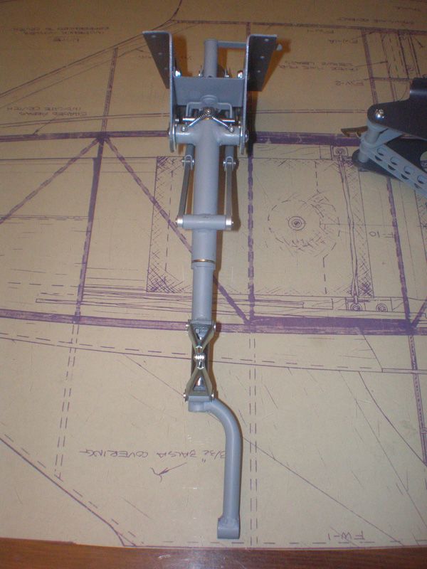

Landing gear plate must first glue from two plates to get right thickness...
On fuselage sides you must glued some wooden parts of hard wood, on which will LG take a seat...
Next step is to glue plates, but must take care about how to turn plate. It's very important to not to turn it up side down...
When I put landing gear in hole I discovered that it can't be open because you need to made some small extra hole...
Finally everything is on place...
Now I need wheel to see how it look... Because I haven't wheels for Lightning right now, donor was Hellcat...
Shaft are exactly same, and wheel look like this...

Few more pictures... To see better where and how exactly looks holes for landing gears and wing, I start adding balsa plates on front part of the fuselage...
Fuselage is pretty rounded, so I wet every balsa plate with hot water and use white glue.
I worked on both fuselages parallel...
Box which carry fire wall is made on plan from 3 mm ply and I decided do add one more 3 mm ply inside. That will give more stiffening to construction.

I continued working in front part of the fuselages, adding second 3 mm ply on the bottom of the engine box.
Next was to glue fire wall on fuselage. Ziroli show on plans that fire wall just glue on edges of the engine box and triangle parts...
First I glue those balsa triangles, but I wasn't "happy" with that idea. I want to add few screws and fix it mechanical. So I cut down triangles and glued hard wood squeezed all with few screws.
I think this is much better solution, because engine will be Zenoahs G45, which are heavy and made vibrations. Maybe glue will be enough, but with screw it's much stronger, and no chance to fire wall break out from front part of the fuselage...
