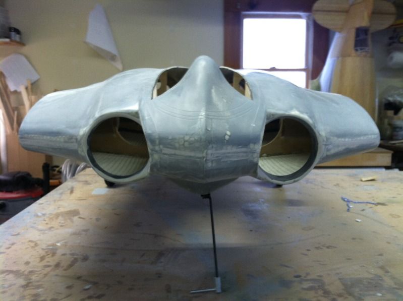

Not a whole lot of gettin stuff done today, I think Tom and I both are starting to get the burn-out setting in. My work trip will be nice just to kind of get away for 2 weeks and get my mind clear of some things (not to mention make some money!).
Anyways, We replaced the wire nose strut for a 3/8" diameter offset Robo-strut. This fixed the lame duck nose gear, but with all the weight needed to get this thing to balance, its fully compressed. The plus, is we still have a bit of a positive AoA, so we are going with this setup for the initial flights. No pictures though.
We also did another CG check. We put everything in its respective positions and balanced it at the CG point (around 19" from the nose). We ended up with: two- 6s5000 lipo's, four- 4s4000 Lipo's, one- 3s2300, one-2s2300 A123, a 4cell 1500mah nicad, a 4cell 3300mah nimh, and a 9 channel Receiver. This is what it took to to get it to roughly the correct CG.. The total weight of all this stuff.. 31.XX pounds. So I suspect the flying weight to be 32-33lbs when all is painted and done.
With 4000watts available and 33lbs, that is 121 watts/pound. It may still fly with this ,but we are definitely doing a 12S jetfan 90 setup in the near future.
This also brings up a good point. We made up a CG doohicky (basically some pointed dowels mounted in a 2x4 that the center section can teeter on. The problem is, when you get it close to being balanced at the CG, depending on which end is lower (nose or tail) dictates if it shows as nose or tail heavy. For instance, without changing the position of anything, we can level the center section and it will sit there for a bit. But if when we are leveling it, the nose is slight to low, it will show as nose heavy, and vice versa if the tail is low. This is without moving the position of Anything!
We really need a more reliable and accurate method of balancing this thing! I have a feeling that the Weight on wheels CG method is going to be the only way to accurately and reliably determine the CG within 1/16" accuracy. For those who don't know the W.o.w. method, it involves some measuring and weighting the weight at each axle, its essentially identical to how they balance full-size airplanes and VERY accurate.

You do know that the 3/8" robostrut is rated for up to 12lbs airplanes. Should be looking at least the 1/2" strut for the nose and probably the 5/8" for the mains. Make sure you have all that weight as far forward as possible. Keep going on this, dont get burned out.
For the CG the WOW method works fine, but you can also look at the CG sling or Vanessa method. Good luck.
#262
The nose gear supports around 1/2 the weight of the airplane, at 32lbs the nose gear is supporting 16lbs. Its over the specs for the gear, but i dont plow my models into the ground on landing and rarely ever bounce, so im not concerned about the 3/8" struts.
The point of the first one is to prove it flies, much of the stuff for this one Tom and myself had about 75% of the stuff laying around our shops, even if it wasnt exactly the best thing for the job (struts) it was better than wasting a couple hundred bucks on new stuff that may or may not last on a slightly unproven model.

On your "octopus" leads. What are they all coming together at? Hard to see in the photo. Also do you run and RF filters with this length?
#267
Fred,
Nope.. Not a P-39, and the project definitely isnt conventional. It was the largest and fastest fighter of WW2.
Pandi,
Is a 12 pin ashlock connector. No rf filters or anything like that, in my experience, they never helped wit what they say they were supposed to do.
Pandi,

I had to run some errands and do some stocking up on hardware at the LHS this morning, so i didn't get much done. I did get the right elevon servo mounted and its linkage hooked up, so both elevon's are complete now.
I also finished up the last of the two octopus harness'/extensions. The center section wiring harness consists of a pair of 12 pin ashlock connectors with four 30" long Heavy Duty servo extensions. Each connector is a different color (which match's the color of each female connector in the outer wing panels) to coordinate each servo with its Rx channel. There are also two Smart Fly Equalizer 2's that are plugged into Aux 1 and the 2nd into Aux2 channels, and then the outer flaps plug into one equalizer and the inner flaps into the other equalizer. This allows the outer flaps to be mixed to go up when the inner flaps go down AND the outer flaps to deflect up when up elevator is selected (helper elevators). The helper elevator function may not be 100% necessary, so i'm going to have it programmed so this function can be turned on and off by the flip of a switch. That way I can use them during takeoff on the maiden flight and then turn them off at altitude, this will tell me if they need to be used this way all the time or not (i'm assuming not, but you never know!)
