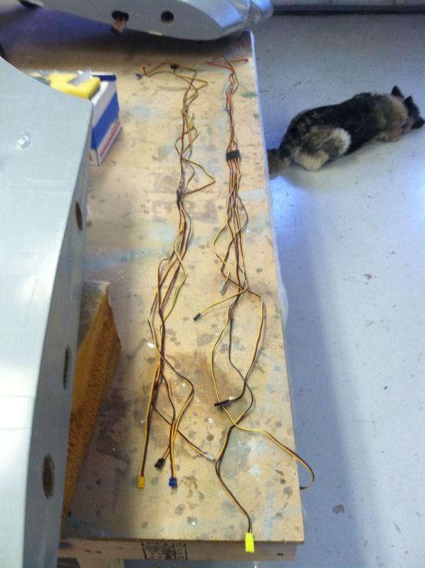

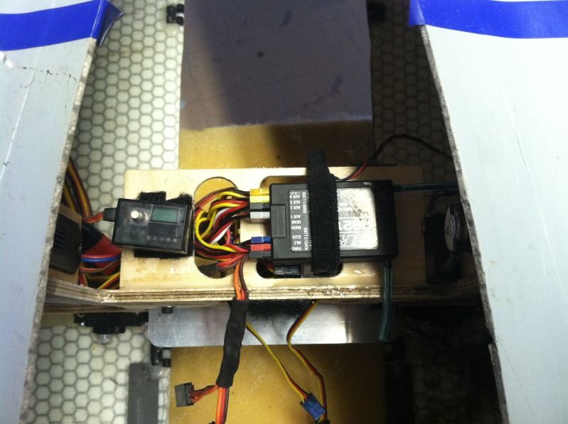

I also cleaned up the Rx mounting and wiring layout of my horton. It was just zip tie'd to the back of the front bulkhead for the first flight, but now that it flies, i had to clean up the rats nest.

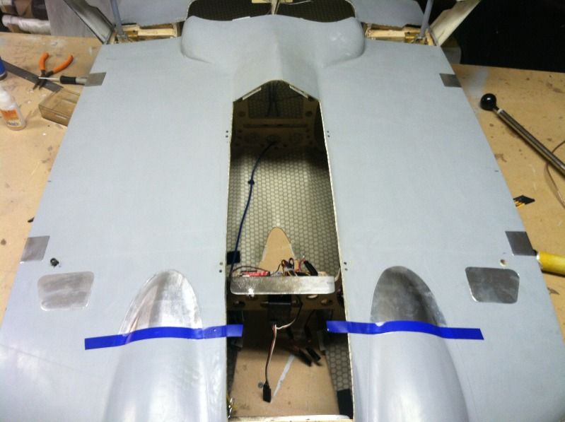

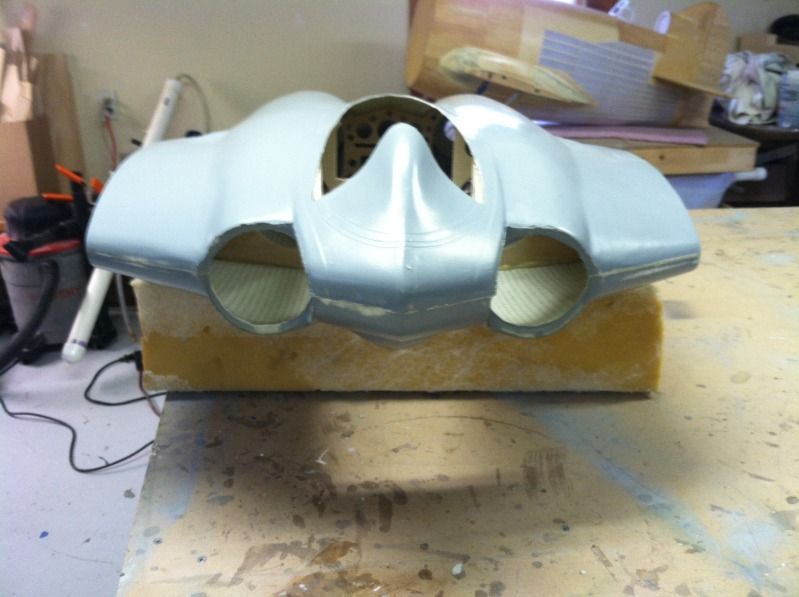

I have also been busy working on Tom's Center section.

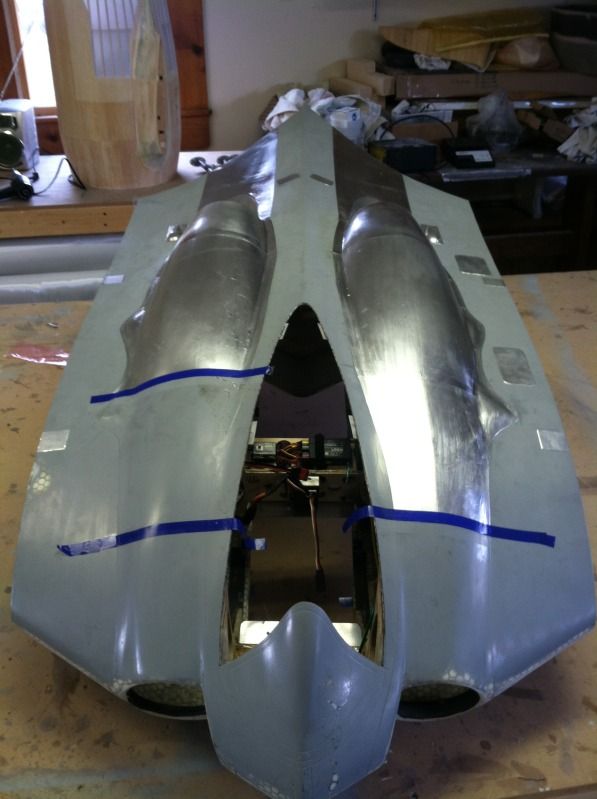

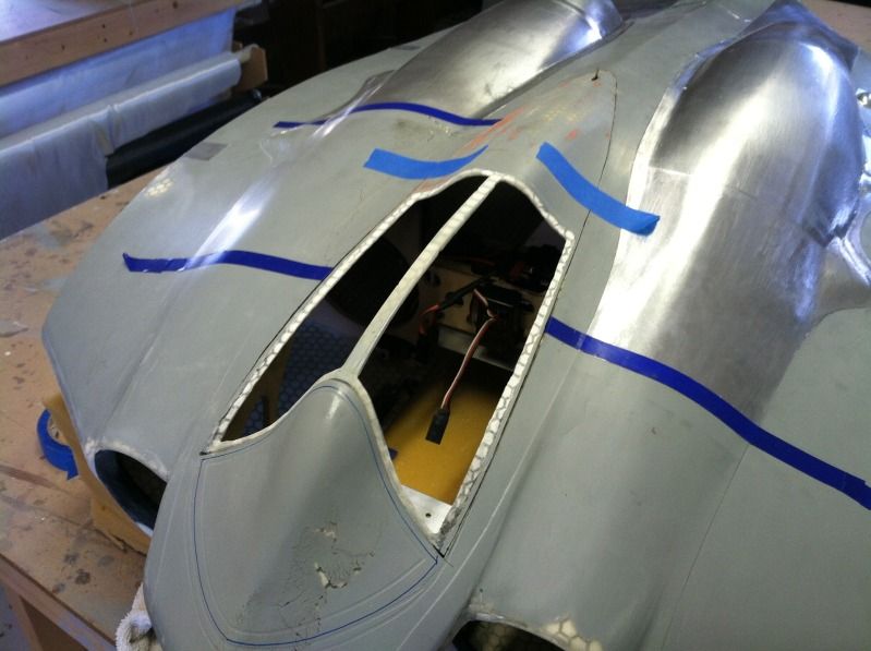

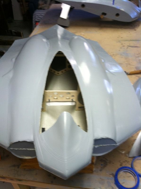

First was cutting out the canopy hatch. this is done using the smallest blade out of the 3 piece Zona saw set (its like a small key-hole saw). A fiberglass and Carbon molded piece that mirrors the hatch is placed into position, and then taped in place. The saw is then used to continuously score the molded center section until it is all the way through, then the hatch is removed:

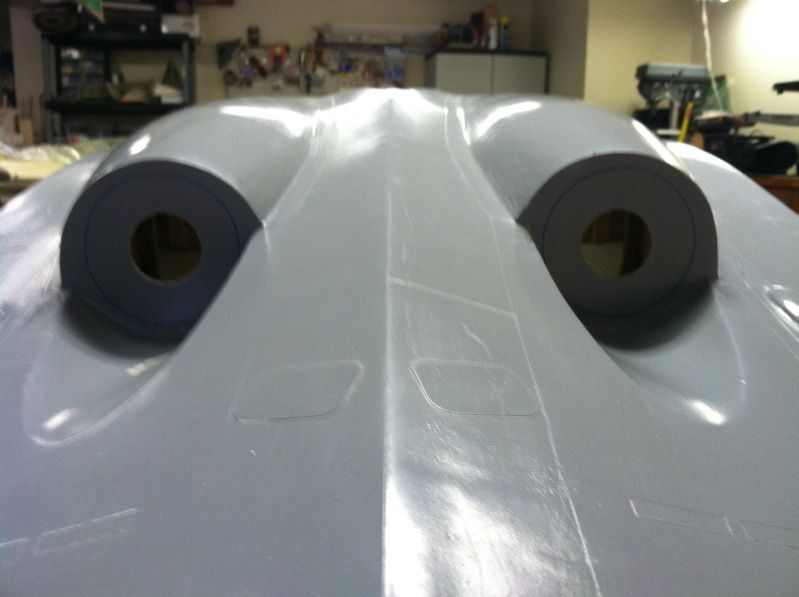

Then the inlets are roughly opened, leaving about 1/4" flange.
Then the 1 1/2" alignment holes for the thrust tubes are cut into the exhaust exit. The wing tubes and sockets are used along with the fan shroud to align the modified inlet ring and fan unit into the center of the inlet and outlet.
Then the Gear door's are all cut out. This is done in a similar way as the canopy, except no cutting guides are used. the upper strut doors are cut free from center section molding and discarded b/c they are provided as a separately molded component. Inner wheel doors and the lower strut/wheel door moldings are reused from the center section, so they must be cut free using the Zona saw.

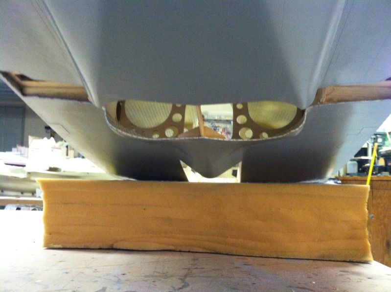

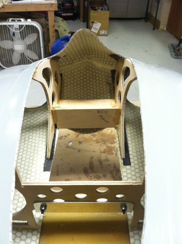

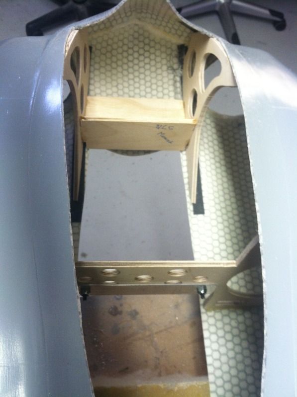

Then the nose gear mounting structure is all installed:

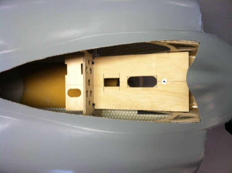

Then the Battery and steering/gear servo mounting plate is installed. You can also see the rectangular plate that has an oval shaped hole in it that is used to hold the receiver and match box's.

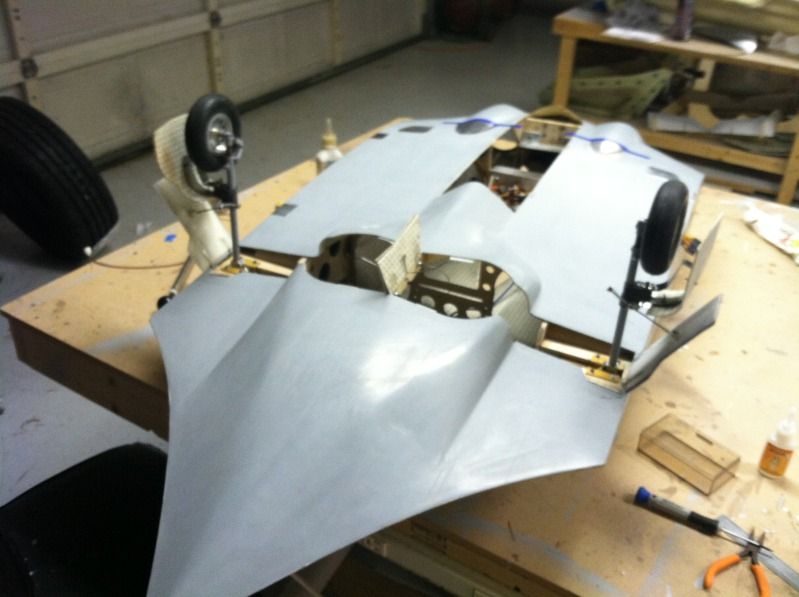

The second center section is getting closer to being at the same stage as the first. All of the little nit-picking stuff is done. The only real construction left to do to it, is the inlet ring install (when i get them) and the fan unit mount plates.
I also made up the octopus' extensions for the 2nd one as well:

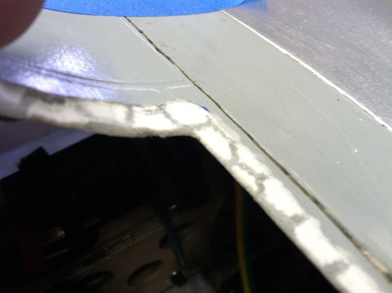

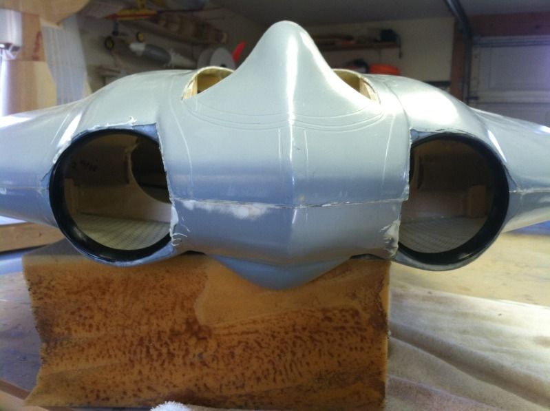

Then on the first one, I did some flite-metaling to the bottom of the inlet fairings:
Then repaired the main landing gear doors and got those back up and working again.
And then I did some more flite-metaling to the top of it. Unfortunately I ran out, so i wasn't able to finish.

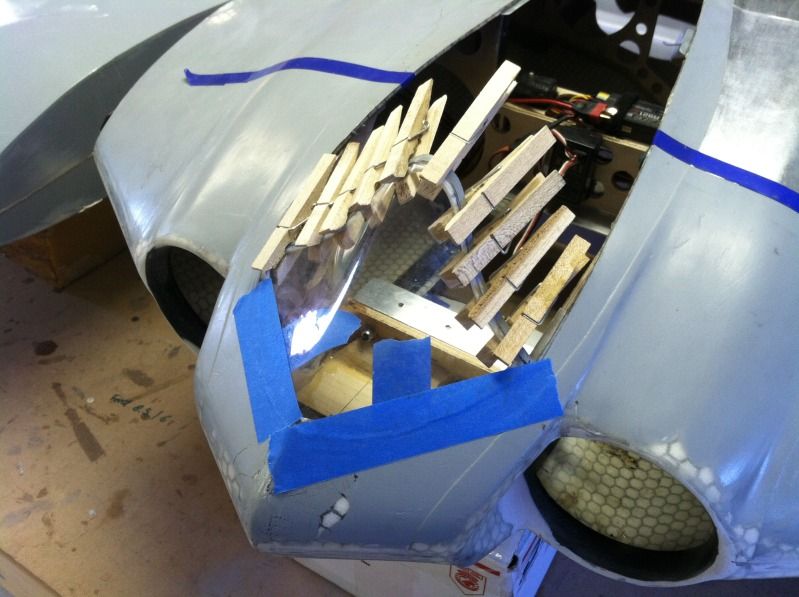

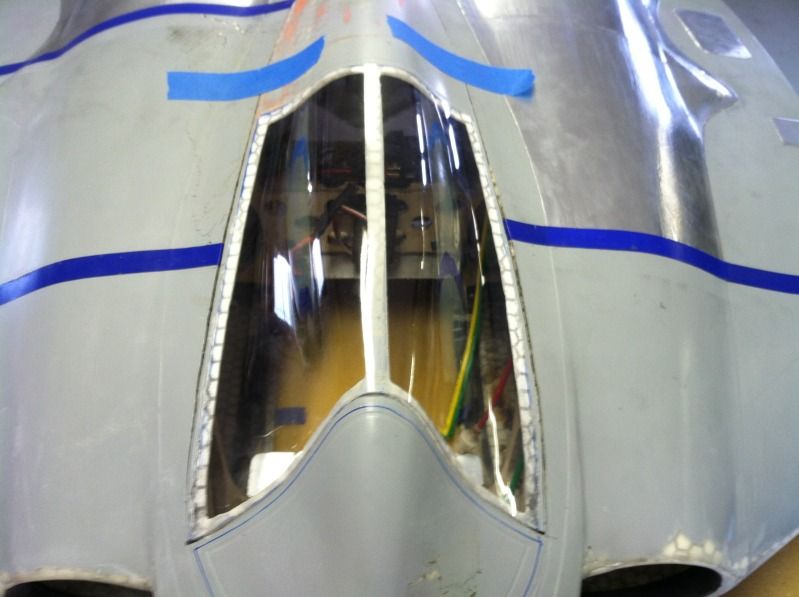

Today I went about installing the clear canopy.
The canopy was trimmed to shape slightly over-size of what you would see. continue reading..
Then i had to cut out the clear canopy area's. The canopy frame has two molded lines, the outer edge of the frame, and then the inner side of the frame where the clear glass starts. The windscreen has three, but you still trim it out to the inner-inner most line.
Then the canopy was placed into position so it overlapped the inner-most edge of the canopy frame by about 3/16" and then the outline of the clear glass was traced onto the canopy frame and windscreen frame.
Using a rotary file, a trench is sanded into the canopy/windscreen frames for the clear canopy molding to sit into so it is flush with the surface:
Then the canopy and windscreen was glued into position with some foam-safe CA (keeps the clear canopy from fogging):
Once all that dries, i'll applly some clear silicon to the center section/canopy frame molding to clear canopy corner joint. Then the canopy and windscreen will be taped off. Then the tape will be trimmed to follow the outline of the inner edge of the frame, any body work necessary will be done (to ensure the clear canopy is completely flush with the surface) and then a flite-metal frame will be applied.

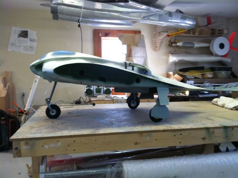

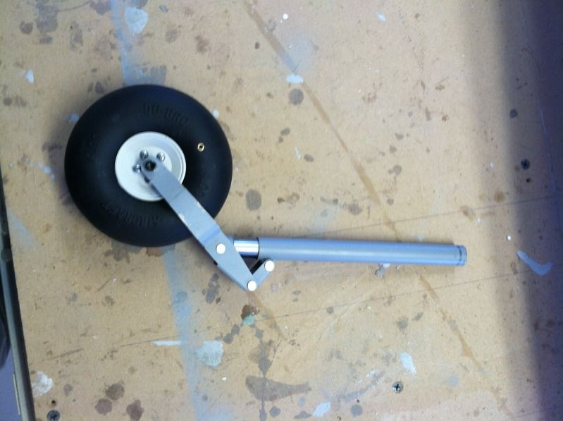

More progress... Robart finally shipped my nose gear unit and nose strut, so that arrived saturday. I got all of the flite-metal done on saturday, along with the adapter for the nose gear strut to work on the retract (it was intended to be used as a fixed gear only)..
And some different length's of nose gear unit showing the AoA..

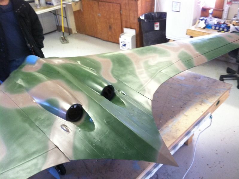

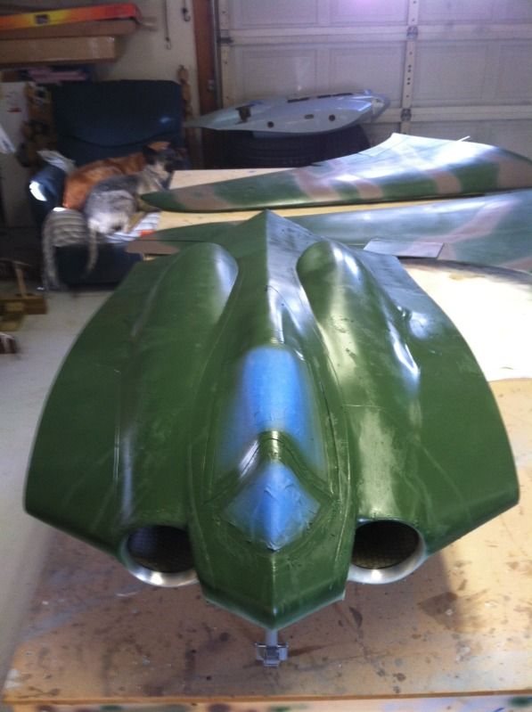

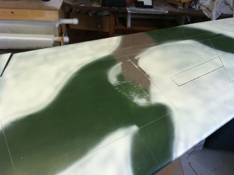

Then today, i got to painting!
First up was doing the interior RLM colors for the gear doors and wheel wells. Then the RLM-76 light blue was spraying on the bottom of the center section and outer surface of the gear doors.. No picture of this though..
Then was the green base coat (RLM-81) on the top:
Then the outer wing panels were put on, and the brown camo (RLM-82) was sprayed:
Then came time for the fun stuff.. WINTER CAMO!!!!!!!!!!!!!!!!
First i took my i-phone in one hand and the airbrush in the other and started copying the separation line between the green and white. then started filling in the white area's. Since WWII luftwaffe winter camo was field applied and normally was made up of whatever white color they could get ahold of and sometimes applied with a mop, rag, brush, paint gun, broom... whatever they had on hand, I purposely tried not to completely cover the RLM- 81/82 base camo..
Then i just continued on with the outline and filling in the gaps, until I got to the point where all the base winter camo was applied.
I'll have to make up the paint masks for the insignia's this week and then plan to spray those on Saturday, then commence with the weathering; some of it (LE chipped) has already been started.

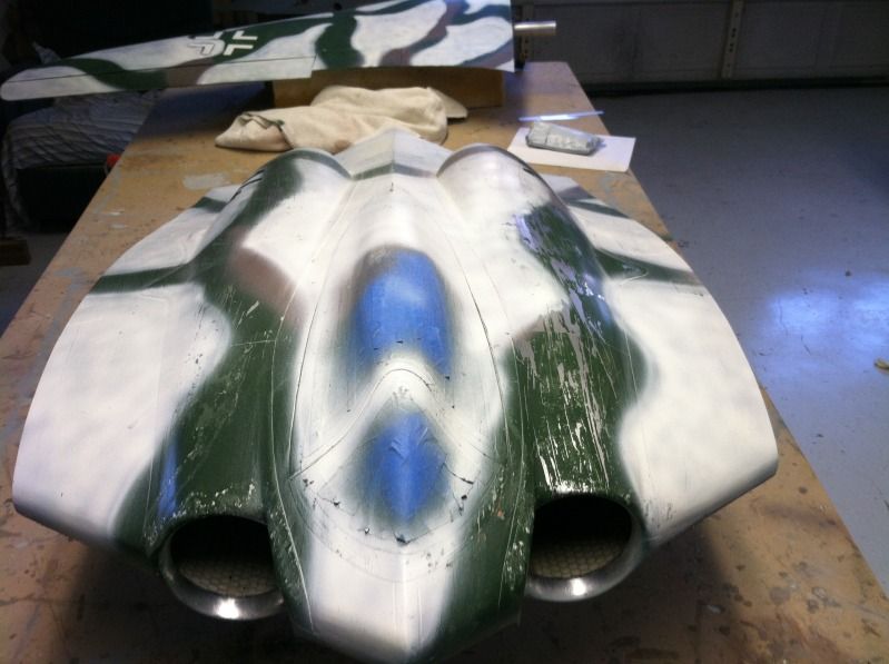

Since we got around 24" of snow today, I got to shovel snow all morning and then said forget about working my way through the snow to work, so I stayed home. After playing in the snow for a few hours with the wife, child and dogs, It was his Nap time so i did some work to the Horton.
Since I made the mistake of doing the snow camo before adding the insignia's to the tops of the wing panels, I made up the paint masks for those insignia's then marked on the wing where the winter camo needed to be removed and removed it with a scotch brite pad and some water downed windex.
Then the paint masks were put into position on the wing panels:
Then the insignia was painted:
Once it was dry, the paint mask was removed giving you this:
And then the winter camo that was removed was re-sprayed around the white insignia's on the top..
The Black insignia on the bottoms was also sprayed:
I then drew up the paint mask for the Radio call sign and the swastika. Since the swastika is typically placed on the vertical stabilizer and the Horton has no vertical stabilizer, the only vertical surface (or near of) was the aft end of the engine nacelle fairings, so I decided to place it there.
Then the Radio call Sign (Black 14) and swastika was sprayed on both sides:
I have to wait for some RLM 23 and 24 to arrive for the squadron tail band colors, then I can apply those and begin the weathering and get this thing done and ready for flight again!

After modifying the Robart nose strut, i finally got the 4" Dubro big-wheel mounted to it. It was about 1/8" to narrow for it to just be a simple bolt on job, so I had to bend the trailing link portions of it outwards to splay around the tire and then back inwards to the axle.
Then I installed the strut to the nose gear unit. And come to find out with the larger retract unit, it now interferes with the steering servo so i need to fix that issue... always something!
Then i took the steel wool to the airframe to begin the weathering process. It took off more of the paint from the flite-metal portioned than I would of liked, but after awhile it, i began to like it. So today it will get the dirty wash and i'll start getting all of the good stuff installed again.
