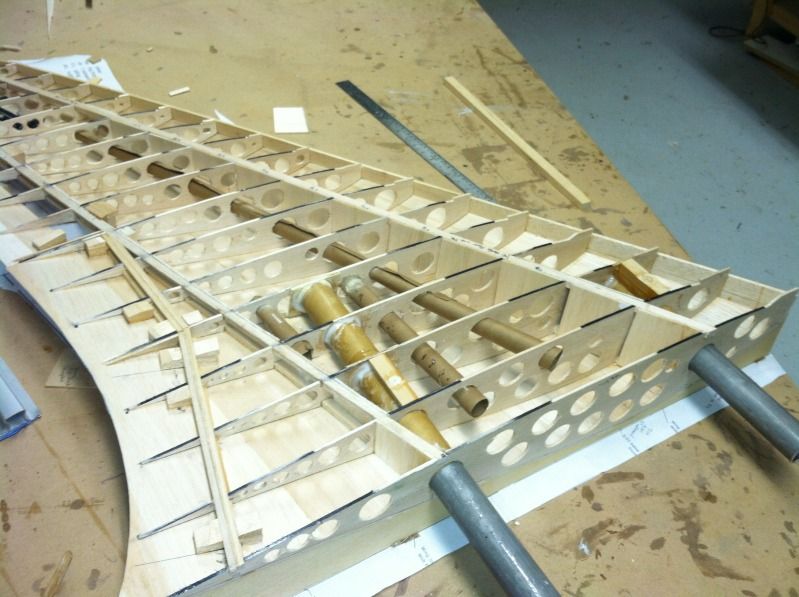

Bit more work while i'm at home sick with something my wife and son gave me... lol
Got the drag rudders constructed:
Then started the install of them into the wing.. I have to say, if this was the original sized one, i'd be cursing a storm! These things are pretty complex even at this scale and I can't imagine putting them in a smaller wing.
I plan to have these directly attached (no slip joint style pushrods) to the drag rudders and then program the radio so that they only move in one direction. IE, when left rudder is commanded, the left drag rudders pop out and vice versa.
Since the mockup worked well and proved my theory on actuating them will work, I glue the sheeting jigs down on the table so I could begin prepping the bottom of the wing for sheeting.
Then I remembered i need the wing tubes and sockets in order to sheet the bottom of the wing. I ordered these things a week ago and still hadn't received them. An hour after calling the vendor, they ended up on my door (apparently the post office was waiting for someone with a big enough vehicle to deliver them, haha).
So, now that I had wing tubes and sockets (and engine stand-offs for another project), I needed to enlarge the 1.5" diameter holes in the wing ribs for the wing tubes so that the sockets could fit. So to do this, two layers of 80 grit greatplanes sticky back sandpaper was wrapped around the end of one of the aluminum tubes:
Then the fancy shmancy gritty sandpaper tube tool (patent pending!) was used to enlarge the 1.5" holes to fit the sockets:
Then I cut a 18" (rear spar) and 12" (fore spar) section of wing tube from the 60" long wing tube and test fit them into the wing sockets:
Then some 2 1/2" x 2 1/2" ply squares with a hole in the middle for the wing socket (these are doublers for the balsa wing ribs) were made up and modified to fit in the wing. Then about an hour of checking, fitting, adjusting, checking, etc etc etc I got the tube sockets aligned and ready to be installed so they were epoxied in place. I also used some brown packing paper to make up the servo extension conduits. Each plane will have over 20 FEET of servo wiring in them!
I then installed the sheer webbing on the front of the front spar. I will probably sheer-web the rear spar as well, maybe...
Other than finishing the drag rudder install and some sheer webbing between the wing tube sockets and bottom wing sheeting, this wing is ready for sheeting!

#33
Still sick... But laying on the couch or web resting makes me feel worse, so out in the shop we go!
First up was getting that crazy contraption they call drag rudders finished.. Thankfully, this side is done, but I have to do it all over again.. JOY.. ughh
Then after a few hours (like 3 or 4) I got all the hinge and control arm hard points installed.. There are allot in this wing and took forever! In this photo, you'll notice the hinge blocks for the elevons are pre-slotted for the hinges. This should make life a little easier come time to hinge this thing. The blocks in the wing were also pre-drilled.

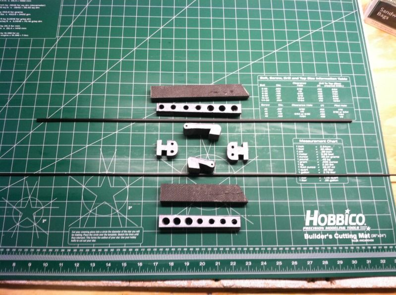

Then I made up the Robart hinge point extensions. These are 5/32" square brass tubing pieces. The robart hinge points will be hysol'd in these and then these hysol'd into the wing panel. I used this same technique on my FW-190 and it worked well, so instead of cutting out all of the custom hinge's that are on the plans, I decided to do it this way.. much easier!
Then the wing was ready for sheeting, or so i thought.. I still have a few hinge hard points for the outer flap to install (i'm beginning to hate hinges..)
Since the elevon was ready for sheeting, it was sheeted:
And then the rest of the wing sheeting pieces for this wing panel was made up. The central section of sheeting was a bit difficult due to having to put the cutout for the lower drag rudder in exactly the right place.

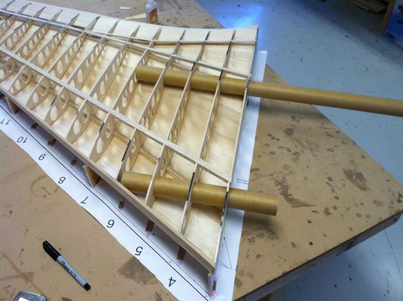

Well after a day or 2 of building a plug, molding and then trimming and fitting a cooling baffle on my 35% Extra 260, And doing some maintenance / fine tuning on other airplanes in the fleet, I have finally gotten back onto the HO-229.
I started working on this thing about 3-4pm today. It is amazing how much faster the second wing progress' after you have learned it all on the first wing. So, the second wing panel is nearly ready for sheeting. All that is left, is to do the elevon hinging holes, profile the leading edge of the ribs and the sub leading edge, install the drag rudders and the servo mounting plate for the drag/elevon servo.
First up, install the hinge hard points:
Then attach the sheeting jigs to the table and then the wing to the jig:
Then Main spars, shear webbing, servo conduits, and more hinge hard points:
Then align and glue in the wing tube sockets. The white paste you see is epoxy and cotton flock mixture. This makes a very strong and light glue, plus you can make it as thick or runny as you need it:
And then the wing tube anti-rotation/attachment bolt blocks and hardpoint (1/2" hardwood dowel inset into the hard balsa blocks) are epoxied to the wing tubes:
And, I had a wild hair and thought, what the heck.. thats the inspiration for this photo!
So, a couple of hints for the guys building these things:
1. Do NOT install the lower forward wing spar when you are initially framing up the wing. If you do, you will have to remove it later in order to set the correct washout in the sheeting jigs.
2. When you install the Flap sub-spars, install them per the plans. THEN install another pair that is butted up against the TE side of the first set. Don't glue the two sub-spars together though. Actually, better yet, would be to install the upper one about 1/4-3/8" aft of the top sub spar, and the bottom ones about 1/8" aft. Reason for this, is it gives you a more robust edge, so when you go to separate the flaps from the wings, if gives you a known edge to cut to AND gives the flaps some more structure.
3. Use the dubro "snap on" style ball-links for the drag rudders instead of the Z bends like what I show in this build. The ball-links will give you a straighter linkage, and will be easier to remove/install if you ever have to remove/replace the drag rudder servo.
4. I'll add more later, but the above three are pretty much the major ones.
