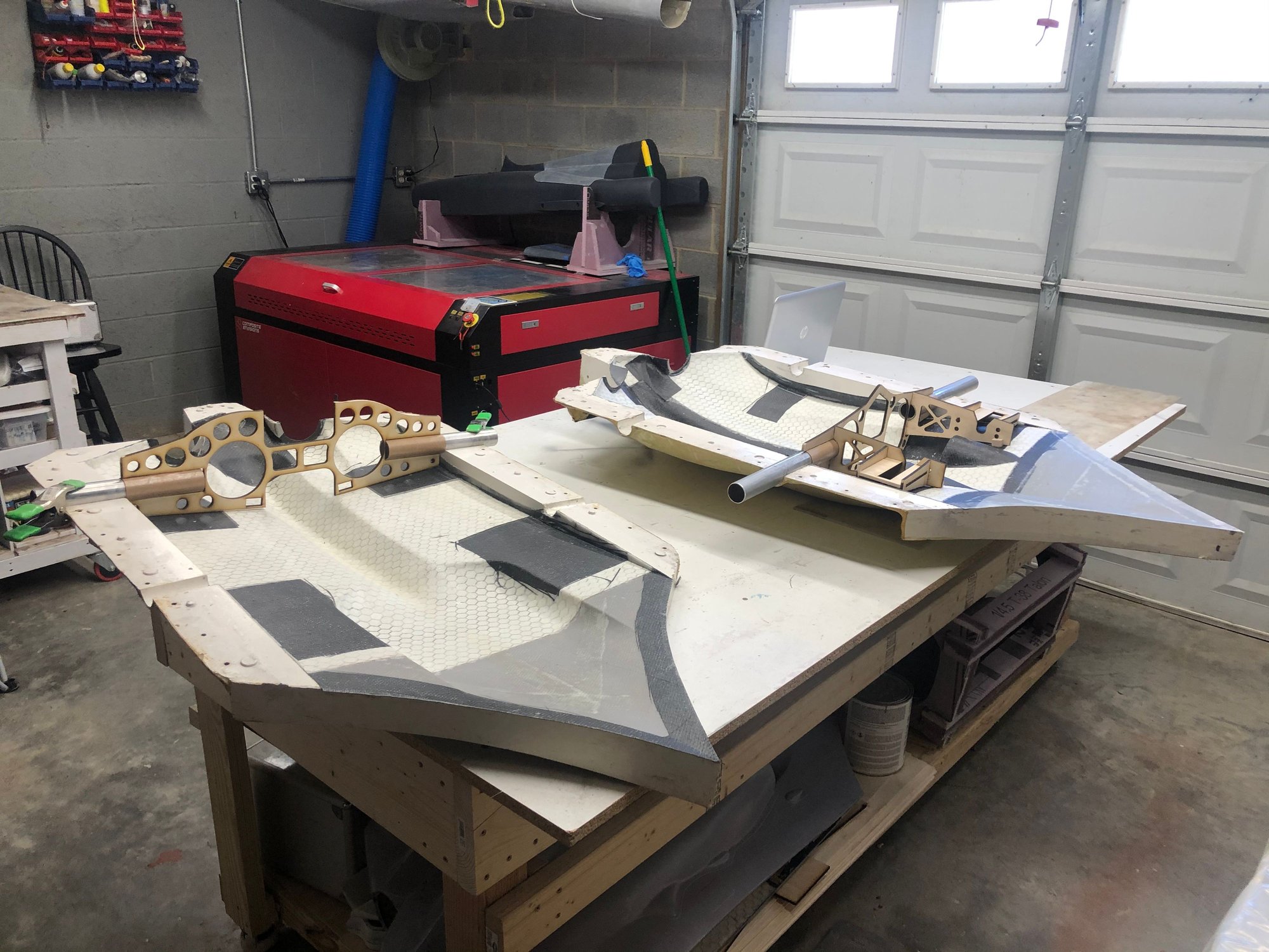

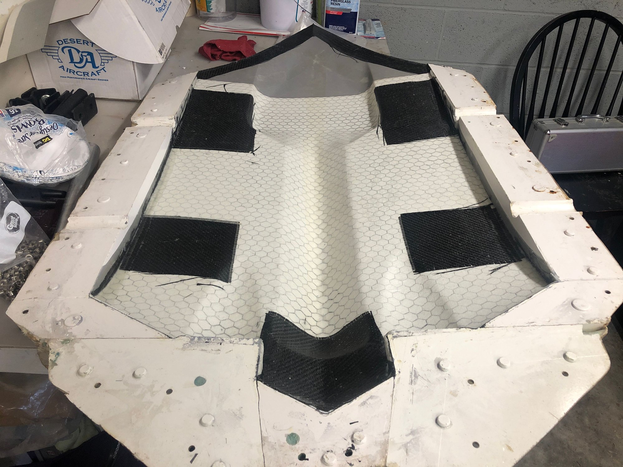

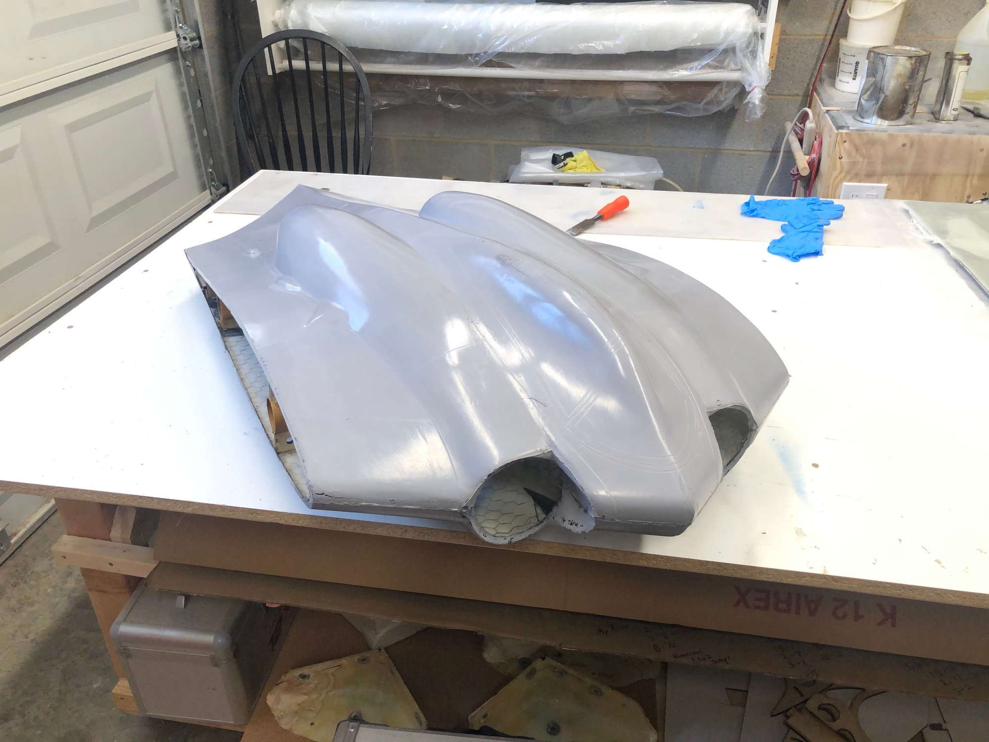

well. Its been a few years, but its time to build and upgrade another (few) Ho-229’s.
the goal this time around is to shave a few pounds off the ready to fly weight.
all future airframes will be FULL composite. No more built up outer wing panels!
The first center section layup came out to 6lbs and 4oz. I have another center section curing in the mold right now that i believe will be atleast 1/2 a pound lighter with no loss in strength. These new center sections also utilize a full carbon skin and laser cut internal structures.

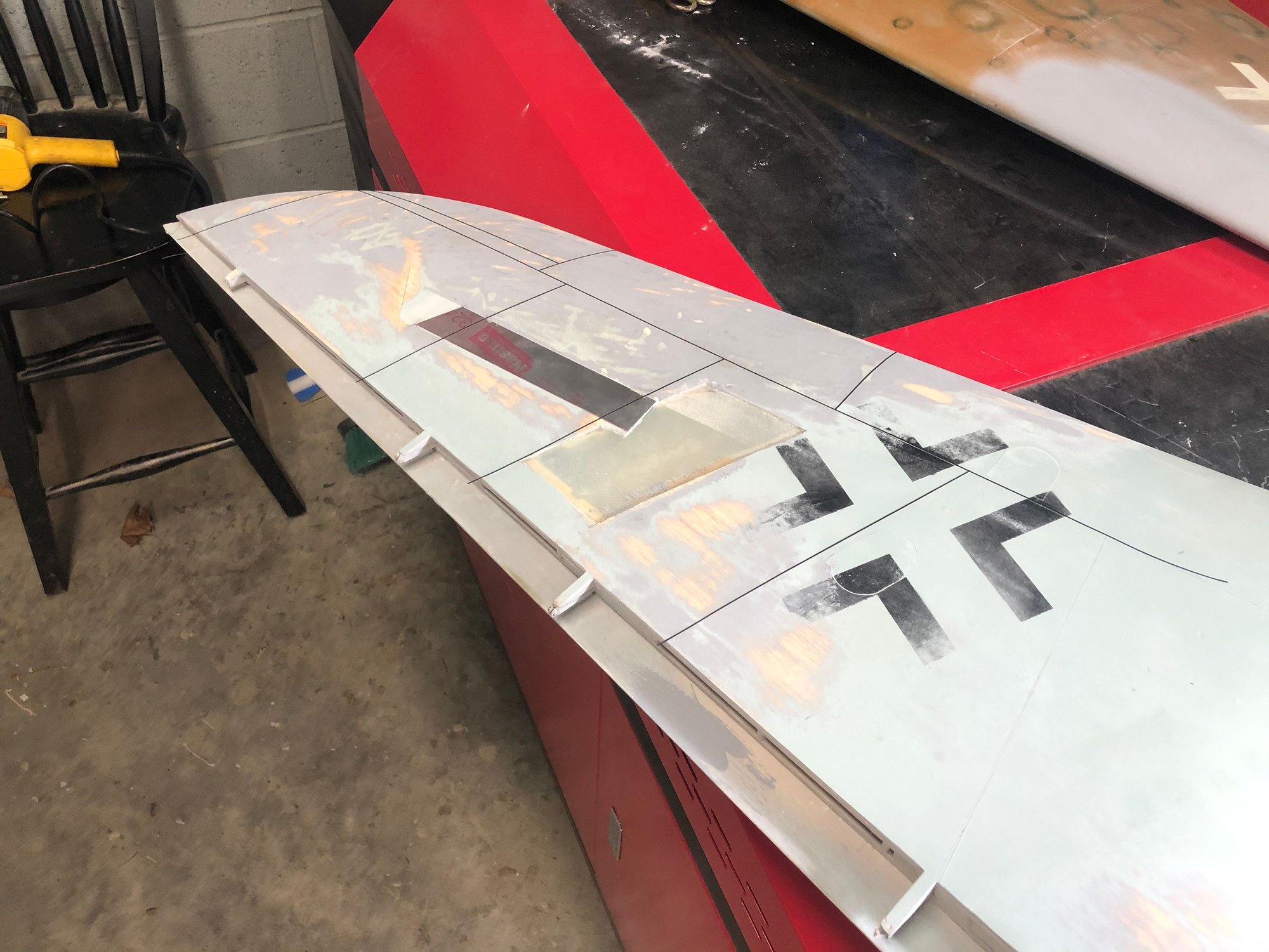

The wing panels have been picked up and the repairs mostly complete.

Wing repairs are done and the repair area glassed.

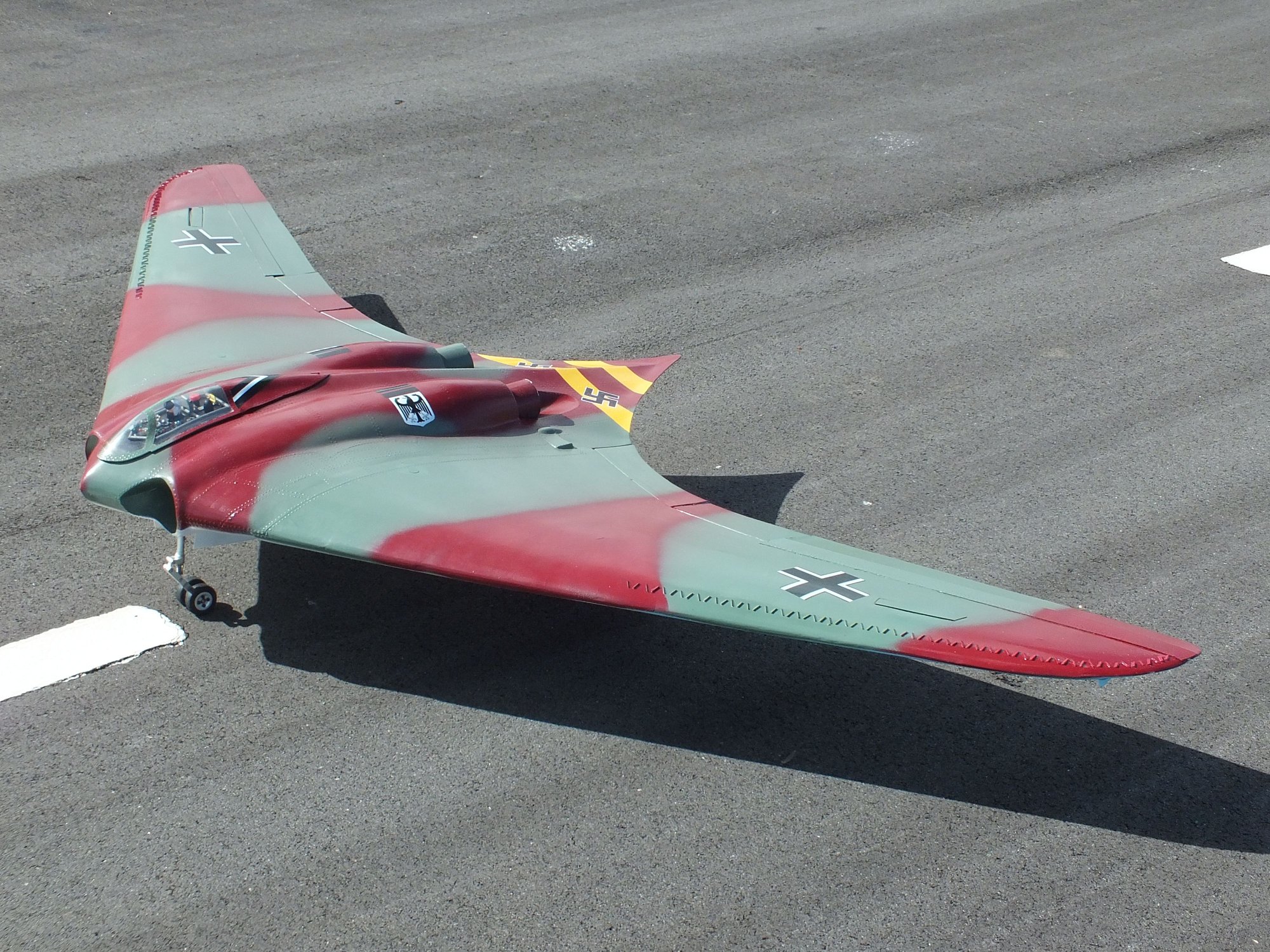

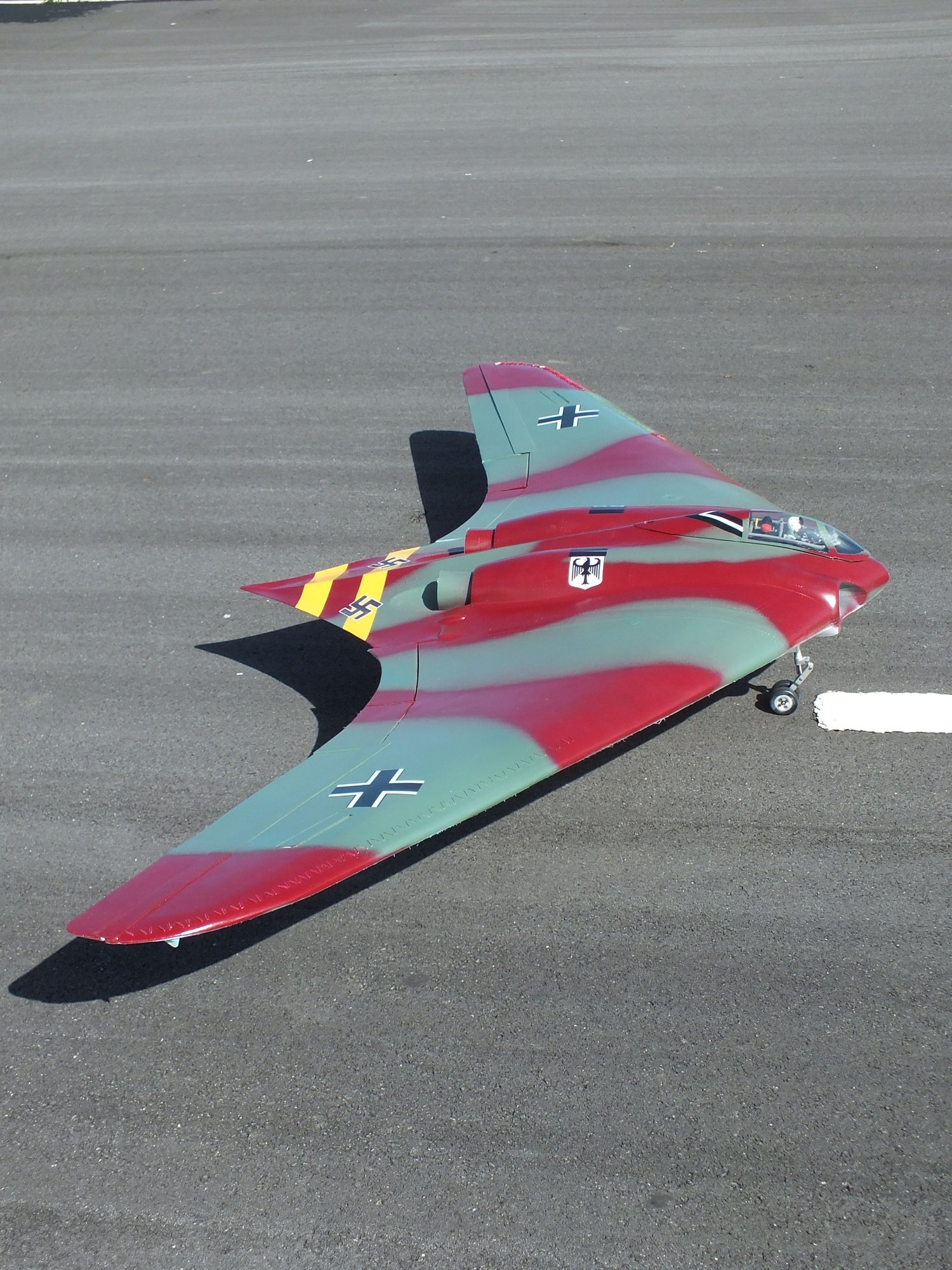

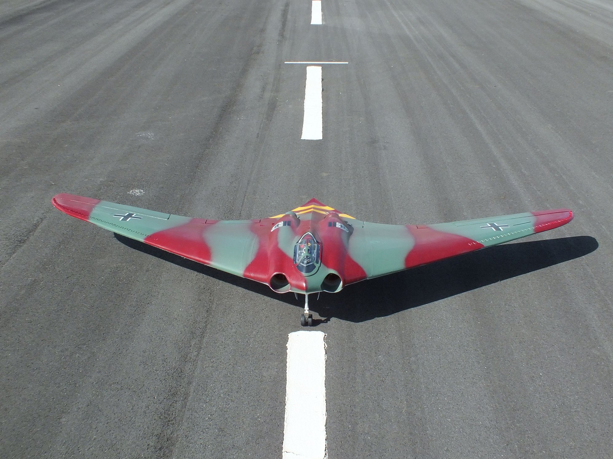

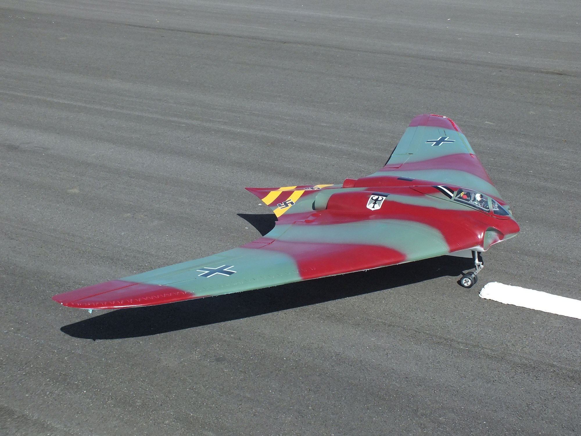

Hi I have been a fan of the Horten 229 for a long time. Recently built a RC model prepared by Gary Heathcoat. Its an 82" inch wingspan model powered by 2 counter rotating 70mm EDF's.
Maiden flight was on 2/29/2020, ddays before the lockdown in Puerto Rico. 2nd flight was recorded by a friend. The system does not permit me to post the yooutube URL.
The only thing I regret are the short 4 minute flights With 2 X 6S 6200 MAH cannot get much more. I think maybe a flew to fast and did not do much throttle management. After 4 minutes had still 42%. Maybe enough for 30 secs more.
Anyways it flew great and really picks up attention.

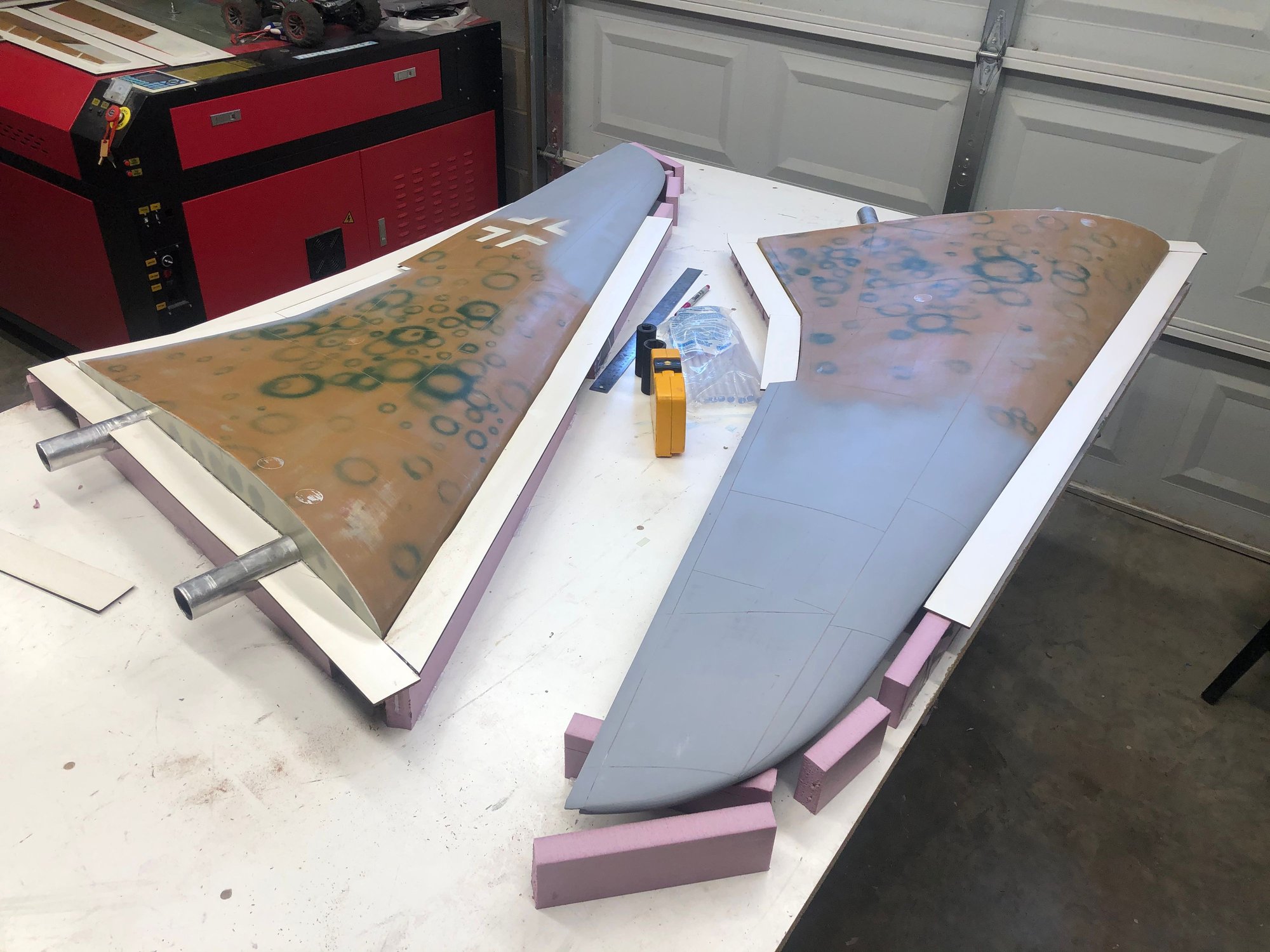

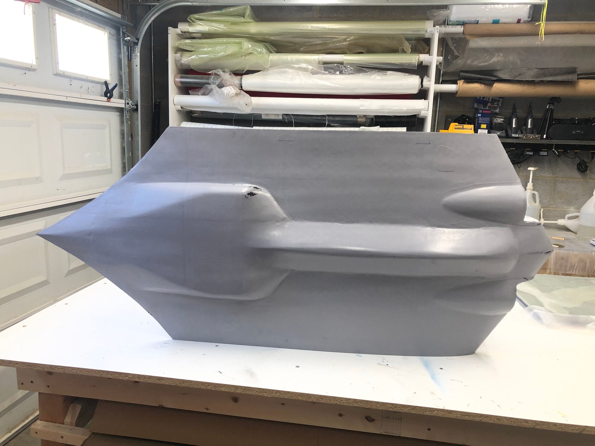

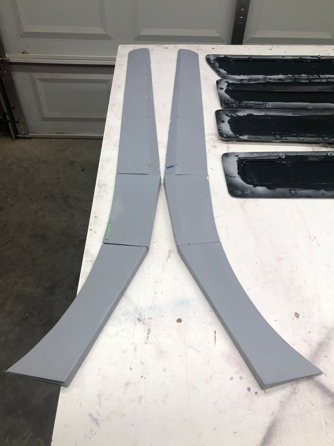

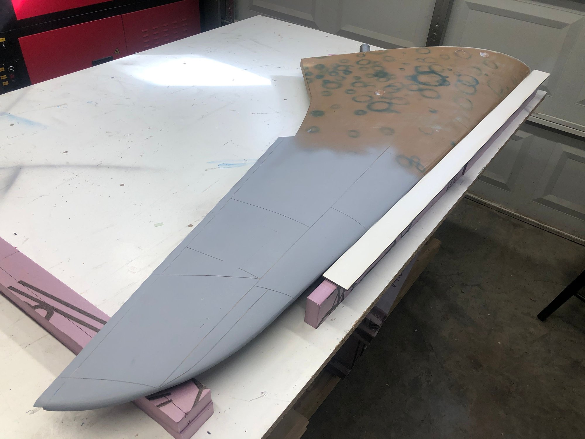

got the wing repairs done and glasses. I then rolled on a heavy layer of primer to fill in the fiberglass weave and sanded it smooth.
Then i laid out the panel lines and applied the chart pak tape. Then sprayed 2 heavy coats of primer over everything and let dry. Then the chart pak tape was removed leaving a nice crisp panel line.
A few days later i started working on the wing panel parting planes.
i also got the flight control parting planes done.
then the wing parting planes were also finished.
with everything finished and the gaps filled with clay and the wing root corners filleted with clay, everything was waxed and then the PVA was sprayed.
tomorrow begins molding day!

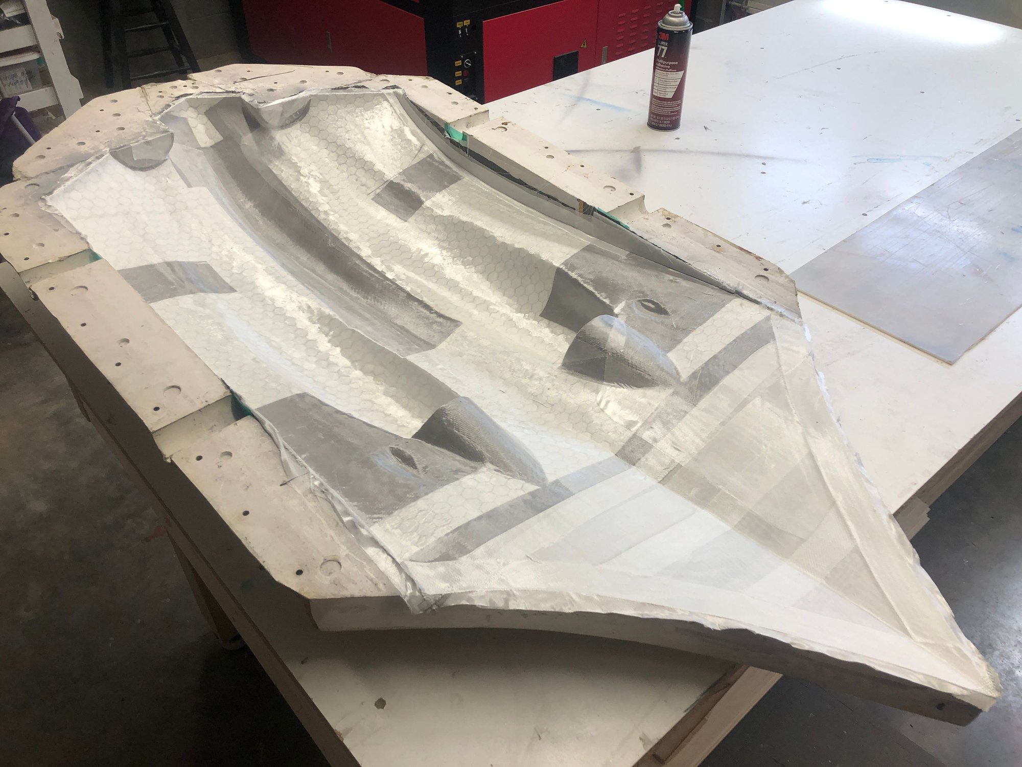

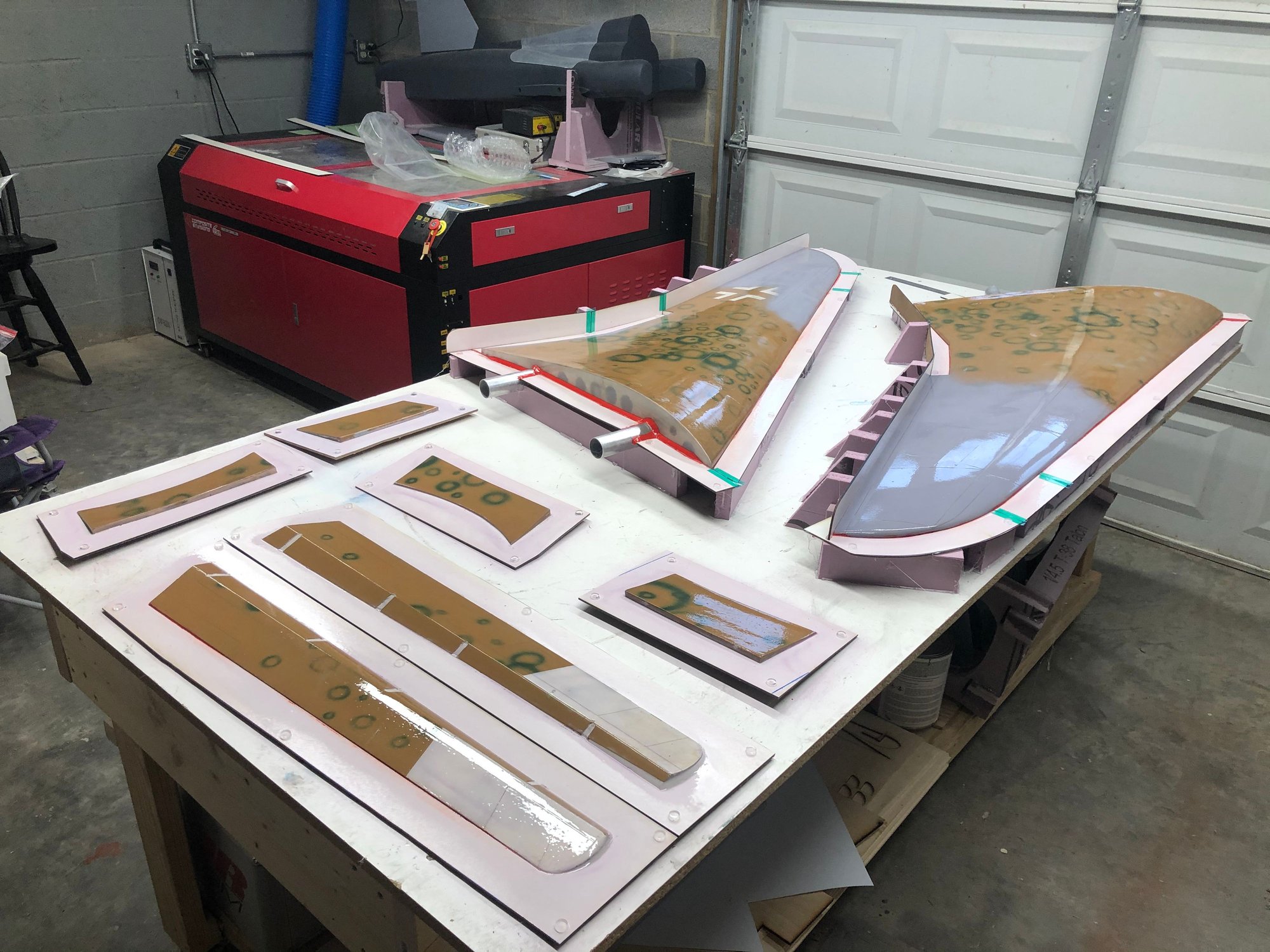

Mold halves for both wings and the flight controls are done after 9-10 hours of constant work. Luckily the wife came down about 1/2 way through with one wing panel and helped, otherwise i would still be working. Haha

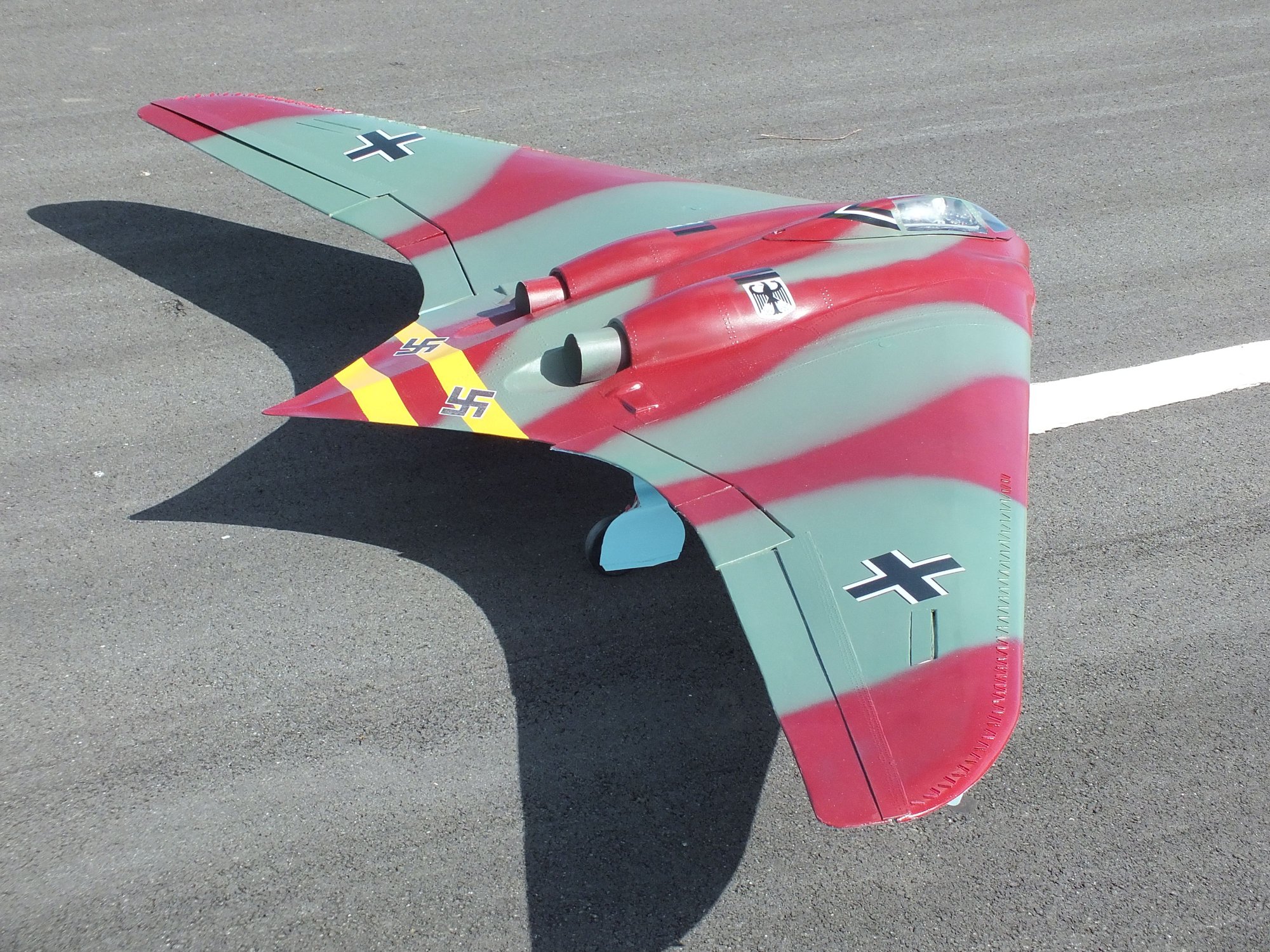

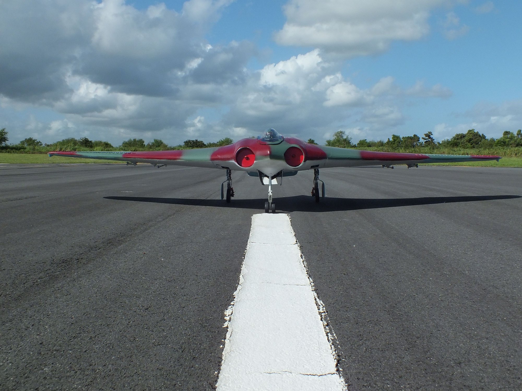

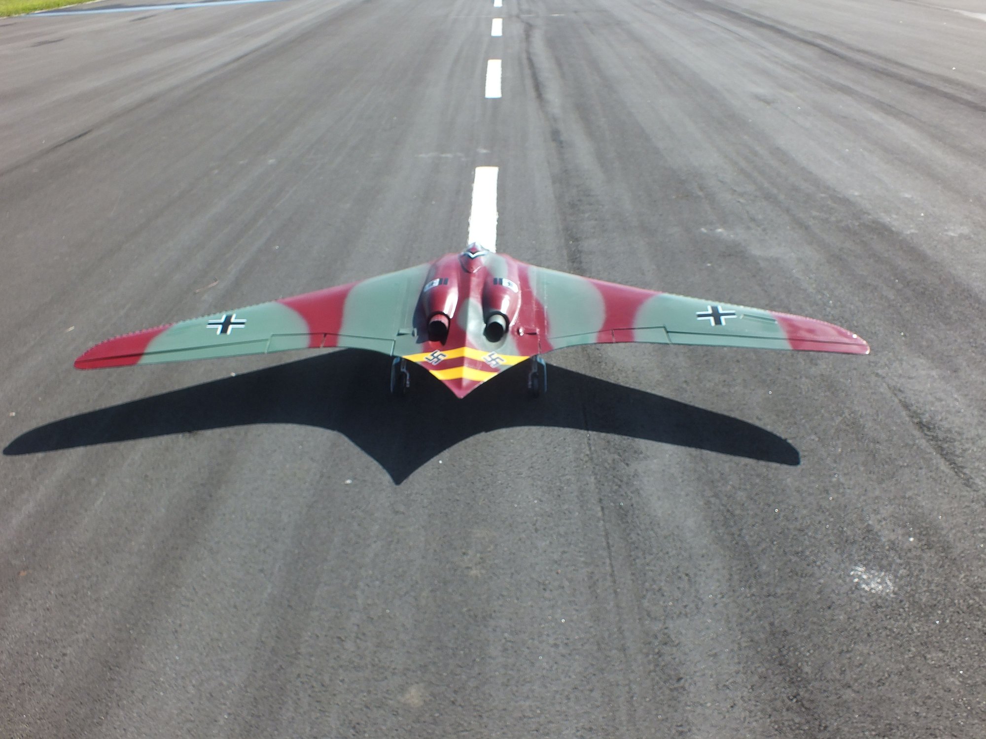

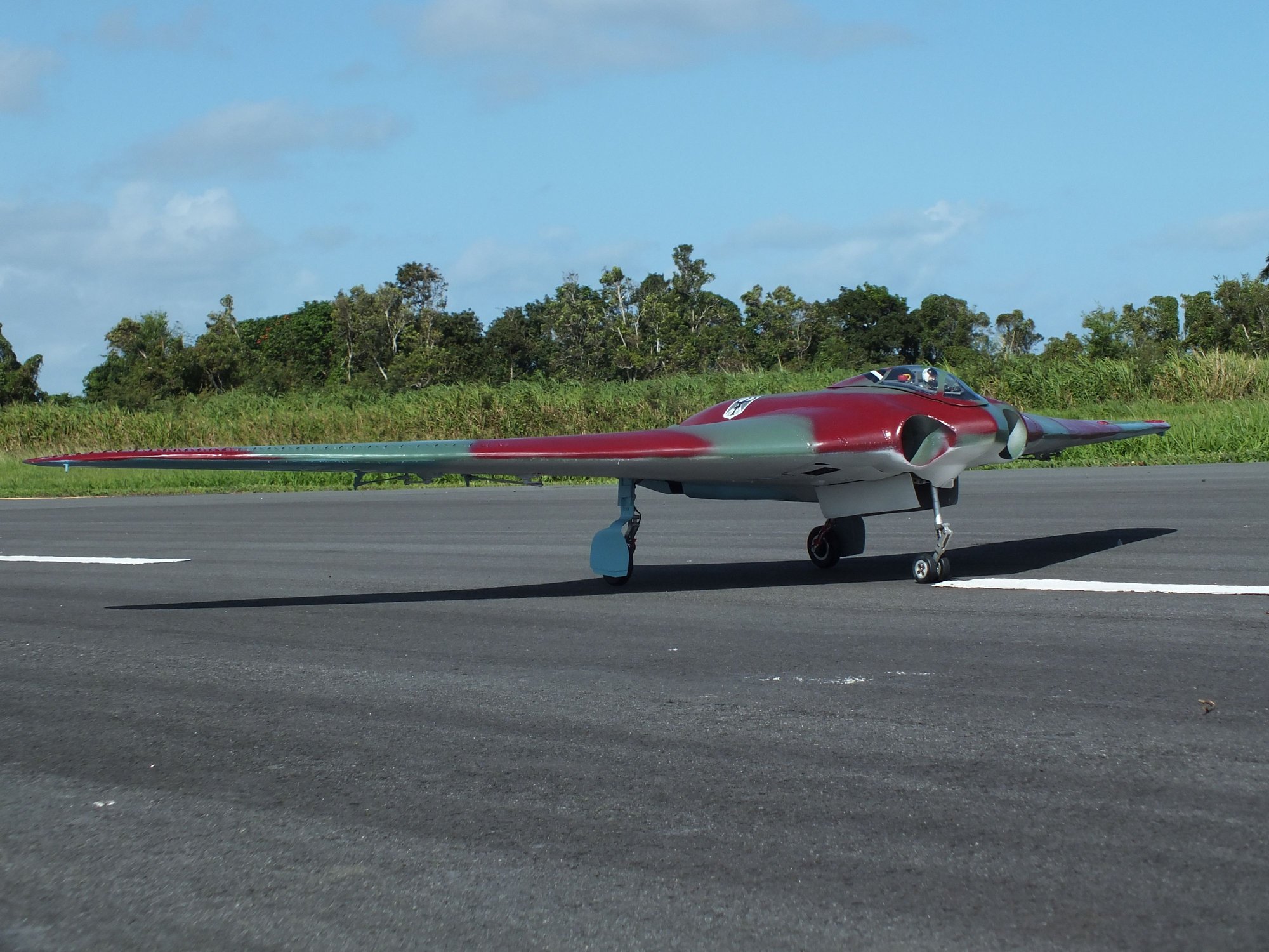

Finally able to post pictures and videos.
This my Horten 229 kit by Gary Heathcoat from California. 82" wingspan and 2 70mm EDF's.
Video of the 2nd flight
Taxing back to pit after 2nd flight
No more flights since due to Covic 19 lockdown in Puerto Rico.
Video of the operating retract sequence

the molds were pulled from the parting planes, flipped over and then the Remaining parting planes put into place. Everything was waxed and then PVA’d.
the molds were then finished.

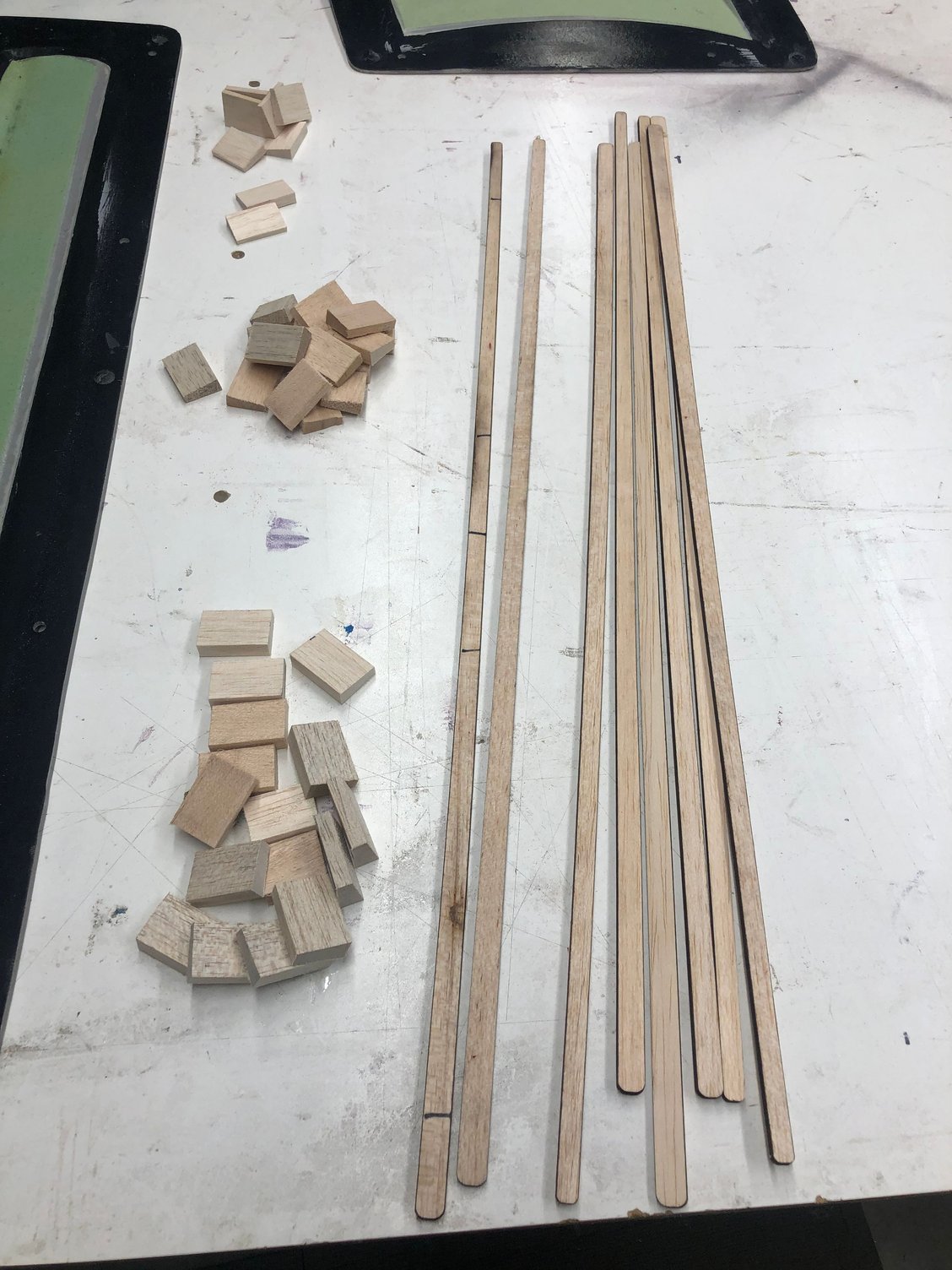

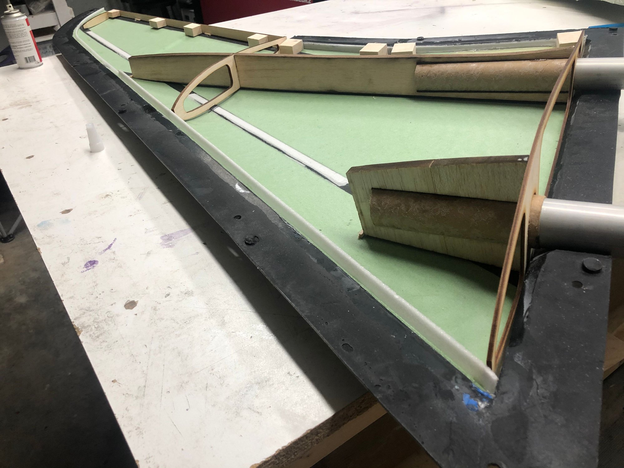

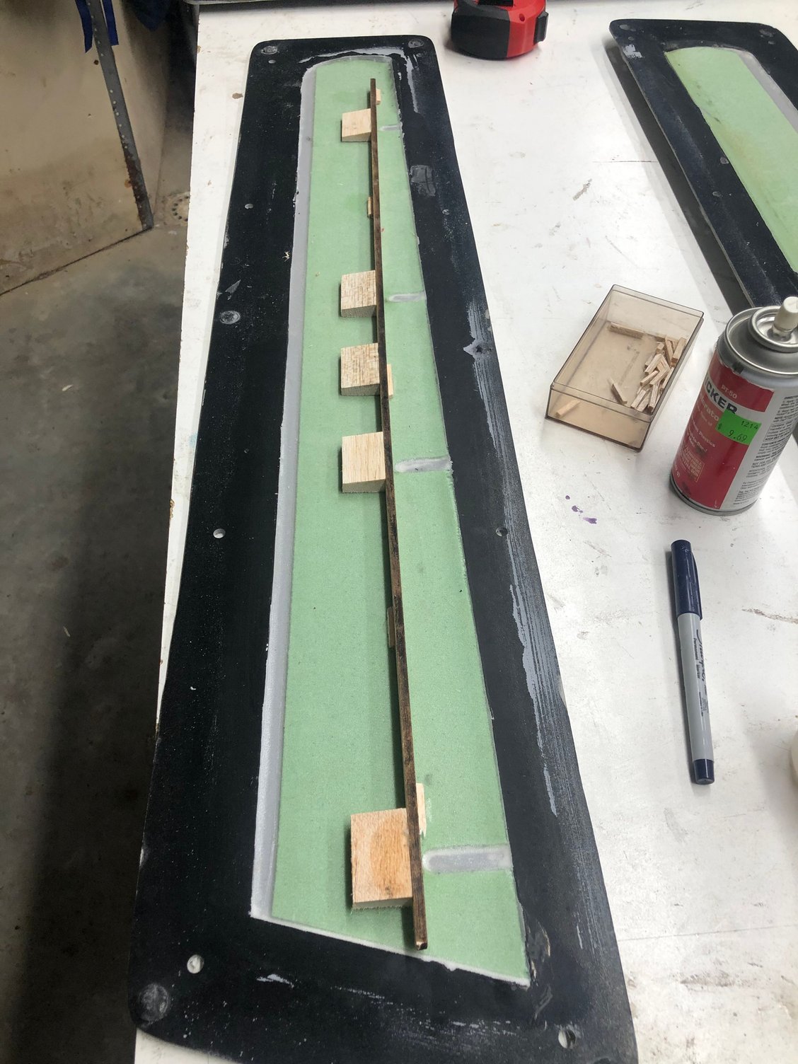

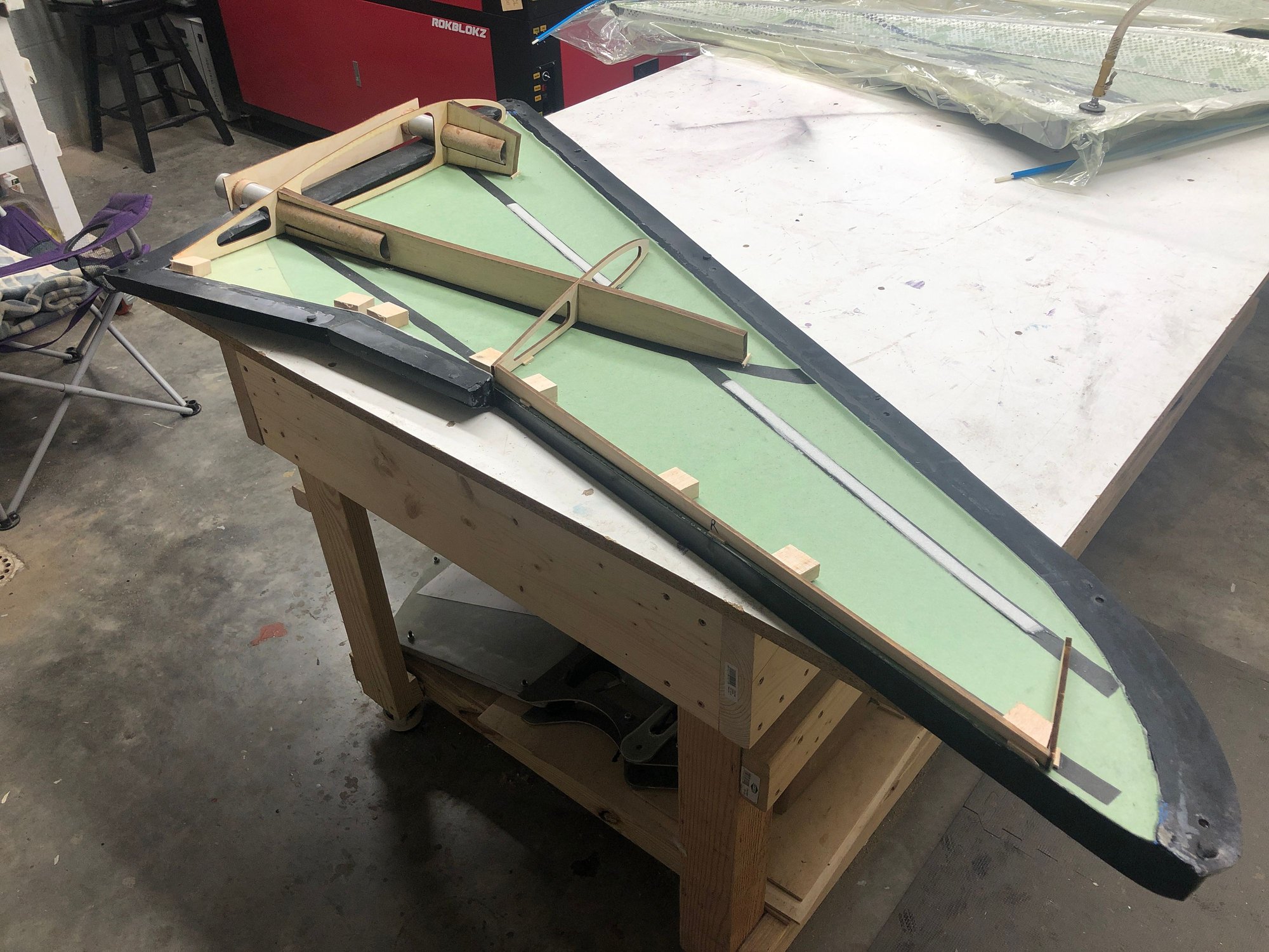

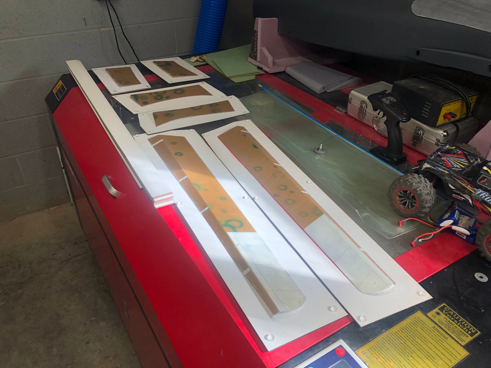

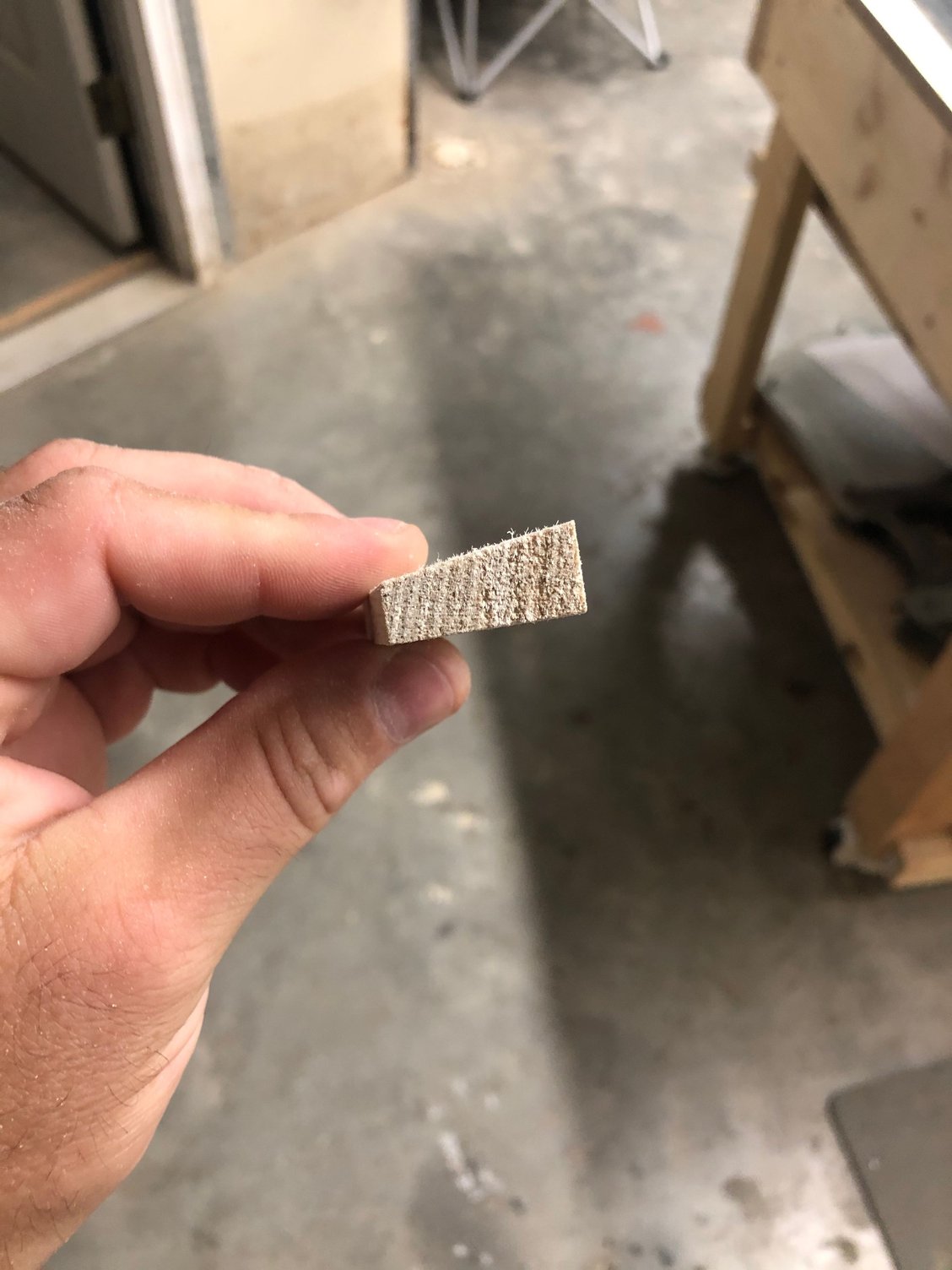

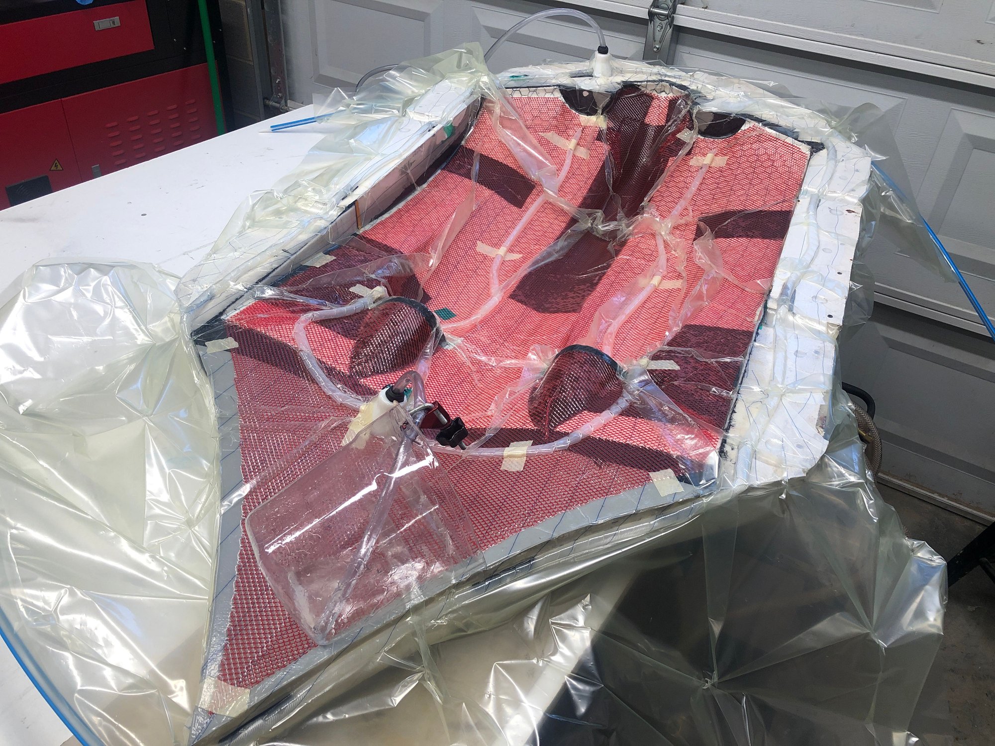

i’ve got the first set of composite wings done. Overall the weight savings is going to be about 1lb, but the biggest difference is the wingtip weight is 1.5lbs less Each with the composite wings compared to the built up ones. This is significantly less and will help reduce the need for nose weight and the overall weight of the airplane.
1/8” ply laser cut test structure
all the parts minus the 1/2” balsa main spars for 4 Hortons.
first wings ready to close up.
First wings all done and on a center section. Flight controls are still left to layup.
Wing set #2 in the vacuum bag with a couple small additions to help stiffen the wing skins in a few places.
gpman (07-08-2020)

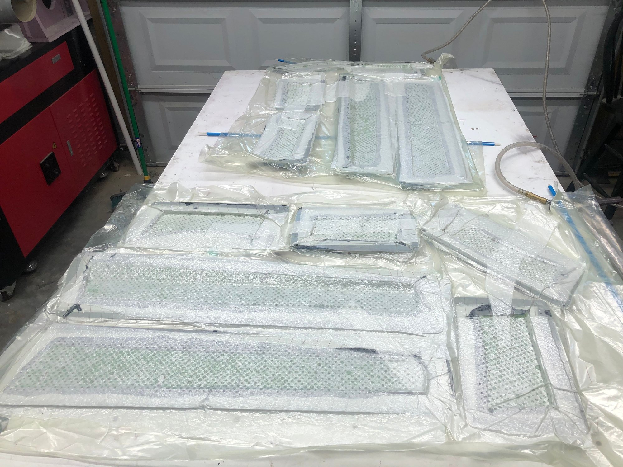

Currently there are 3 completed wing pairs and 2 1/2 sets of flight controls done. That makes 2 complete kits and the 3rd nearly there.
4 airframes worth of flight controls involve
80 pieces of Airex
144 pieces of fiberglass
48 pieces of peel ply
12 pieces of perforated plastic
48 pieces of breather cloth
That is just for the skin layups.
Them there is:
8 elevon spars
24 outer flap hinge blocks
24 inner flap hing blocks
Needless to say, it was a pretty involved few days to get everything cut out to make this process go quicker.
