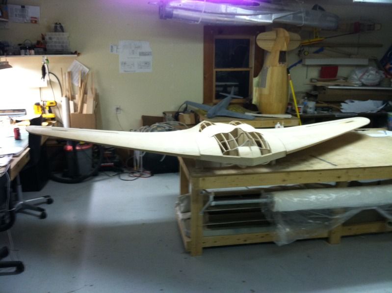

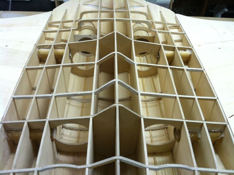

Now THIS is what I am talkin about.. this is why a I enjoy building so much... you take a bunch of wood scraps and make something AWESOME out of it... ok, not scraps, but you get what I'm sayin
First up was taking a sanding block and running across the leading edge ribs to true them all up with each other. Then a 3/16" false leading edge was installed. Then it was time for sheeting this center section...

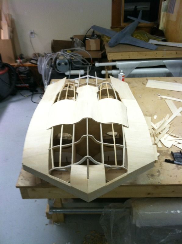

So some 1/8"x6"x48" sheet balsa was ripped down to 8- 6" square pieces, then these were installed along the tip rib edges just like the smaller version. from about 3/4 way back on the engine nacelle, the sheeting was done in a long strip.
Then the spine and top center of the engine nacelle's were sheeted:
Then the rest of the bat-tail was sheeted. I've got to make the cutouts and install the exhaust duct portion's now and it also has been left oversize.
Then the right wing had its 1/4" leading edge installed and rough shaped and its wingtip installed and rough shaped. The wings were then put on to make sure they matched up with the center section once sheeted.
Then I got the right rear nacelle section strip planked:

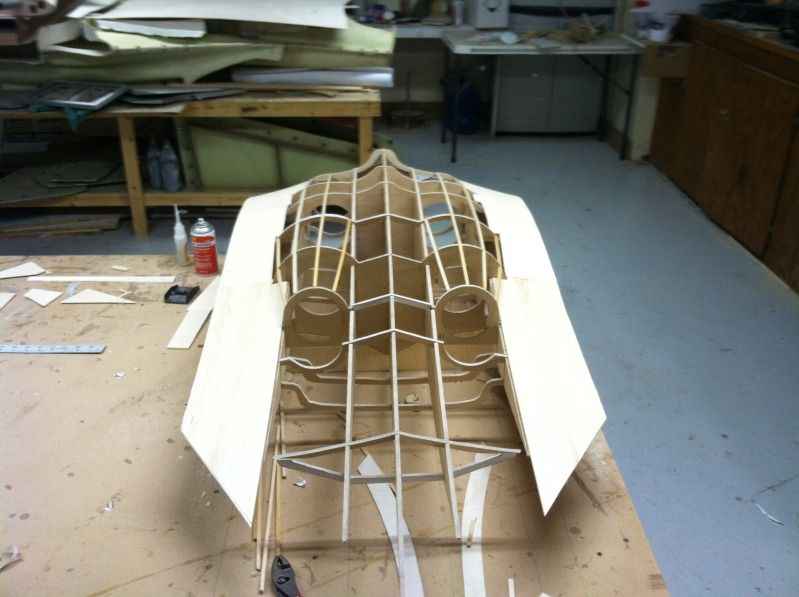

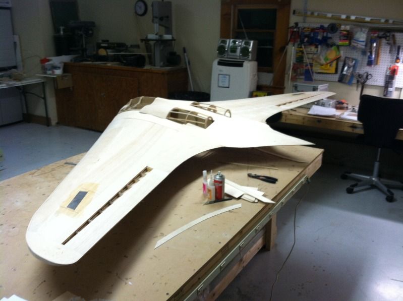

Got a bit done while the little man was taking his nap...

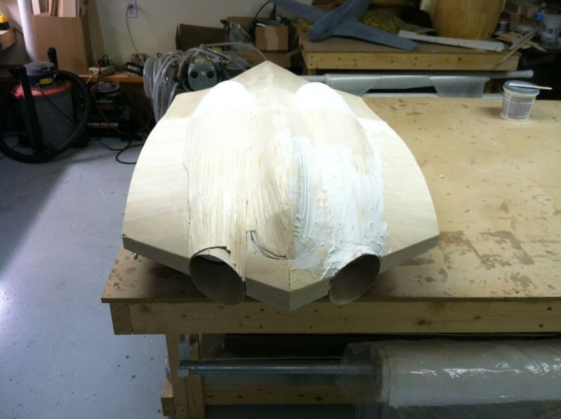

Got both rear nacelle's strip planked and filler applied:
Then got the inlet ducts cut, installed and sanded to the same taper as the LE. now I can start strip planking the front portions.

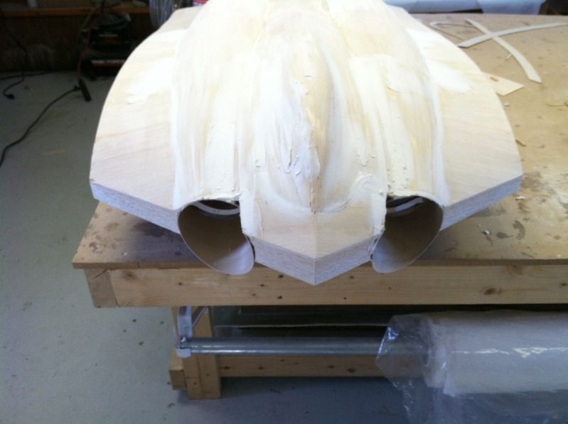

Last bit done for the evening...

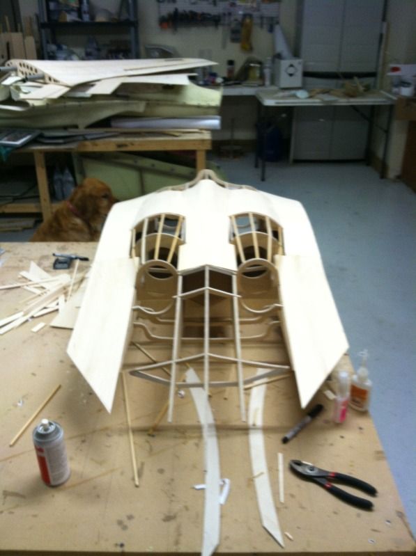

Strip planked the left side of the cockpit and forward engine nacelle's, and put a butter coat of wood filler on it:
Then started on the right side:

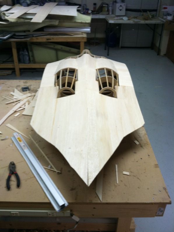

Then finished the right side the same as the left:
A shot from the front:
Then installed the exhaust fairings:
Then put it all back together...

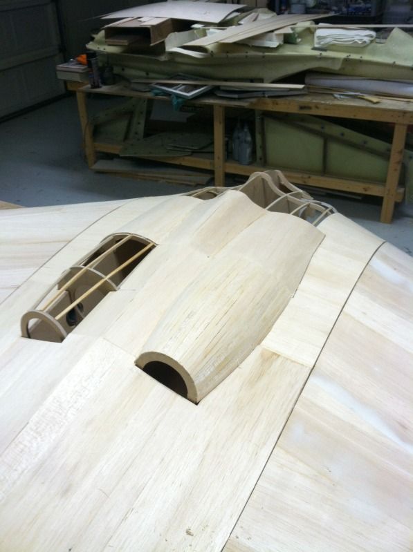

But I did do the first round of sanding of filler on the top of the fuse, then put the 2nd round of filler on. Also did the prelim trimming of the inlets, still more work to do to those.
Then enlarged the wing tube holes in the junction rib so the wing tube sockets would fit through, then flopped the whole thing over, aligned the wing panels and epoxied the wing tube sockets in place. all to do now, is to let it cure overnight, cut the outer wing panels free, trim the trailing edges and then start sheeting/planking the bottom. I figure i'll be pretty close to done building wise by the end of tomorrow, so when I return, I can finish the last bit of shaping/sanding and then start glassing everything.
