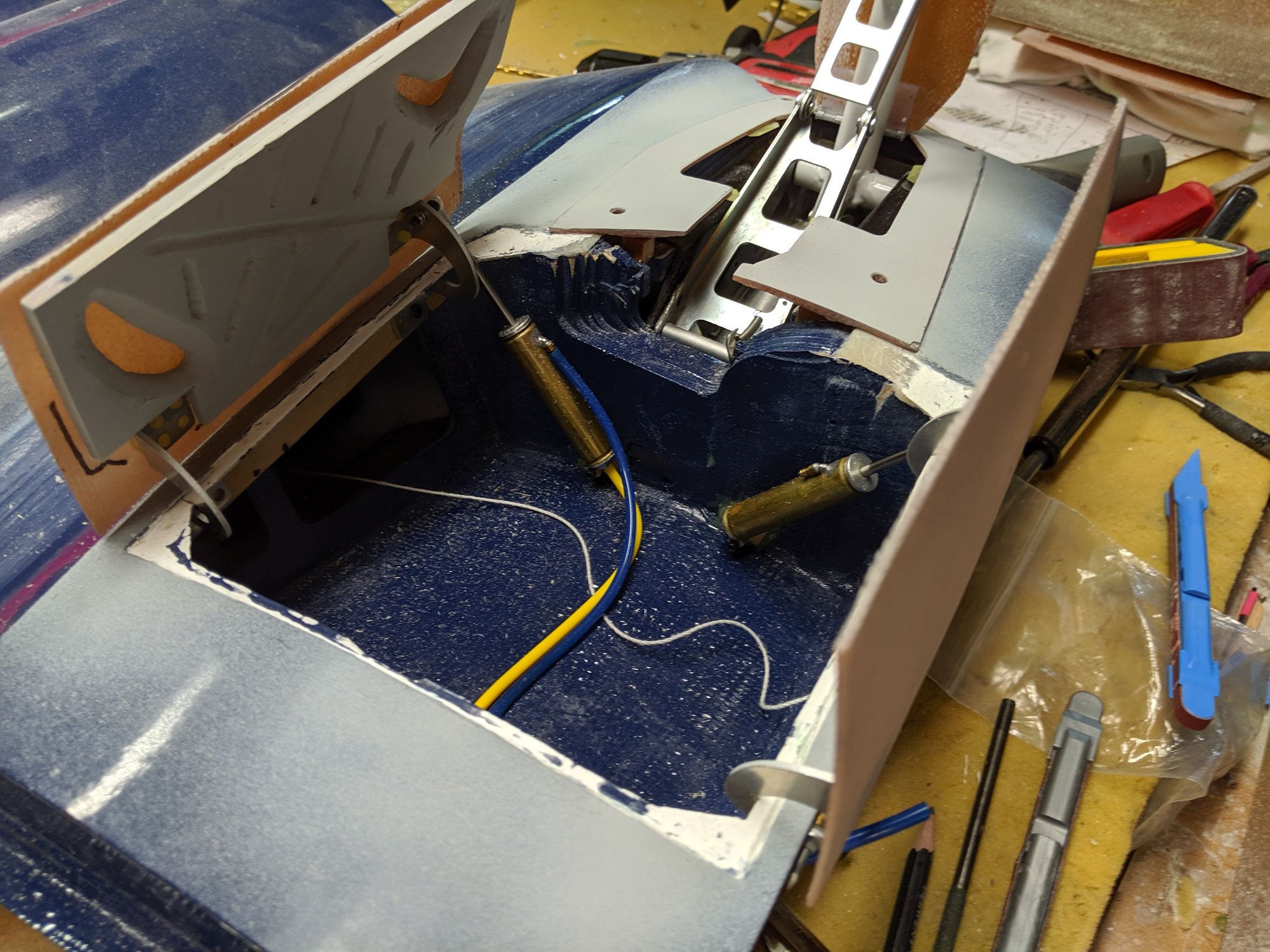

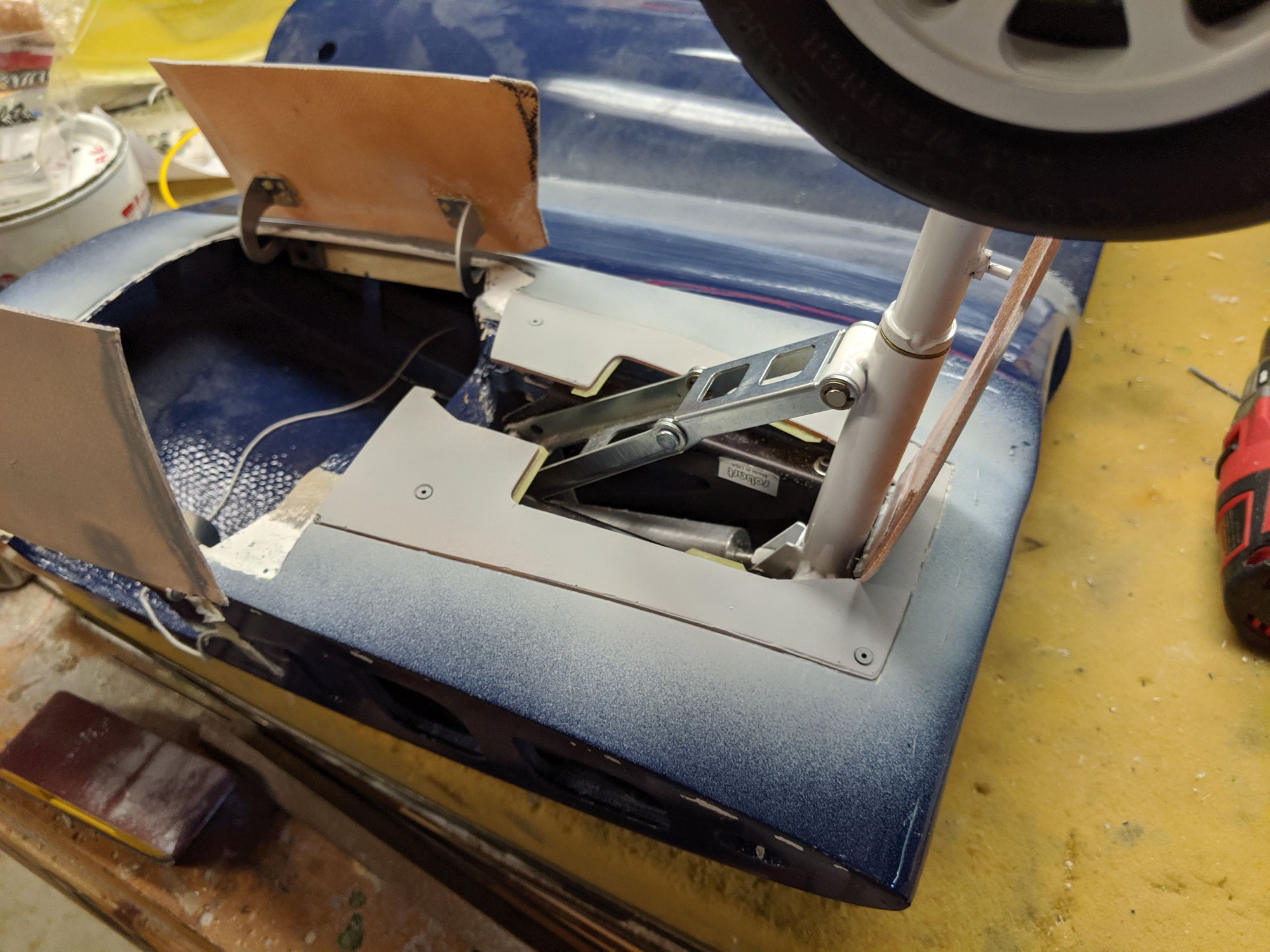

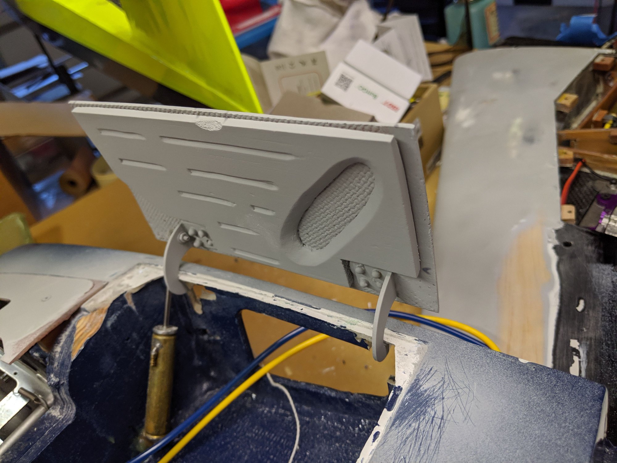

I did some quick and dirty inner door panel but I got the cylinders working. I hate electric gear but I hate servos on gear doors even more

Looks good Matt. Balsa door liners?

Nailed it!
How did you make them?

Thanks guys, just some 3/16 balsa. I don't like the weave showing through, I think I will use some typing paper just to cover it up, that will probably look scale after the paper gets wonky

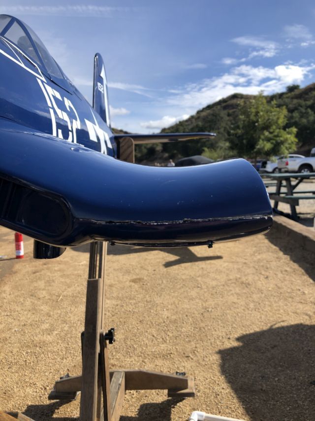

I went to fly mine last weekend and noticed that the left leading edge of the wing center section was starting to split. Has anyone else heard of this happening?
I need to do a few paint touch ups, anyone know of a gloss blue paint that closely matches this model?
my first one did that. I suspect it was from a hard landing. I wicked some ca in the crack and a little touch up paint it was fine.

Todd D - Others at my field thought the crack could be from a hard landing, or maybe a high stress maneuver, or the retract putting stress on the wing.
I haven't had what I would call a hard landing so not sure. I have removed the left landing gear and plan on applying some 30 min epoxy mixed with some shredded fiberglass from the inside in that area. The rest will have to be done the best I can from the outside.

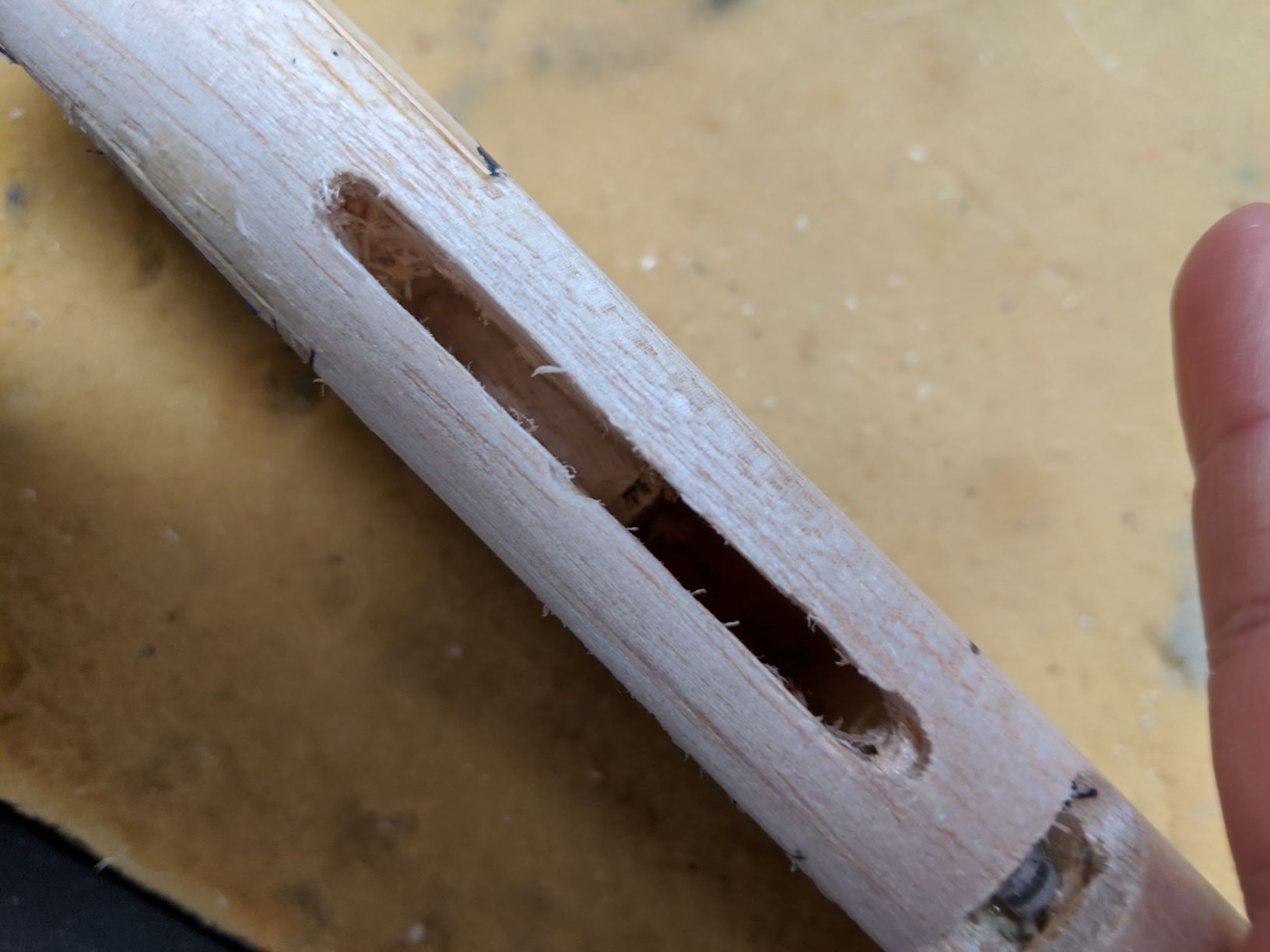

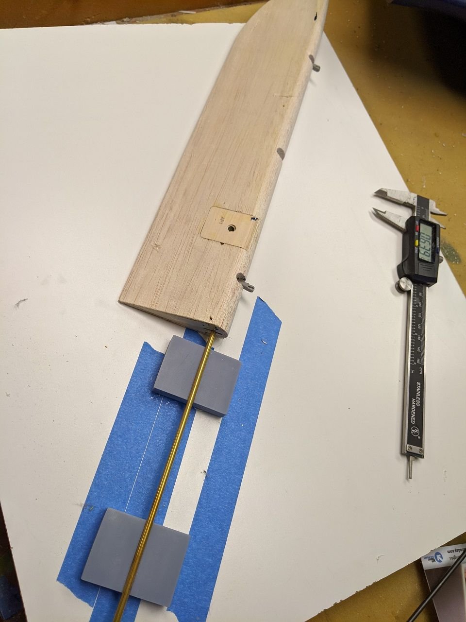

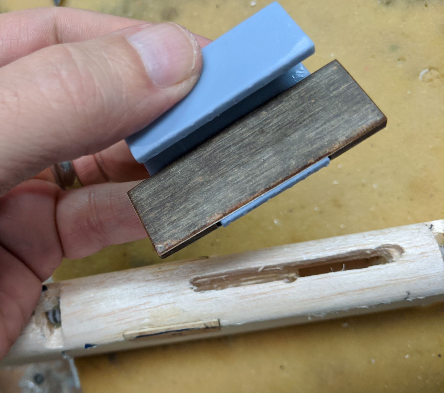

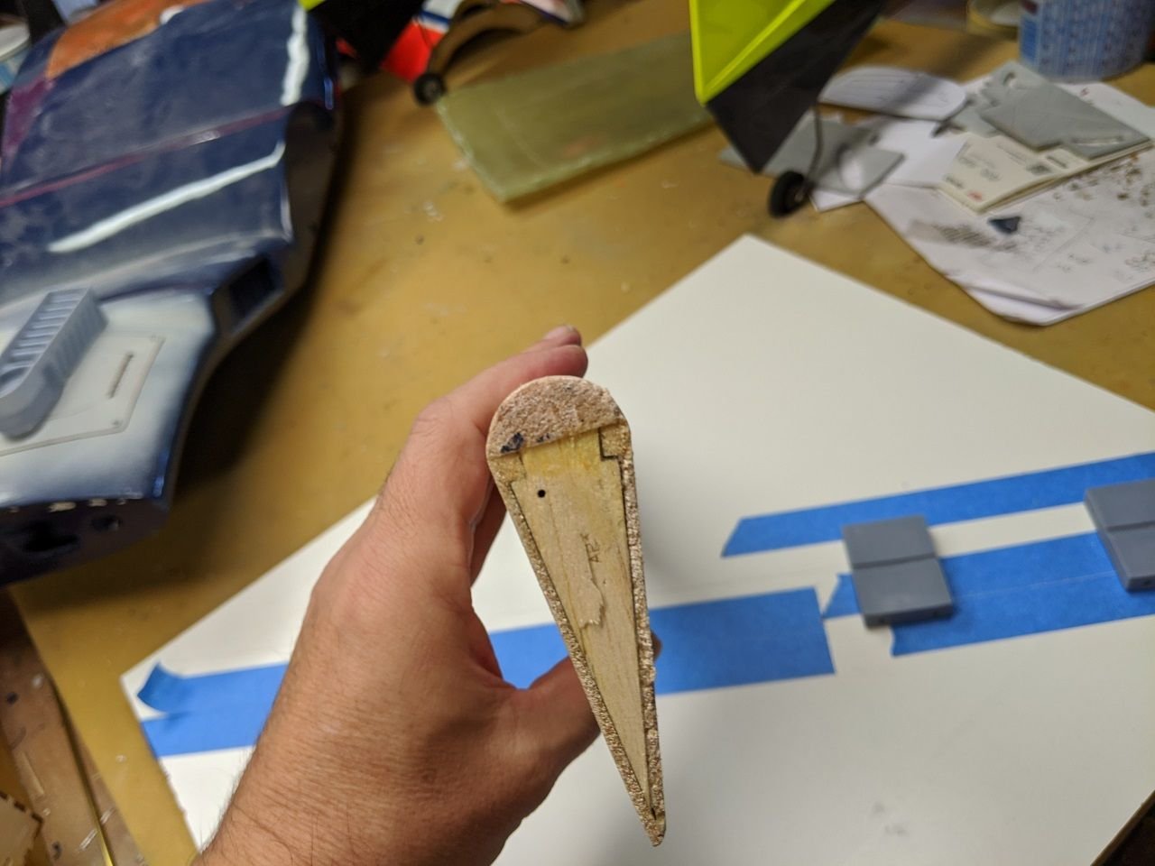

Since the only exposed linkages on the model are for the ailerons, I thought I would change those to RDS. I also like to make surfaces removable when I can, and that is especially important on RDS installs.
I start by finding the point where the surface will pivot, generally right at the center of the radius of the round surface "nose". I then glue the surface down in front of a couple of engineered blocks (3d printed) that guide a long brass drill down hinge line. Not easy
The hinges are just mocked into place to measure the height of the hinge opening over the reference surface, just to make sure the brass tube is exactly inline with that hinge axis.
Old 02-07-2020, 06:03 PM
  #2711
mr_matt
My Feedback: (10)
mr_matt's Avatar
Join Date: Dec 2001
Location: Oak Park, CA,
Posts: 10,360
The 0.055" music wire pin now goes through the center of the hinge line.

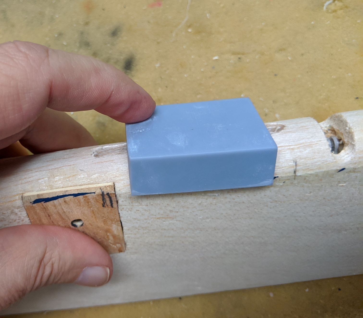

I made a small jig to align the hinges and se the correct depth while the glue cures on one side

I then printed another jig to hold the surface vertically to route out the RDS hinge pocket (no ugly horns/linkages sticking out)

This routed pocket goes deep into the surface. Typically, gluing in this pocket is hell, but here I printed a little jig that centers the formica RDS pocket and holds it at the correct depth. This also keeps the formica slot cleared of glue. Super important to keep the glue out of the pocket.
