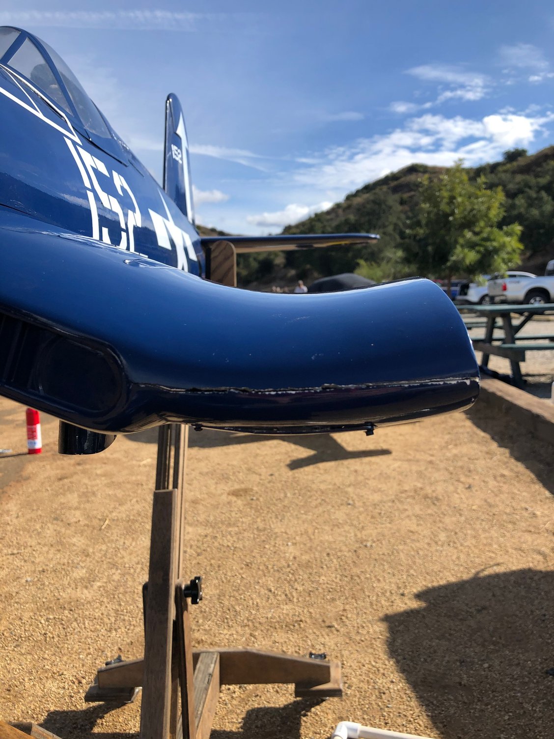

The only problem I have had with this plane is the center wing section. One day I noticed the leading edge was cracking and starting to split. I have been told that this has happened to others. So I highly recommend reinforcing the leasing edge with resin filled with fiberglass shavings before its too late. The other problem I had was one of the mains ripped out after landing from turning the aircraft. Seems the gear is mounted to heavy duty wood blocks but these blocks are held in by 1/8" ribs. I would recommend reinforcing this area too!

i have 2 nib corsairs and the first one I ordered over 5 years ago has terrible quality in the center section. The other is fine. I will modify the bad one with wood and carbon fiber and dowel rods that go through the center spar. I didnít know what I was looking for back then when I received it or I would have sent it back. Iím glad I waited. Iím certain it would have failed.

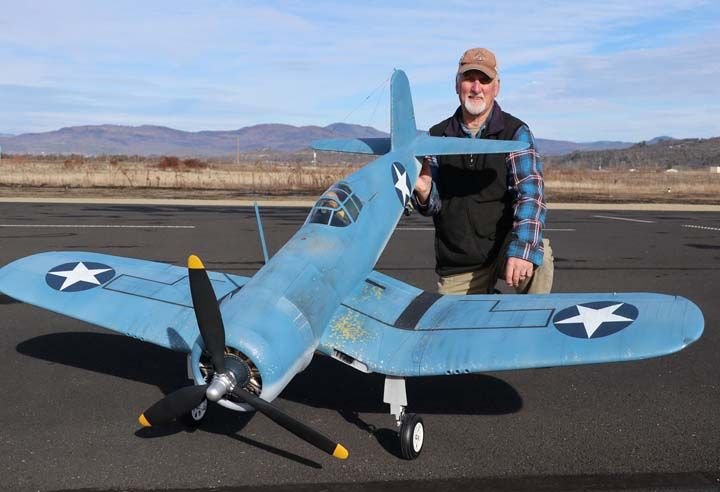

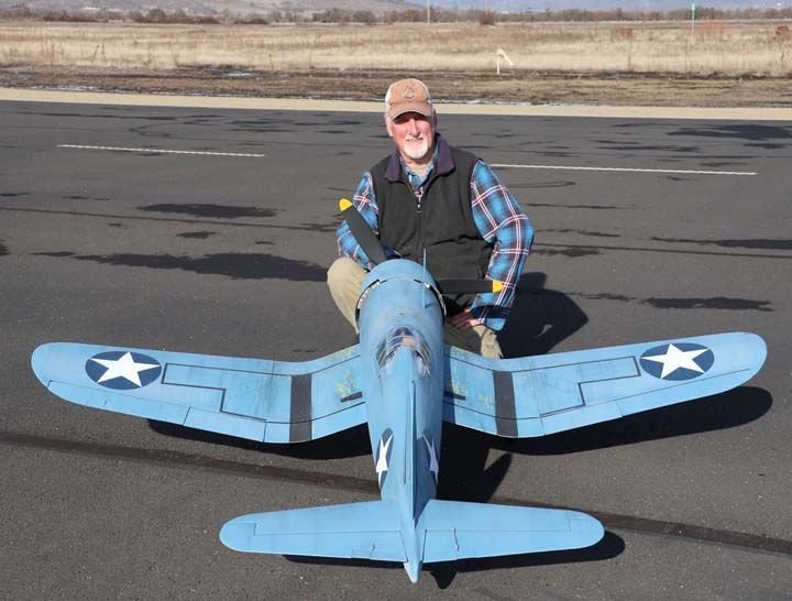

Well it only took me 5 years , on and off, to get my Corsair bashed to the earlier Birdcage version F4U-1.
Stripped own and fiber glassed, vacuum formed my own sliding canopy and framework, Covered the open wing bays with Solartex and wooden battens like the earlier version.
Painted with Behr Outdoor Latex, lots of weathering. Running Zenoah G-62 for the next year and then hopefully upgrading to the Saito FG-90 ( when my ship comes in ...lol )
Any tips on take off and landing this beast... Flaps on take off ? Full flaps on landing? are the gear doors holding up well with flimsy hinges from Sonic-Tronics? ...etc.
Maiden in a few months.
Any flight and landing info. is appreciated !
Thanks, Eric

Old 01-02-2021, 06:05 AM
  #2747
BarracudaHockey
My Feedback: (11)
BarracudaHockey's Avatar
Join Date: Jul 2003
Location: Jacksonville, FL
Posts: 24,581
Received 84 Likes on 69 Posts
Very nice!
No flaps on take off. Slow application of power and let it pick up sufficient flying speed, don't pull it off the runway with elevator, it should lift off when its ready.
Landing with full flaps, on the mains, you will need plenty of power on final to overcome the drag of the large flaps and front gear doors, let it settle on the mains and cut power and let it slow down to nearly a full stop before you try to turn it.
It gets a nice groove on approach with the right power setting.

Looks fantastic. I have a second one still in the box that I plan to strip and glass as well but there are two things that I feel need modification first. I'm reinforcing the leading edge of the center wing panel as it will crack and split. I'm also going to reinforce the main gear landing mounts. The rails are heavy duty wood but are attached to thin balsa ribs. Guess which gives. I recommend you make these mods before you fly it if you haven't already. I bought my first Corsair pre-built without gear doors. The builder said he kept burning out the servos. I never bothered to put them in myself on this plane so I have no advice there. My current Corsair has electric retracts and I have had problems with them especially the tail. I'm going to put in pneumatic retracts in the second bird. I have the Saito FG90 in mine and it is always a crowd pleaser. Good luck you will enjoy it.
Old 01-04-2021, 06:42 AM
  #2749
paladin
Join Date: Feb 2002
Location: Vestal, NY
Posts: 2,900
G-62 and that plane were made for each other.
that variant had bomb mounts, when loaded with them it would use flaps. while on std load (carrying no bombs) it would not use flaps. it also had wing tanks which would only be filled on long distance missions and it might use flaps if they are full, but I cant tell if the wing tanks are full or not from picks.
as for the model I always takeoff with no flap assist but that is because of me not the model. I forget they are down, retrim, then realize what I did when prepping for landing.
landing - it does not need them (flaps). I used full flap and a lot of throttle. best to go down and dirty and fly around a while (Traffic patterns) to find the right throttle setting for you. mine needed no extra e hold when flaps were down so if the throttle is correct it will tool around with the same E hold you would have with that throttle setting clean. in wind I could do steep dives to final.
it needs rudder co-ordination, in cross wind at scale speeds it will wag its tail. I put a gyro in mine to stop that but did not like it and removed it. full tilt w g-62 no wagging.
it flys like a trainer with lots of side area, till it reminds you its not.
good luck! its a lot of fun
Joe

Hi Eric,
If you are referring to the main doors, those are just heavy duty robart hinges. Tower sells them. They are fine but I modify them to make the doors easier to remove. If you meant the tail doors, those hinges that I 3d printed (not scale, I used offset hinges)
Your plane is beautiful, especially the -1 canopy. How did yours balance? I flew mine in primer, I always do that. No nose weight, but it needed 2.5 ounces of tail weight (!) to balance, so hopefully after I paint it it wont take too much nose weight to balance.
I would say not too much expo on the rudder, you need to use the rudder quite a bit and if you get the expo wrong, it does not feel that natural in yaw response. THis is just from 2 flights. It did not need any other trim, even with that mess of flaps (I modified those too, to make all of the flaps removable for painting and maintenance)
