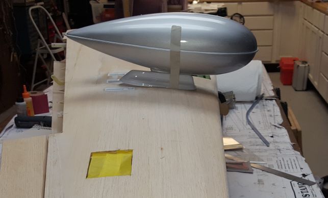

Default Drop Tanks 75 Gallon
I'm trying to locate the drop tanks fore and aft. I need a dimension for 1/5 scale, preferably the distance from the tip of the tank to the leading edge. I can't find reliable location dimensions anywhere. I tried measuring 1/32 scale and not good enough. Anybody have a good reliable dimension I could use?

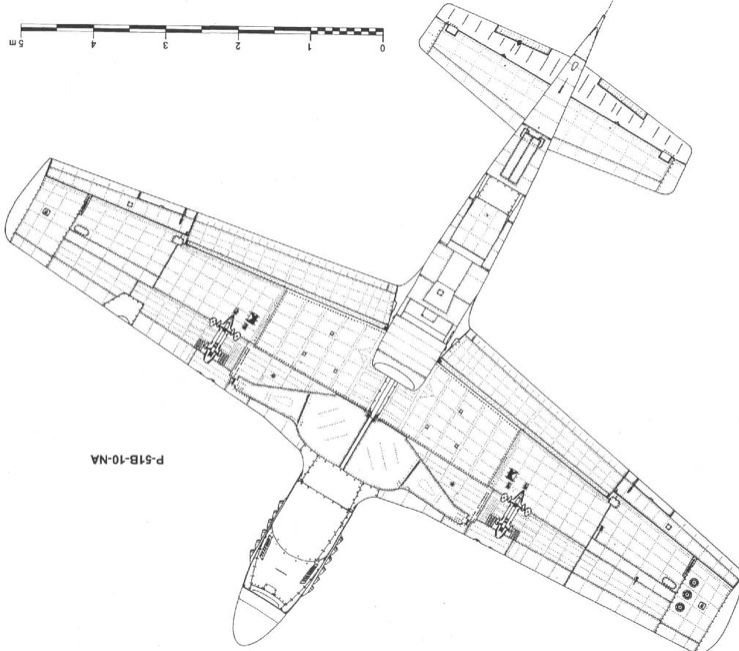

I used this drawing to locate pylon locations, its not great but it is on scale, I used my retract housing as a reference point, I’ll keep looking at ref material and see if I have anything better for ya

Thanks Wyoturbine, for a 1/5 scale kit, using the leading edge as a datum, a guy gave me these dimensions. The pylon was 40 mm back, (1.57 in.) and the tank tip was forward 67 mm (2.63 in.) I could not find any dimensions on the net and I'm hoping the kit designer was correct. I was surprised to find nothing.
