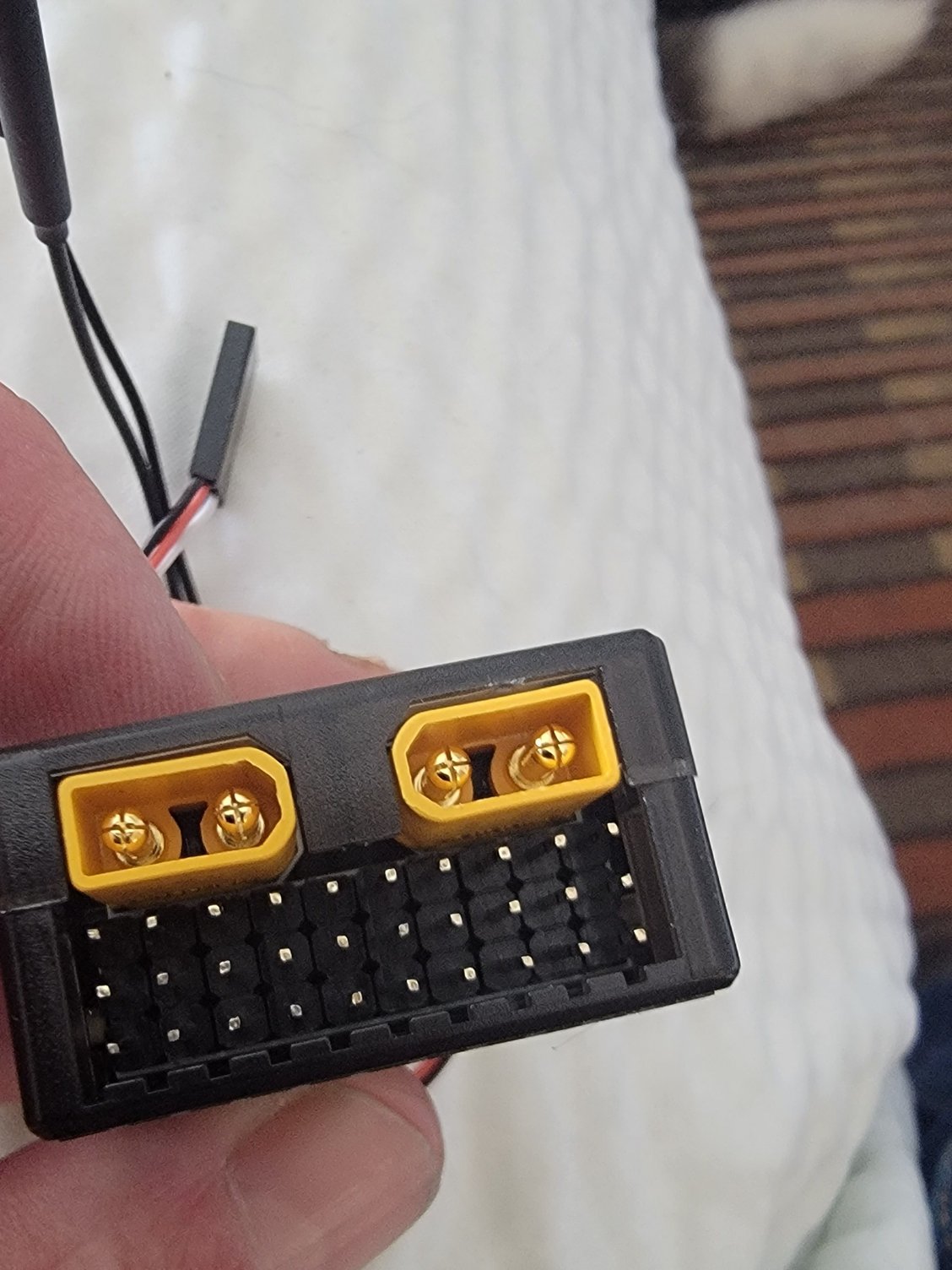

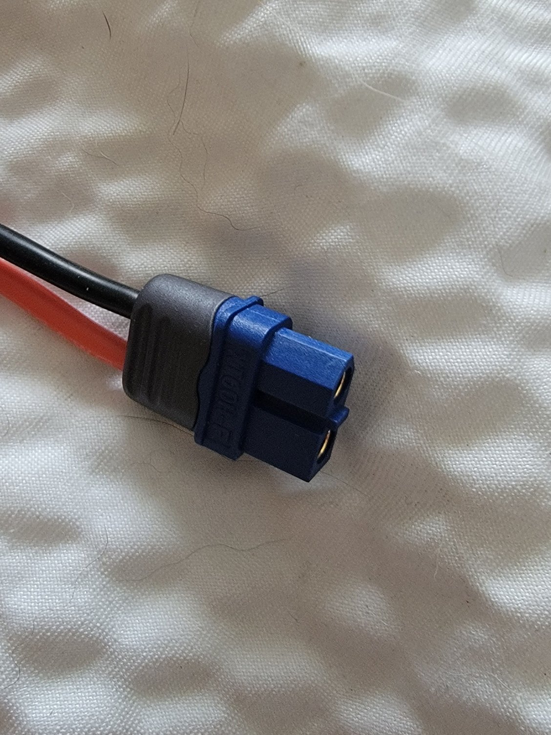

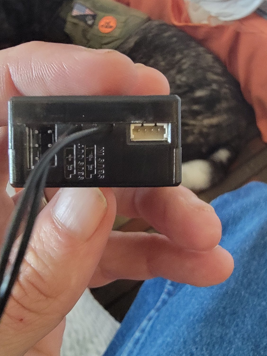

Ok, guys. I need some help. I built my last plane some 10 years ago. Was flying it up till I sold it 8 years ago. A lot has changed.
I need a reciever power switch to go from battery(blue plug) to my Archer SR10 reciever (yellow plug) I think..or am I thinking wrong?
The battery also has two JR style plugs and the white balance charge plug.
As far as using a channel/servo plug on reciever, those are spoken for between servos and telemetry.
What do I need to make the connection? The two slots to the right of the white plug in on reciever are the Sbus in/out.
Old 12-03-2021, 03:39 PM
  #1146
Txmustangflyer
Join Date: Nov 2021
Location: Boerne TX
Posts: 297
Received 10 Likes on 9 Posts
Ok..thanks to some serious tech support from aloft...this clunkers now knows how to hook up the new fangled gadgets to the new fangled reciever...and this klunkhead has managed to muddle his way through setting up his new fangled computerized radio gadget for the new plane...
