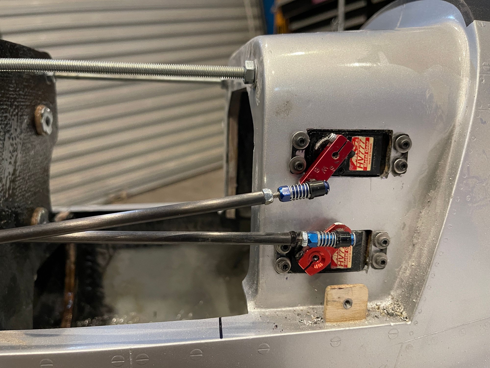

The hanger 9 wing fitment issues many have had don't seem to be an issue with mine. They are tight, but the do slide home with some see sawing the final few inches. Just gonna be a bit of sanding of the inner ribs to make it just a bit easier in and off. Right now takes a wedge and a decent bit of force to get the tabs free so I can see saw them back off. They line up decent, everything lined up with center wing at a glance.
Horizontal stabs slide on and off no issues at all also no play. Pleased with those.
One issue I ran into, the factory runs thread for pulling servo extensions. Theres a channel in the wing where its SUPPOSED to be. The nimrod that built up the right wing decided to run it through the fiberglass for the wing tube. (Facepalm) so that one is going to take some finagling and contortions to get routed for the aileron and lighting.
The included cockpit, though not bad, is just not good enough. The cockpit seat, just from handling it briefly has cracked already. Gave a shout to Jiri to resolve that for me. New cockpit (complete) is in the works and should go in with some minor trim work. Started on getting the canopy rail to slide properly..pin is hanging in the track not exactly sure how to get in there to sand the track a bit..still thinking on that one.
He still has to paint, but Jiri works fast.
Wings good out of the box, but tight.
Cig pack to show scale..this lady is big Still some ironing to do on the rudder but had to pause that..back was killing me.
