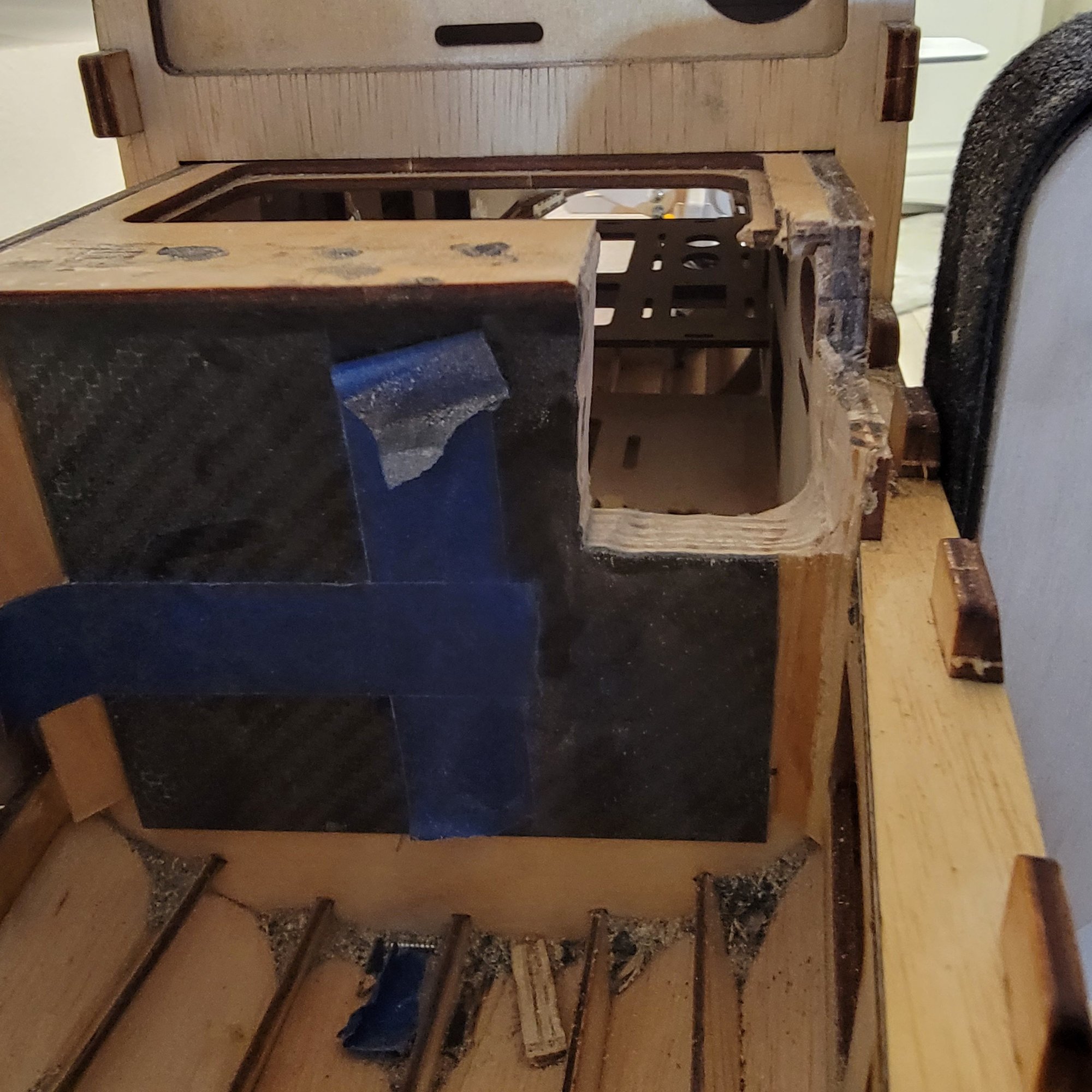

Lots of progress where I can on my mustang. Due to a bit of boneheadedness on my part, getting the retracts set up had to be put on a bit of a hold. I fried the eflite programner cuz I grabbed the wrong battery. Ordered a new, better, setup from dreamworks rc to control the retracts.
So, instead of continuing with retracts, gear door servos and installing the gear doors, I tackled the firewall midification that I had been dreading to get the zenoah to fit like a glove. I'm sure I'll need to make some minor adjustments to get it just right, but, for the most part, other than some final shaping of the air opening, and sealing the engine bay with Klass Kote its pretty much done.
I first sheathed both sides of the firewall with preformed cf plate at 1/16th inch thickness each, increasing the firewall's laminated strength. I then cut the notch out to clear the carburetor...that took most of an afternoon just getting that out. The firewall, pre cf, was 1/2 inch thick layup if 4 1/8th hardwood ply sheets. It did not go quietly. I dulled two 2.5 inch rotary wood saw blades getting it cut out, plus a 3/4 inch making the smaller cuts.
structure built back using cf plate gussets, and 1/8th ply. Back wall of the notch is a two piece lamination of 1/8th ply. After epoxy had set for 24 hrs, I applied approximately 30 pounds of force in direction of thrust...no movement at all. Even the ply bottom if the engine box that had some flex with access panel removed has zero flex now. Its not super pretty but cosmetics aren't important. Its strong and it does the job. Once firewall is drilled for engine mounting, its all getting sealed with Klass Kote 2 part epoxy zinc oxide color paint. It will be sealed up tight and fuel proof.

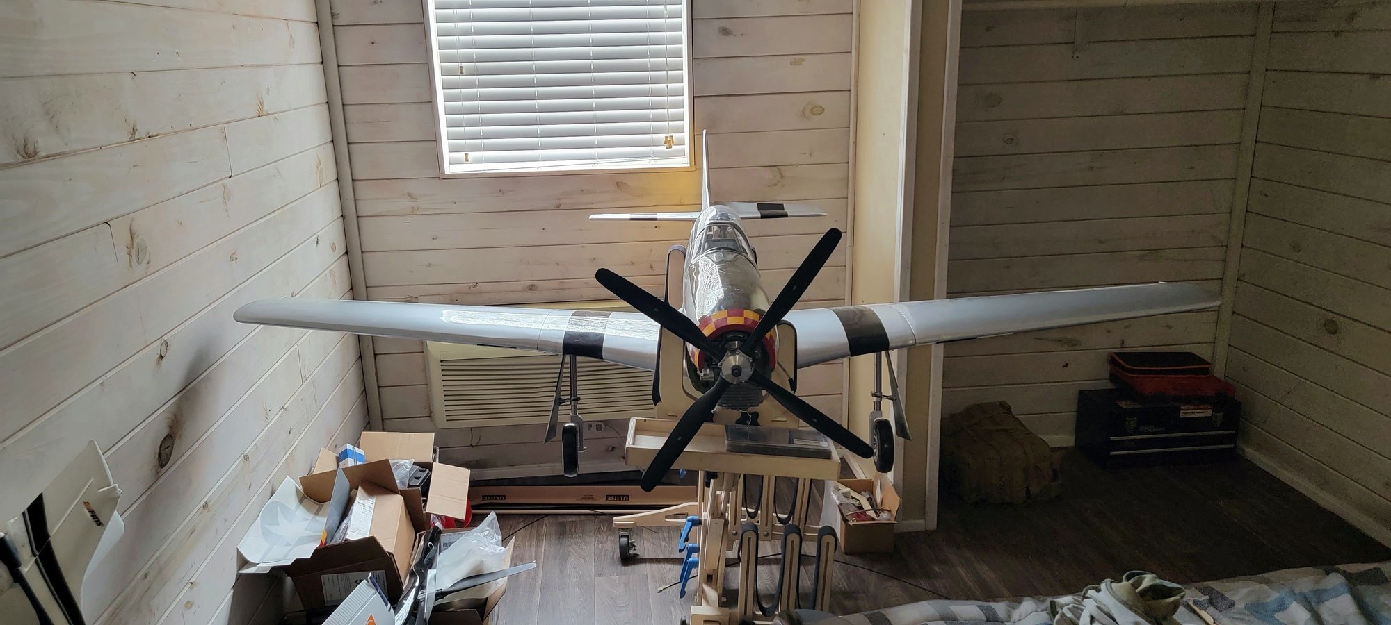

When you are 7ft 3 inches wingtip to wing tip...you tend to make an entrance..
