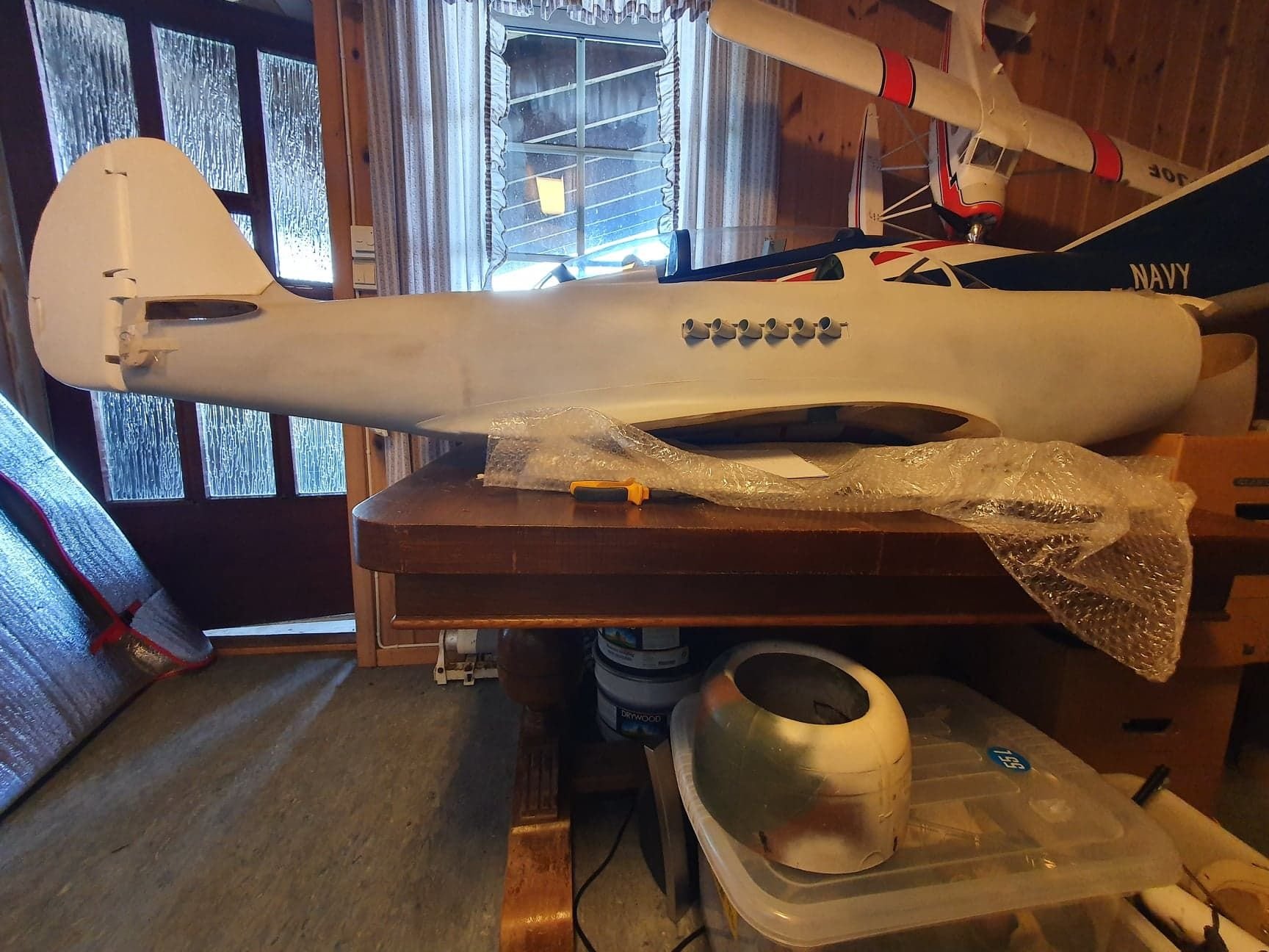

I`ve got a 2,5m P39 with fiberglass fuselage and foam wings. Long therm project but I am thinking of a MVVS Water cooled center mounted enigne.
Anyone here ever seen or tried a MVVS Watercooled engine?

That is a lot larger than the Top Flite kits we have. Nice looking bird! I have heard of the MVVS engines but I have never seen one in the flesh.

that think is a beast! Never saw a MVVS.
