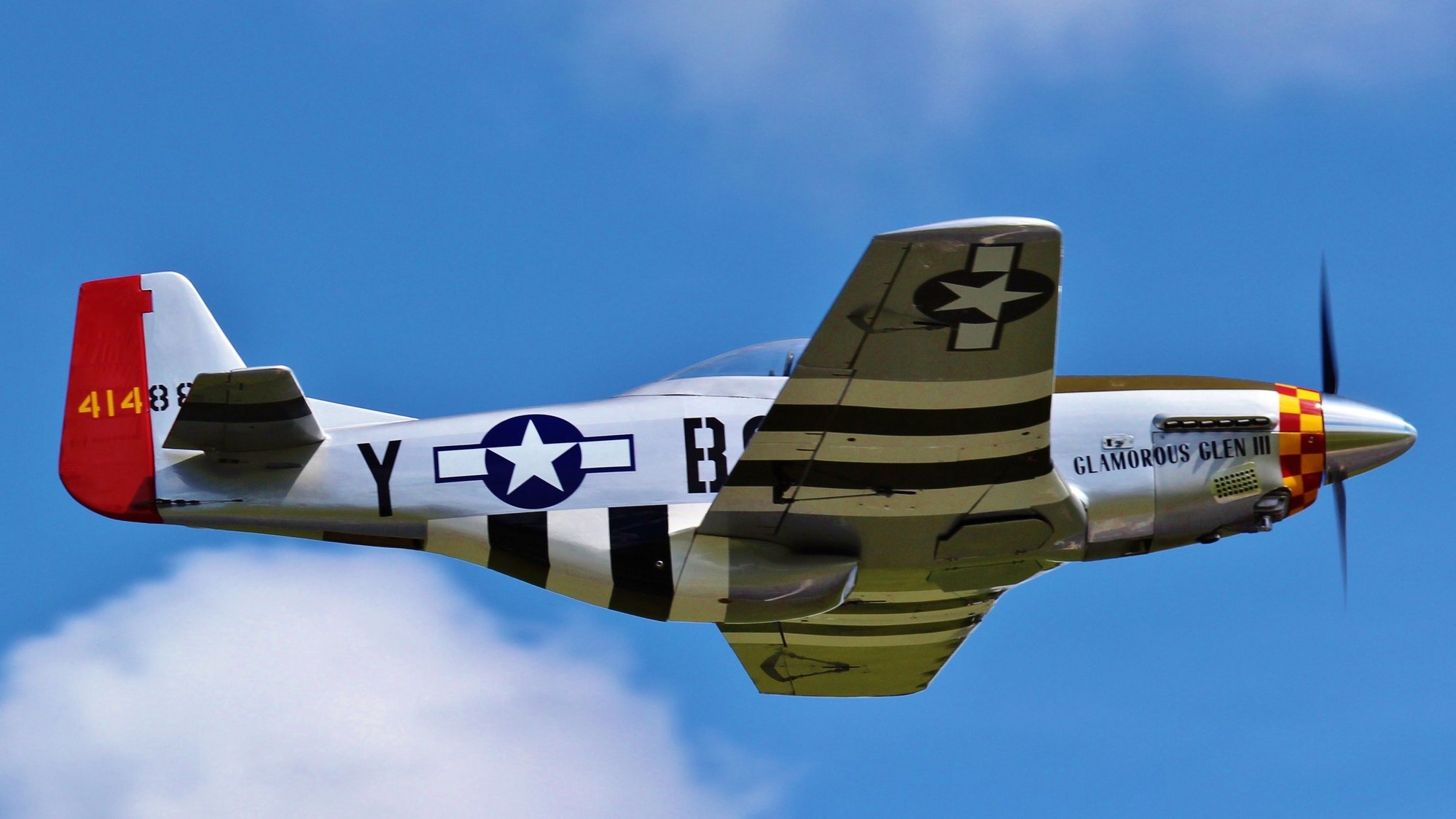

The gear door's hanging low has been fixed by removing the servos and installing air cylinders.
My replacement for the H9 Mustang. James Bates P 51B, DA 60
I flew mine today, up around 60 flights now. I removed the DA 60 to install the DA 50r from another TF plane I had retired for fuse cracking. I have 9 flights with the DA 50r installed and a new JR telemetry speed sensor. Today's speed runs gave top speeds of 118-122 mph with a slightly rich needle setting out of a 45 degree dive from 300 feet. Previous speed testing using an Eagletree speed recording sensor in my 1st H9 Mustang with this engine returned 127 mph and another radar reading at an event of 130+ mph. The new JR sensor is not calibrated (JRamerica says it is not necessary), the Eagletree was calibrated within 1 mph of 95 mph on the Interstate 75 in low wind conditions. 2 way calibration tests averaged 95 mph. Testing the JR sensor in my Corvette show accuracy up to 80 mph, it tends to read 6 mph high at higher speeds above 90-100 mph.
Speed reedings at the stall got down to 19 mph at the break, dropping to 9 as the left wing dropped. It doesn't give speed going up until above 25 mph and stops below 19 slowing down. This plane holds a steady high angle of attack, climbing slightly at 20-25 mph, refusing to stall until throttled back to idle, nose high. Recovery is instant when the up elevator is released and either down is applied or a little throttle. It usually does a 1/2 turn in a fully developed stall, losing 30-50 feet depending on how fast the recovery is started. A partial stall can be recovered straight ahead by adding a click of throttle. It has very pilot friendly characteristics and will not do an accelerated high speed stall like the kind the TF Mustang is famous for. All low speed stall testing was done dirty with gear down and flaps at 45 degrees down.
Clean, it is difficult to stall. I have to hold up and idle power in a climb until it stops, then it will do a slow motion left turn and fly off in another direction. Speed readings are not possible, the sensor doesn't work that slow.
I stalled it inverted at the top of a loop several times, it will change course and continue the back of the loop. Doing inverted stalls with the TF plane is usually the end of that plane. I have perfected the engine's cooling baffles, I can fly as long as I want at low speeds with no vapor lock ever and do multiple touch and go landings. The carb gets all its air from inside the fuselage, and all of the intake air is baffled to cool the exhaust system only. The engine cylinder is tightly cowled and no air dams are used, only a heated-air exhaust ramp cut into the bottom of the firewall. I have posted pictures of this in this forum in previous pages.
