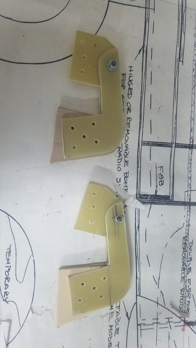

I got my brass tube and Robart hinges installed and found that there was way too much looseness in the flap movement. The brass tubes were not ridged enough and would have allowed the flap to move or flutter in my opinion. This idea would work for a smaller plane, 60 to 80" with smaller flaps, so I will hang on to them for future work. Spent the morning designing a G10 flap hinge. Now it is way over kill on the strength, but I only had .125" material so that is what I will use. I'll bet the flaps will not move now.
Different template ideas used on the plan to check for proper movement.
Final design with flap at 45 degrees.
Just cut one hinge setup but looks pretty good. Could only spend the morning working on the project so will pick this up tomorrow.
Mounting blocks not installed but shows basic design. Undecided on G10 section in flap as to how to mount for best strength.

Hinge assembled with #6 bolt with washers and Nylock nut. Holes drilled for glue and surface scraped for better adhesion. Pivot bolt tightened down to stop rotation and then back off about one half turn to allow for easy movement.
First glue up of hinge on right side flap. Ensuring that the hinge is perpendicular to the flap.
Same setup on the left side flap. Once Tightbond has dried, I will reglue with Aeropoxy on the edges. Sure, was a lot of work getting here.

Not a great day, as the hinges bind as the flaps are deployed through about 30 degrees. It looks like I was not careful enough when I glued them in. I may have to cut them out and reset them. Biggest issue was that the flap attachments were not plumb, so in a rotation they begin to twist. Flying tomorrow so might not get back to this until Thursday. One good thing, I do think I can use the brass tube hinges for the outboard wing flaps. They laid out pretty well on the plans and the distance is shorter which makes them stronger and there is a lot less flap.

Don't you just hate tearing out what you just put in!! Came out better than I thought, but still have skin to repair or replace. Much more care now in tomorrows and Fridays install. Did not go flying as planned but used the morning to do other items. Got started about 1030 with fear in my heart. Took all afternoon but hinges are out and cleaned up. What a mess! Leason learned, be very careful on installing long reach hinges. Check all alignments and maybe build a dry fit temp assembly to test hinges being square and plum. Be very fussy on the install here. Going flying tomorrow morning at 0630 due to heat so won't get back to this until the afternoon.
Right side with hinges and support material removed. This is a real pain to do.
Left side removed but damaged the skin getting it all out. Will patch the skin after install is complete.
Flap with all hinge items removed including the servo linkage attach point, it was not installed perpendicular or plumb to the flap. Some skin replaced
Better shot of dry fit new linkage attach point with 1/2" mounting material and my made-up square to make it plumb. Large area of skin replaced getting stuff removed this time.
Hinge cleaned and ready for reinstall. It's got to be correct this time.
One other hinge ready to go. I think I will tack weld the G10 in place with Aeropoxy making sure of the alignment, let it sit overnight and then install the blocking with more Aeropoxy. Bad thing is that the hinge structure will not be able to be removed without destroying much more material by using Aeropoxy. Did I mention, it's got to be correct this time.

Today I spent some time figuring out just how I was going to improve the layout of the flap hinges. After mulling around for a hour or so, I recalled Sam Parfitt's 2011 build of the B-25 and found the section on how he installed the flaps. Sam, in my opinion, is a master builder and now I see myself using more and more of his building techniques. If you wish to see an absolutely outstanding build here is his address on RCU -- ZIROLI 120" B-25 MITCHELL - RCU Forums (rcuniverse.com). So I did what he did by temporarily gluing the flaps back into place. Now, how do I make the layout work, I will make an effective jig that sets alignment to the flaps.
As Sam showed, I went ahead and temporarily glued in the flaps. Also shows how I butchered up the flaps and how much work it will be to get the back in shape.
Vertical view of my jig. It is exact to the same size of the actual hinge in the wing. Some more work will be needed to get a placement for the hinge in the flap. It should be the exact center of the gig. I'll see if I can find center and make it usable to make the location for placement of the hinge.
Side view of the jig. This jig is as close as I can get to 90 degrees to flap face and plumb to the skin.
Jig is place showing the proper location and alignment of the hinges
Just another view of jig pulled back. More work to make it work in both left and right hinge locations in the flap.

Made some adjustments in the jig design so it could be used in the different hinge locations. Also recut new hinges so they set flat on the skin of the wing and the flap This allows that they can be tacked in position for a test before the side reinforcements can be epoxied in place.
These are the newly cut hinges that reach the skin in both the wing and the flap. Each one is custom fit to its location on the left or right side of the flap.
Jig in place. The crossbar at the rear sets the plum, perpendicular to the skin, and the side locator is removable so it can switch sides for left and right flap locations.
The side locator is set against the spar to set the correct angle to the flap. Here the hinge is clamped in place to the jig.
A rear view of hinge clamped in place. I used CA to temporarily set the hinge. Side supports will be epoxied in.
Left hinge glued in with CA and right side just setting up against the jig. I will measure across the hinges to ensure that they are parallel to one another.

The jig idea worked pretty good but not good enough. I did not get a good alignment between the two hinges so went to plan E, or whatever came next. Just keep trying until you get it to work and yes, I finally got a good alignment, and the hinges do the fowler movement. Now on to the outboard flaps on the wings. Something went amiss and I could not type in text. Photos show flap deployed to 45 degrees and various shots of side reinforcements installed.
Here is the final setup. Two small squares (1x1 angle) on each side clamped to the spar and a perfectly squared jig to make the other hinge parallel. I first set one hinge perpendicular to the spar with a larger square and then set the parallel board and clamp it in.
Better photo of small square. A 1-inch angle is actually square. CA used to temporarily hold the hinges for a test. Cut the flap loose and it all works with no binding.
