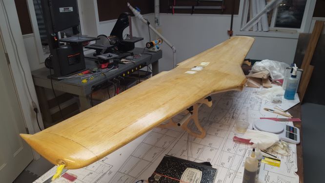

I'm putting in build log progress on adding features to the wing before I glass it. I put in the shell ejectors. I also wanted to be able to remove the Hangar 9 drop tanks I bought so I had to figure out how to attach them. I may or may not fly with them. I couldn't find any fore aft location dimensions on the internet. A fellow modeler who had a kit gave me dimensions for a 1/5 scale kit relative to the leading edge. Pylon 40 mm back and tank forward of the edge 67 mm. I'll adjust height, and level tank when I drill attachment holes. The issue here is how to attach and be able to remove the tank. I needed to secure them if I flew with them. I made a blade and pocket in the pylon which is just a vacuum formed ABS part.
I used 1/16 G10 to make a blade that would fit the tank to the pylon.
I made a pocket and glued it to a base that fit inside the ther****rm pylon that came with the Pica kit.
The blades locked in place and slid into the pocket.
I filled the void with lightweight epoxy putty.
This fitment shows where I will drill and tap screws.
The excess balsa was shaved and fitted to the wing at a location 40 mm back from the leading edge.
I epoxied the pylons onto the wing.
I checked the fitment. I'll have to drill holes and level the tanks out relative to the wing.
I smoothed out the gap between the pylon and the wing. I wish Pica curved it to match the airfoil.

I kept track of the weight increase as I applied the .73 oz. / sq. yd fiberglass. Always curious of the weight gain of finishes.
The estimate of area excludes the ailerons and flaps and is about 2505 sq. in.
Same procedure on both sides; fiberglass then sand edges, second coat then prime and sand all the primer off.
Spot fill and then make it smooth as a baby's butt!

Start 2670 g 94.18 oz
After 1st Bottom Resin 2780 g 98.06 oz
After 1st Top Sanded 2915 g 102.82 oz
After 2nd Bottom Resin Sanded 2925 g 103.17 oz
After 2nd Top Resin Sanded 2935 g 103.53 oz
After primer/fill/sanding 2941 g 103.74 o
oz. oz / sq. in.
Increase 9.56 0.003816
