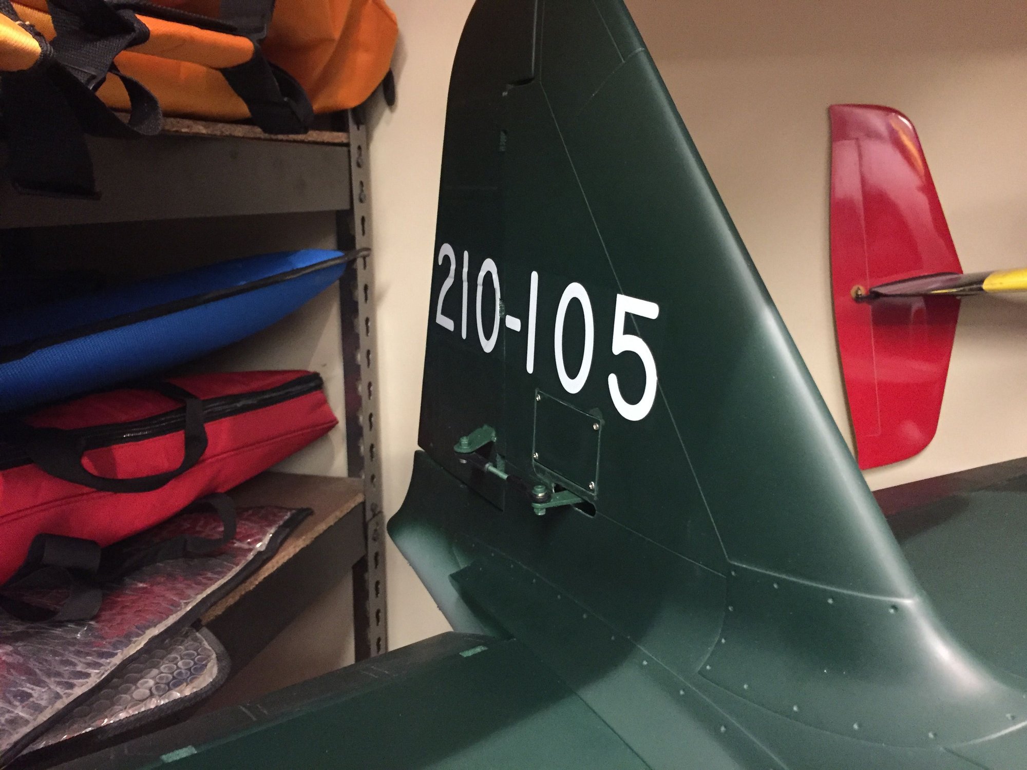

Just type his name in on the FB search and you’ll see his work it’s really good

Originally Posted by LtMash1A View Post
The model is a modified Meister Scale Zero
I donít think so....
I' m not sure what that is about with the title Top RC. It obviously is not a TopRC Models Zero. Are you saying that it is or is not? Sorry to be confused by the post.
Just to clarify, the airplane in the pictures posted is indeed a Top RC Zero ARF that Toshiaki is modifying, obviously, to be more scale. He also built and competed at Top Gun with a Meister Scale Zero several years ago. I believe the cost of transporting the Meister Zero back to Japan was not economical and so it passed into the ownership of Dino DiGorgio, owner of Meister Scale.

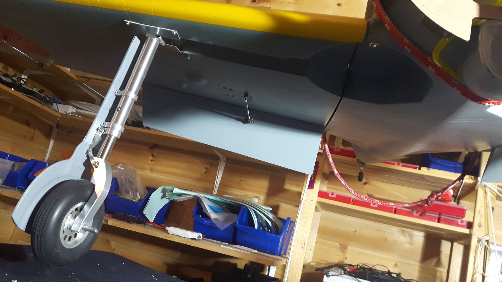

Hello,
I am building my second TopRCmodel Zero. Just needed one again since i sold it.
I used the electric retracts that you can get for the model, and i was very pleased with it. No problem with those as long as i had it.
This time however i decided to use Sierra retracts air. Fantastic good quality on them. I also use a Sierra retract air on a TopRCmodel FW-190 that i currently also are building. Simply great retracts.
Just some pictures of the Sierra system:
My previous one

Good work Totto .............. I really like the grey version.
Working on my Zero too at the moment.
