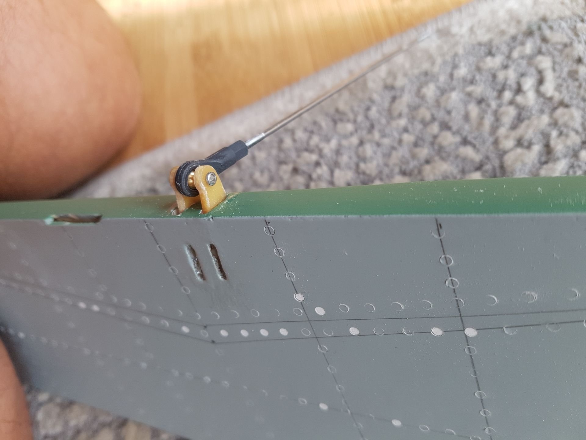

3. Aileron pushrods are shifted to upper side of the wings like on the original Zero.

1. Ailerons:
I cut another hatch in the wing to install servos, pushrods and control horns to have scale look

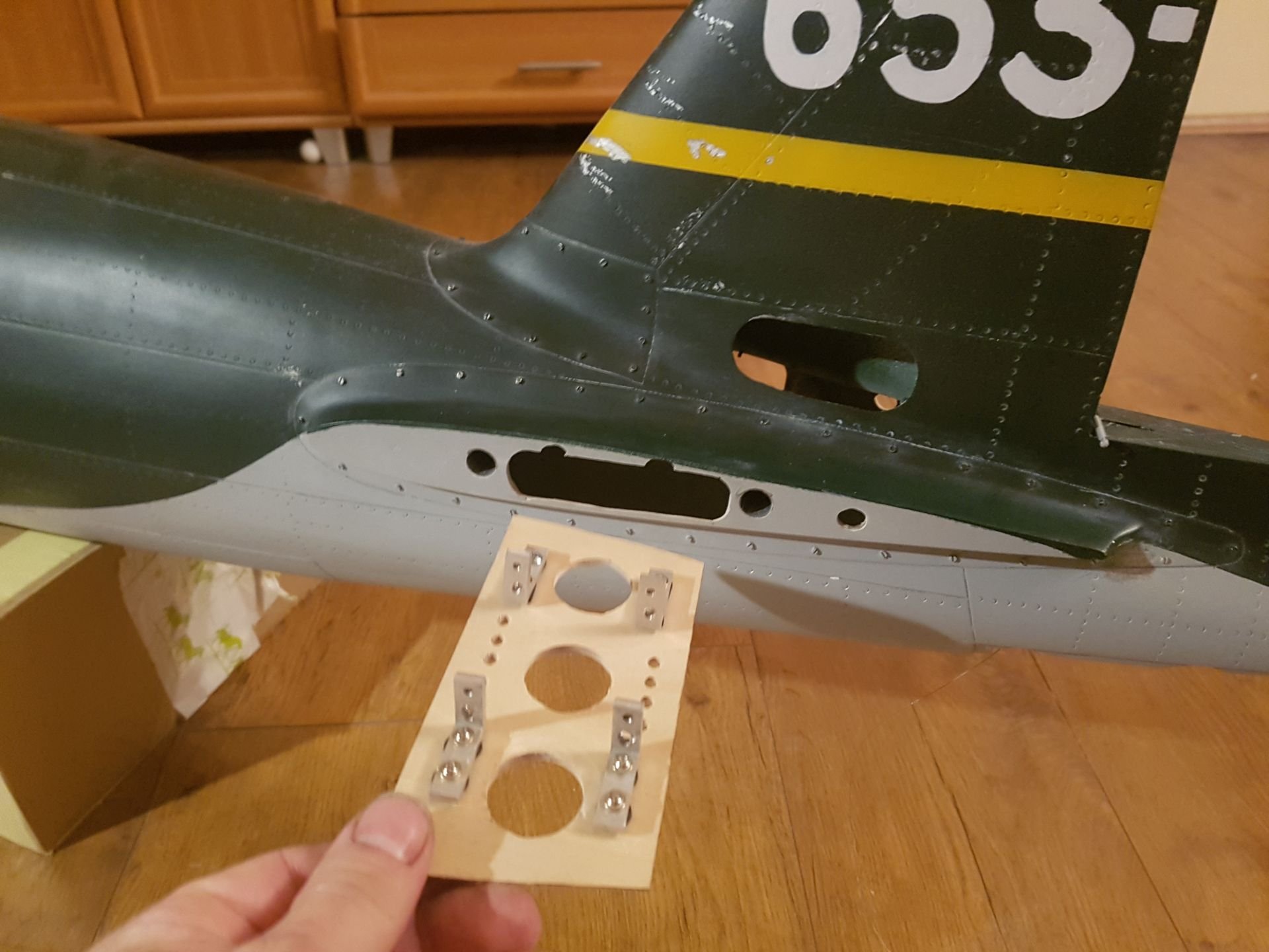

I cut hatch in the tail like the original Zero had to have an access for linkage connetion. It is slightly overscaled but then I can put my fingers inside to screw upper part of control horn and connect it to pushrods.For elevators I used 8mm alu tube with inserted wooden core. On the elevator side lever is M4 screw . The other side is heavy duty control horn M3. Once horizontal stabilizers are in place I can instal control horn with srewdriver through the tail wheel hatch. Servos for elevator are Savox SV-1260MG. I'm still missing one piece because was out of stock in shop so pictures doesn't shows how everything is connected.

Assembling of tail section is finished. This is how it looks:
and how it's done:
