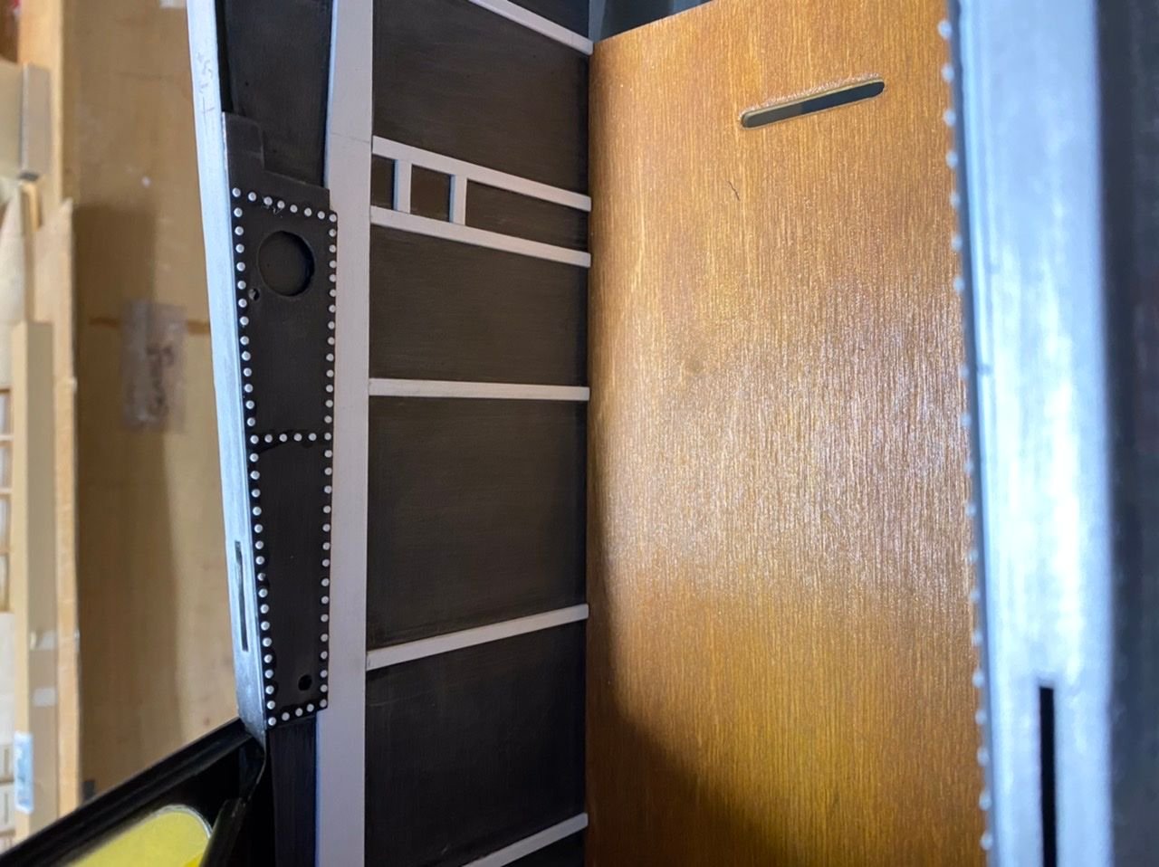

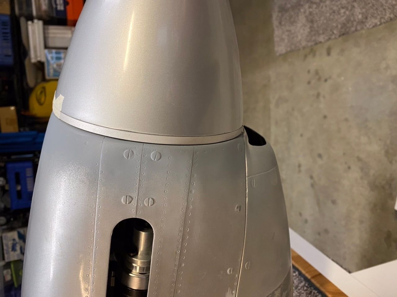

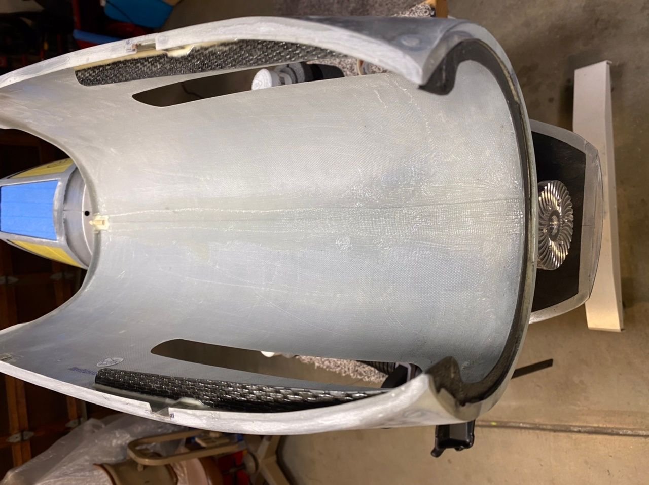

Heres a shot of the rudder, again a moment of OCD, I had to sand off the pimples on the rudder. Just doing that alone was a huge improvement I think. I cut the trim tab out, spaced it, and glued it back in place. I have another idea so I’m going to test that and see if it looks good or not.
Now I’m in paint prep work and sanding and finishing for primer then paint. Cowl is done, I finished the other side of the exhaust and epoxied them to the cowl. The starter motor clears just fine. A note here is the parts are spaced from the cowl and the pipes are drilled through to promote air flow.
Also note that the spinner with the lightened backplate in conjunction with the 4 blade prop now have a way to pump air into the cowl.

The cowl had a bad gap to the back so I had to do some body work there with body filler. The exhaust looks ok to me as a place holder till I figure out something better looking.

Posts: 3,128
Received 19 Likes on 17 Posts
Rudder update, removed the bumps and covered it with black Solartex. Looks better but not really scale. I just had to remove the bumps and clean it up with a fabric finish. I tried looking for a pinking shear or fabric cutting wheel but I didn’t find one small enough.
