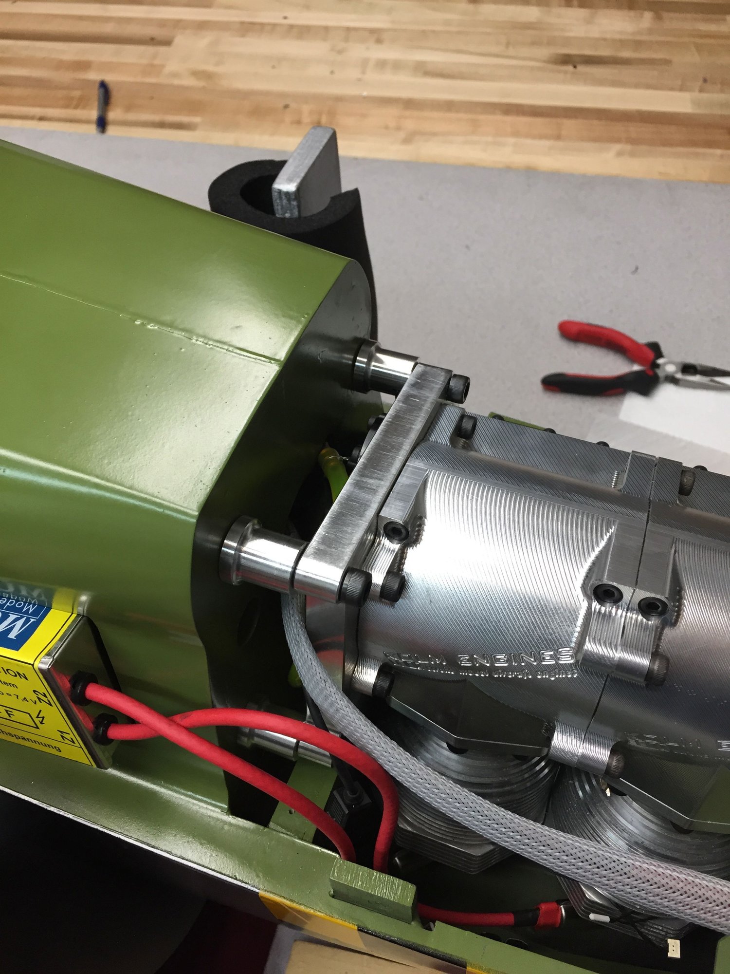

Something that might have helped your CG would have been the long front prop hub to set the engine back just a little further.
Yes, I went with the machined mounts now. I was going to use hard mounts and soft mounts but decided to just go with all aluminum mounts. It’s getting closer!

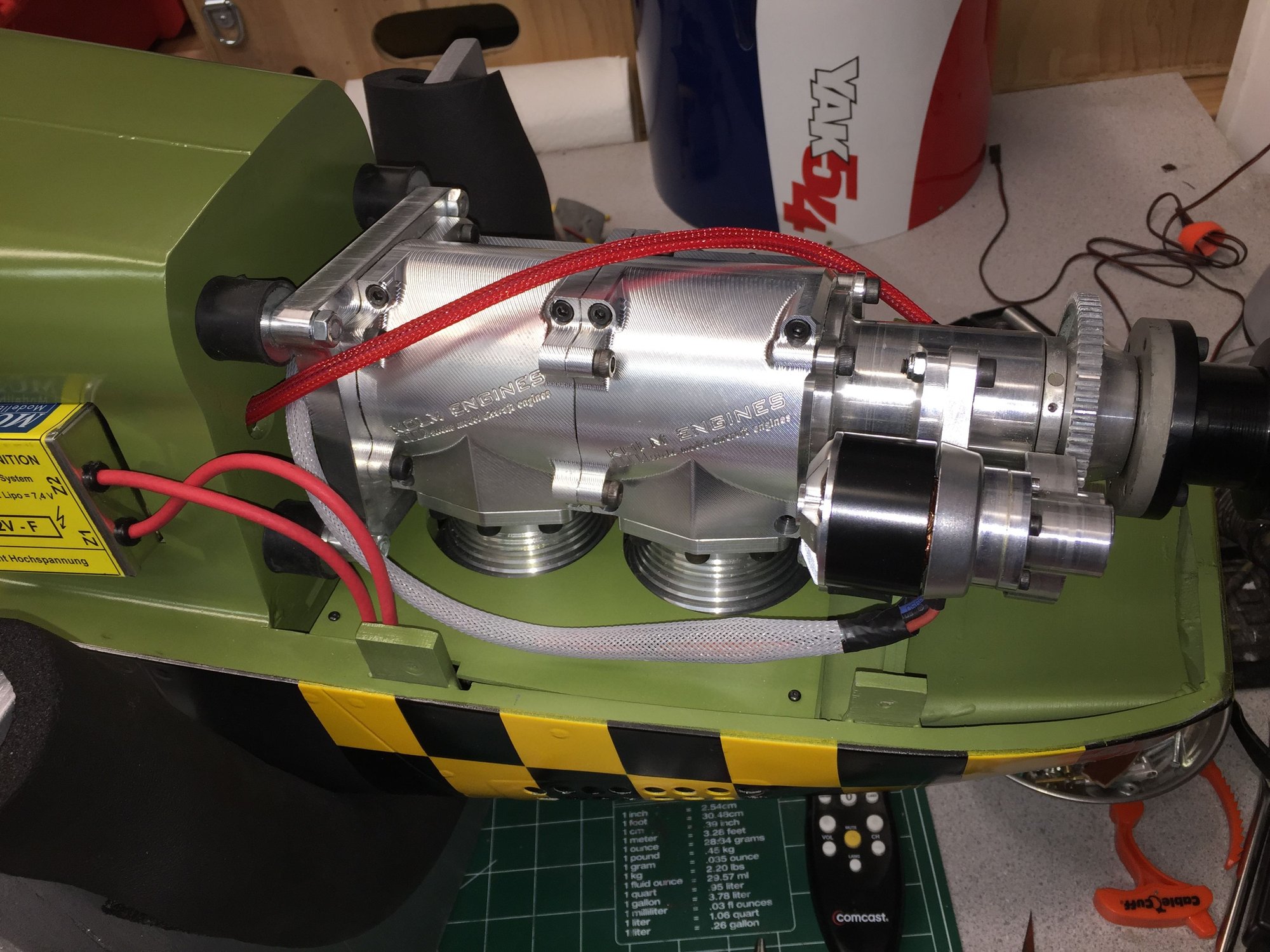

Motor mounts and the baffle is done.

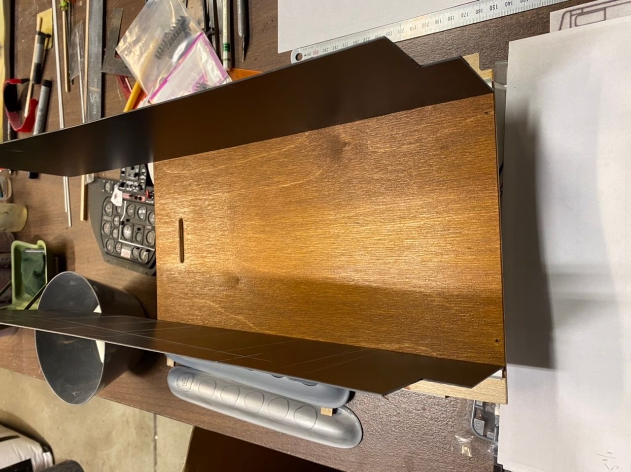

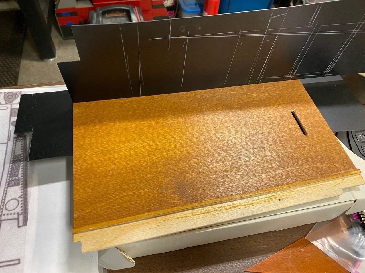

The Cockpit

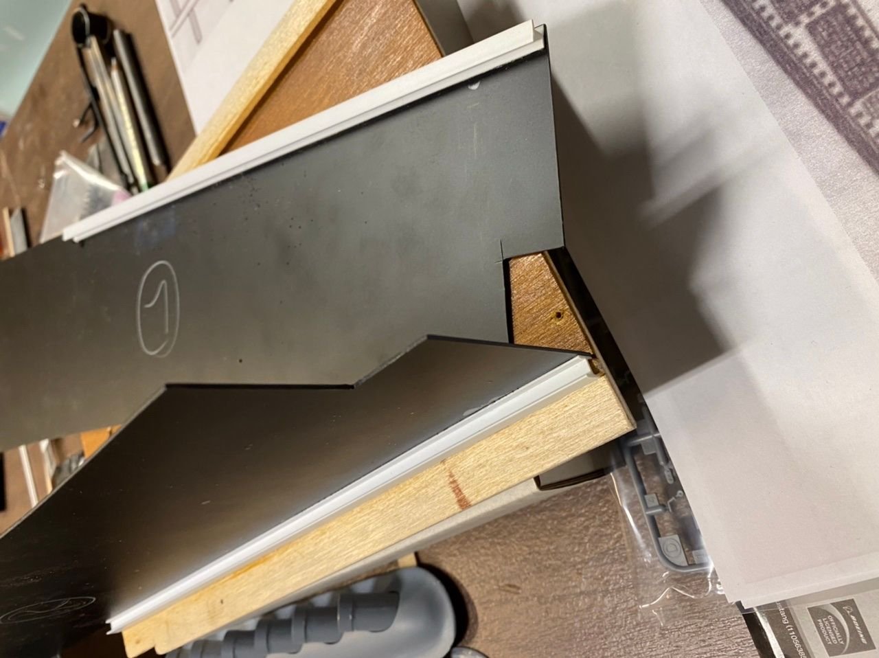

This is the part I’ve been dreading because of the cockpit kit I got and the difference in scale. If you want to build this cockpit I highly recommend getting the 1/4 scale kit or finished cockpit from wherever you want to buy it. The 1/5 scale kit parts are too small for the CARF Mustang, don’t let them tell you differently. Without seeing them in person or installed in another plane you can’t get an idea of what will work. I took the word of the guy from Iflytaileis and the parts are definitely too small. Now the trick is to make them work but I have to fake it by spreading them out and cheating things.
The pilot figure has to be 15 inches tall too.
The seat the kit comes with is pretty bad in person, very light but also very flimsy and poorly made. I prefer the sheet metal seat the later Mustangs had instead of the this tube frame version. I’m debating building one from sheet styrene.
Since I have a floor in my build the proportions are messed up because I built it according to my duct requirements. This is also adding to the cockpit proportion problems but actually not as much or as bad as you might think. My cockpit will end up being shorter and longer but what really hurts this is the smaller scale components.
The plan is to use sheet styrene to make the basic walls and then add layers to make it interesting. Since the canopy will not slide and only be removed when needed I don’t need to make the cockpit super detailed so I’ll use the paint to create depth with shading effects.

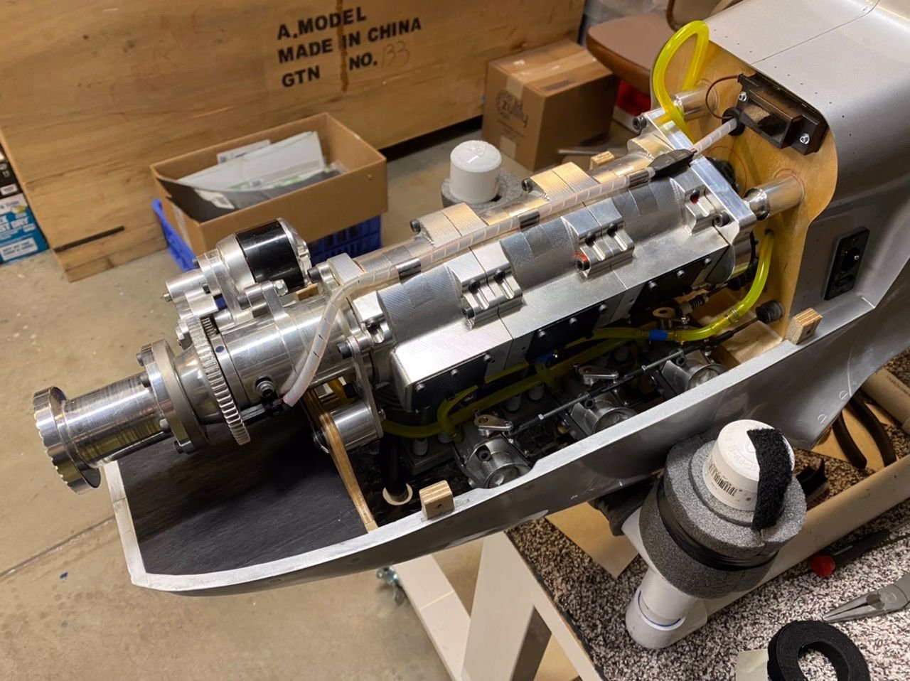

The instrument panel is also too small and you can tell because the edge instruments are far from the side walls. The 1/4 scale panel might be on the large side but you won’t know until you try it, unfortunately. I would prefer the larger panel and make adjustments than have the smaller one swimming in the cockpit tub. Someone needs to make the right size cockpit kit for this model!
The engine is in and I had to adjust a few things like the tank and ignition positions. I had some issues with the tank interfering with the throttle linkage and the ignition switch so I rotated the tank 90 degrees and moved the ignition box back about an inch. Lots of stuff to fit between the firewall and the instrument panel.
The cowl just needs the right side exhaust now and it will be done.

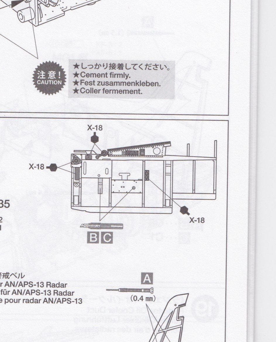

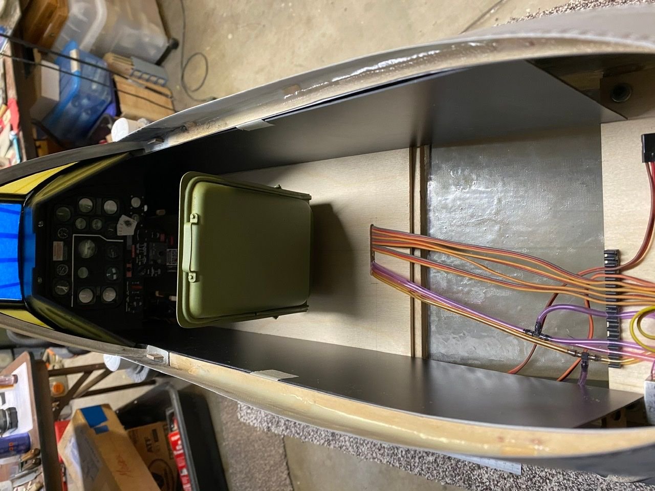

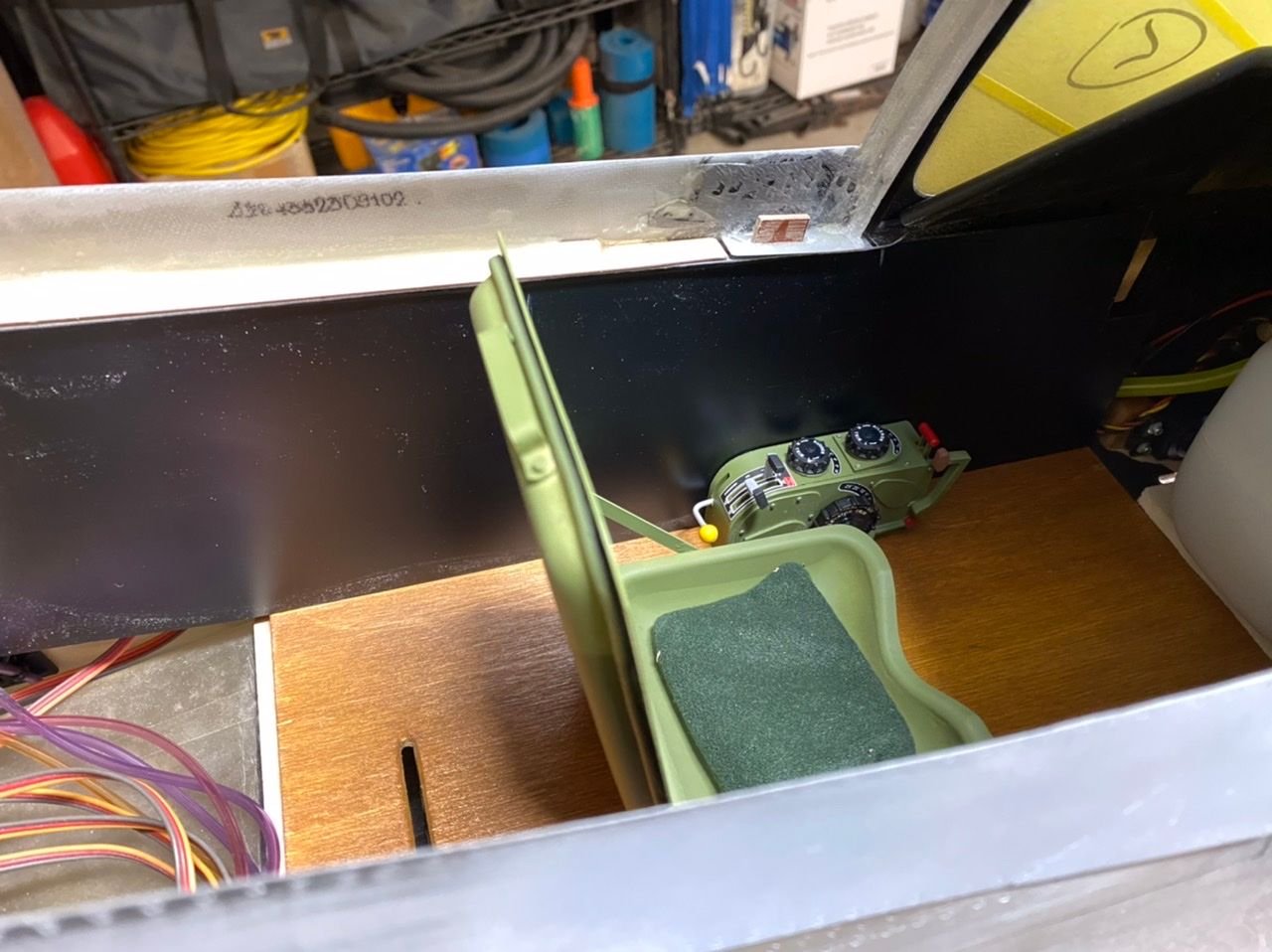

The Cockpit build like many planes is a challenge because you don't have a lot of documentation plus the planes can vary from model to model, etc. I have a literal stack of magazines and books about the Mustang and you can see the variety of colors and instruments within the D model range. I bet a lot of it has to do with these planes being restored and less original but Im looking at the factory fresh looking restorations for the best representation of the cockpit. On top of that Im really just making a sport scale cockpit but as you go down this rabbit hole you learn a lot of things like zinc chromate, 3 basic colors but depending on theater and availability and wether the crew chief mixed his own the choices are just about infinite.
Finally I decided to refer to the 1/32 scale Tamiya plastic model kit manual of the Mustang because I found the best image to help me out with the basic layout and scale/proportion of the side walls of the cockpit. The magazines and books show nice images of the panels but never side on or flat, always in perspective. With this image you can scale the layout to any Mustang model you have and get it laid out quickly and easily.
To help everyone out Im posting this in case you want to tackle this cockpit project some day.

Some basic scaling with the cockpit kit parts I received. I’ll be using this to plan it out and make it fit. The side panels and floor are tongue and grooved so all I need to do is add plywood blocks to screw into to lock them in place. The blocks will be epoxied to the fuselage walls and easy to get to with a hex driver for a total removal of the cockpit if needed.
